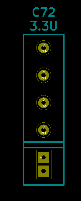

Lead spacings of 5.0, 7.5, 10.0, 12.5, 15.0, 17.5, 20.0, and 22.5 mm are supported for C22 and C72. The double line on the top-layer silkscreen indicates the demarcation between cap-terminal-1 and cap-terminal-2.
You could measure this on a Noir PCB.

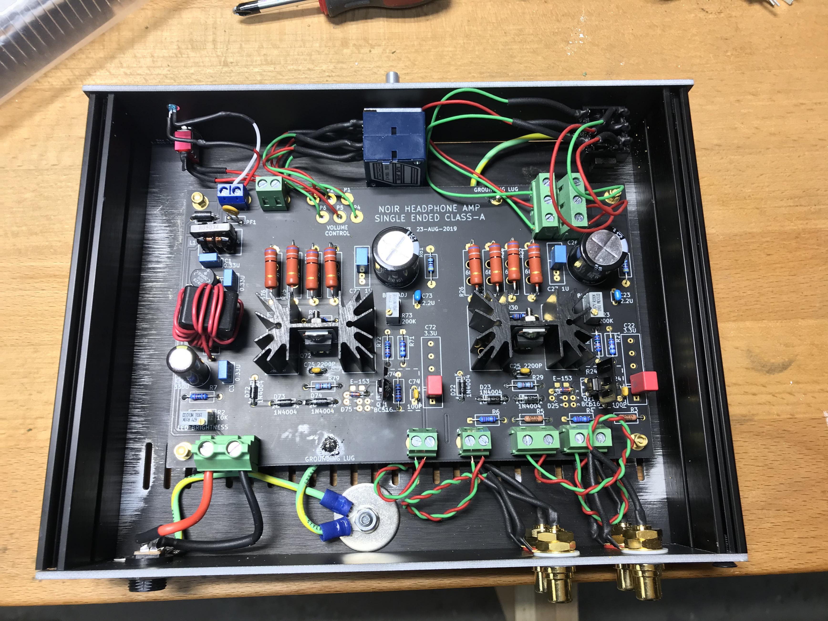

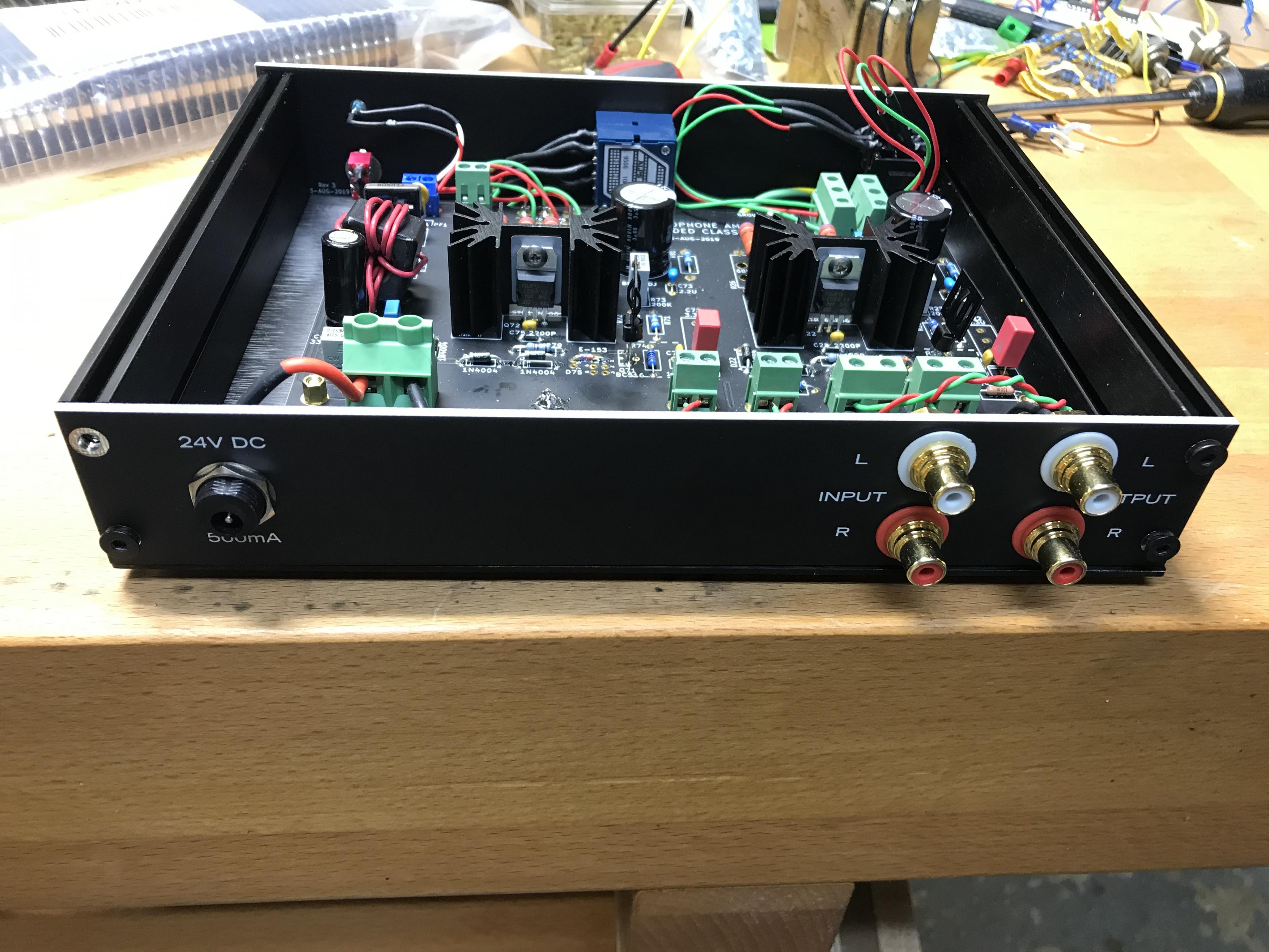

+1 I love the NOIR I built and thank the community and everyone that helped design, package the kit, and help with this including 6L6, Mark and others. This is why I love DiyAudio! 🙂
With the correct pictures of the NOIR this time. 🙂
