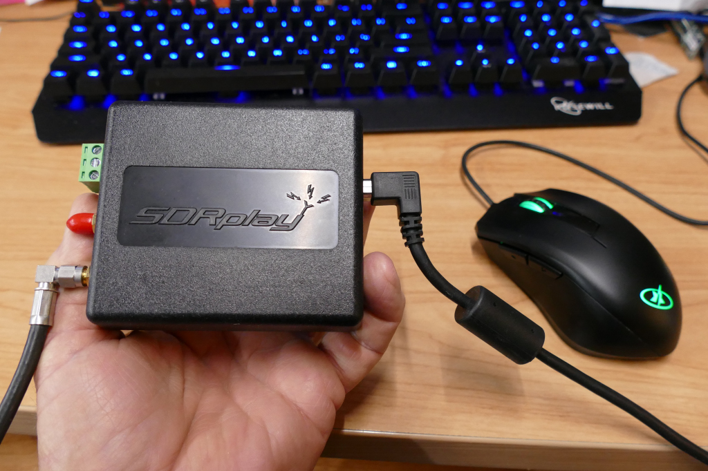

We're talking under $200 to get into a lot of fun......One, an SDR receiver product out of the UK: SDRplay

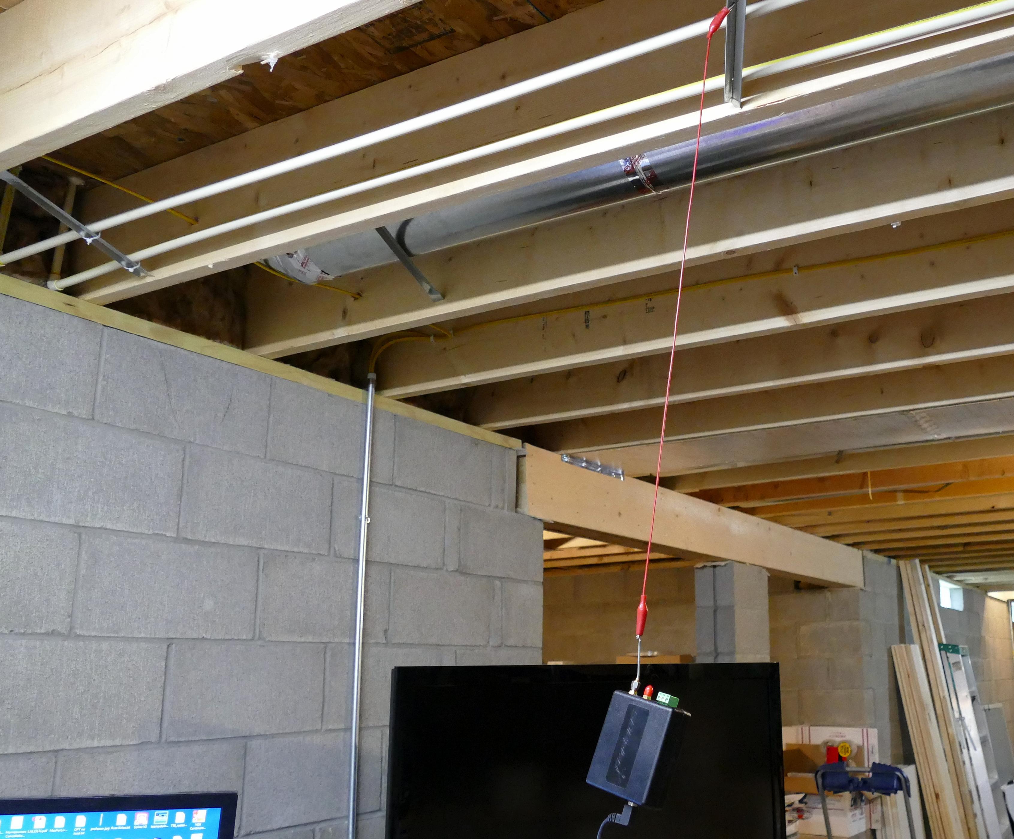

I got one of those. I have tested it in my FR black hole, underground in the basement of a house which is in a "holler" surrounded on all sides by tall (100+ feet) hills. We get no cellular or TV reception here and little broadcast radio. I also purchased a "broadband ham and scanner antenna" on Ebay, but haven't had the time to put it up yet. When I do, I will also put up some sort of HF antenna. I had a "Mystery Antenna" up in Florida, but it picked up more noise from the nearby EHV power transmission lines than it did radio signals.
With the crude underground setup I don't have many signals, and I have a lot of random RF from the PC, it's displays (cheap TV sets), and the Comcast Box. All of these are within 3 feet of the clip lead antenna.

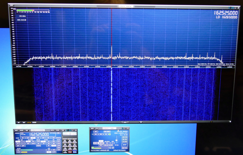

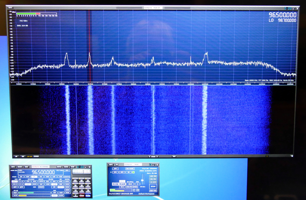

The SDR Play can be set to "swallow" as much as 10 MHz of spectrum at a time, and display it spectrum analyzer style, with a waterfall histogram below. Shown here is the local weather broadcast on 162.525 Mhz in a 2 MHz capture window. It is telling me (through the PC speakers) about the snow that we are going to get Saturday night.
I also grabbed a 10 MHz chunk of the FM broadcast band, and tuned in the local rock station on 96.5 MHz.

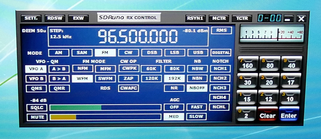

Also shown is the RX control panel. Here you can choose the IF filter, FM mode (wide for broadcast radio, narrow for ham FM), noise blanker and notch filter for removing a pesky signal.

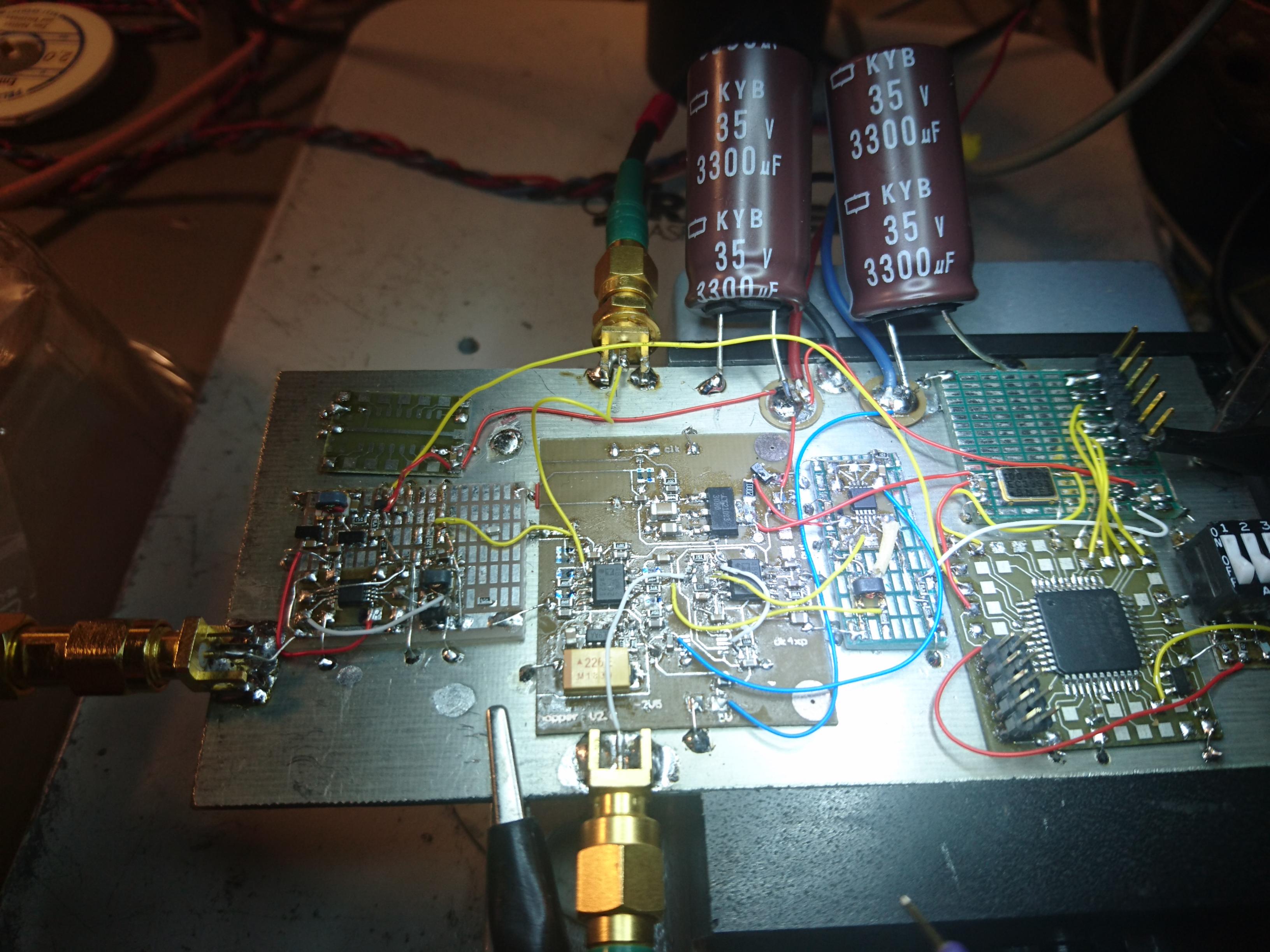

I'm trying to build a chopper amplifier at 100 pV/rt Hz that upconverts to 1 MHz,
amplifies and downconverts again with the FET switches. Transformers are
small MACOM and Pulse engineering thingies, I had to rewind some of them ,
3 mH for 32 turns. Had to solder them to a breadbord and then wind them under
the microscope. 🙂
I want to get rid of the 1/f noise.
The CPLD allows me to alingn the up- and down conversion switches to make
up for the amplifier delays. The oscillator is 100 MHz, that allows 5 nsec of
resolution, which is probably much better than needed.
I get terrible switching glitches, some of them 2 nsec wide.
This is Version 2.5, with a lot of rucksacks for the changes, but it starts
to converge.

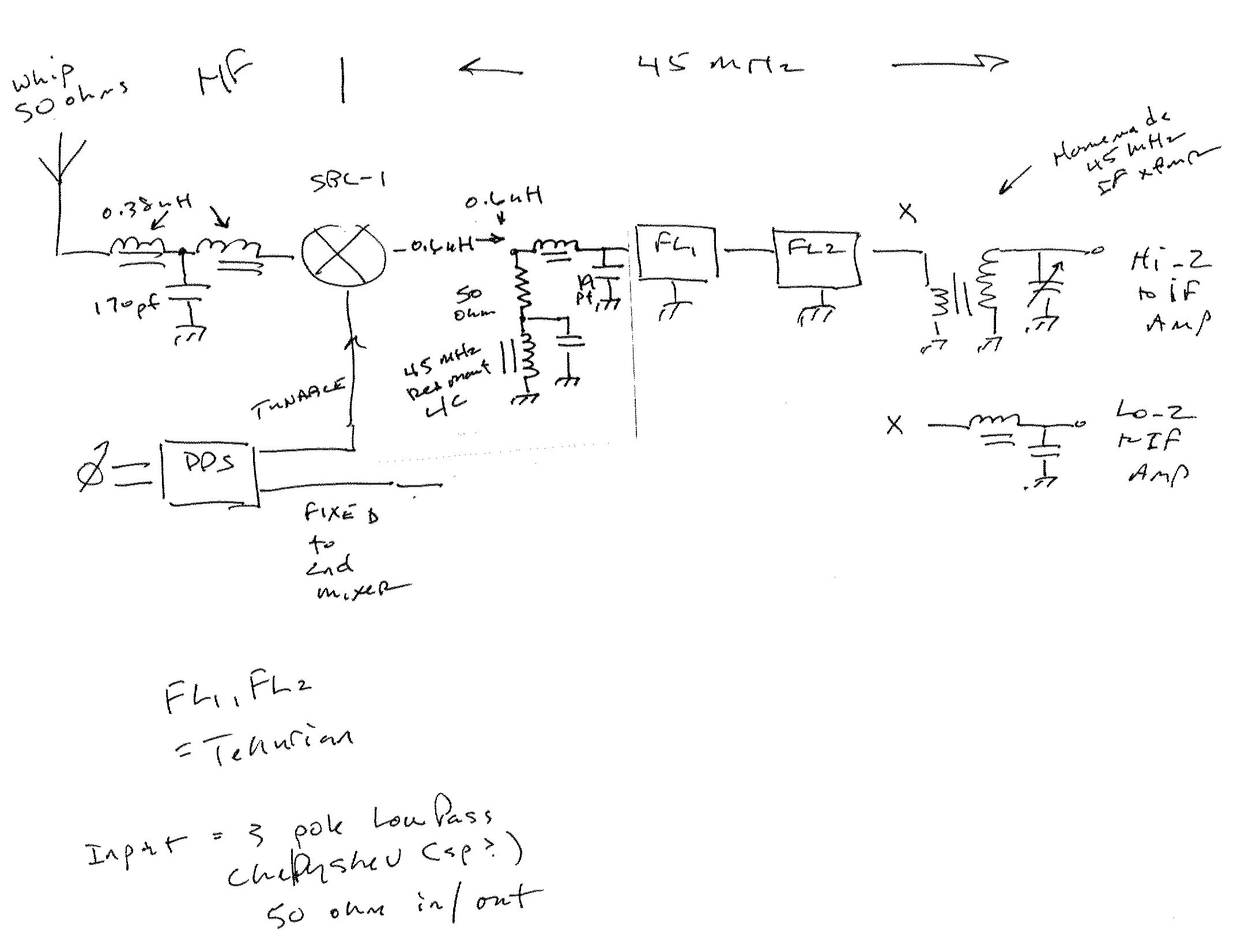

Proposed first front end with a ring mixer. Looks too simple, but I guess that's the virtue.
The T Network ahead of the mixer is a low pass filter at about 26 MHz. It doesn't have much attenuation until the bottom of the FM band, and then only about 30 dB. I anticipate the antenna will be a pretty sharp filter in it's own right.
The LC network out of the mixer is to match into the Tellurian filter(s). If I use the ECS, I'll recalculate the values. I'll use a homemade 45 MHz IF transformer from a toroid to match into a MOSFET IF amp, or another LC network to match straight into a Lo-Z bipolar transistor, or IC amp - or maybe no matching needed, depending on what I use here.
Haven't thought much about the first IF amp - it seems all I want to do here is maybe cover the loss ahead of it, and in the mixer to follow.
I'll probably work up another sheet for active mixing, since it may be a bit before I can burn solder on the project.
At HF, I'm thinking I won't need an RF amp, but I guess that could change once something is built out enough to get in the car and start testing. My usual test is that if I can hear the noise output increase when an antenna is connected, sensitivity is adequate .....
I guess I will actually look at Part 97 and see what the HF spectral purity requirements are, but I can't imagine -60 dB not being sufficient for amateur use. Not that I will have any way to directly measure ...

It is absolutely essential that the RF and IF ports of the ring mixer
see 50 Ohms without reactive components. Anything that is reflected
back into the mixer will mix again and again and again. So the IP3
drops to ridiculous values.
see 50 Ohms without reactive components. ....
The point is well taken.
I think the RF port is OK - it should be looking at a constant 50 ohms. I can insert a broadband 50 ohm resistive pad at the IF port to terminate it.
The antenna will be a small mobile whip - Yaesu ATAS-100 - about 4 feet in physical length. If I use the ring mixer, I'm hoping to avoid the need for an RF amplifier, so I hate to add in more conversion loss, if I don't have to. I may need more poles at the low pass filter - going to 5 poles would give me another 30 dB rejection at the image, but would be more loss.
If the mixer is not going to be seeing big signals, is it that critical that the mixer be terminated at all frequencies, as opposed to just being impedance matched at the 45 MHz IF?
All of this is part of the balancing I am weighing between active and passive mixing.

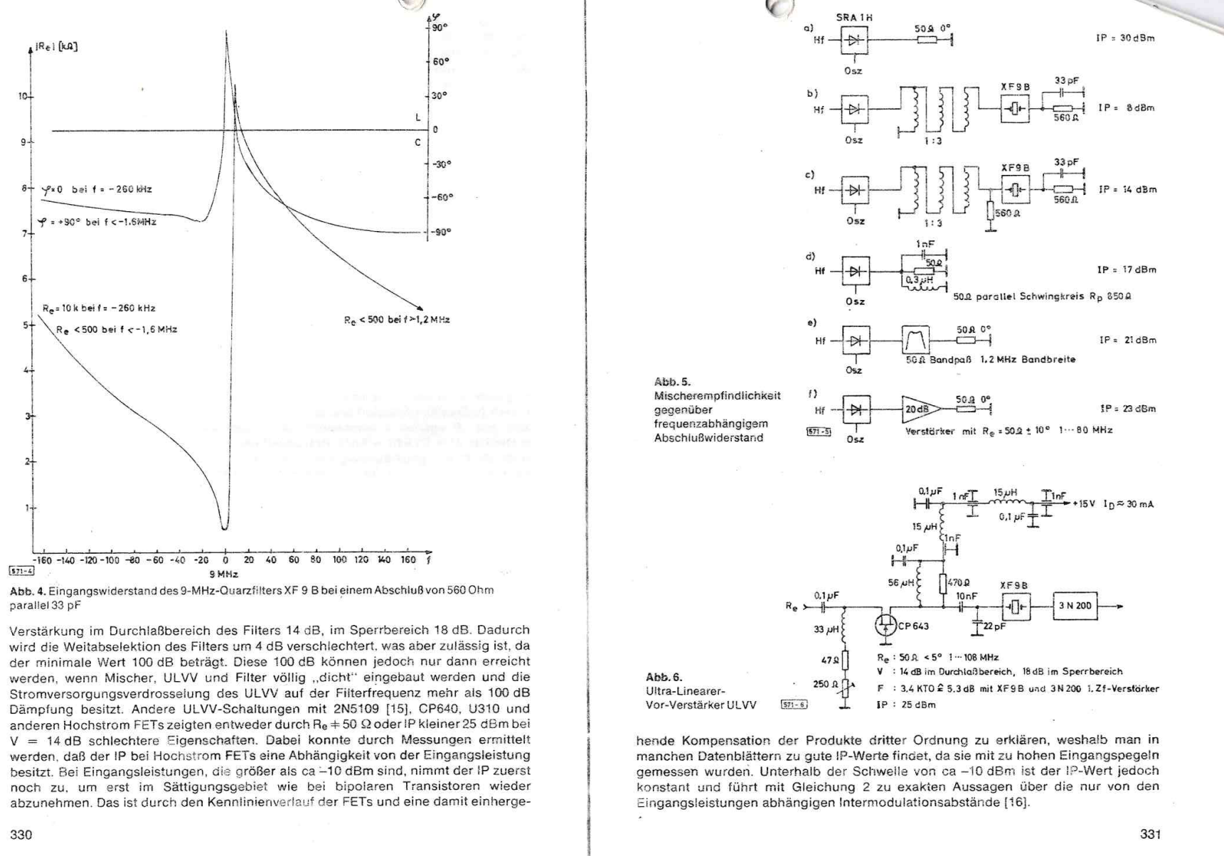

Revised. Better?
From an article by DL7VY in a 1974 DL-QTC:
Left side of the picture:
input impedance of a 8 pole 9 MHz crystal filter. XF-9B by KVG, it was the
standard here for ham receivers. The impedance goes all over the place.
Very bad as a mixer termination. There is no reason to assume that the
45 MHz filters are more friendly.
On the right side: some alternative terminations and their influence on
3rd order Intercept point. By far the best solution is an isolation amplifier
between the mixer and the filter. Its input impedance is 50 Ohms real
over a wide frequency range.
You probably cannot get the Teledyne CP643 any more, nor the
TI P8000 or P8002. The input impedance in common base is 1/gm,
so you need gm=20 mS. Modern FETs such as BF862 have a better gm
at less current than the CP643. You can use several in parallel to get
enough current for linearity and then get rid of the excessive gm by a
negative gate voltage. I think the old FETs used to run at 50 mA.
I happened to measure one of them when I started to play with my
new Locky-Z curve tracer
< http://www.diyaudio.com/forums/grou...measurement-amp-ikoflexer-11.html#post5195602 >
The isolation amplifier will have some gain, but after the input filter and
the 6+ dB of mixer loss that should be no problem. It can handle the
crystal filter mismatch, esp. with a parallel resistor so that the impedance
cannot go completely through the roof.
There are now op amps > 46 dBm IP3.
Two AD604 make a great IF amplifier with excellent AGC range.
Article by U.Rohde in Ham Radio 1975:
< https://www.google.de/url?sa=t&rct=...put%20RX.pdf&usg=AOvVaw0_mXhiyhkZzT4rC__vU6iu >
Look into the archives of QEX at ARRL.
Mini circuits do some great broadband MMICs which are 50 ohm input, or very easy to match to that...
I have a lot of Dr. Rohde's articles from the 70's into the 90's, from Ham Radio and QST, but did not have that one. Thanks for posting it, Gerhard. I should probably read his book, since I have it ....
There was a follow up article in Ham Radio in 1977 ( don't have the cite handy ), not by Dr. Rohde, but referencing the 1975 article you linked, that illustrated an adaptation of (e) above - an extensive 50 ohm bandpass at the RF port, followed by a constant 50 ohm impedance FET amplifier at the IF port. This was for a strong second conversion mixer, but same principles.
The simple diplexer at the input in the revision is from Solid State Design for the Radio Amateur, ARRL.
I fear 30 dBm intercepts may be beyond my current skill set at the moment.
If only there were a magical snake oil goop that could simply be mixed up and slathered all over the mixer case by RF dolts, and instantly match the ports at all frequencies ....
Win W5JAG
