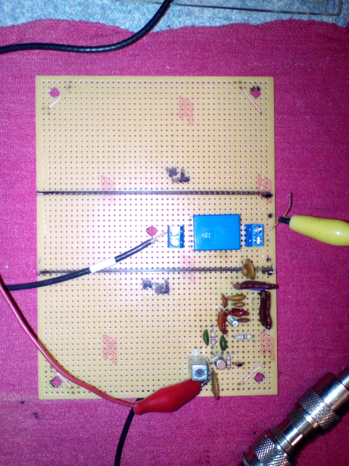

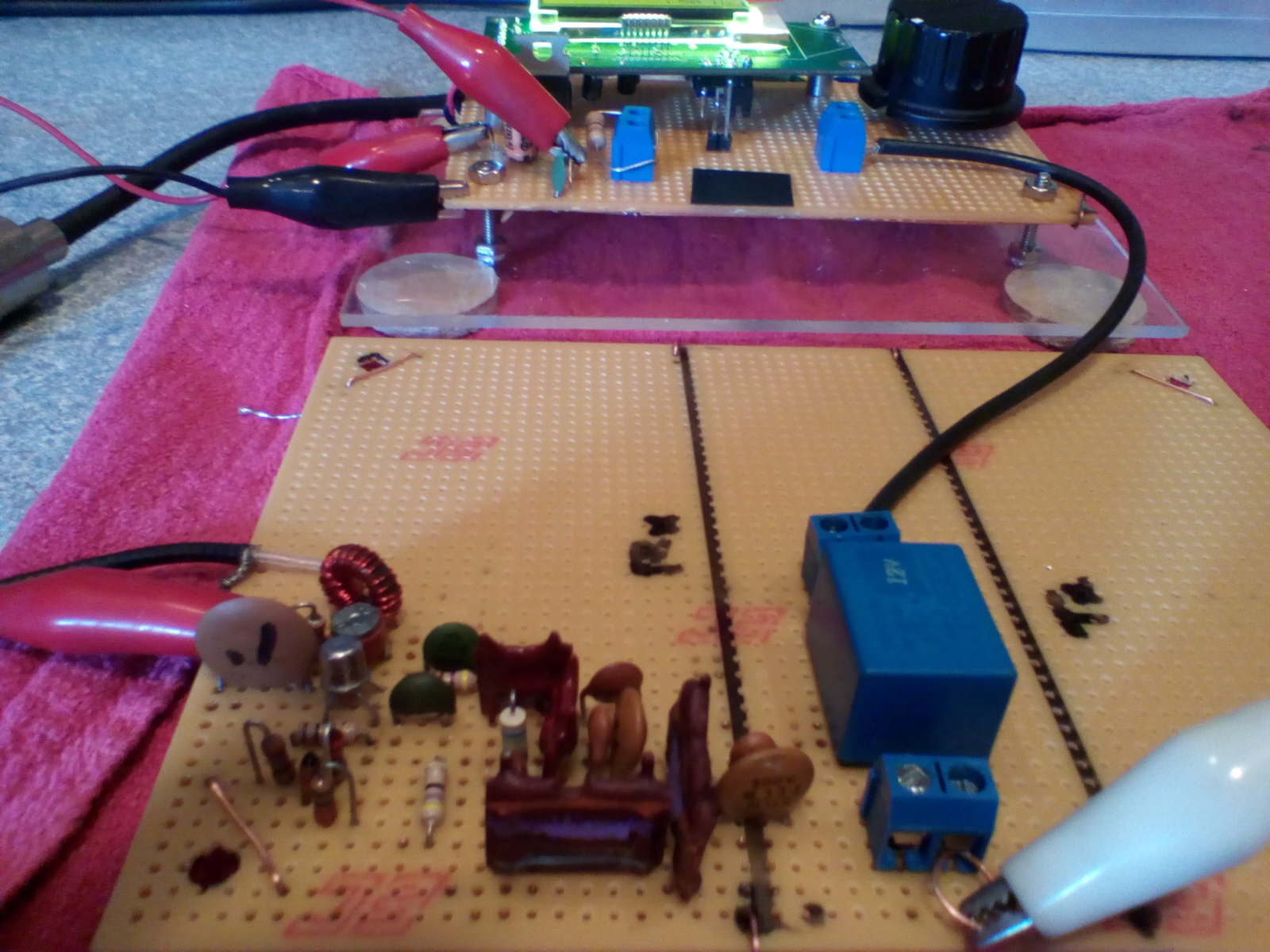

The mosfet mixer moved to the active board - left a bit of room in the corner for better matching into it and / or an RF amp. Listening to 75 meters with a piece of wire; 10.7 MHz IF; high side injection, same wideband input filter, sidebands flipped.
The "prototype" was wack job on a piece of scrap, worked fine right off the bat, moved it to the main board, tried to make a neat, compact, layout - took three tries in as many hours to make it stable. Go figure .....
When I'm sure it's right enough, I'll change out the transformer to a 45 MHz LC load, and try again at 45 MHz IF.

I got some copper clad board, and I'm going to try again, deadbugging a single band upconverter, to a 45 MHz IF, on the copper side, and just forget about general coverage. This noise maker will never be suitable for general coverage. At this point, I don't have much confidence it will be suitable for a single band with a VHF IF .
The existing board can be converted over to a conventional single band PLL LO, bandpass front end, with a 10.7 MHz IF. Maybe a ring mixer. So, two paths to the same end, being built in parallel.

Fellas ... we have up conversion to 45 MHz.
The first iteration of the deadbug was just terrible - it was still one of the hottest, non selective, FM BCB receivers I've ever run across.
When all else has failed, miserably, do arithmetic .....
It appears the fundamental problem was the SBL-1 was being overdriven. After nearly ripping my hair out, I finally decided there was a pretty good chance the output of the Si5351 was about +13 dBm, where the SBL-1 wants to see + 7dBm at it's LO port, so I rigged up a 6 dB attenuator, and, like that, the FM breakthrough was gone. I thought I had drive level issues eliminated with my craphouse pot attenuator, but apparently not.
Still early days, but things are at least looking up. It seems to be about 10 dB more sensitive with a 10.7 MHz IF, but that may be an artifact of my FT-950 "IF" being less sensitive at 45 MHz. Right now I have it parked on 1.23 MHz listening to a ball game, with no interference from the image of that 100 KW FM station, 45 MHz IF, simple 3 pole low pass filter at 30 MHz, non selective antenna.
Interestingly, the 40673 must have been pretty severely overdriven as well, but behaves better in spite of it. I would have expected the opposite. Perhaps that is why I had such a tough time stabilizing it.
I plan to move forward with both mixers - think I'll put about 9-12 dB attenuation on the LO gate of the 40673 and see where that goes.

The MOSFET mixer at 45 MHz.
12 dB attenuation on the LO gate; general coverage front end filter; 25 ish foot random wire antenna; 45 MHz L/C single tuned circuit; taking the output with a couple of turns on the main coil. I get a smooth peak at 45 MHz with this coil / cap / link combination.
Sensitivity seems adequate for now - running the FT-950 straight through, the background noise comes up when I clip the untuned wire to the antenna input.
Do I still need to follow the output with a xtal filter, or will the single tuned circuit be sufficient selectivity to go to the next IF? I haven't thought much on the second IF - I have 10.7, 9, and 455 as options. I'd lost confidence in actually getting to this point.
9 could go straight into the Mizhuo board, so that is probably the easiest choice.

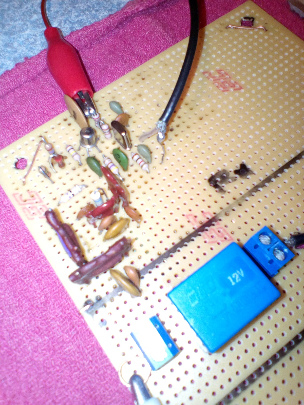

And another variation of the MOSFET mixer, this time with the 45 Mhz xtal filter as the load.
Earlier in the day I had a 45 MHz IF amp running, but the footprint was bigger than I wanted with the filter and all the coils, so I ripped everything back out to try to simplify it a bit, and shrink the size.
I don't think I need the high pass filter, so at some point that will probably come out.

I think I've learned more about the MOSFET mixer than I planned.
The L/C load has better conversion gain, than the xtal filter load. I've not matched the filter perfectly - I'm using the ECS-45-K20A which calls for 910R/2.5 pF, and the closest I have is 1K and 3 pF. I like the simplicity of just using the filter as a load.
Wow - just heard a VK on 20 with the 40673 as the front end ....
Anyway, I pulled the attenuator back out - the impedance of the LO gate is so high that the Si5351 can't put any appreciable power into it. The conversion gain is greatly influenced by the LO voltage, so to a point, more is better. The scrap mixer I made last weekend worked well, and used a tuned circuit on the LO gate. I was trying to get rid of the harmonic snarf from the Si5351, but in hindsight the beneficial effect of this was probably that the link coupling into the L/C circuit likely boosted the LO drive voltage into the MOSFET.
The LO drive level does not seem to affect noise performance.

I got interested in the current in the transistor, because there are still about six spots where I get FM breakthrough with the MOSFET that I can't seem to resolve. Other than that, I'm pretty satisfied with it at this point. I think it's working the way it is supposed to. Now I'm wondering about that xmtr site.
Win W5JAG
I haven't fooled any with the RF input port.
The RF to LO port isolation .... I think is OK enough. I set my SteppIR to bi-directional, and walked around in front of and in back of the antenna with a receiver tuned to the LO, and could hear the LO quite easily, but it nulled when I rotated the portable antenna horizontal, so I don't think the LO is coming back out the antenna.
Alarmingly, I heard a bunch of strong FM broadcast stations between 60 and 85 MHz on my Icom IC-R3, which is not a great receiver, but not a POS, either. There is a big cell site / pubic service transmitter site a couple of hundred yards away ( they like this hill for the same reason I do ) and I'm wondering if they have a transmitter there spewing crap.
The standing current in the MOSFET looks to be somewhat critical. The cookbook value is 470R in the source, with a bypass of 0.01 uF. I found that more current increases conversion gain and noise, but after a point, just noise that can completely swamp weak signals. I wound up putting in a 1K trim pot to try to get the optimal point. I'm using a genuine RCA 40673, and for this transistor, it's about 1.2 ma. Mixers farther from the antenna might benefit from more current, where low noise is not that important.
