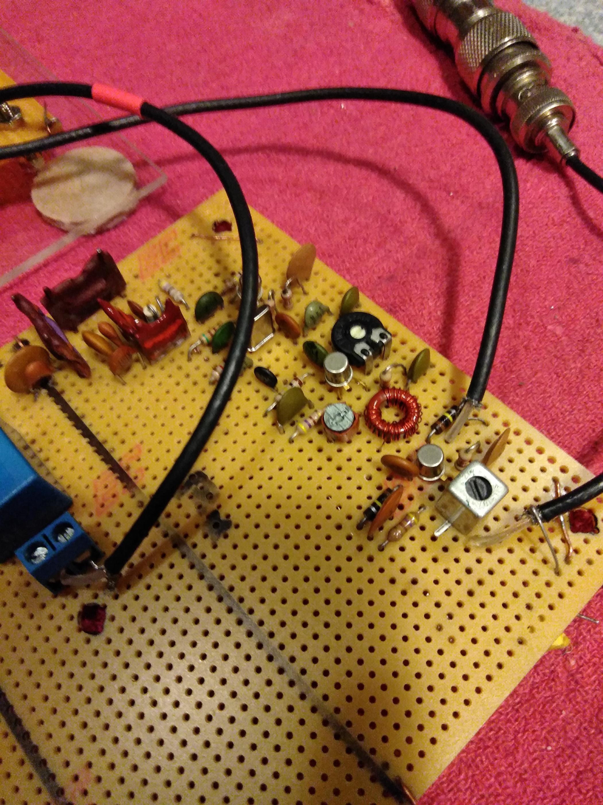

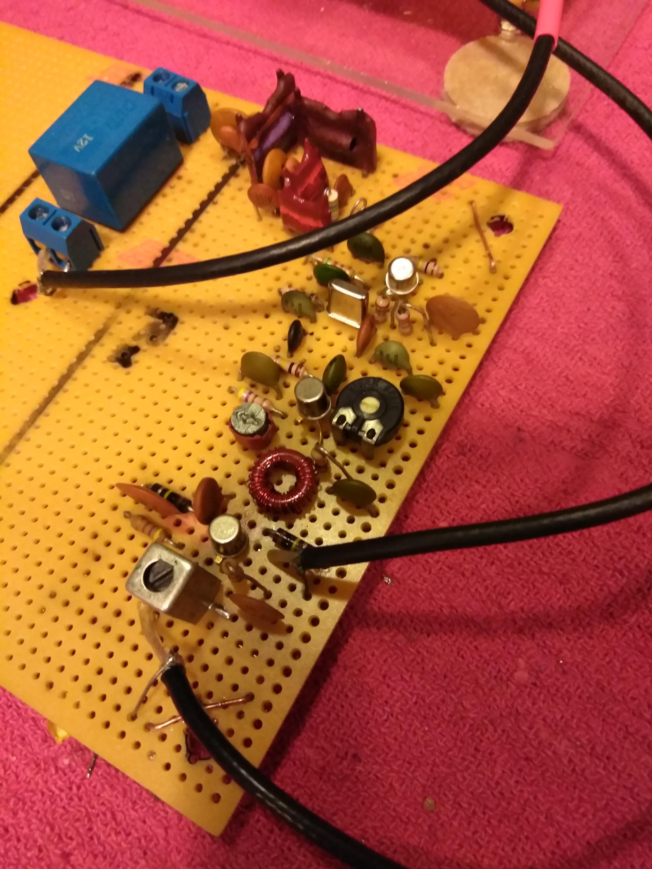

The MOSFET board again. 45 MHz MOSFET amplifier; MOSFET Mixer to 9 MHz. Pot is for gain control since I don't yet have an AGC line. Might replace the LC tuned circuit with another 45 MHz xtal filter. Easy to switch stuff around - the only difference between an amp and a mixer is that in a mixer, there is an extra bias resistor on gate 2, and gate 2 takes the LO through a cap. For an amp, gate 2 is at AC ground through a cap, and bias is a bit different.
Blah, blah, and blah.
Took a lightning strike last night. Haven't heard that big a boom since one of the big trees in the yard took a lightning strike - went down the tree, hopped out over to the ham radio antenna on the Pontiac GTO ( Holden Monaro ) parked next to it, went all through the Monaro, blew out the front wheel ABS to ground. As in, literally, blew out. Six months of consultation with Australia and the Monaro ran again. Traded it on the Pontiac G8 ( Holden VE Commodore ). Never killed the tree, but the lightning skunk stripe down the side of it is visible to this day.
Didn't kill the G8 this time. Killed a cable modem in the house proper and knocked some stuff off line. The garage door ( on the regular house AC ) - opened and then killed the motor.
Appears to have wreaked havoc on my radio room, tripped the breakers on the 220 line I ran to it. Apparently everything fried in a perverse cascading sequence protecting the breakers until the last moment. The surge protector that all the high $$ SteppIr control circuitry was hooked into is fried. SteppIR control box appears fried. Hopefully the motors aren't fried. Interestingly the homebrew 2 meter rig hooked to the antenna on top of the tower appears to be just fine. Score one for DIY. Visually, the antennas look fine.
The MOSFET board may or may not be fried - the FT-950 was hooked to the other end of it as the 9 MHz IF. The SteppIR was hooked to the antenna end of it. It looks OK, but the FT-950 is - you guessed it - FRIED. The radio appears to have fried, thoughtfully protecting the twenty five cent fuses in it's power line. The power supply feeding it is fried. The AL-811 amp seems OK. Haven't checked any of the test equipment, except for my audio signal generator, it's all junky last century tube stuff so hopefully survived. Hopefully the DHT SSE survived.

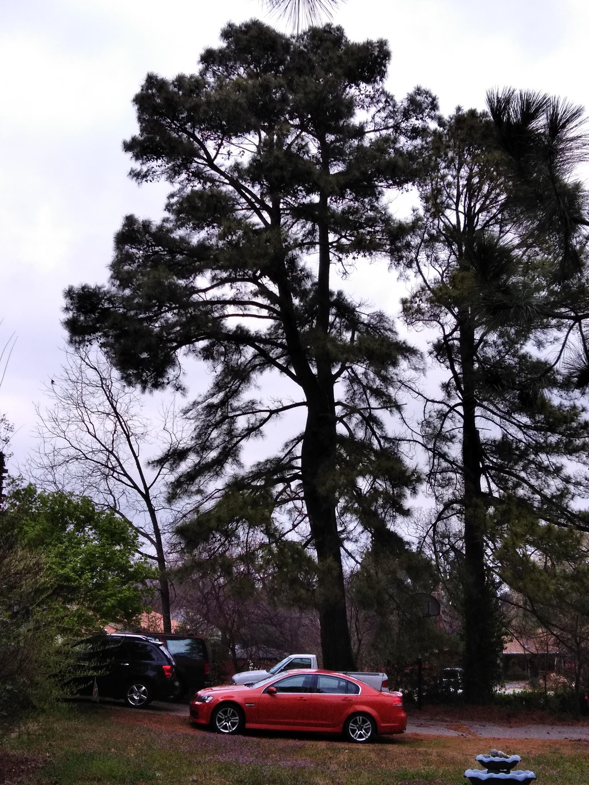

The fork tailed devil in the first picture appears to be the lightning rod. Again. It would be even taller, but for an ice storm about 15 years ago that took about twenty feet off the top. My primary antenna system at this house is modest by anyone's standards - small Glen Martin roof tower, two element SteppIR ( three on six ), modest 3 dB gain fiberglass vhf/uhf vertical about eight feet above the tower top. On this hill, I don't need much. The backup system is even more modest. Neither is a lightning attraction.

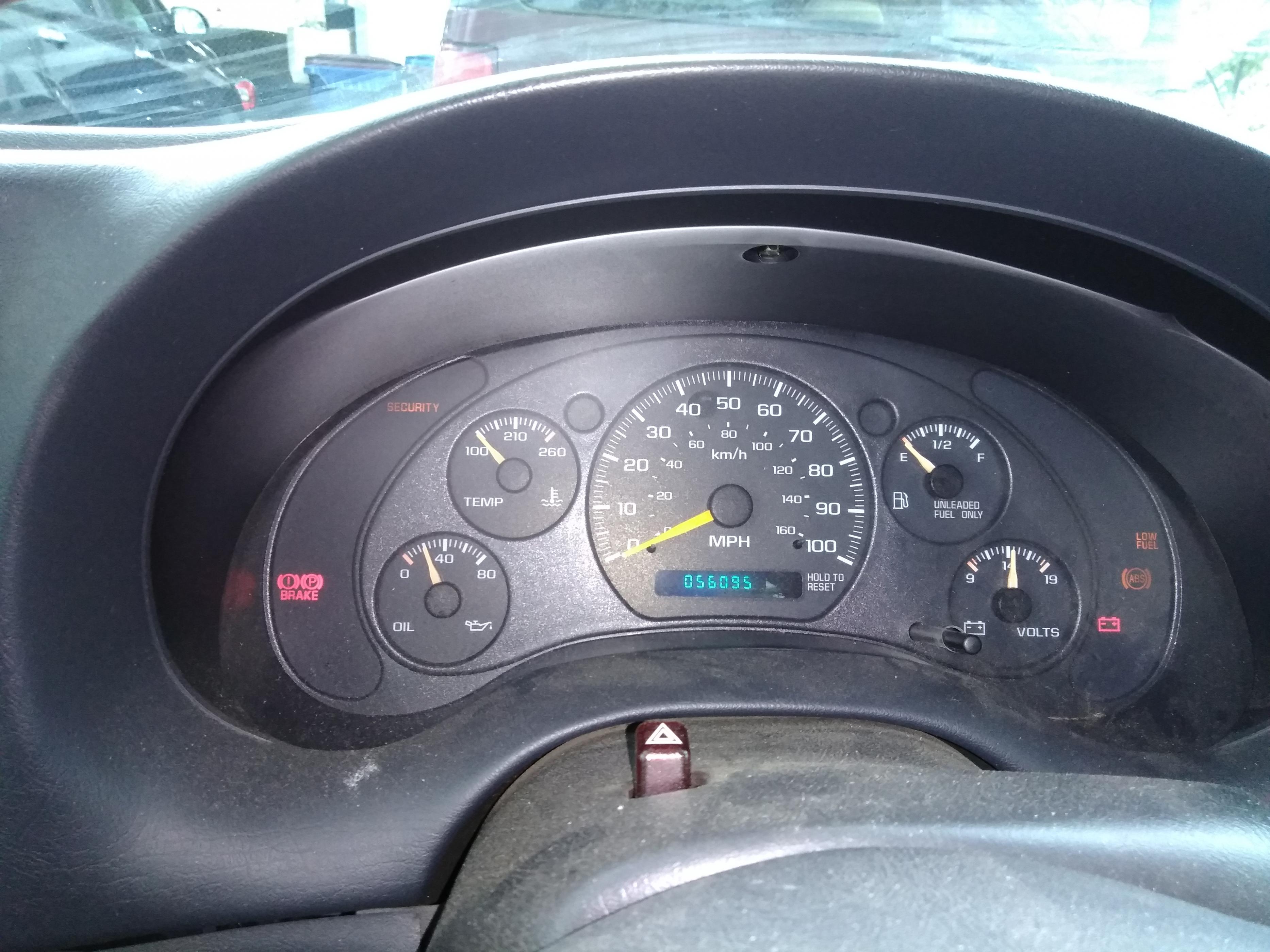

...The alternator flag I'm not sure of. The volt gauge is working, but won't go above 14.5 volts. The system is charging at least some, because I've loaded it enough to kill the battery if it weren't....
Modern charging systems mostly won't go far over 14V, because that annoys modern no-maintenance batteries. I'd call 14.5V plenty high. My Honda rarely goes past 13.1V. (It is obsessed about avoiding the part-horsepower needed to full-charge the battery.)
But with the rest of the troubles, and the history, I'd gingerly take the truck to the crusher. Not even save the seatcovers or manual.
One new glitch noted with the truck - the DRL system is not functioning, instead of DRL activation, it goes to full lights on at all four corners.
It goes through the correct ABS self test cycle, but locks up a wheel failing the test. The ABS flag is real.
The charging system is fine - on cold startup this morning, it went up to 15.1 volts to quickly recharge the battery, then settled to a normal 14.1 ish. This is nominal behavior for this system. The alternator flag is false.
Wait, .... what ? With only 56,000 miles on it? How often do you find something that can survive multiple instances of being driven like it was stolen, AND a mega jolt from the heavens? No. Just no. I've seen FUBAR or near FUBAR on a lightning hit car. This isn't it .....
Haven't put my code reader on it yet, but this looks to be very minor damage. All I've done so far is reset the security system ( which the BCM took ) so I could start it and drive it and see what else was wrong. I didn't disconnect the battery at that time to do a system reset because it wouldn't fix that particular problem - the security info is in non volatile memory.
A battery disconnect to reset the bcm might fix it all, if not, possibly some cheap sensors, maybe just fuses or fusible links, worst case scenario possibly a replacement BCM.
.... But with the rest of the troubles, and the history, I'd gingerly take the truck to the crusher. Not even save the seatcovers or manual.

The MOSFET board lives, but performance may be degraded. Everything connected to either end of it is dead.

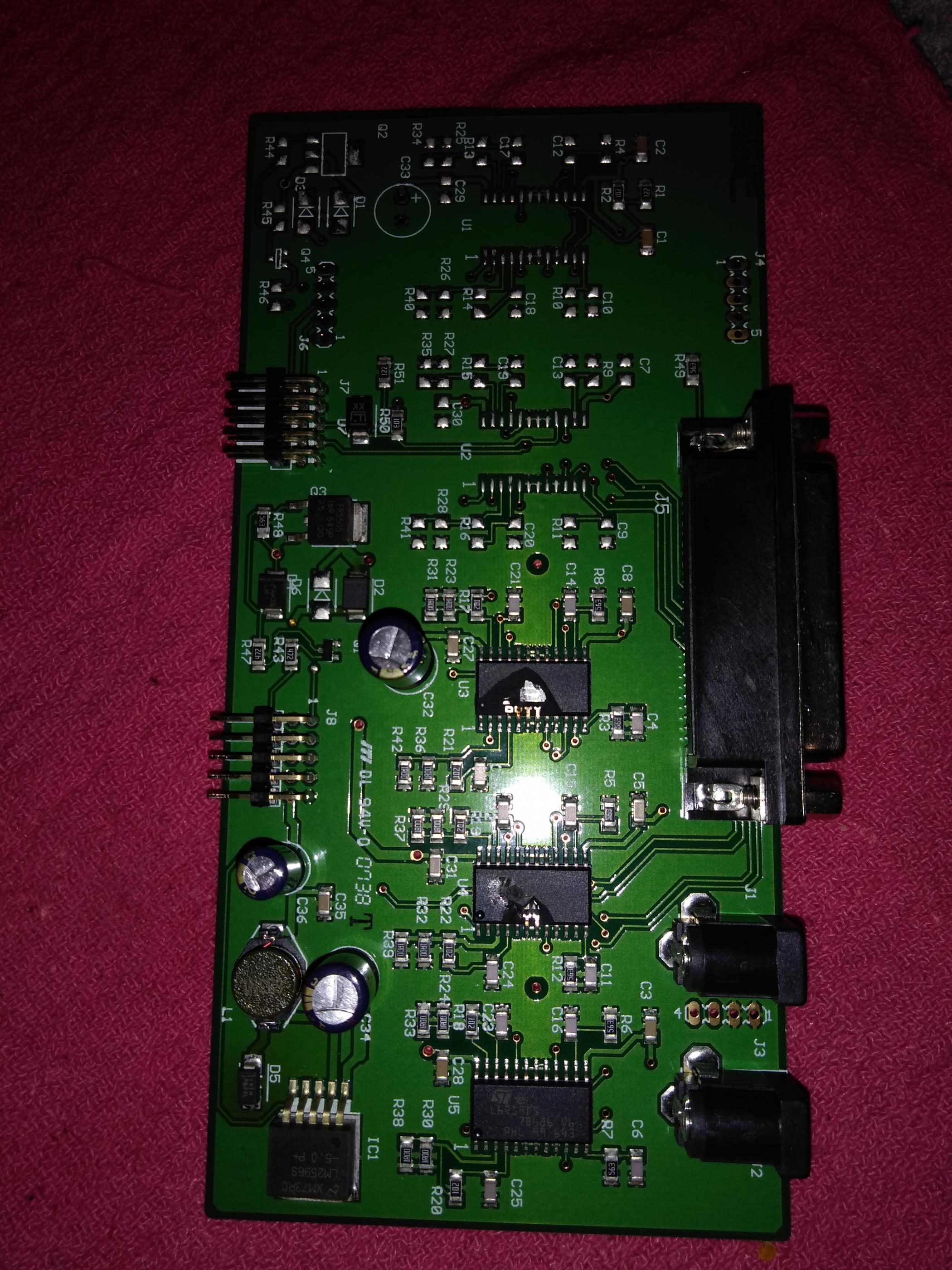

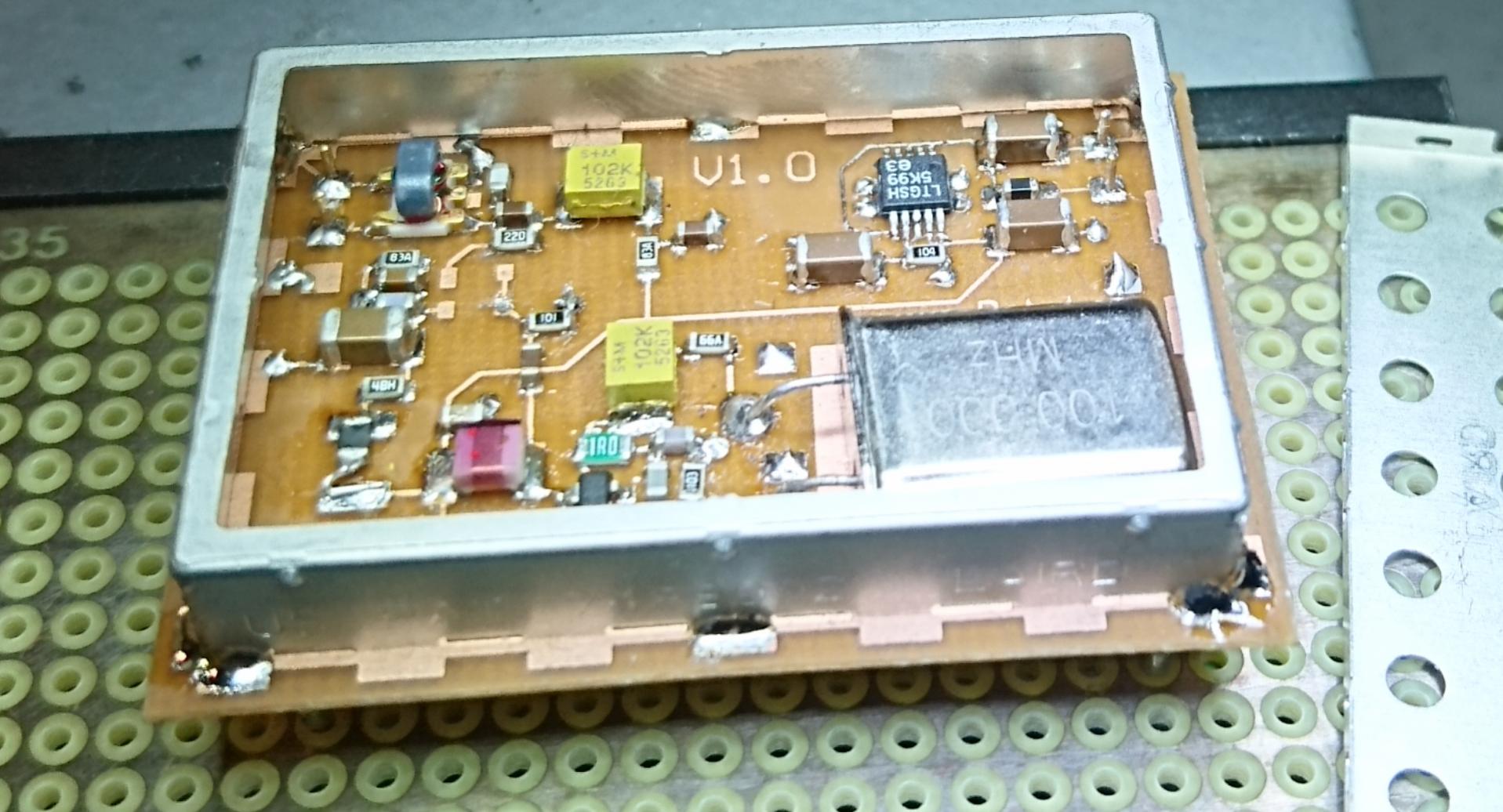

I worked some on the FT-950 last night. Found an open diode in the power control circuitry - wired in a substitute for testing. One or more parts downstream from the diode immediately let out more stink, they are apparently too small to smoke .....
The cratered board is out of the SteppIr controller.

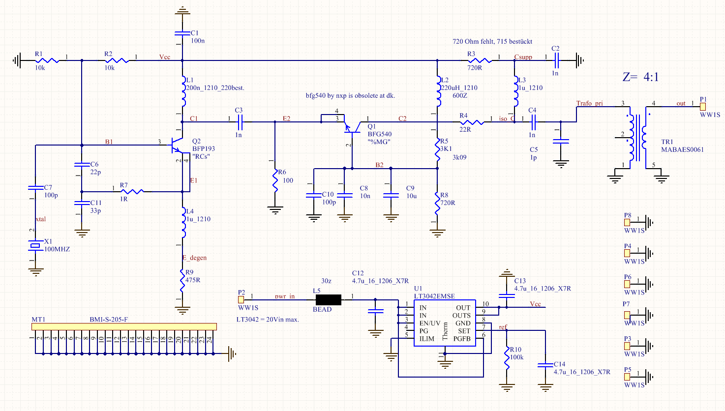

There are other interesting transformers from Pulse and MAcom, .... Quite cheap. CX2147, cx2049, cx2074nl, cx2156, maba009594, mabact0059, mabaes0060, mabaes0061, cx2032nl e.a.
All SMD / SMT.
The SteppIR situation looks to be somewhat expensive, so I am considering getting equipped up for SMD to just repair that blasted board, since everything is going SMD anyway. If I'm going to be dragged into this century, might as well go all the way.
In the meantime, I'm reading Dr. Rohde's first edition book, which is pretty dated - it illustrates dual gate FET mixers! So, it's good for me ....
It looks like CoilCraft has some through hole RF transformers in 1:1 and 4:1, that are pretty reasonable in price, especially in the 1:1 xfmr. Mouser is carrying them. Has anyone used them, or am I going to be the first?

The coil craft transformers are inside just like the SMD ones, it's just that
the box is bigger. The originals are probably made by Mini Circuits, we used them
already 40 years ago.

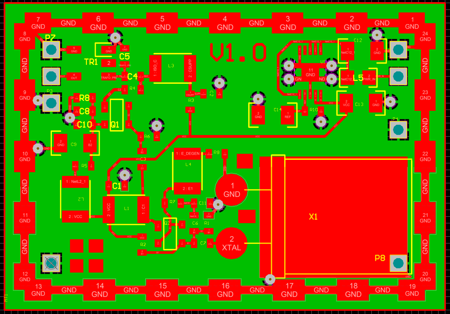

Make the switch to SMD! You need a microscope anyway, even when your vision
is still better than mine. It is so much faster and easier.
I do all my boards on double sided expoxy. The bottom side is usually only GND.
I print the layout to foil on the laser printer and then do a contact copy to
pre-sensitized FR-4. The boards are as good as the laser printer. MSOP-10 is
no problem.
