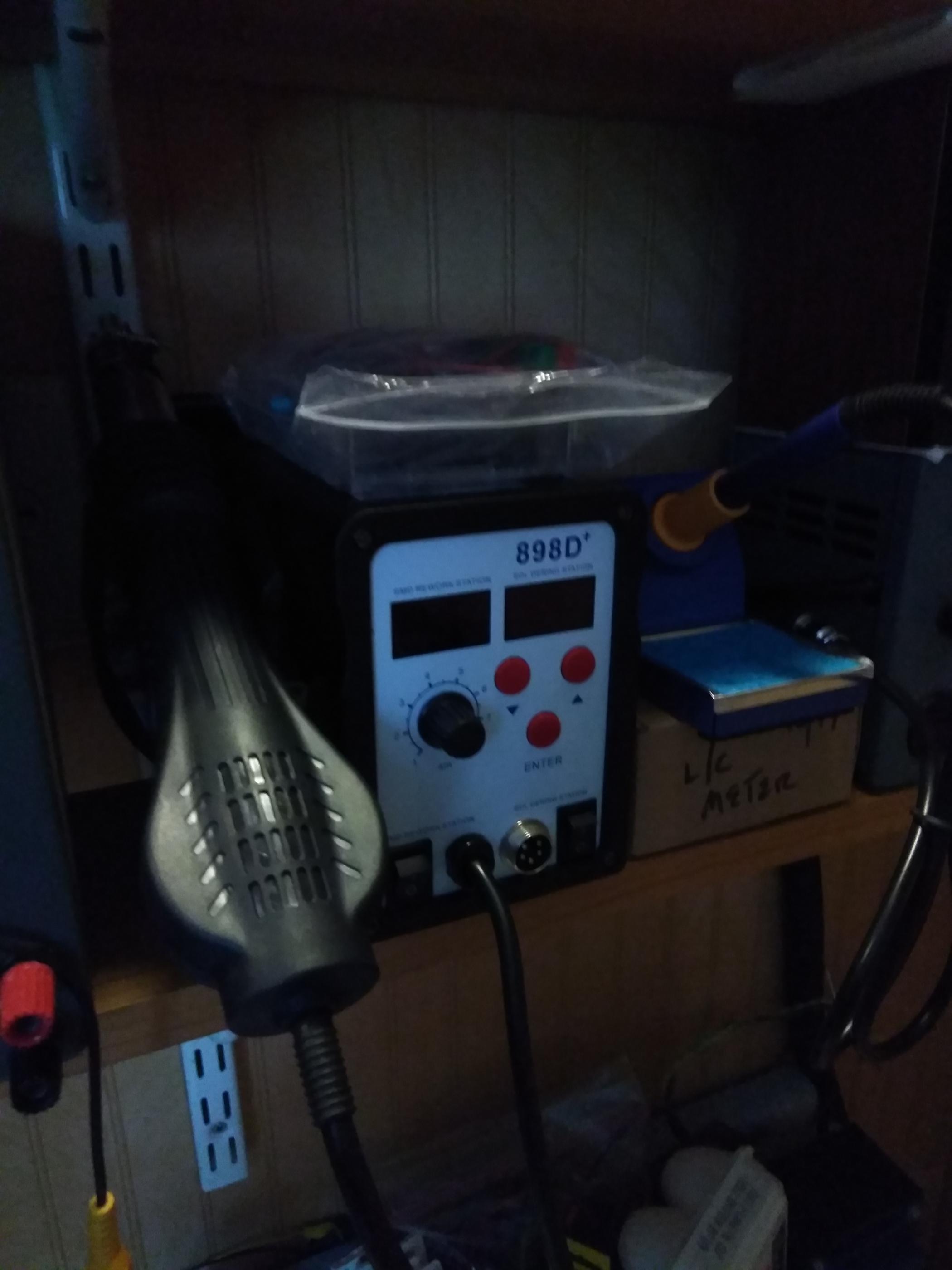

The SMD hot air thing doesn't even have a brand name, however, it works well - it has already removed those lightning blasted driver chips off the SteppIr board, as well as an RCA 40673 I found on a board from about thirty years ago, and some 3N202's and IF transformers from another board. I haven't tried the soldering iron - it came with some surprisingly fine point tips.

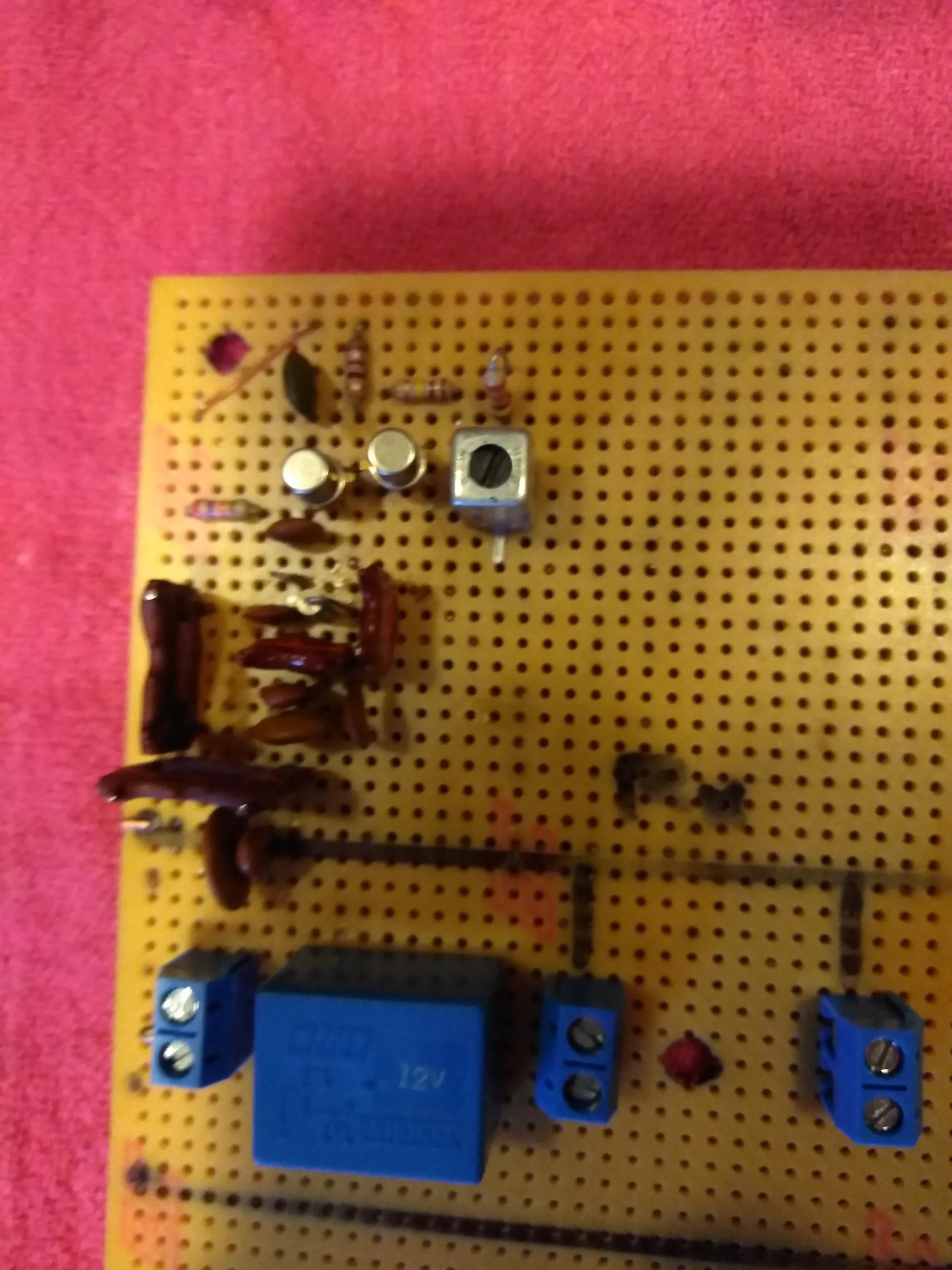

Moving away from zombie parts, here is 2N3823 JFET times two in a cascode configuration. I bumped into this circuit here:
http://kd1jv.qrpradio.com/swbcrx/AMSWBC.HTM .
It is attributed to W7ZOI, but it is not described in "Introduction to Radio Frequency Design" which I belatedly discovered on my bookshelf, or "Solid State Design for the Radio Amateur". There is a lot of information on JFET mixers in the former.
The repair parts for the SteppIr are still in my Mouser shopping cart, and with the FT-950 still toast, my subjective point of reference is lost, so I can't say whether this is better, worse, or just a sideways move from the usual dual gate MOSFET mixer. It does work.
Some of the broadband transformers and other parts are starting to trickle in, so this may or may not be tinkered with further. The new scope should be here next week, that should help a lot.
Win W5JAG
