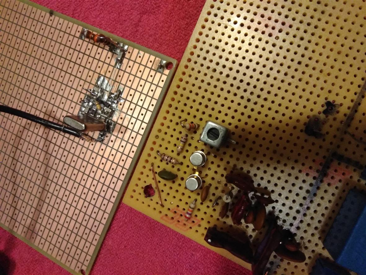

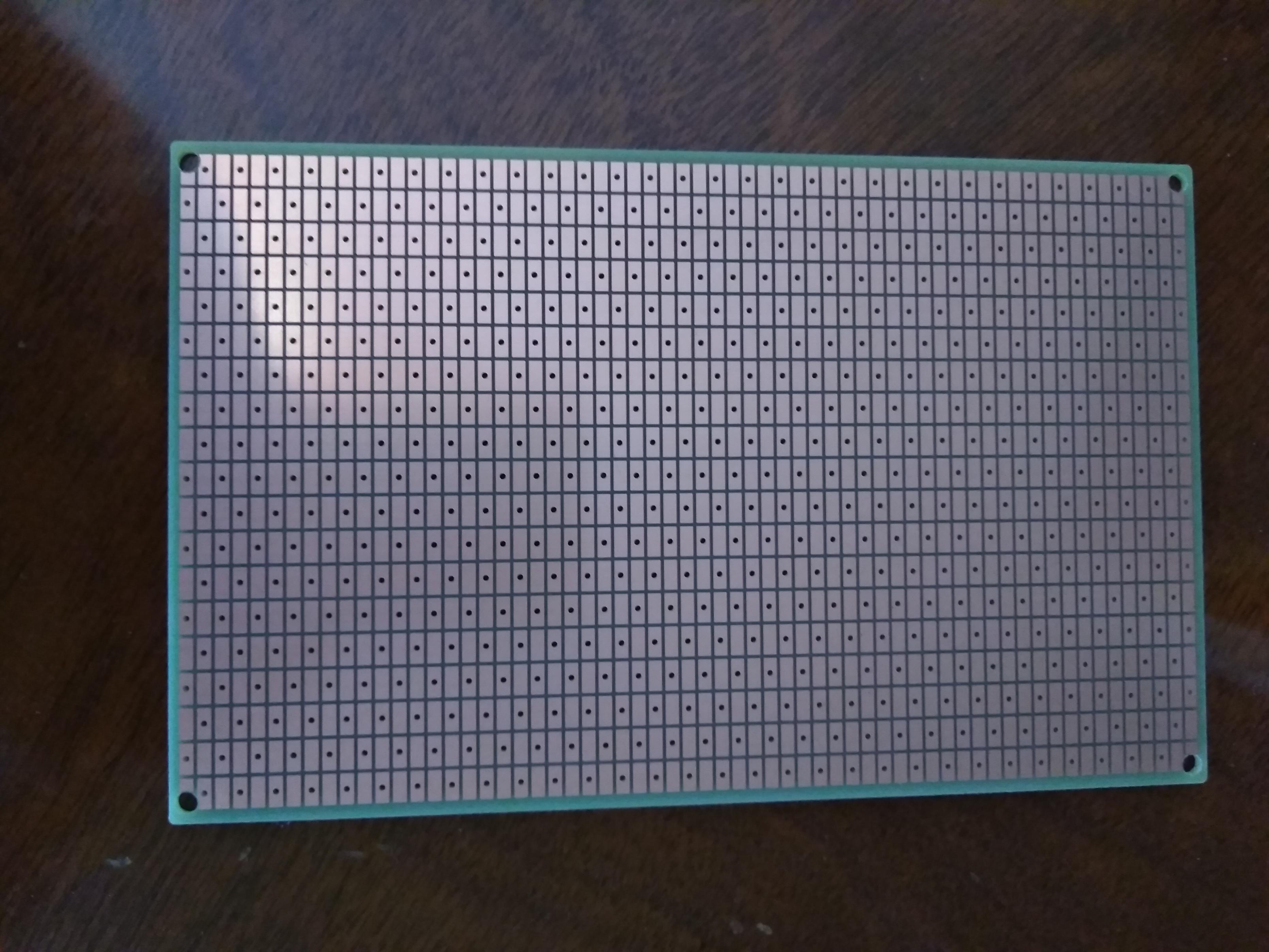

....Take a look at the bottom board in post #216. That is excellent
for RF work. You get a relatively ideal ground plane and attaching
components to GND takes just a solder blob on the top side.
The bottom layer is just square pads. There is also a deluxe
version with plated-through holes. That makes the pads stick better
to the board, but the cheap version is usually good enough.

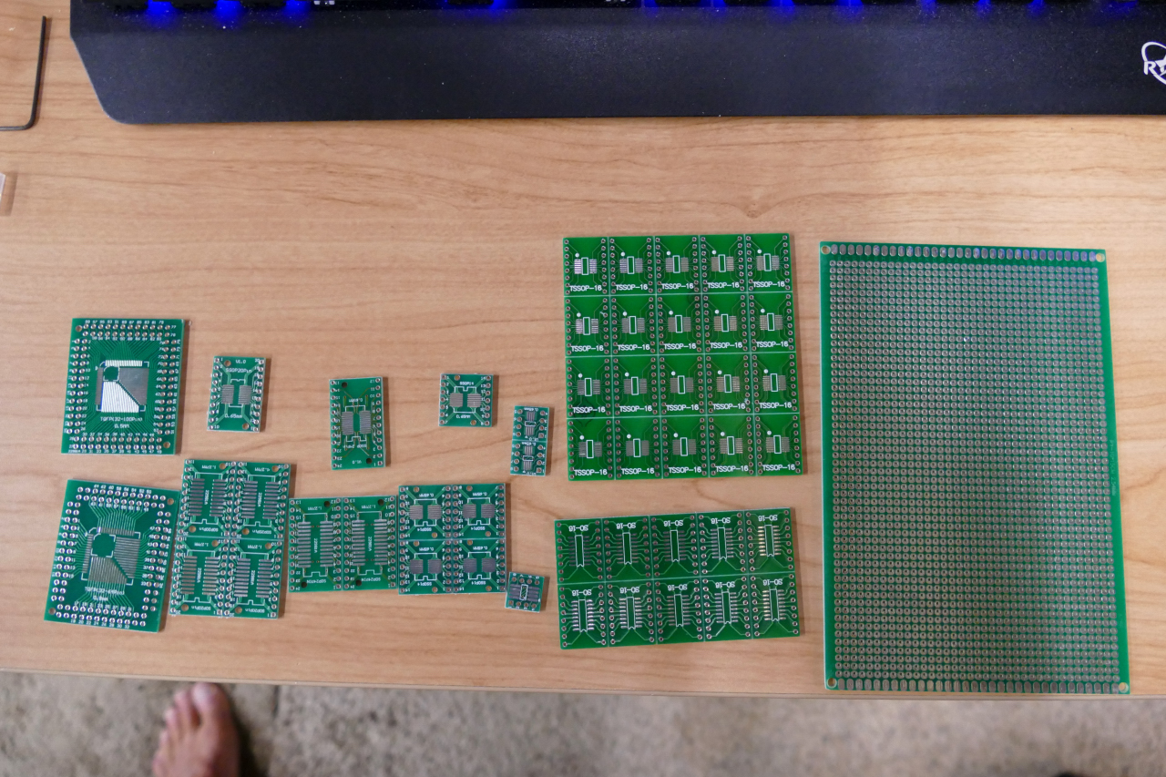

This was in the Mouser catalog, and is similar to what you are describing. The holes are not plated through, I felt it was more versatile if they are unplated.
This is the large size, almost identical to the piece of perf I have been using, with the largest pads. Since my SMD inventory is going to be thin for quite some time, I want to be able to use small through hole parts with the leads clipped short.
I'm going to straddle the SMD fence for a while. These are probably not suitable for GHz level RF work, but probably OK for IF and audio.
My immediate application is for an analog music synthesizer, mixing SMD and through hole parts. It will combine SMD and DIP IC's with mostly leaded discrete parts and even a few vacuum tubes.
These SMD chip adapters come from Amazon as does the perf proto board.
The adapters have a SOIC pattern on one side and a SSOP patern on the other side. There are even QFP adapters with two different lead pitch. Each terminated in a row of holes on 0.1 inch centers for use with the perf board, or your favorite white plug in breadboard.
McIgIcM 30pcs PCB Board Kit SMD Turn To DIP Adapter Converter Plate FQFP 32 44 64 80 100 HTQFP QFN48 SOP SSOP TSSOP 8 14 16 20 28: Amazon.com: Industrial & Scientific
50pcs Top Quality Double Sided Circuit SMD PCB Convertion Board Module for TSSOP16 MSOP16 to In-line: Amazon.com: Industrial & Scientific
Uxcell a14062100ux0248 15 Piece SMD SOP24 SSOP24 TSSOP24 0.65 mm/1.27 mm to DIP 2.54 mm PCB Board Adapter: Amazon.com: Industrial & Scientific
Uxcell a16040500ux0190 3 Piece Double Sided Prototype Universal PCB Print Circuit Board 9 x 15 cm Green, 5.91" Width, 3.54" Length: Amazon.com: Industrial & Scientific

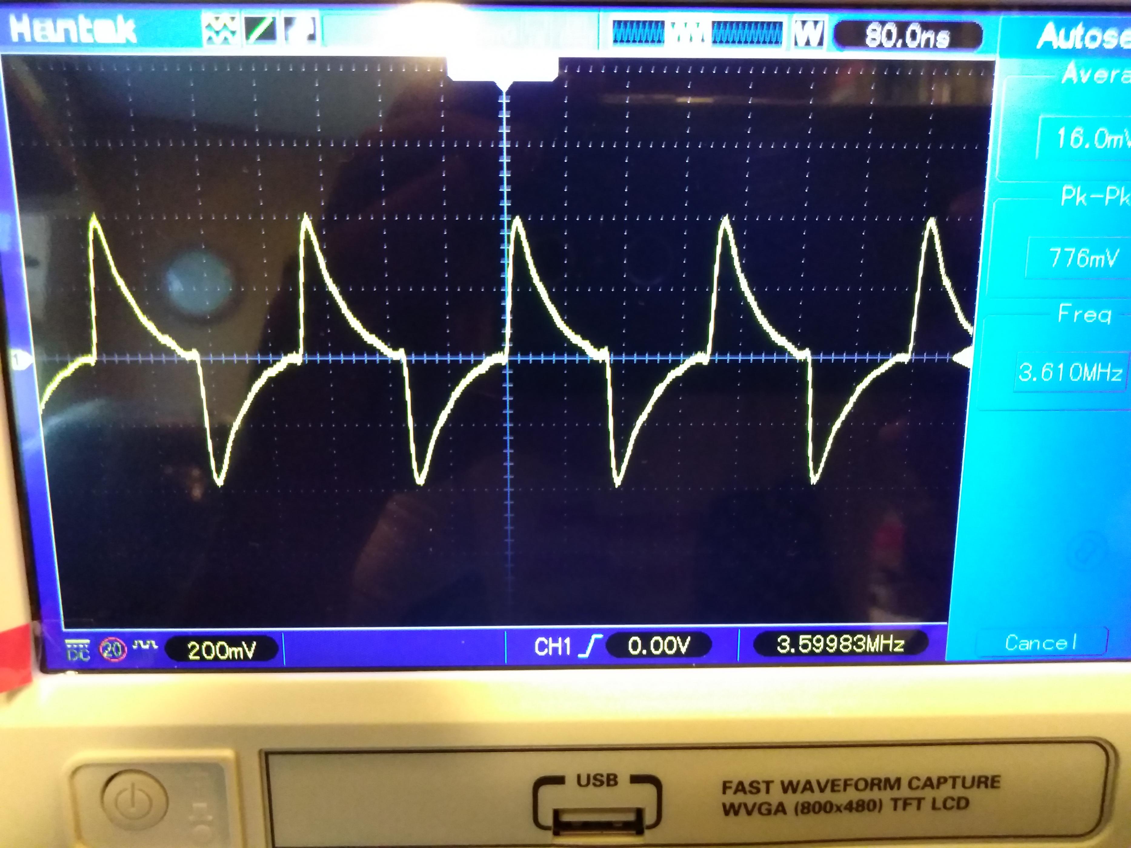

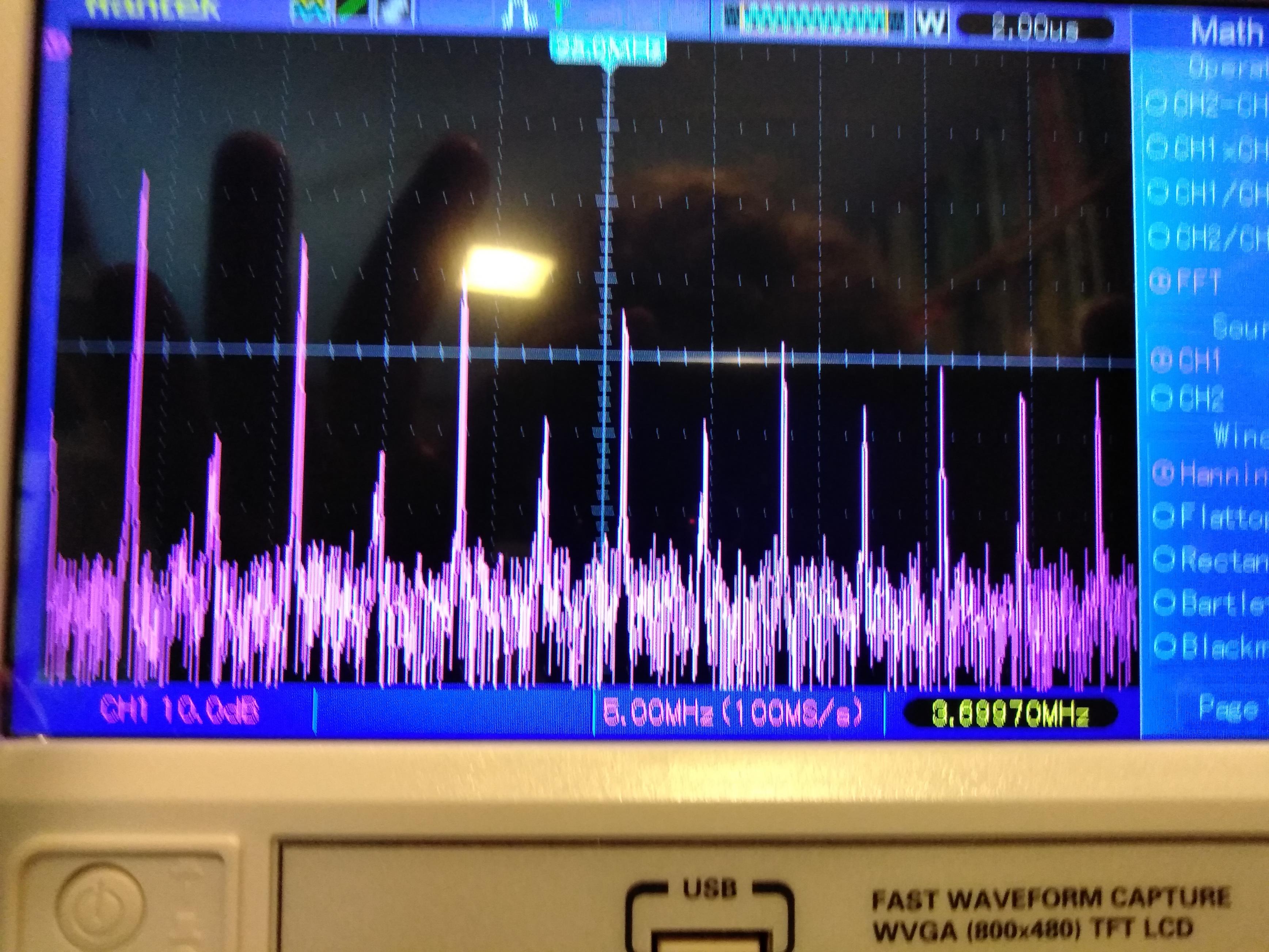

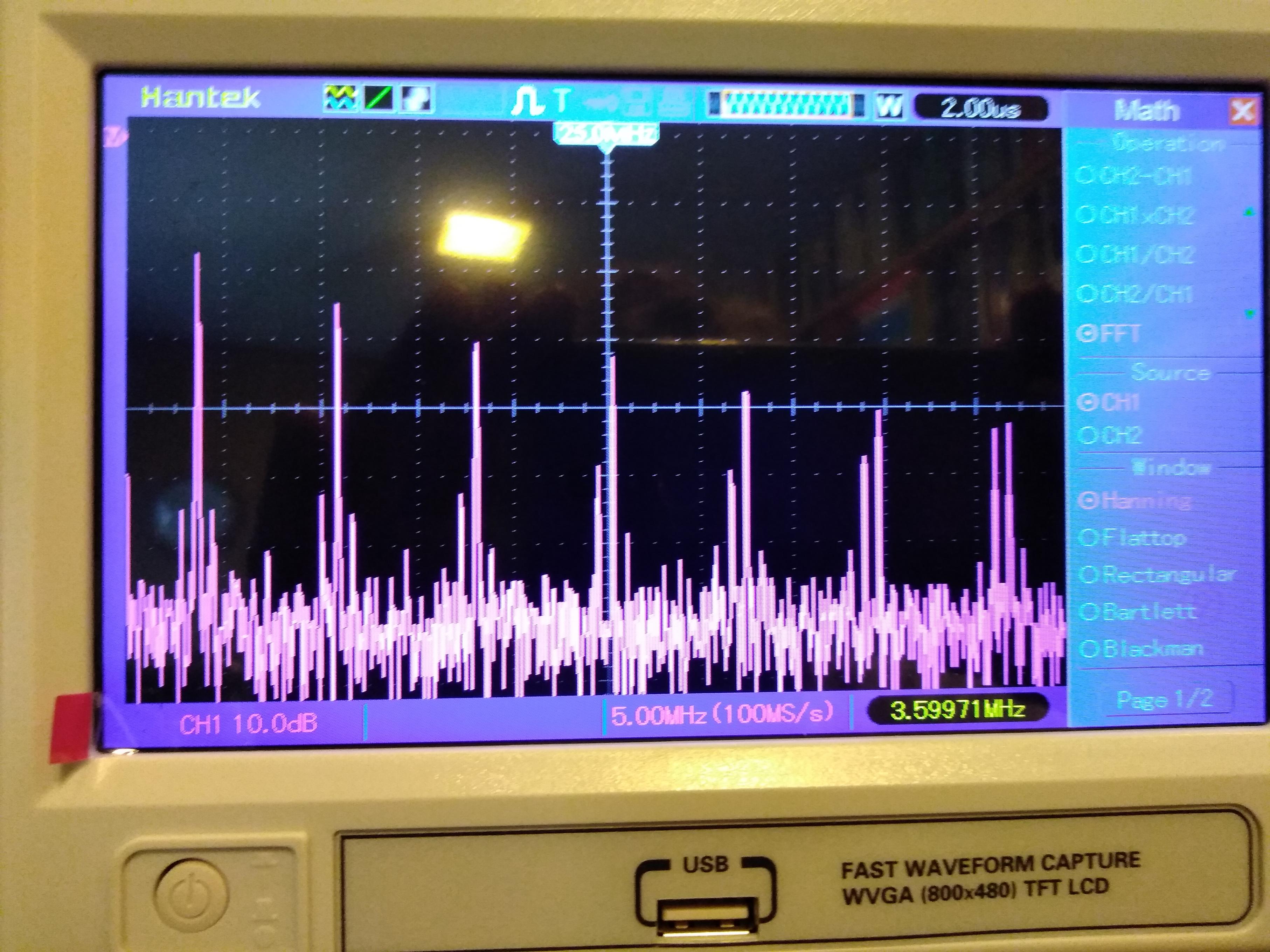

I didn't have a USB Stick, so these are just cheap cell phone shots of the Hantek screen.
These next few posts are some snapshots of the Si5351 output.
Each output has a fixed 10 dB 50 ohm attenuator ahead of the scope probe.
I reset the device before taking these pictures, so actual frequency will be off a bit as I did not recalibrate the crystal.
The first pic is the TUNABLE LO at 3.6000 MHz. The FIXED LO is set to 0 Hz, which should be OFF.
The second pic is the FFT of the tunable LO at the same frequency. Note the harmonic distribution, and the sidebands / spurs adjacent to the tunable LO and the harmonics.
The third pic is the FFT of the tunable LO shifted about 100 kc from the original frequency. Note the spurs have moved about 2.5 MHz from their original distribution. As the tunable LO is moved around, these sidebands / spurs also move around, including back and forth across the LO.
I observed this behavior up to about 12 Mhz or so. As frequency increases, the sawtooth wave transforms to more of a square wave, and eventually sine waves.

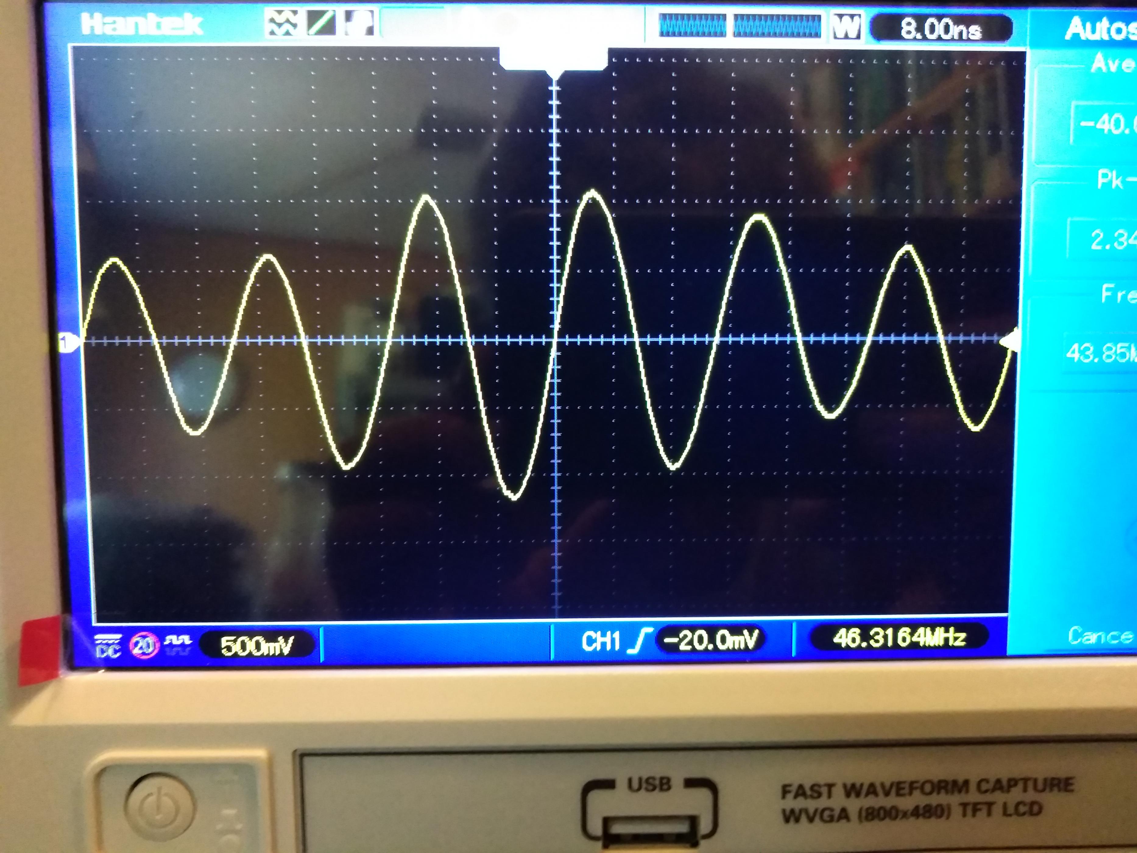

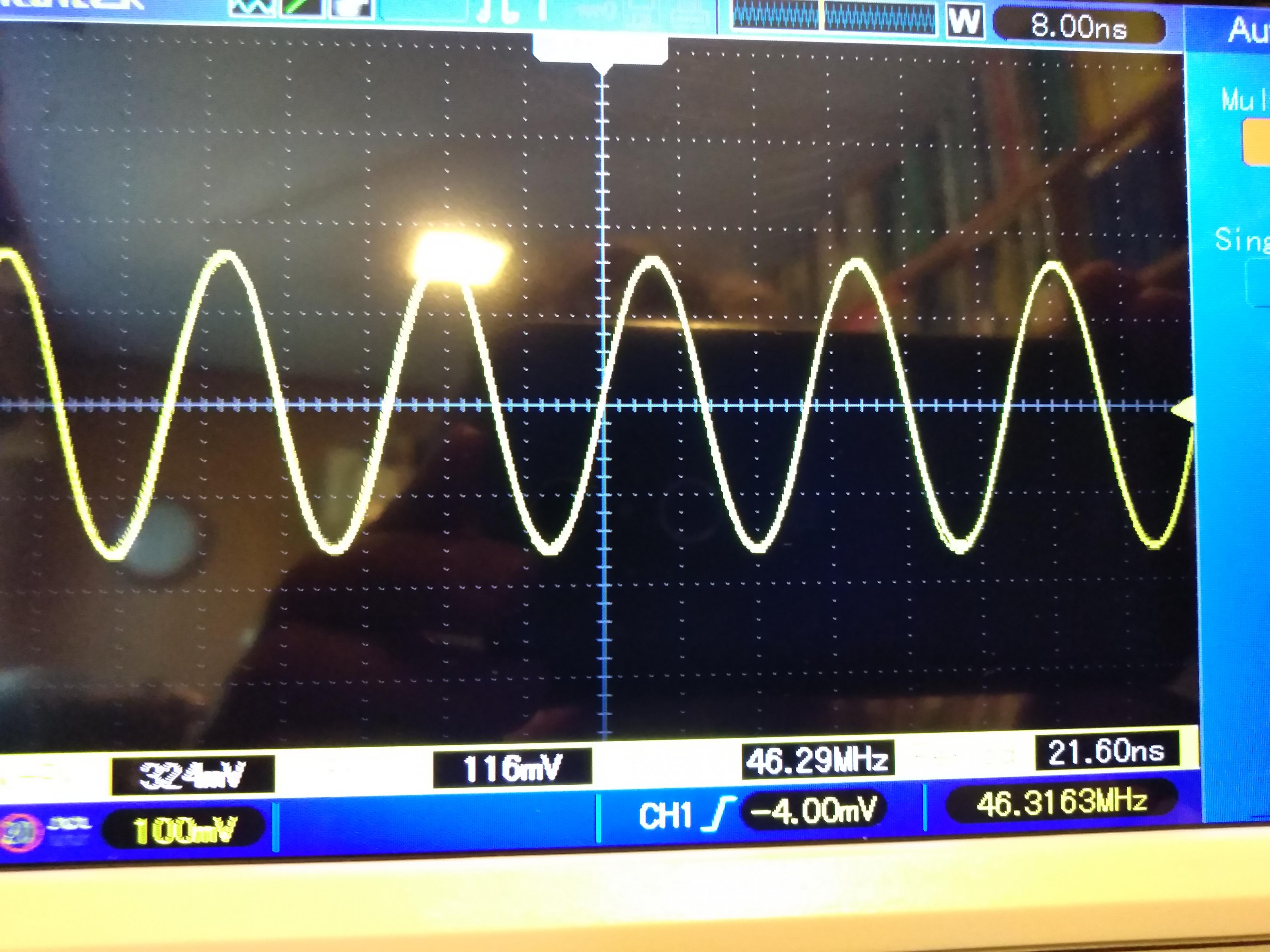

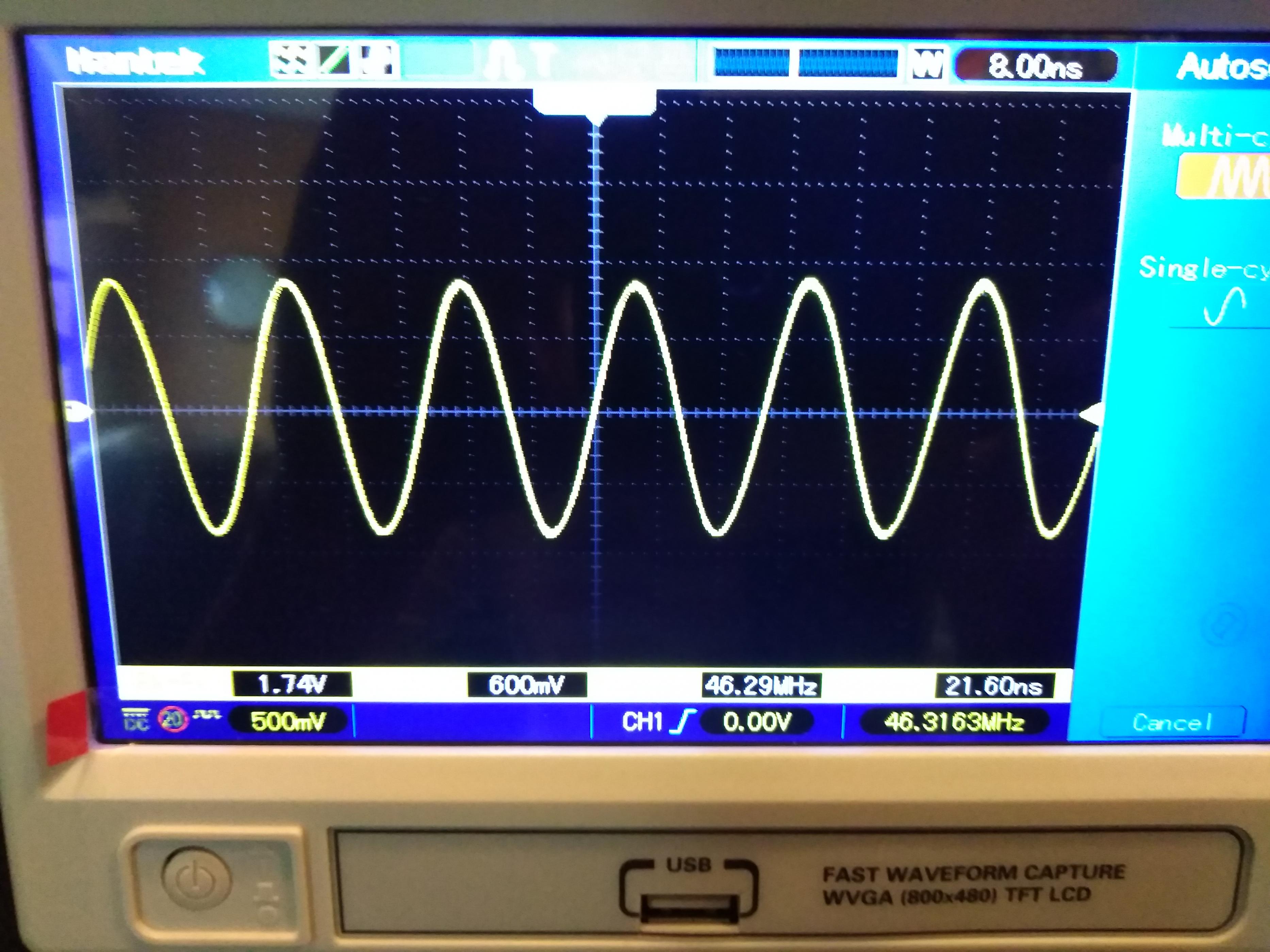

This series of shots is with the synthesizer set to produce a 45 Mhz IF output.
The LO is tuned to a local broadcast station at 1.32 MHz, the module is set to ADD the 45 MHz IF, so the tunable LO will be 1.32 Mhz + 45 Mhz = 46.32 MHz, differing only by the error in the uncalibrated reference crystal.
The FIXED LO is set to 0 Hz, which should be off.
The first pic is a clean 46 MHz sine wave.
The second pic is the FFT of the 46 MHz sine wave. Not world class, but looks good enough to me.
The third pic is the FIXED LO which is supposed to be turned off. WTH? The tunable LO is present on this output, and look at the amplitude - about 12 dB stronger than the actual tunable LO. Both of these track perfectly - change the tunable LO 1 kc, the fixed tracks it.

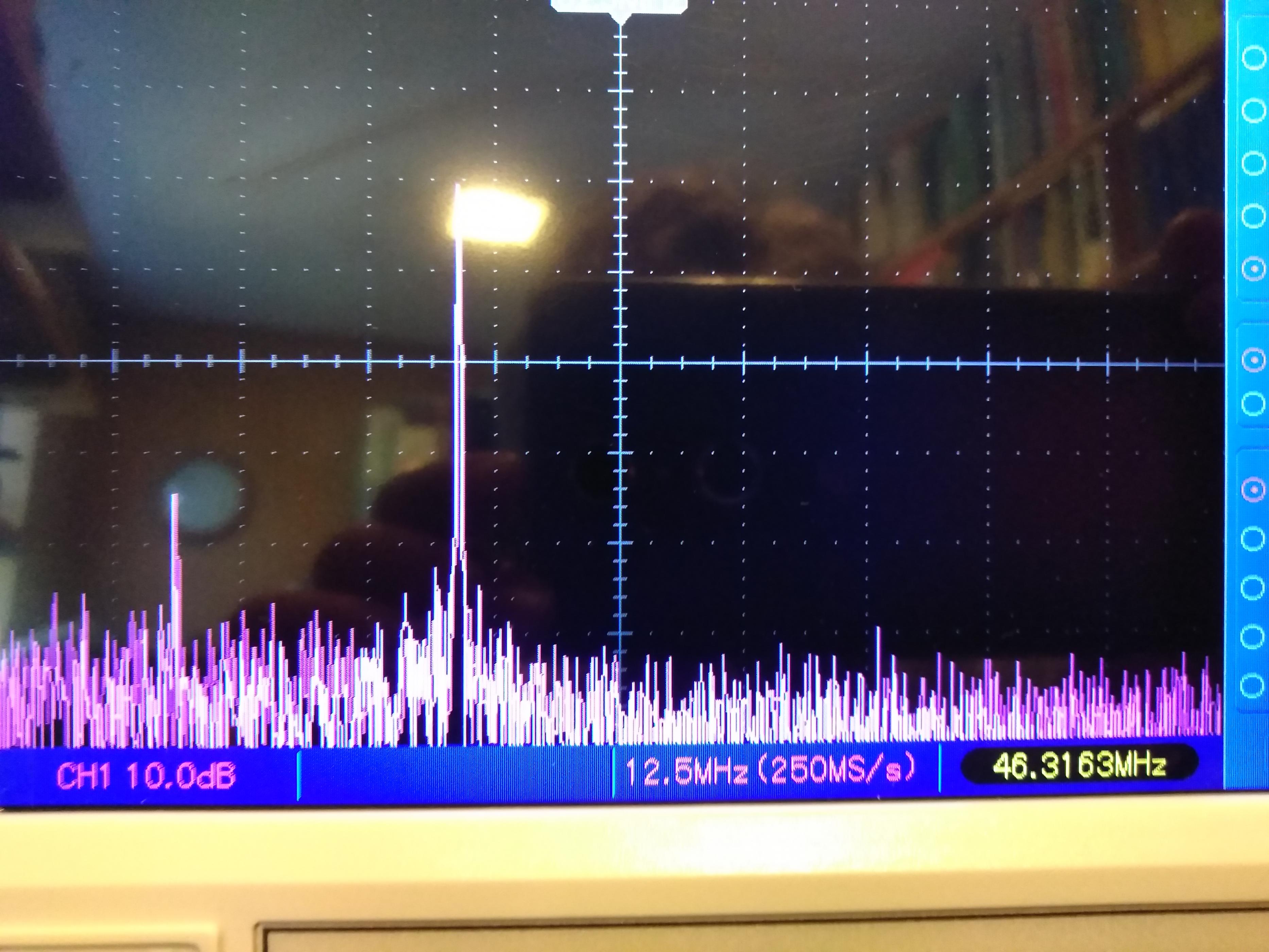

This series of shots is with the synthesizer set to produce a 45 Mhz first IF output, and the FIXED LO is set to 36 MHz to produce a 9 MHz second IF.
The first pic is with the scope on the output of the TUNABLE LO.
Note the scope clearly shows the presence of two sine wave frequencies. Note also that the scope is counting the FIXED LO frequency as the predominant frequency.
The second pic is the FFT of the TUNABLE LO with both outputs turned on. Note the FFT also shows the FIXED LO present at a stronger amplitude than the tunable LO, the increased noise floor, and other spurious signals. And this is just the first 50 dB or so. Who knows what other crap is below what can be seen with just 8 bits.
Win W5JAG

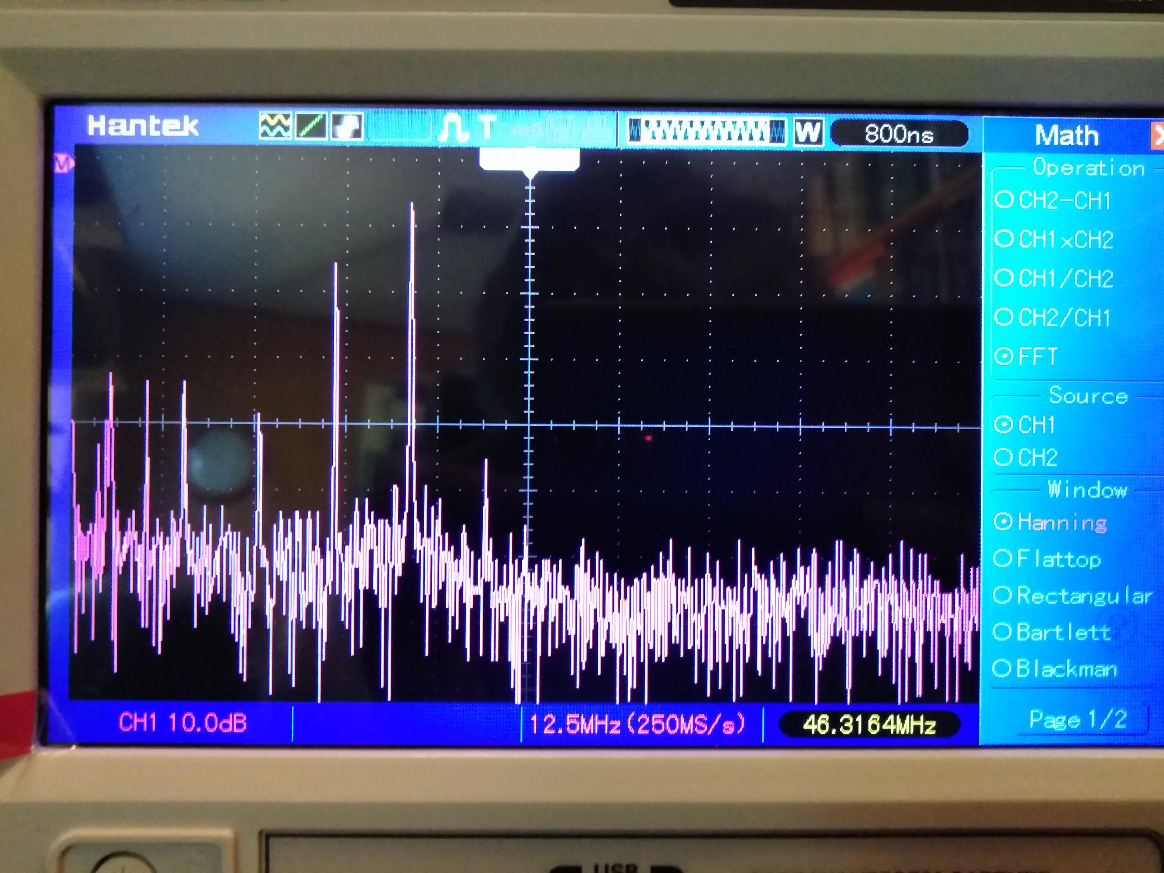

This series of pics is of the FIXED Lo output; again the tunable LO is at 46.32 MHz, and the fixed LO is at 36 MHz for a second conversion to 9 MHz.
The first pic clearly shows the presence of two sine waves. Note that the scope is counting the frequency of the TUNABLE LO, even though this is the fixed output.
The second pic is the FFT of the fixed LO output. Note that the tunable LO predominates over the fixed LO, the increased noise floor, and the other spurs in the FFT.

So, I now understand why I could produce a good enough to quite good conversion to a 45 MHz first IF, but could never produce a satisfactory conversion to a second IF of any frequency.
I probed around the mixers with a wavemeter, and probably should have caught this, but for whatever reason, I did not.
The idea of going to a crystal second LO to be able to switch sidebands should fix this, although without the new scope ( $203 WELL spent ) I would have had only gut feelings as to why.
I want to stick with this synthesizer module for the same reason I bought it in the first place - it is very small, and should lend itself to a compact control head. Since the fixed LO apparently cannot be turned off, I guess I will set it to 0 Hz and ground the output through a 50 ohm resistor. Or use it as the second tunable LO if I need more output, maybe for the TX side .....
I have no idea if this is how Si5351 normally work. It sure looks craptastic if it is. I have no idea whether this particular chip is flawed / damaged; the firmware is flawed, or some weird combination of both. I do have another Si5351 vfo from QRP Labs, but after six months of talk, and five months of soldering, I don't have the intellectual curiosity to find out the answer at this time.

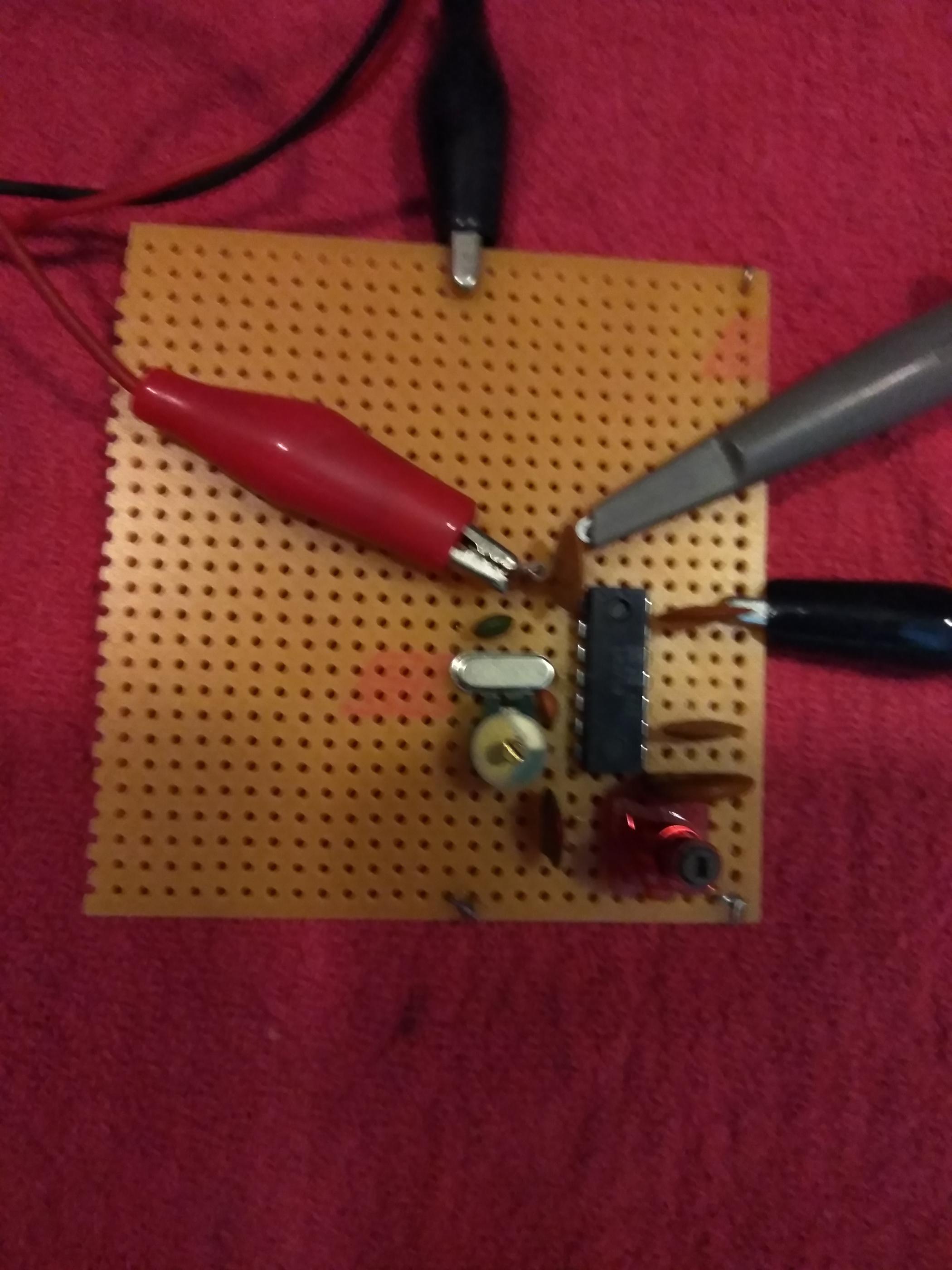

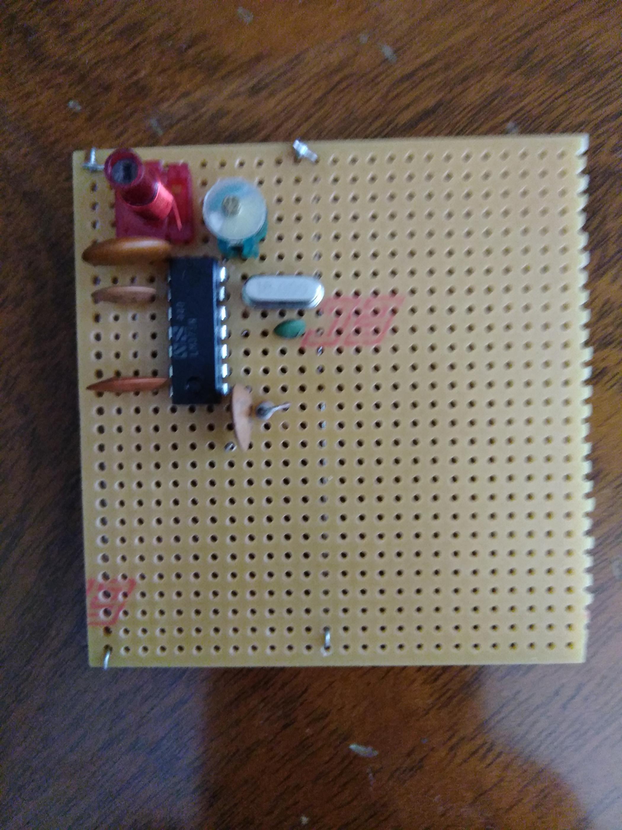

eBay had another flash sale a couple of days ago, 20% off anything, so I picked up a 60 MHz dual channel arbitrary waveform generator, and a few other bits.
In the meantime, I have been playing with some LM375, a part so obscure and obsolete, I doubt a stand alone data sheet can even be found for it. But, I have a bunch of them, so, use what you got. It is in the 1970 era National Linear handbooks, and the first ( I think ) volume of the old ECG databooks. Google coughs up a few images that derive from an article on oscillators in Ham Radio magazine, and the actual article can be found with a diligent search. Unfortunately, the circuit(s) they published for LM375 will not work. The Ham Radio circuit got republished in a lot of the big circuit books of the time.
The pics are of a working LM375 - it looks rough because I had to rework it to make it work, and I'm still fooling with feedback values. This is basically the data sheet circuit. On paper, this device is good to 200 MHz. The tuned circuit is at 18 MHz - the temptation is to put the tuned circuit at one of the harmonics, but I doubt it will work that way, although I haven't tried it yet. The thought is / was to just use a separate LM375 and frequency doubler/tripler for each 2nd LO frequency. This one pictured is about 12 Khz low of where it needs to be. I haven't played with pulling the xtal around. These cheap microprocessor crystals may not be up to the task.
I haven't played with discrete oscillators yet.

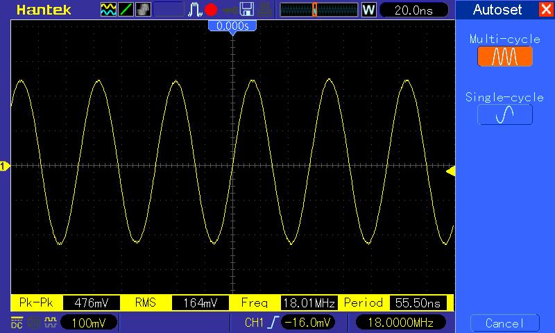

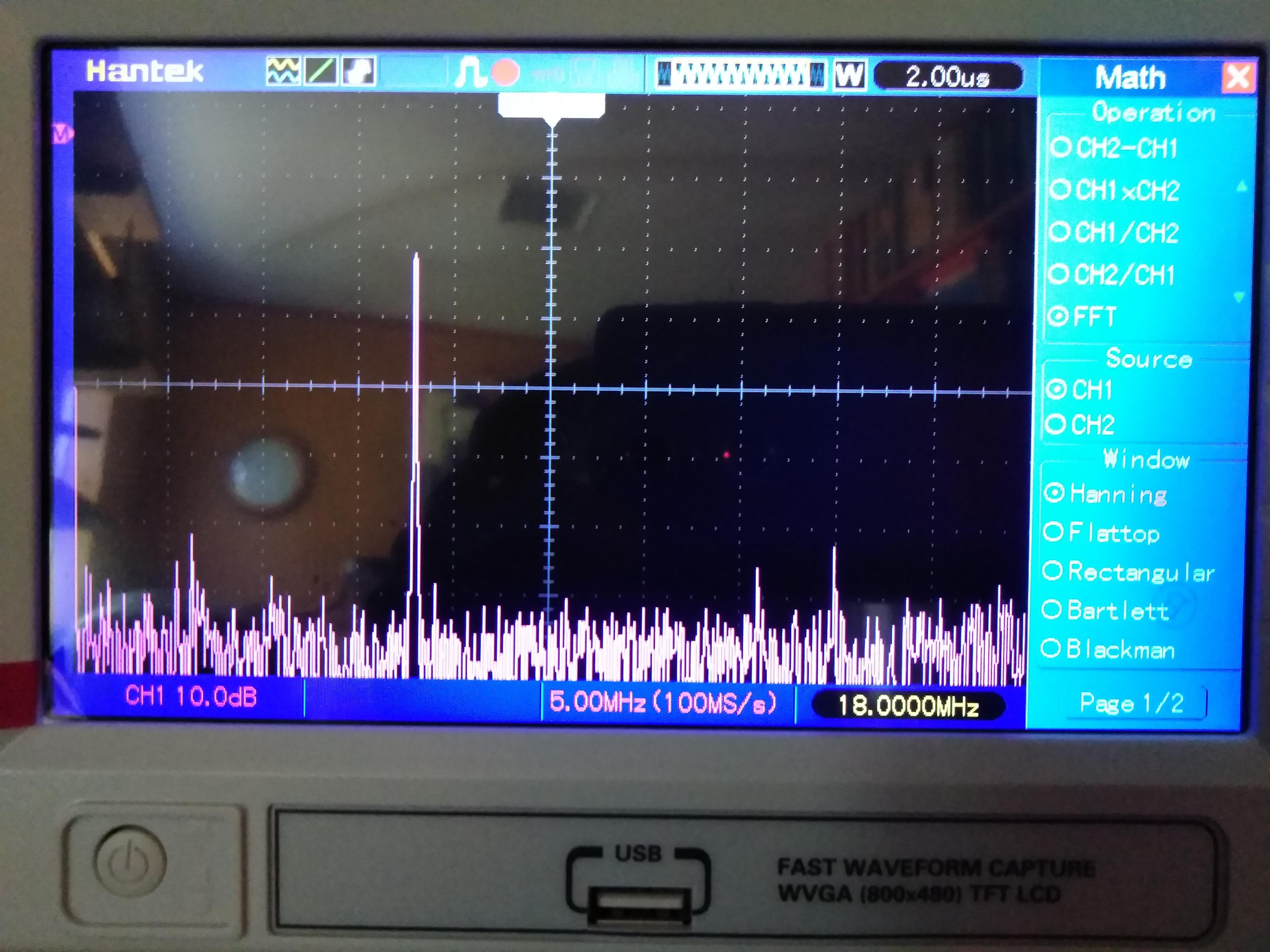

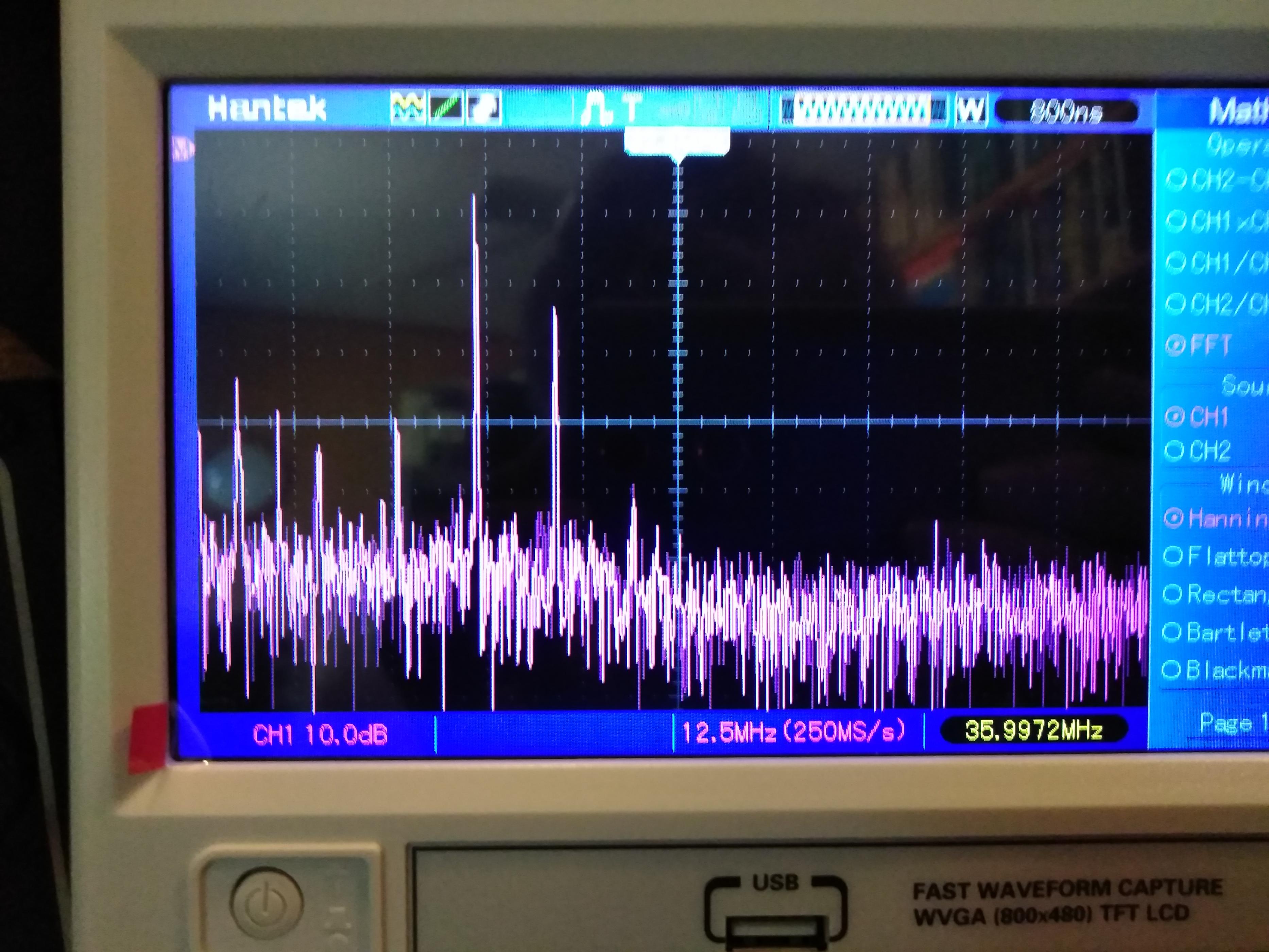

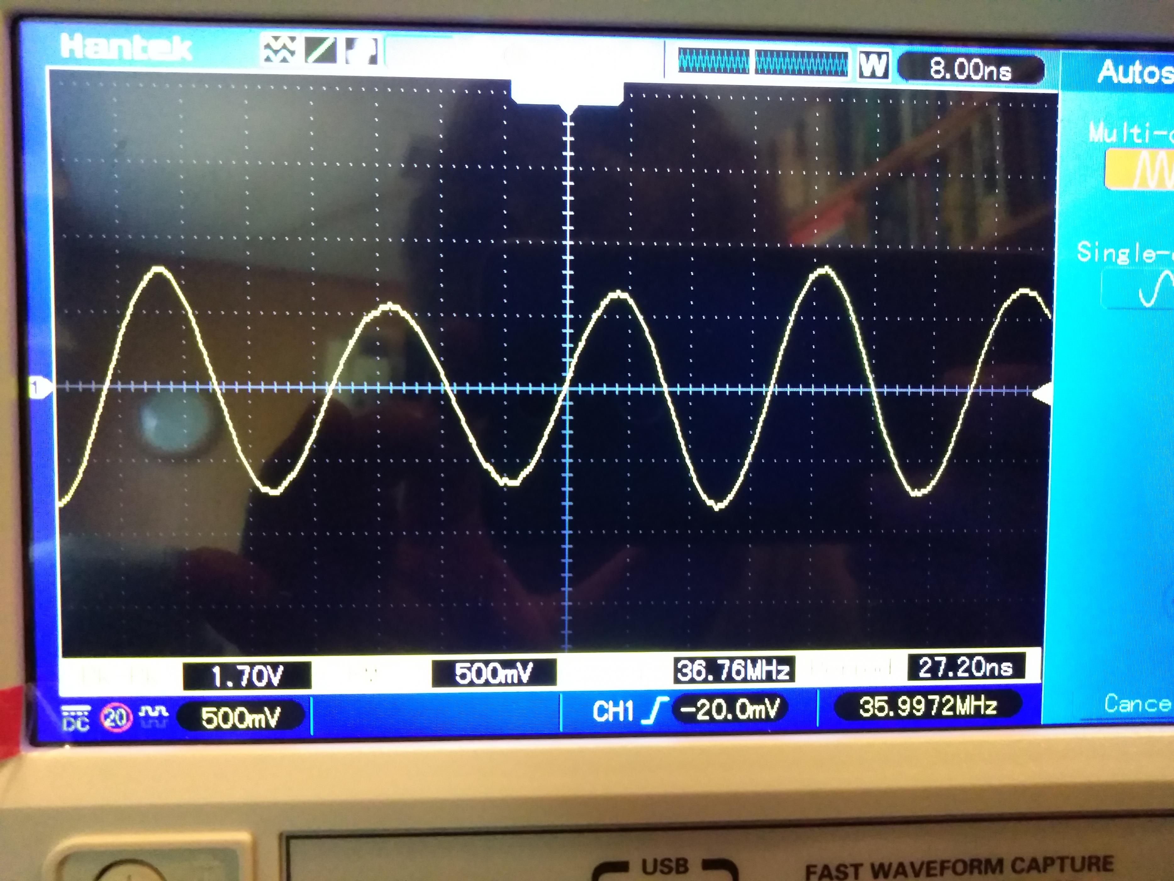

So, I cleaned it up a bit, and here is the result: spot on at 18.0000 MHz, second harmonic and a few other spurs all better than 40 dB down.
This is with a random crystal, pulled from a $2 eBay bag of 18.000 MHz crystals. If I could show the datasheet ( haven't found one online, but it is in the 1972 databook ) the circuit I am using is the VCXO series tuned oscillator, variable capacitance in series with the crystal, except I am using a trimmer instead of a varicap. This one is a bit sensitive to the quality of the trimmer - with a cheap ceramic trimmer, it looked dirty around the fundamental starting at about -40 dB, but with the better trimmer shown, the output looks good enough for a simple transceiver, unless someone sees something I am missing.
Seems stable - its ran on my bench with a fan blowing across it for about four hours, and has not moved. It's running at 14.4 VDC.
It occurs to me that if the tunable LO stays put, and with a fixed BFO frequency, then moving the second LO back and forth across the IF implements the IF shift feature of low end transceivers? I have plenty of varicap diodes, I didn't use one because I thought it might compromise stability.
These crystals are almost as cheap as dirt, so I ordered a couple of bags of 36 and 54 MHz crystals to try out. Maybe a doubler or tripler won't be needed.

This particular chip will oscillate all the way down to 2.3 VDC, and achieves maximum output at 3.0 VDC. The second harmonic stays at -44 dB, and frequency remains constant regardless of voltage.
The screen captures are at 3.0 VDC.
Win W5JAG
Win W5JAG

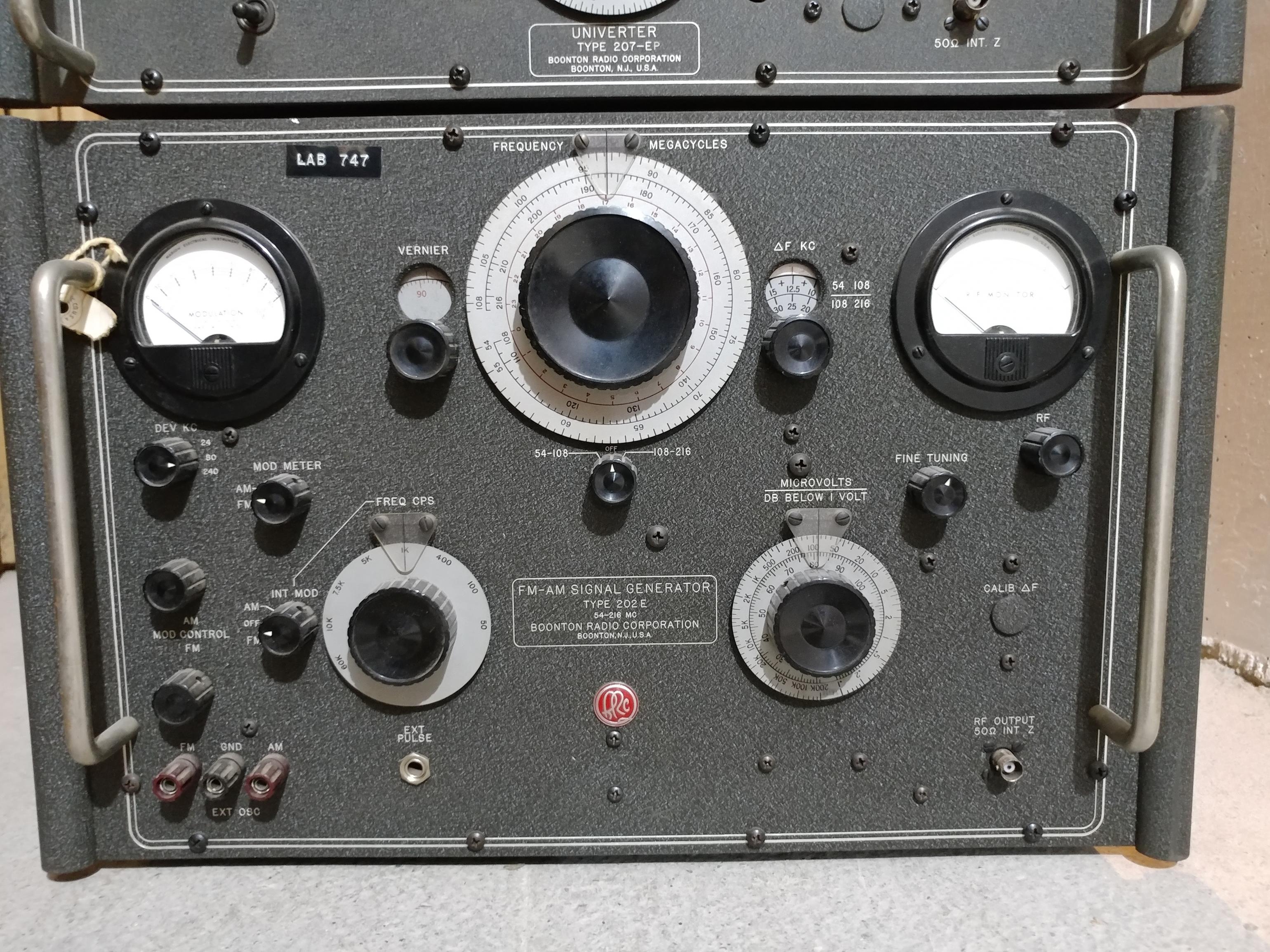

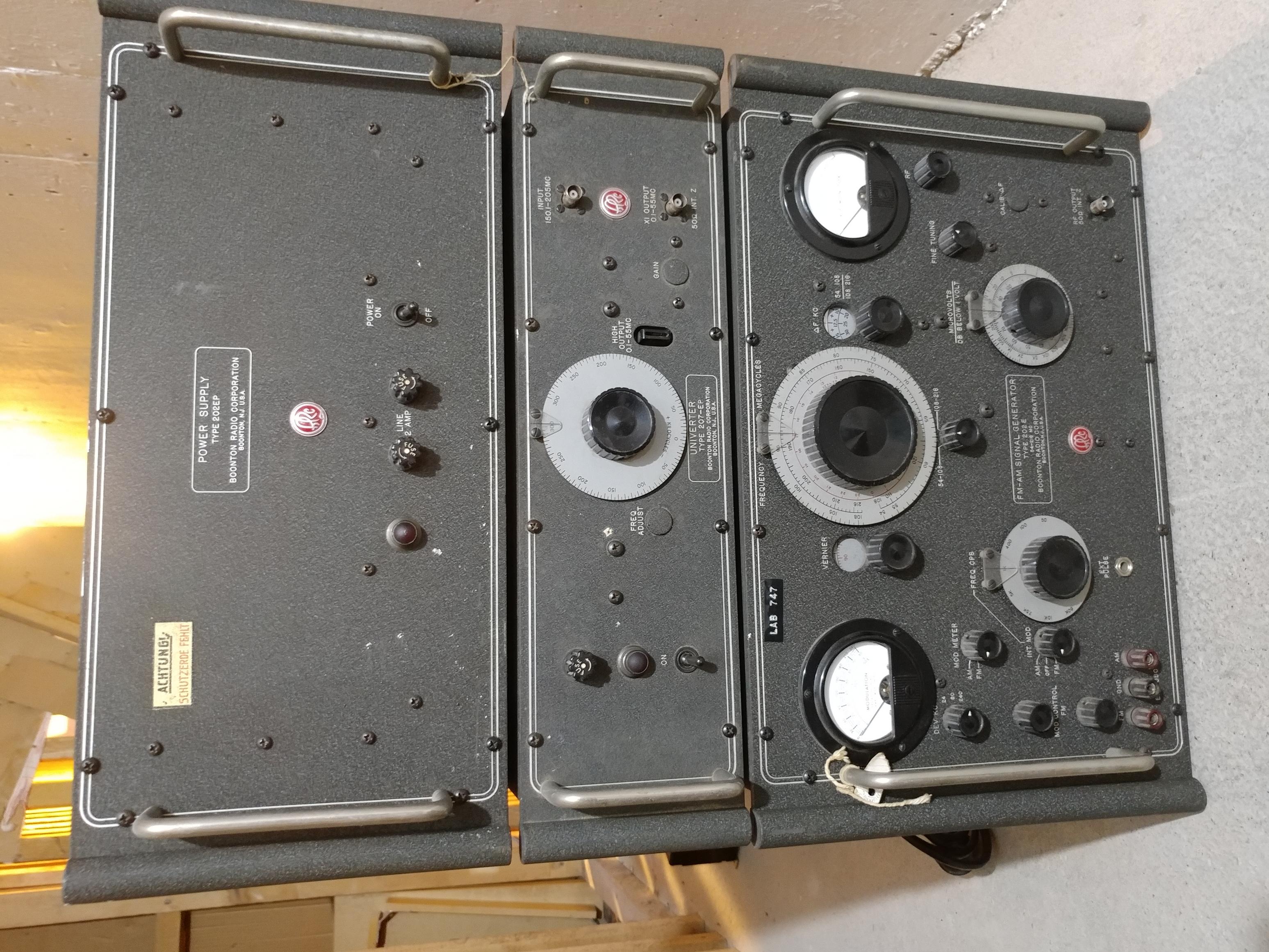

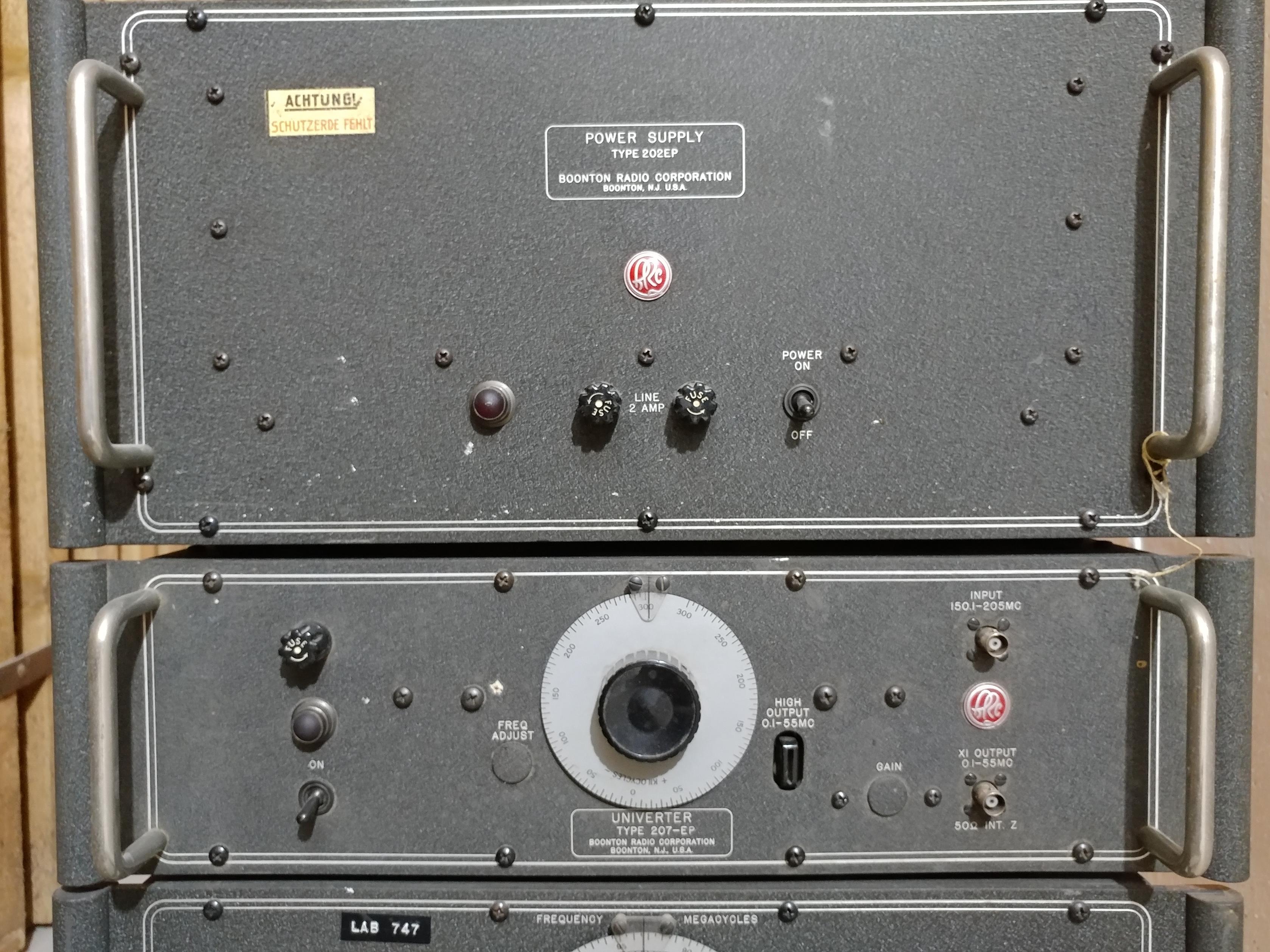

Wow, is that ever cool!
Don't throw it out. Some museum might want it for display, or a HAM club.
-Chris
-Chris
I think it's wonderful. What a beautiful link to the past when this was probably cutting edge stuff.
J310 JFET times two, emulating the dual gate 40673 MOSFET, in SMD format, the exception being the flying 1/8 watt 100K resistor to bias the gate of the upper JFET.
The load is a generic 10.7 MHz crystal filter. I am using a 60 MHz "FeelTech" FY6600 waveform generator as the LO. Looks like about 6-7 volts peak to peak is about the right LO drive level for this circuit.
Subjectively, the J310's seem hotter and quieter than the 2N3823's. The reduced footprint of the circuit is substantial, although the leaded / perf version could be made smaller than it is now.
It is going to take a bit of practice to get proficient with the SMD parts. There were certain parts of the circuit where 0603 might have been easier to work with than the 1206 parts.
Win W5JAG
Win W5JAG
