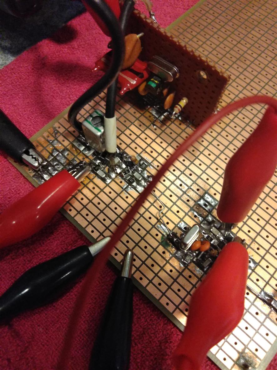

MW/ HF => 45 MHz => 9 MHz => FT-817. 36 MHz xtal 2nd LO, Si 5351 whatever using the FIXED LO as the TUNABLE LO.
IF I use this front end, I don't think I'll need an IF amp, but there is room allowed for one. If unneeded, I'll probably use that space to replace the 2 pole ECS filter with the 4 pole Tellurian.
The board works fine all the way down to 6 VDC.
The front end filter is just a test setup; it will probably become two bandpass filters, one for 20 meters, and another for 40.
The 2nd LO is actually going to go on the TX side; I want to add IF shift to the RX and this Pierce circuit doesn't lend itself well to a varicap type VCXO.
If this board doesn't make it into the actual radio, it will recycle as a single conversion BCB rcvr with a 45 MHz IF. Those narrowband FM filters work well for this.

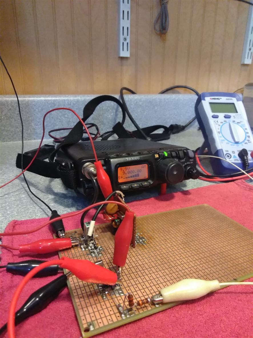

Having played with it a bit, the double J310 JFET is definitely not a backwards move. I forgot to order any modern smd dual gate mosfet's, so I can't speak to them.
Now that the double conversion works like it should, one of the amusing things of playing around with this front end is the VLF performance of something with no filtering at VLF. My ham rigs are deaf below 500 KHz, but not this guy. This is the worst time of the year to listen, but I was tuning around the other evening and ran across one of the local non directional beacons at about 311 Khz, out in the Peno Bottoms, probably fifteen miles away. My "antenna" is the coax shield of the RG-59, feeding the test dipole that I use for the simple FM tuner built last summer, about twenty five feet in length, total. Not exactly resonant, and totally unmatched. I don't know the power of this NDB, but it uses an antenna not much bigger than mine, although I am sure it is matched, and it comes in at S9, with the FT817's RF amp off, and 20 dB of attenuation turned on. Prior to this, I had never heard one of these NDB's on anything but an ADF.

..... so I can't say whether this is better, worse, or just a sideways move from the usual dual gate MOSFET mixer
Win W5JAG

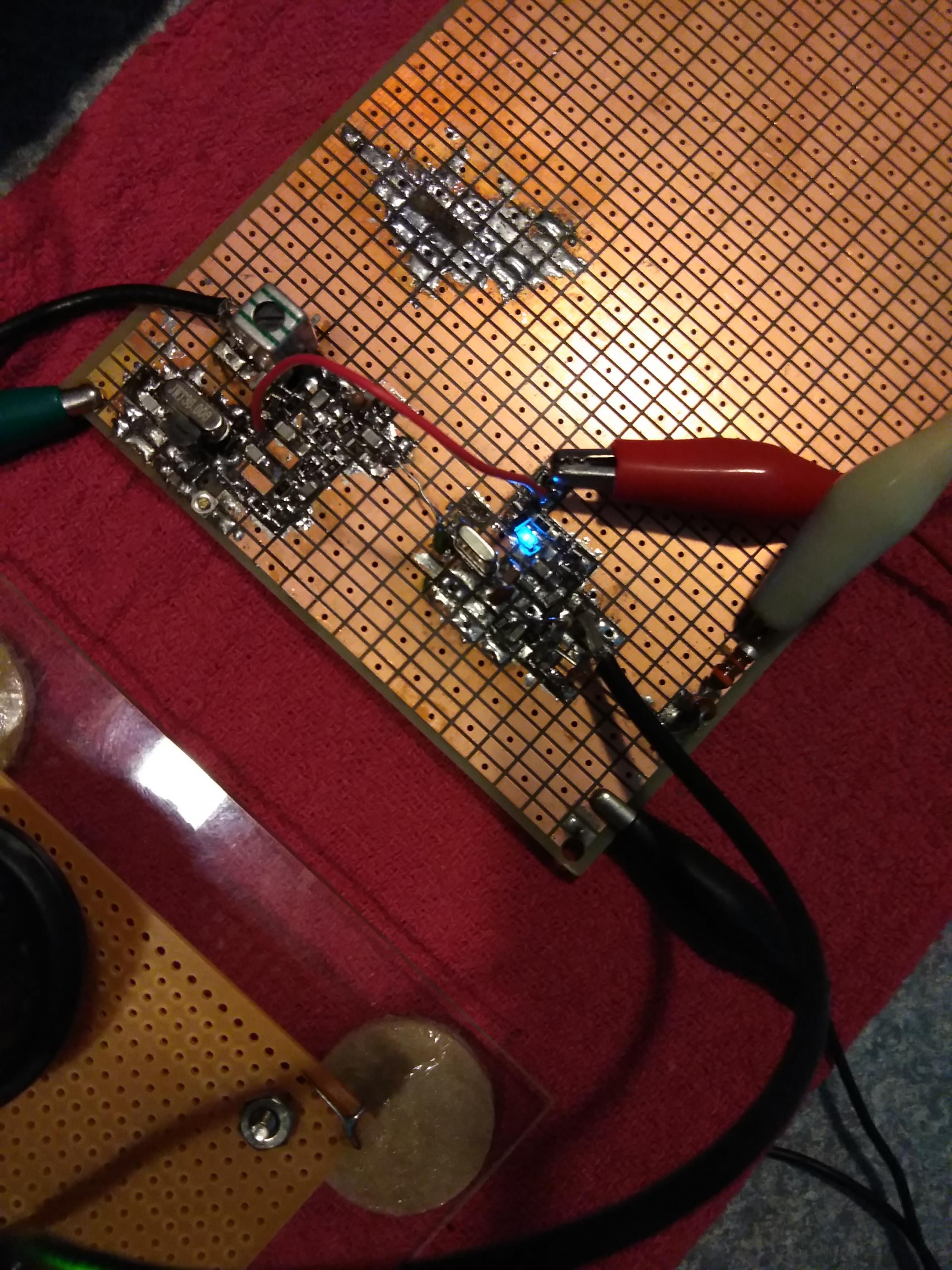

I put the second LO on the board next to the second mixer; the 54 MHz crystals are way overdue, so I am using 36 MHz at present. I've decided to make a new BFO board using the LM375 to inject carrier into the Mizhuo SG-9, so 36 MHz or 54 MHz, not really a big deal other than sideband inversion ( or not ), unless there is some other reason to choose one frequency over the other that I am not aware of.
This seems to work pretty well. It puts out about 6 v P-P, with very little second harmonic according to the Hantek FFT. One of the things I've noticed about using two JFET's to emulate a dual gate MOSFET device, is that the dual JFET combination can eat LO voltages that would likely kill a 40673 on the spot. The JFET x 2 mixer seems to be able to get down to background noise with just the LO voltages typically used with dual gate MOSFET's, but I expect strong signal handling would be better with higher LO voltages.
I didn't have much luck using the J310 as an oscillator. Well, actually, I did, but all of it was bad. They would run for a bit, and then die. I lost two J310's this way, gave up, and just moved on to using an obsolete MPF102, which works fine at 36 Mhz, and should be fine at 54 MHz.
I would like to say that the cheap cell phone picture is not an accurate representation, and that the board looks better in real life, but it doesn't. It is gouge your eyes out ugly - just a mass of black and white blobs, stale solder, and copper pads. I put that little LED in just to add some color and amusement.
The SMD thing is a bit harder than I anticipated, but I think I am starting to see how to better exploit it, and better utilize this prototype board. The good thing is that it works a lot better than it looks. It seems to work exactly like one would expect it to.

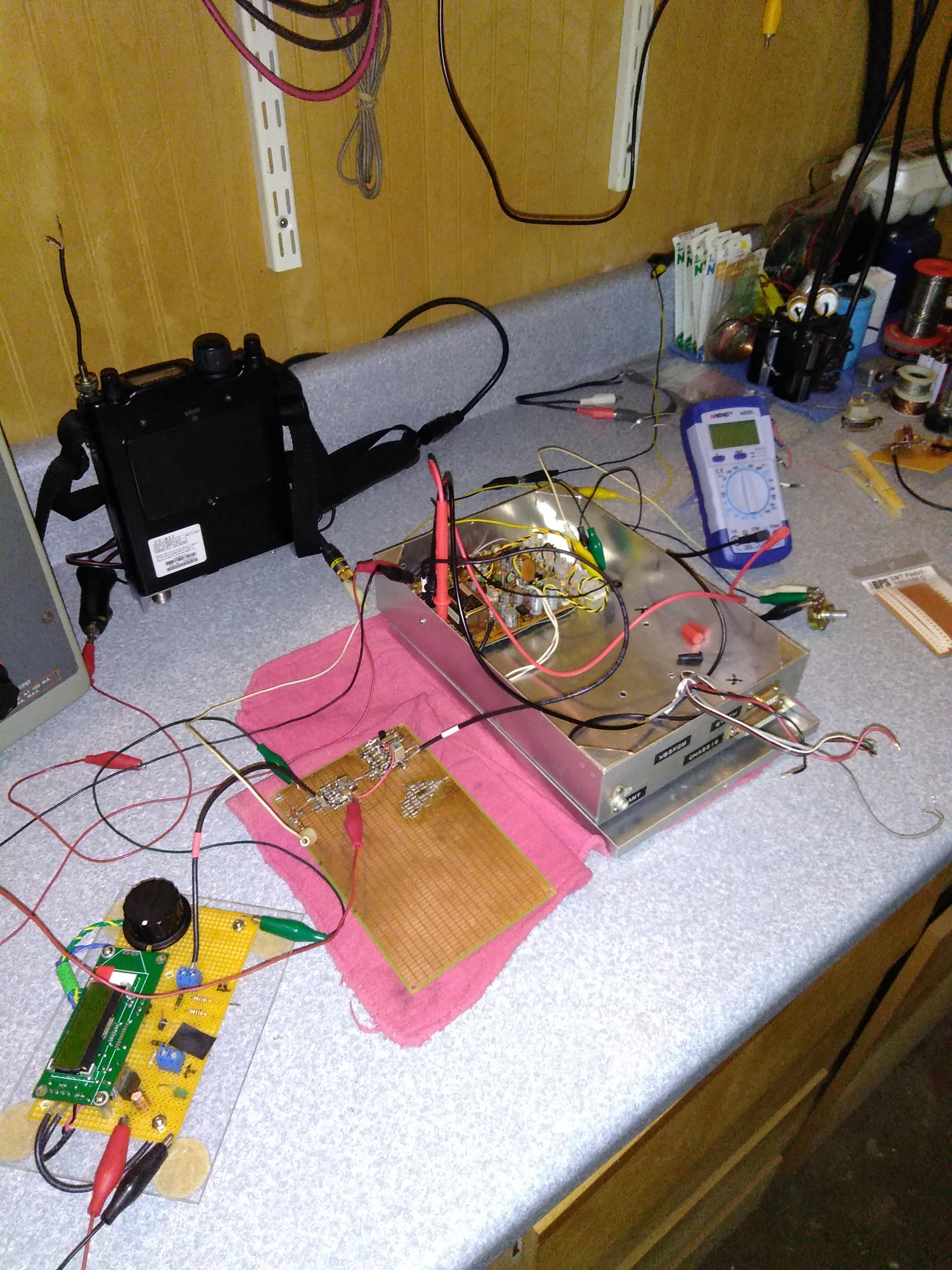

I think this is the longest I've ever spent on an uninterrupted single project, with really nothing to show for it.

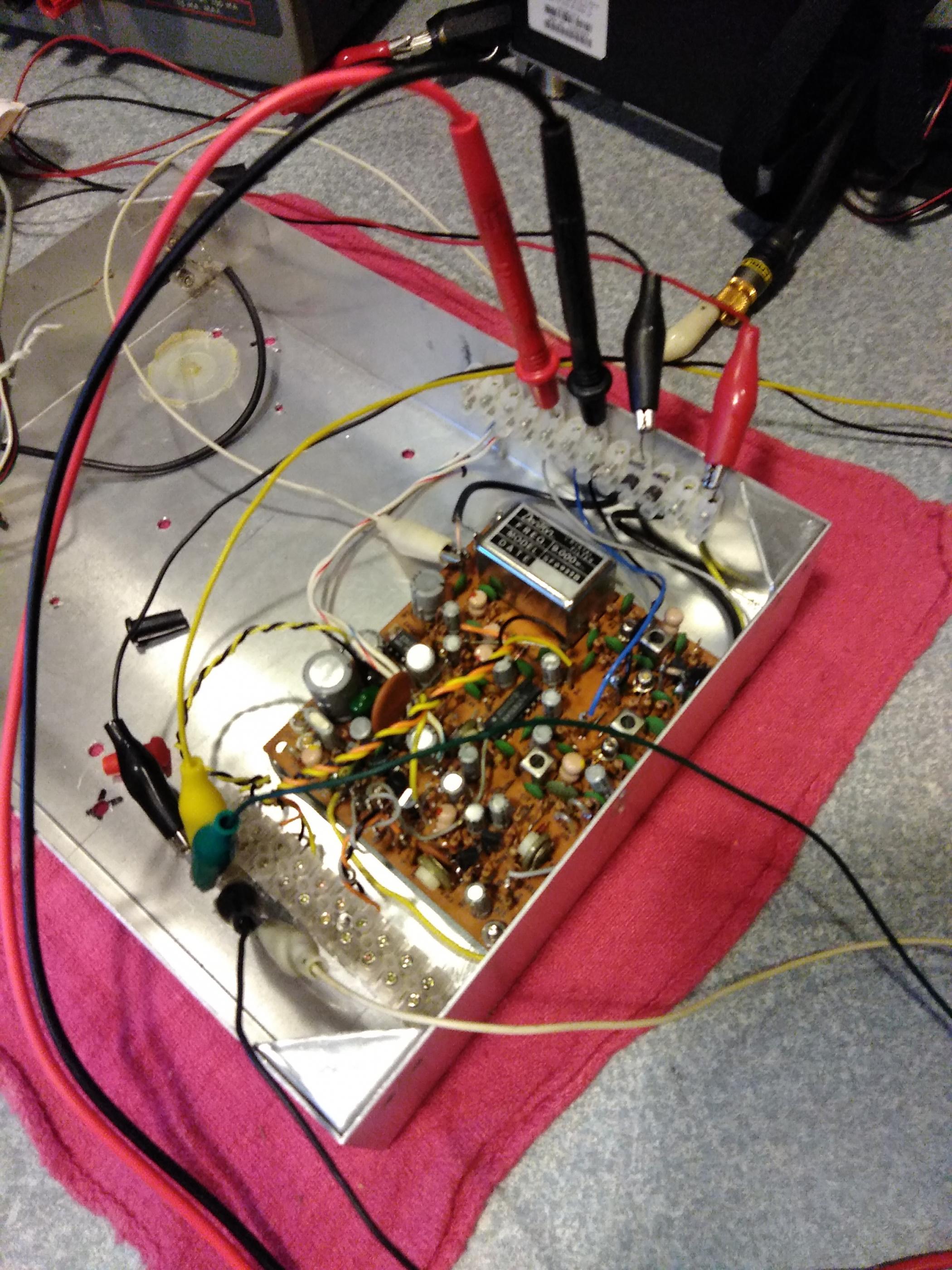

So, a YEAR in, just to have something to show for it, I decided to start piecing it together as a radio to see where I was at, or if I should just toss in the towel .....
I put the SG-9 in the box, and brought all the i/o out to barrier strips for testing. I have it hardwired for SSB; it still takes about 24 connections to get to everything even without mode switching.
The electrolytic caps are about four decades old; on a case by case basis I may replace some of them, it's not a high priority right now.
My goals are always pretty simple:
1) I can actually make it work ( sort of );
2) it won't drift ( a whole lot );
3) I can actually make QSO's with it, or listen to it all day without having the urge to drive a nail through my ears.
The up conversion to low VHF, and tossing SMD in on top of that, may be a deviation away from simple. I don't really know - simple is a relative thing, I guess. Having gotten the Si5351 whatever figured out, It doesn't just sort of work, I think it is going to work pretty well.
With two crystal oscillators and a synthesizer, it does not drift a bit, even with an air conditioner blowing across it.
No TX, so, no QSO's yet, but it sounds good. I was a bit taken aback at how good it sounds into a full range speaker.
