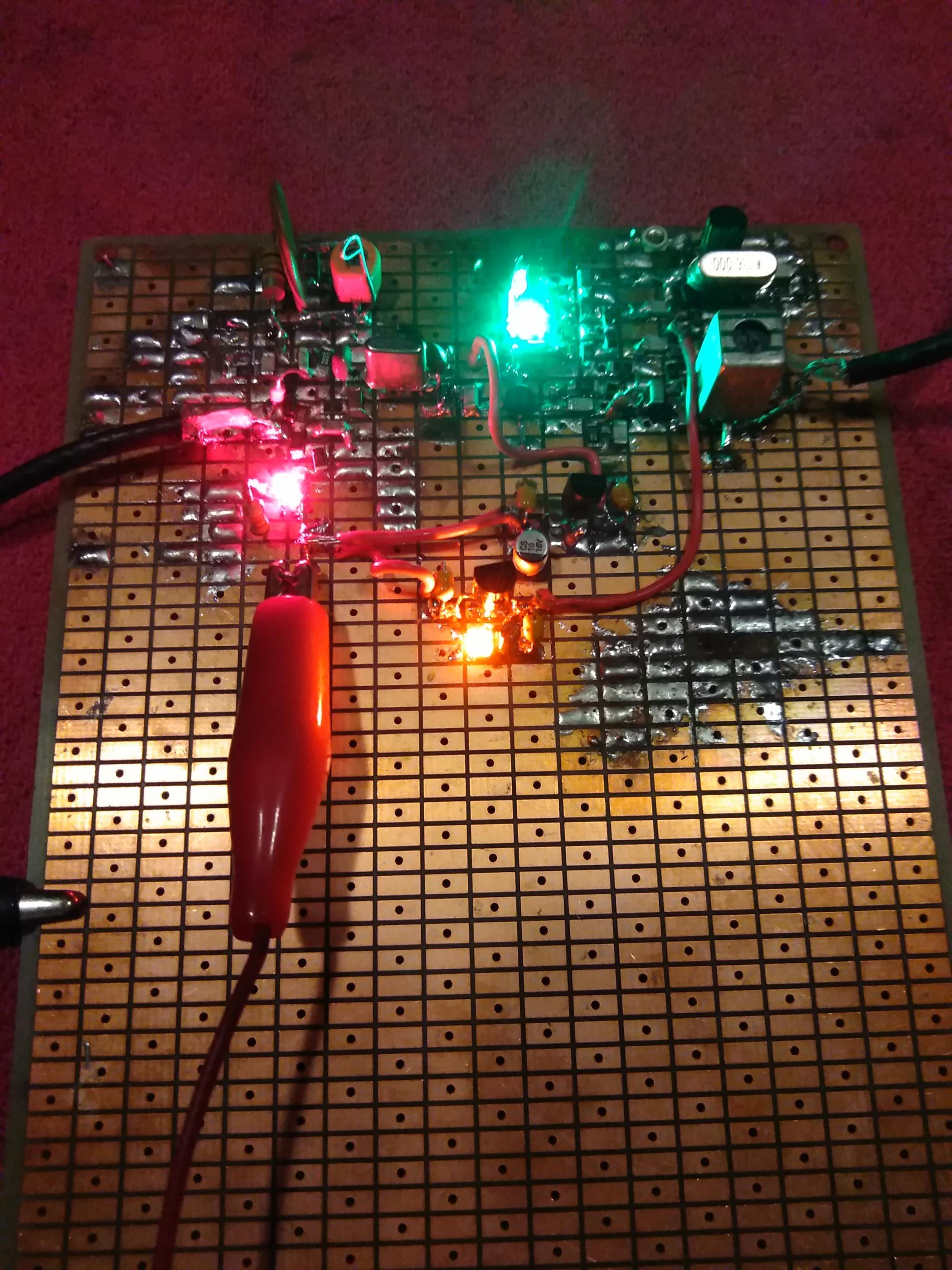

To get the sideband right on twenty meters, I also changed the 9.0015 BFO crystal to one of the new 8.9985 MHz crystals .....
Which was premised on changing the fixed second LO to high side injection at 54 MHz, which I did last night.
And immediately ran into problems (shocker).
The 36 MHz crystal is a fundamental cut, and I built the oscillator for that. It works well; the second harmonic is about 45 dB down from the fundamental. When I put the 54 MHz crystal in, and put a frequency counter on it, it came up at 18 MHz. You guessed it, it's an overtone crystal.
I looked at the output with the FFT, and it showed a textbook distribution of harmonics out to the 4th, which is probably as high as the cheap DSO can resolve. The oscillator is built pretty tight. The inductive/reactive load is a 4.7 uH SMD part mounted *under* the crystal. I can change that without much difficulty, but at present I don't see a way to fit a resonating cap or caps in the available space, even with SMD parts, without significantly rebuilding it.
So, I tried picking out the right harmonic with a tuned circuit in the output and got basically nowhere useful. I used the Toko SMD part discussed of late (among others), and the best I could do was to eliminate the 4th, and bring the (desired) third up to the level of the second, both of which are still about 12 dB under the fundamental. The fundamental never changed, so I guess there is also a leak around the tuned circuit.
For some extra fun, I managed to bust that IF transformer on the output of the second mixer, and that will have to be fixed. I can run the output into the filter on the SG-9 without the transformer, but if I do that, it reduces the conversion gain, a lot, so that would have to be made up somewhere else.
One other thing, the dual gate MOSFET mixer seemed to have some RF isolation between the two gates. The dual JFET emulation appears to have little to no RF isolation between the two gates.

why not stay at the fundamental and build a tripler stage ?

A couple of months ago, that was sort of the plan.
High side LO injection inverts the sidebands. When the only source of new 9 MHz BFO crystals were $15 USD each, I had the crazy idea of using one or two cheap 18 MHz crystal(s), doubling that to 36 MHz for one sideband, and tripling to 54 MHz for the other, and selecting sidebands that way, but Mouser added BFO crystals to their catalog a few weeks ago, and these are really cheap - less than $1 USD each, making the second LO frequency a non issue.
It probably would have been difficult to get the same amplitude into the mixer at two different harmonic frequencies. The conversion gain is directly dependent on the LO voltage, so if they are different, it would be apparent. edit: the conversion gain would probably also vary with frequency, adding another variable.
Likely, I will just go back to 36 MHz for the second LO. This is a classic example of the time consuming problems that pop up when you fix something that wasn't broken.

the other option is to use something like a Cy22800 clock multiplier eventually combined with a logic chip like a xilinx to generate the divides. once needed that to generate two clocks with variable digitally controlled phase for beamforming at 6.78Mhz. the CY chip does also have a VCO option when a pullable xtal is connected.
Don't forget that an overtone crystal may not be an exact harmonic of the fundamental, although it will be close.
The 54 MHz crystal came up a little bit higher than 18 MHz; I didn't write it down and don't specifically recall what it was, but it may have been 10 KHz, or a little more, high. My simple equipment would always latch on to the fundamental, and I was never able to measure the harmonics, other than relative amplitude.
The 9, 18, 36, and 54 MHz crystals that I have are the cheap stuff off eBay. The 9 MHz crystals actually had some specs, but with the others, the only spec offered was the number of crystals in the bag.
This self inflicted problem has been resolved by leaving the oscillator alone, and re installing the 36 MHz crystal.

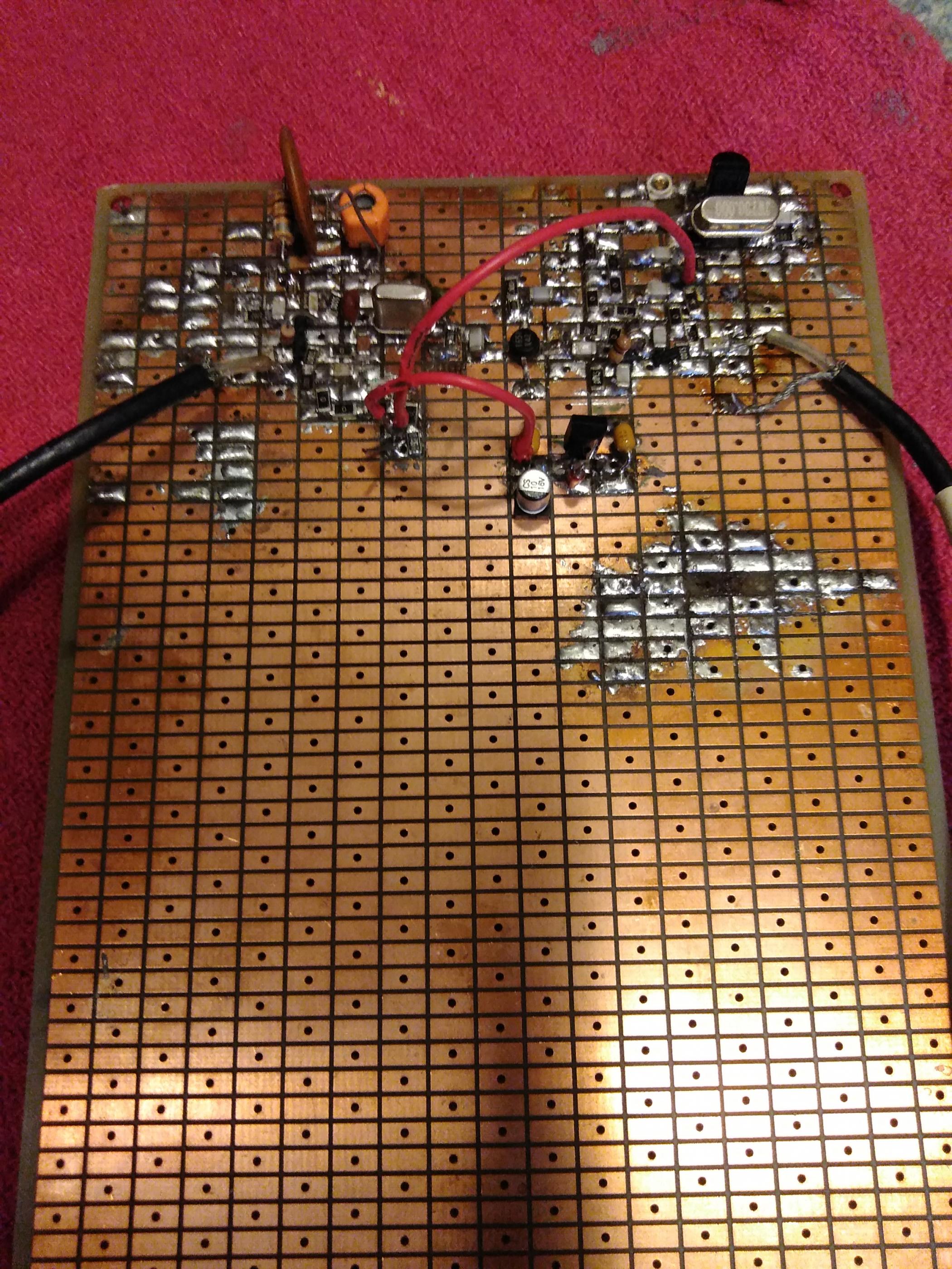

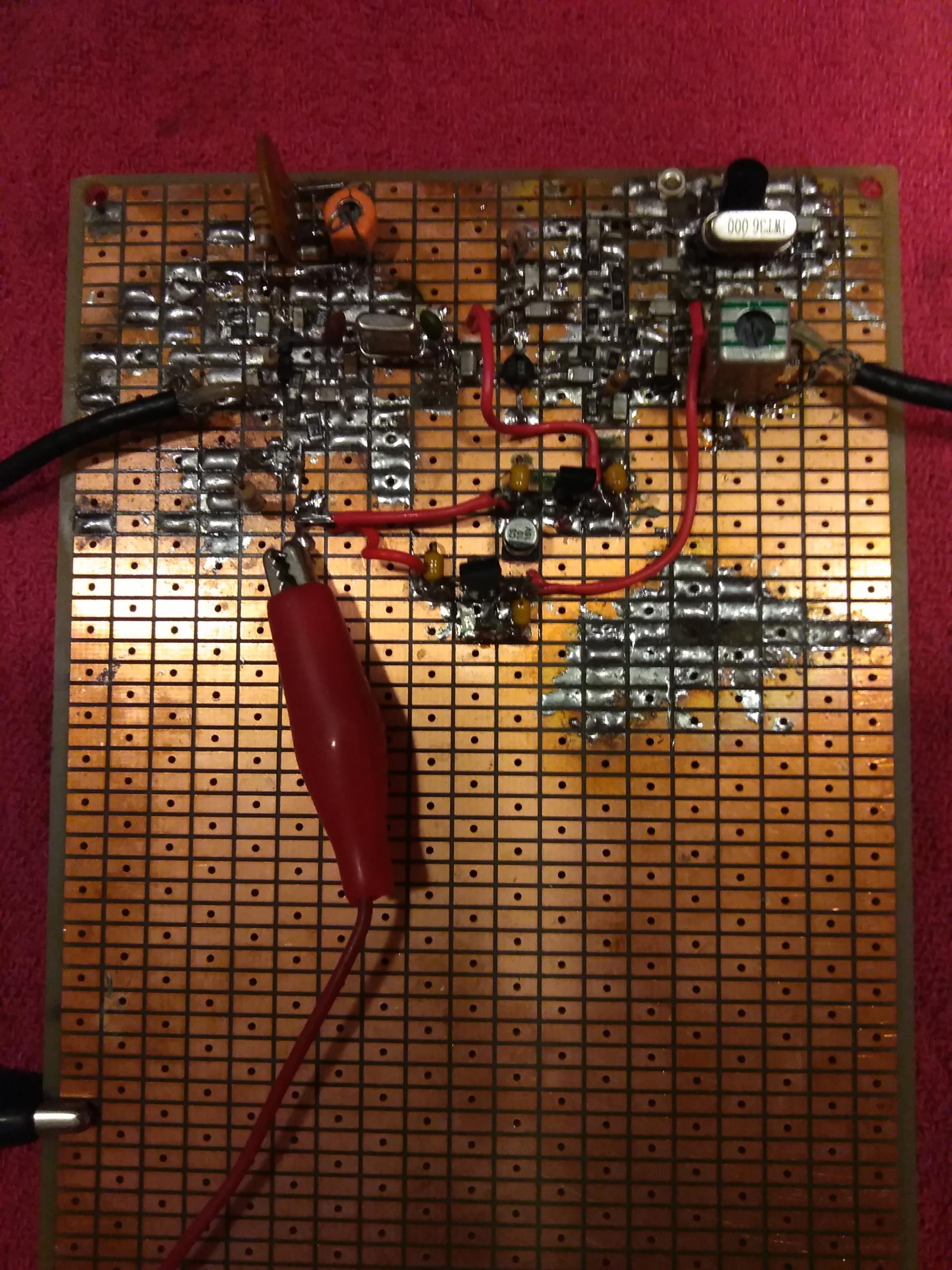

Not that pictures show much, but the latest iteration is pictured. I omitted the IF transformer and substituted a resistor load, and added the severely mismatched upc1651G as a first IF in between the two mixers to attempt to offset the gain loss. Instead of fooling with zeners, the MMIC will be powered off the 78L05 pictured, floated above ground by a diode junction. It measures out at 5.68 volts. I haven't tried this configuration yet, but it should work, the only variable should be whether or not I need to re install that transformer. Which brings up gain, gain distribution, and

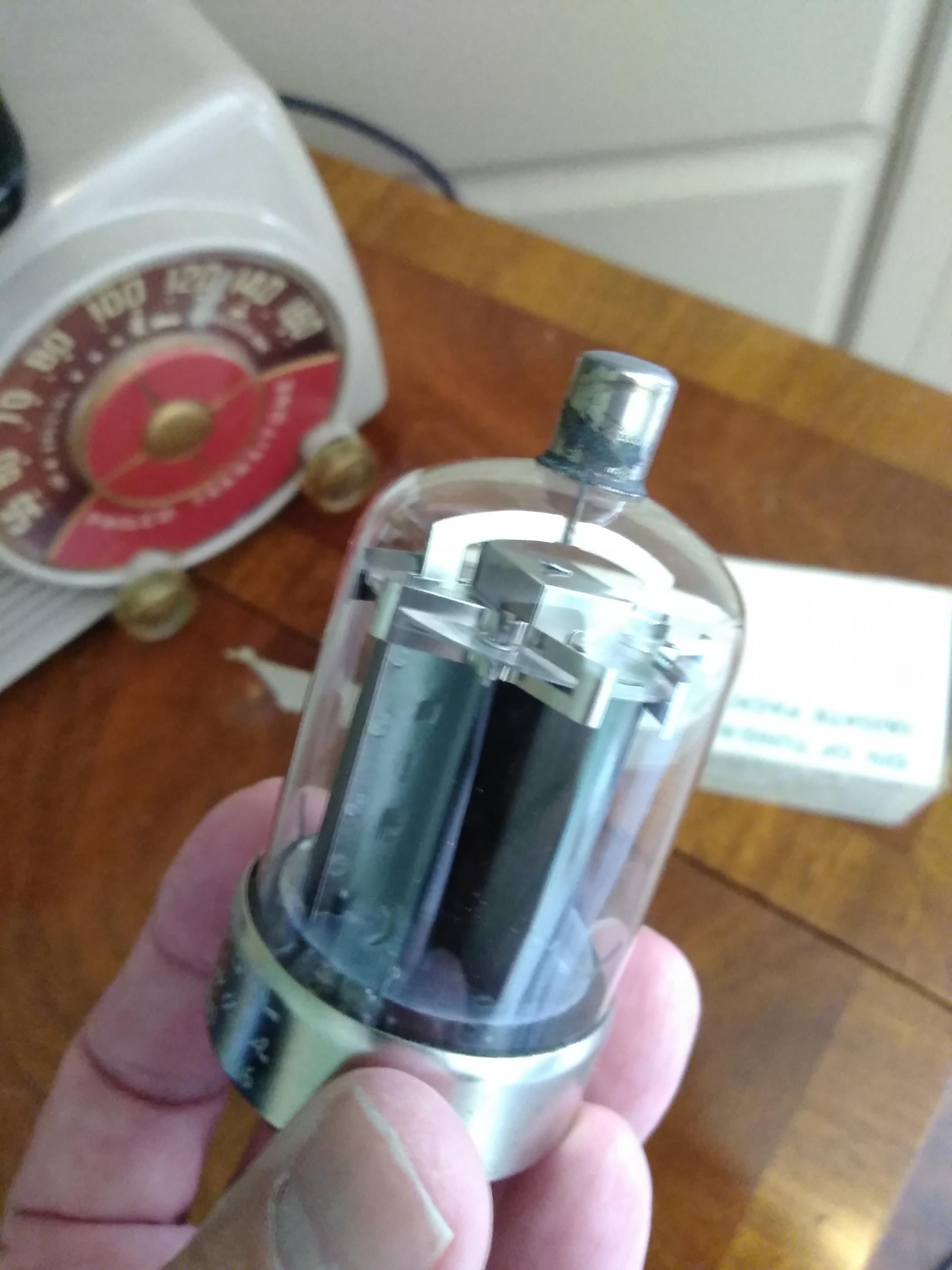

In the meantime, enough of this SMD chicanery! Look at what the mail lady just delivered - a pair of genuine NOS Tung Sol 7212's!
Just the ticket for a mobile HF amplifier ......

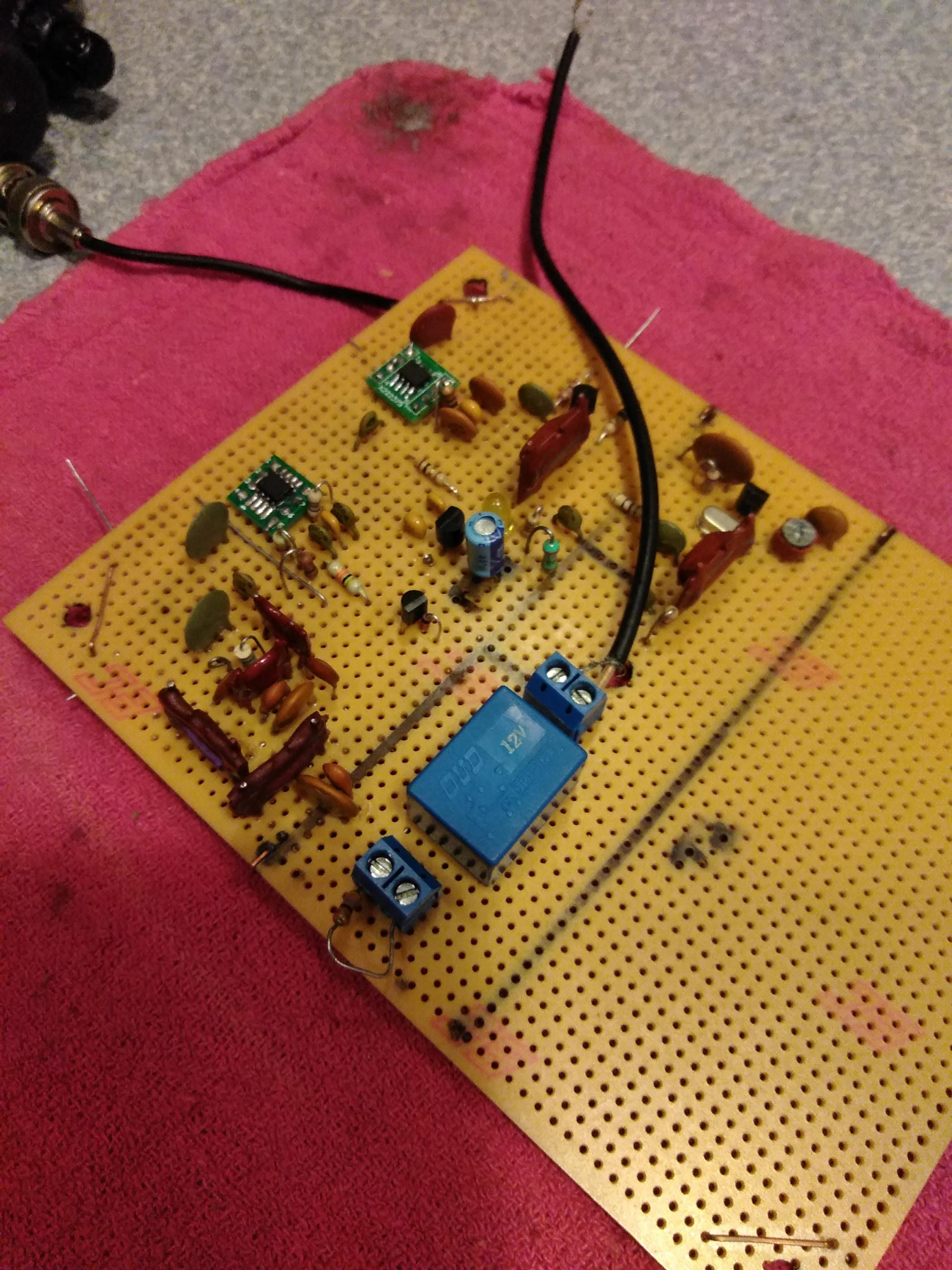

In the meantime, the simple front end is done. The single tuned circuit at the front end should be inadequate, but it doesn't seem to be. The image is up in the FM BCB, and doesn't seem to be causing any issues. The high power shortwave stations that would overwhelm this all seem to be gone. MW breakthrough doesn't seem to be happening.
The board draws about 90 ma, probably from the MMIC and LED's. It is wired so the first mixer will get all the voltage the car electrical system can deliver, the MMIC has it's own regulator, the second LO and mixer get a regulated voltage from a 78L12, boosted by one diode juntion, about 12.6 volts. The red LED indicates power to the board, green is output from the MMIC regulator, orange the second LO/mixer regulator. They load the regulators a bit and add some pizzaz to an otherwise bleak landscape.
I couldn't get it to work satisfactorily without the IF transformer, probably because of the load of the coax pigtail. I did not try hard to solve that, since I knew a transformer would take care of it.

This is a double conversion setup with the HP mixers for testing. Still needs quite a bit of work.
No first IF selectivity yet.
Could need an RF preamplifier. Hard to say, yet - when driving the FT-817 as a back end, the overall noise combination of the two is misleading.
An LM375 based oscillator had no trouble driving the low impedance of the HP chip, but the simple Pierce oscillator shown here, and used on the other board, needed a buffer to be able to drive the chip. That part still needs some refinement, or I might use an LM375 here.
Not sure about optimal LO drive levels.
