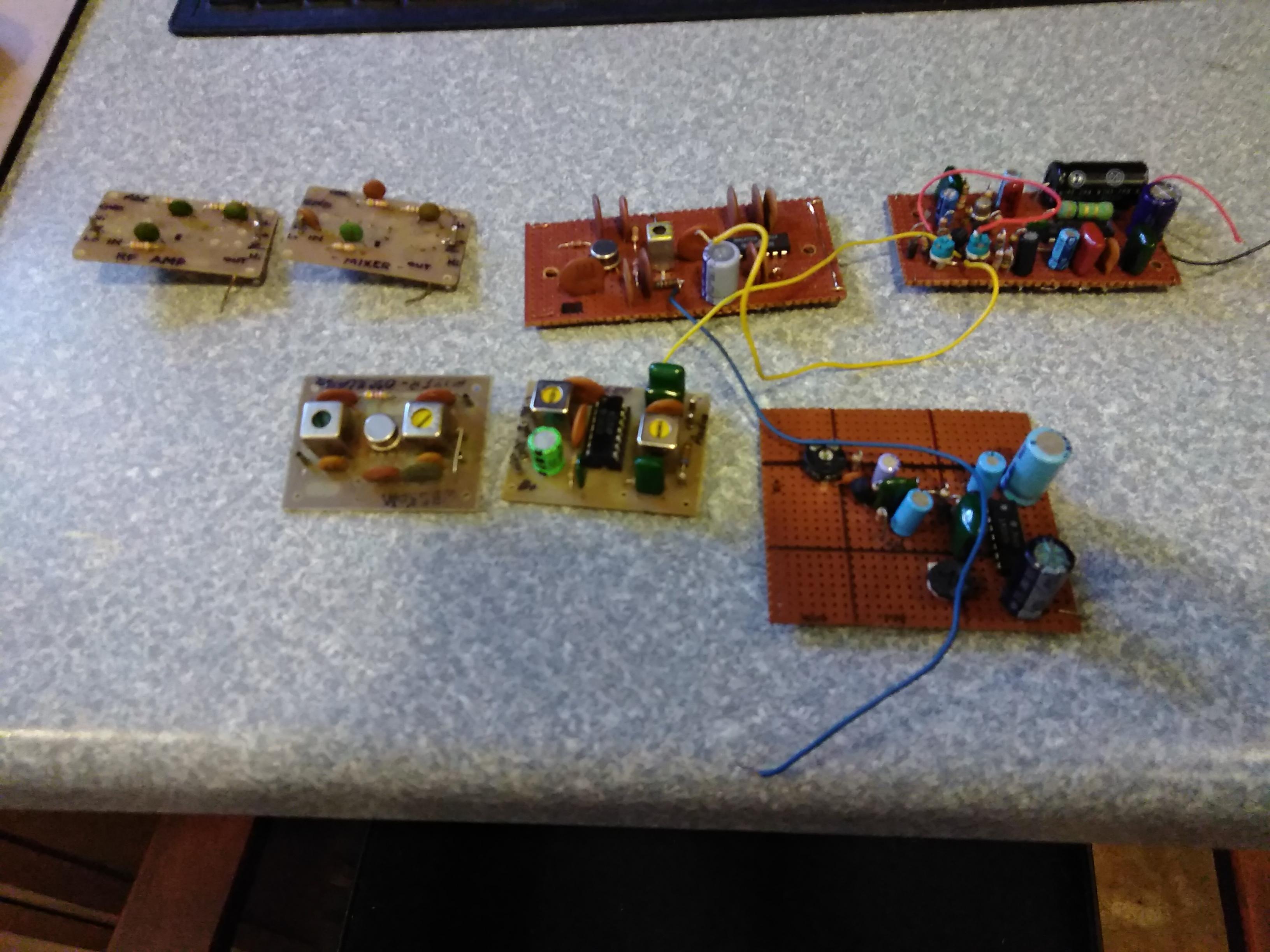

It's not best practice, no doubt about it, but that's not it.
I rerouted that lead, tried some series resistance in the output, fiddled with the decoupling, without any improvement.
I can kill the oscillation by dropping the VCC, but that's about all it seems to respond to at the moment.
I can get the needed gain with an IF amp at 45 MHz, but I'm not sure the mixer chip is quiet enough to be usable at HF without something low noise in front of it. It is looking like I'll have to try that and see.

The perfboard is easy to work with, and there are some other circuits I want to play with, so not sure how much effort I want to put into this one. There are a few more things I want to try to see if I can get this to work, but I may move the MMIC to a gain stage in between the two mixers, and if it is stable there, then try that setup with the Mizuho board to see if it is quiet / sensitive enough without an RF preamp ahead of the first mixer.
There are still a lot of things I want to try, so even if this setup can be made to work right, there is a good possibility it will be torn back down to parts to try out some other stuff.
I tore down that board with the diode DBM's a while back, so I have those, and a few leaded broadband transformers, and now some decent enough leaded RF FET's. Maybe even some vacuum tube stuff. At a hamfest a few years ago I got some NOS J.W. Miller RF transformers; I think I have enough to make a single band, single conversion, tube transverter for the Mizuho IF board.

I still think the issue I am having now is not impedance matching, but just plain poor grounding, or poor decoupling, or a combination of both, so I am probably going to throw some more time at it and see if the problem can be solved just on general principle, even though the device is probably too noisy for an RF stage, even at HF.

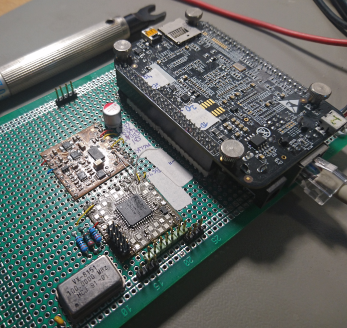

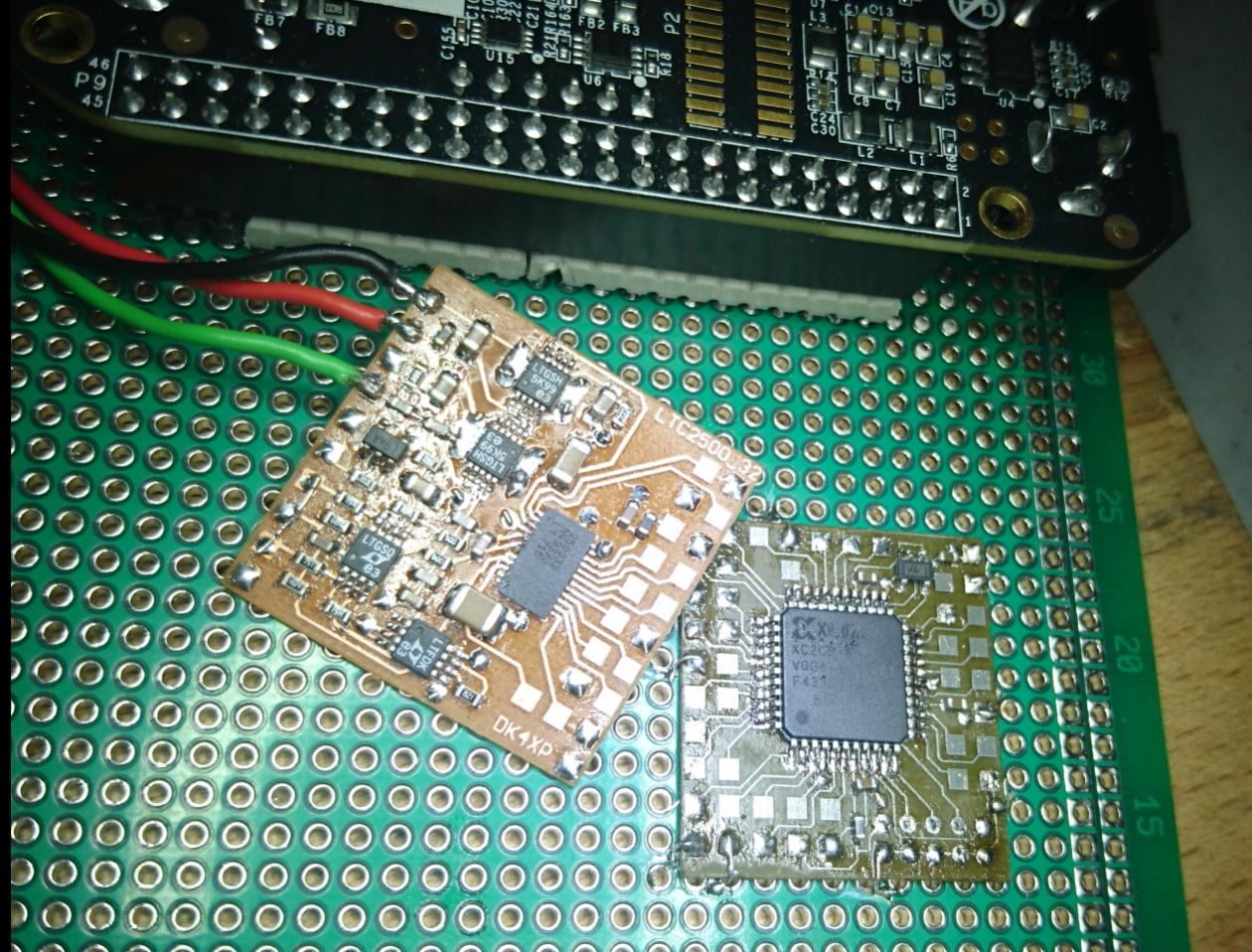

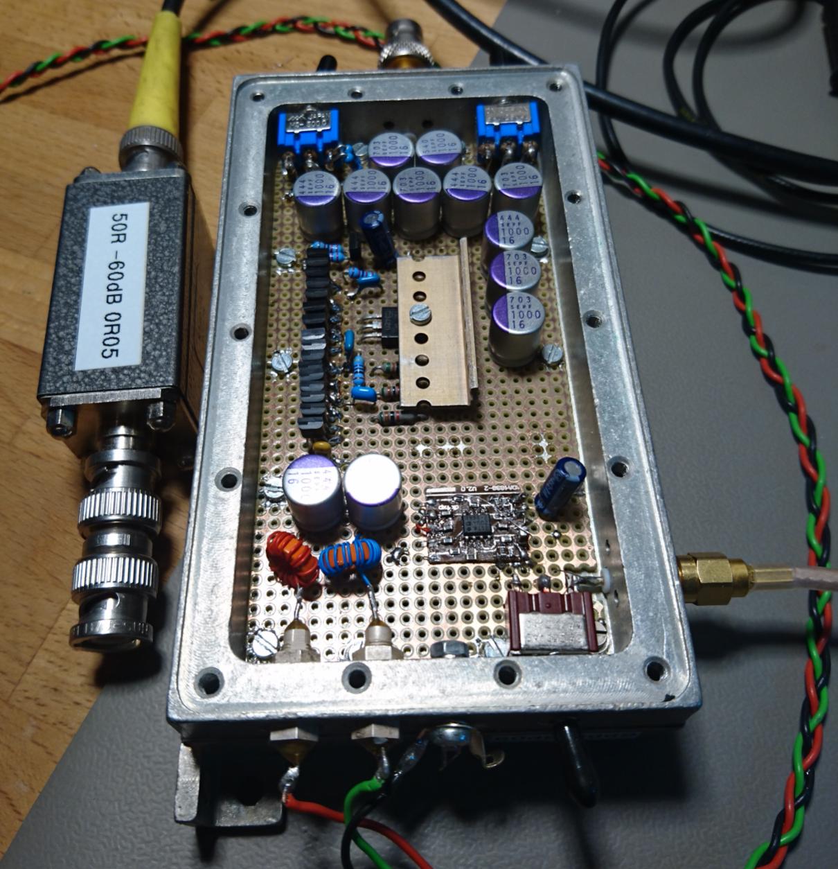

The first pic is a preamp that is quite close to that in Art Of Electronics V3,
70 pV / rtHz, but the input impedance is quite low.
The 2nd and 3rd is a digitizer stamp with a LTC2500-32 ADC, 2 LT3042 pos.
regulators, fully differential input amplifier with a neg. regulator and LT6655
voltage reference. The stamp with the Xilinx Coolrunner makes the sample clock
and collects the leftover digital stuff.
In the rear is a Beaglebone Black that will collect the data and do the FFTs
and network interface.
