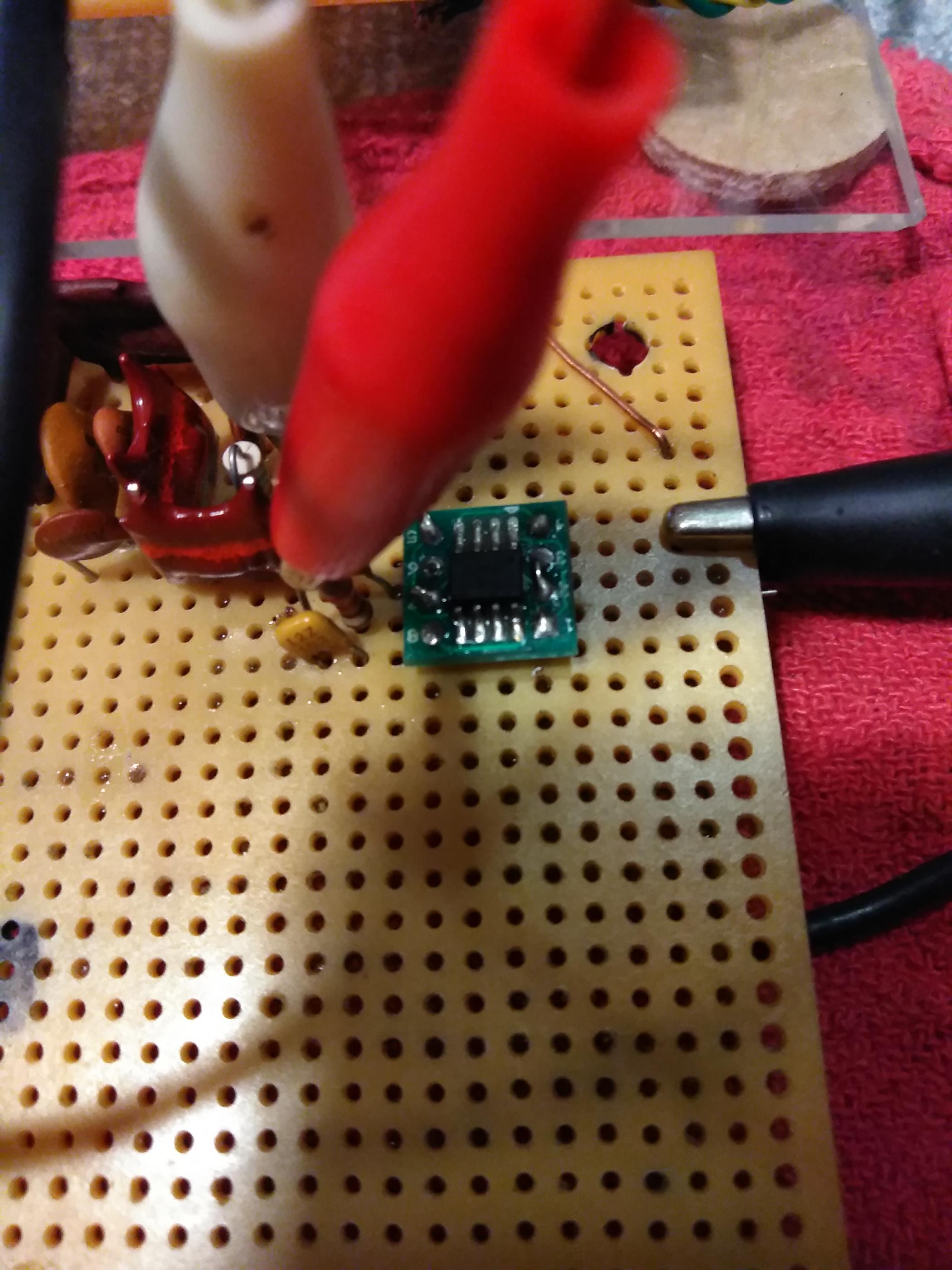

As part of the SMD thing, I've had these HP IAM 81008 chips laying around, so I tore down the 2N3823 mixer, and substituted one of these in it's place.
Not much to it - 50 ohm in and out, so I just hooked one end to the input filter, and the other end to the FT-817. A couple of bypass caps, blocking caps, the usual decoupling from the supply line, that's pretty much it.
Seems to work okay; the battery was low on the FT-817 so I didn't get much time to play with it, but it heard the local 25 watt LF NDB, and 50 watt BCB station in the next town over, quite well. CW on 40 meters was good, also.
These chips are cheap on eBay, and apparently genuine. Datasheet attached. There is an old patent for it, #5379497, but my copy is too big to upload
Win W5JAG
Win W5JAG

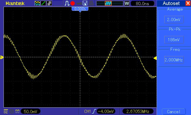

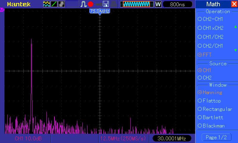

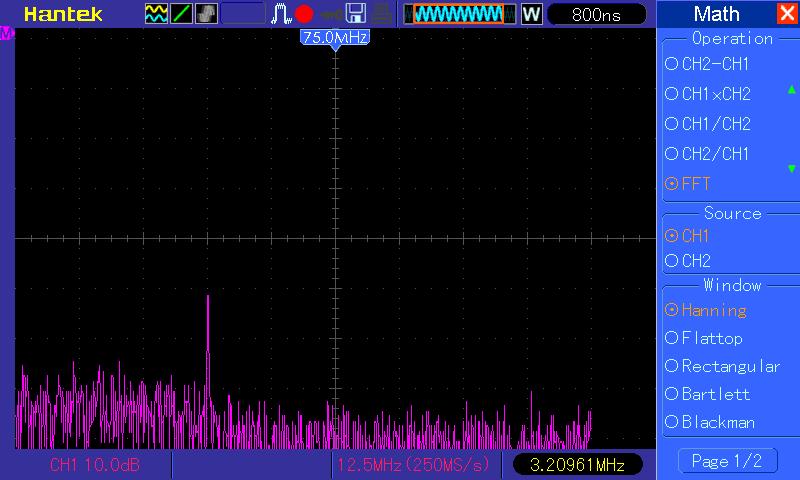

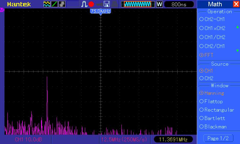

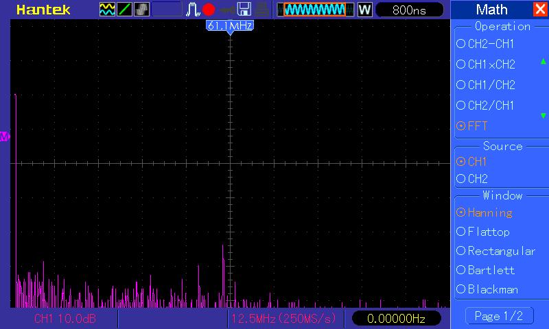

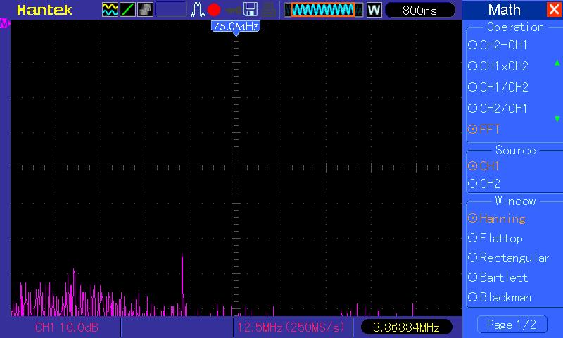

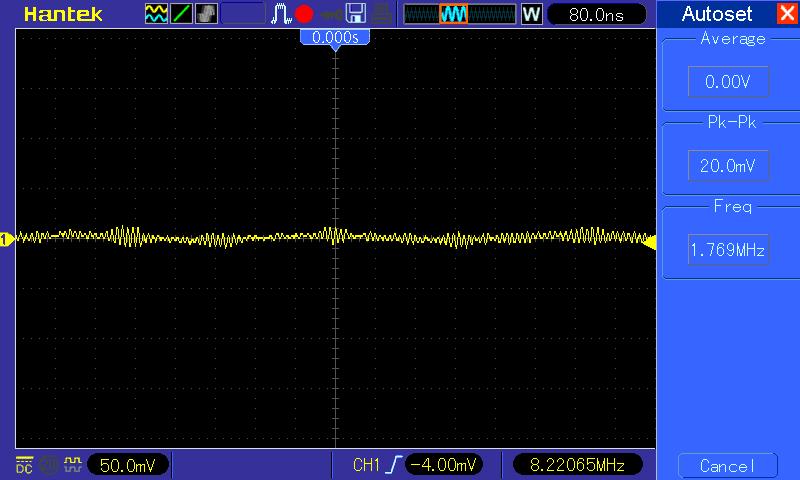

The IAM 81008 looks like it could have some potential.
It is a doubly balanced mixer, so here are some FFT captures of the port to port isolation. I am taking the IF at 45 MHz, and was listening to CW on 20, so the VFO is running about 59 MHz.
I am running the VFO flat out, so this could be right at, or slightly over, the spec for LO input. The chip is at 8 volts, again the maximum recommended operating spec for this device. Max, period, is 10 VDC.
Capture 1 is the VFO amplitude at the LO port of the mixer. I put the pip at the horizontal mark to make it easy.
Capture 2 is at the IF port - the LO is suppressed about 25 dB.
Capture 3 is at the RF port - LO suppression here is only about 17 dB, and some spurious response is showing up.
I haven't looked at the rules since last summer, but I doubt that this meets the rule for spurious emissions, so something more is needed here. I do recall that the rule was that spur readings have to be taken at the antenna port - any suppression from a narrow bandwidth antenna can't be counted in meeting the rules.
The low pass filter at the antenna input should take care of this, so I took a look at it, and determined it's not working properly - at the antenna terminal, I am only seeing an additional 3 dB attenuation of the LO at 59 MHz. So, if I go with a wideband front end, that will have to be sorted out. The MW high pass filter looks to be working as intended.
I will probably follow up with a double conversion down to 9 Mhz to see if these chips have any merit, or not.
Win W5JAG

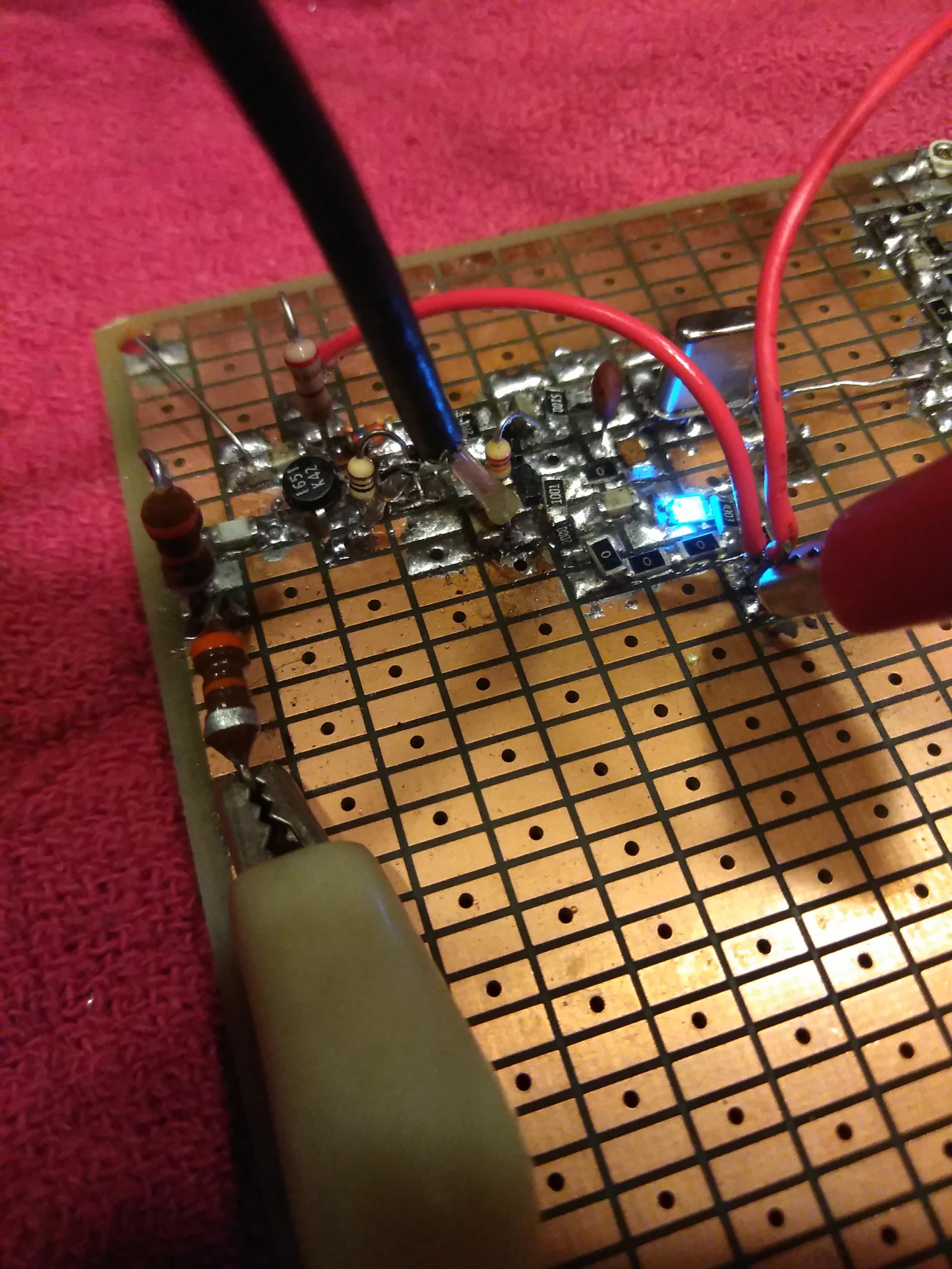

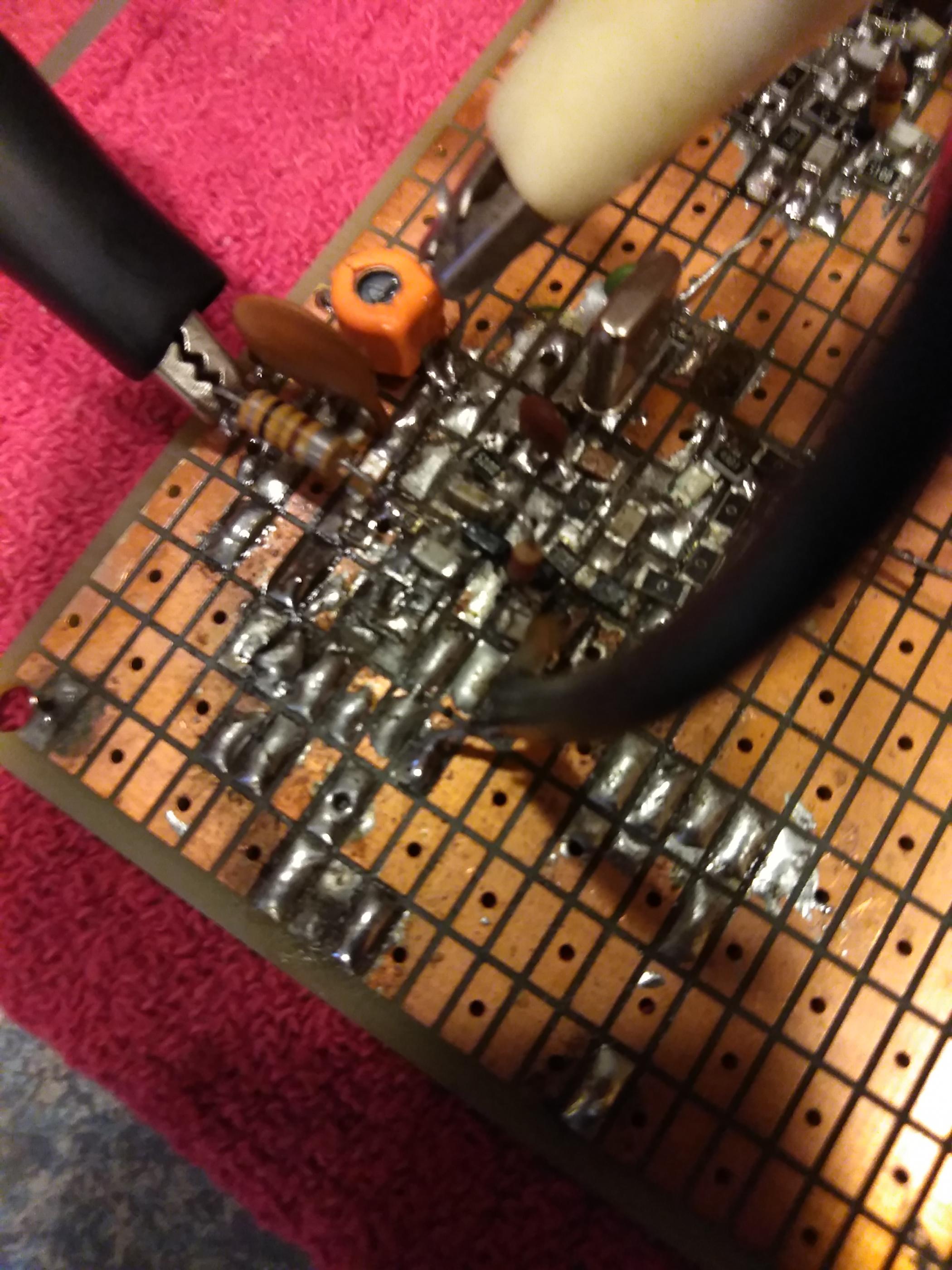

So, maybe someone more experienced at reading data sheets can look at this Toko sheet, which appears to be the only slug tuned SMD coil in the Mouser catalog.
I made a narrowband front end with the slug set to midpoint, and an appropriate resonating cap, only to find it was impervious to 14 MHz signals, and no amount of diddling would change that. I swept it with the Feel Tech function generator while looking at the FFT on the Hantek, and resonance was well into the low VHF range. I pulled the coil, measured it as best I could, and found it was nominally about 0.23 uH, and can be varied from about 0.2 to 0.3 uH. Thinking I had damaged it, I checked another and got the same result. Maybe not coincidentally, 11 pf and 0.23 uH is resonant at the 100 MHz test frequency specified.
Looking at the sheet, I thought I was getting a slug that would go from 0.05 to 2.7 uH.
So, I backed up and made a single tuned circuit with a toroid and a link, that worked OK, but looked too fragile for the rough roads around here.
I switched to a fixed inductor, and instead of a link, rigged up a series capacitive divider to get a Lo-Z point for a 50 ohm antenna, as well as a Hi-Z point for the random wire I am testing with. This looks like it might work, and the trimmer can be substituted with a tuning diode that can be tuned remotely if I stay with just one pole, or multiple poles can be stagger tuned to make a fixed front end.
I probably need to diddle with the capacitor values in the divider some, this is just for a test of concept.
I was listening last night with this set up hooked to the FT-817 as a 9 Mhz IF, RF amp off, and 20 dB attenuator turned on to make the FT-817 as deaf as possible, and heard a local guy about two towns north working phone on 20. From about 11:00 PM local to midnight, he worked Nebraska, Michigan, Indiana, Minnesota, and Wisconsin, and, with the random wire, this set up could Q5 copy every station he worked.
I ordered some more of those HP mixer chips, but haven't had a chance to do anything more with the ones I have.
The board looks just flat out awful at this point. It is not apparent from the picture, but I am starting to mix in some 0805 with the 1206. I have 0603 also, but haven't tried any 0603 yet.
Win W5JAG

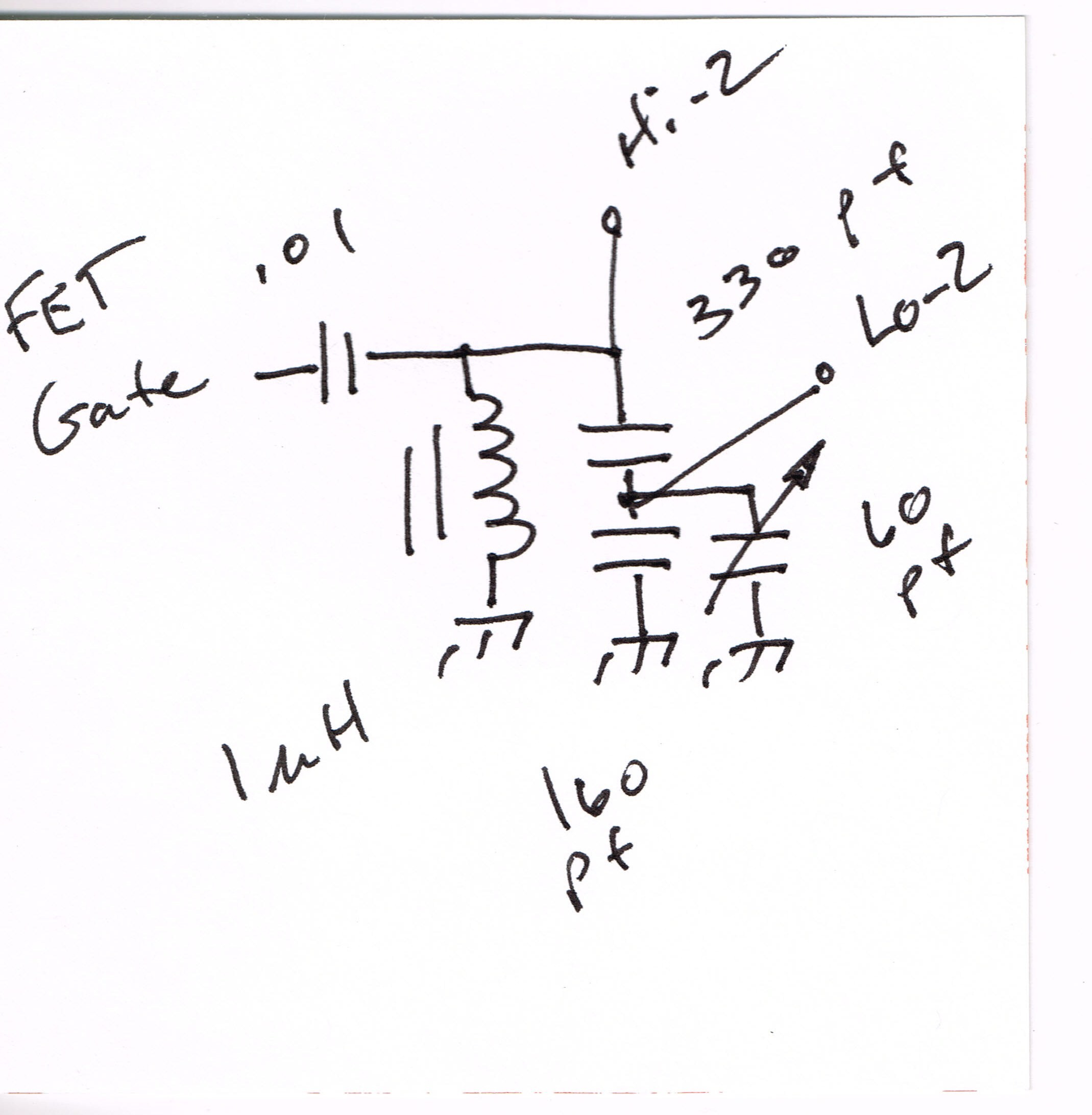

I played with this circuit for an hour or so last night.
I set up the FY6060 as a signal source at 14 MHz, injected into the "Lo-Z" series point, hooked the scope up to the gate, and peaked the trimmer cap for maximum response.
I then swept it with the FFT, and found it was actually resonant at about 12.5 MHz, the trimmer was just going to minimum capacitance. I changed the lower cap to 130 pf in parallel with the trimmer, and this brought it to resonance in the twenty meter band.
It doesn't behave like other single tuned circuits I've played with / used. Instead of a sharp response on the resonant frequency with a steep slope, if the Hantek FFT is to be believed, and I am testing this correctly, it has a very flat response across the resonant frequency, with very shallow skirts. Shallow enough that I only saw 6 dB difference between the original resonant point and the bottom of the twenty meter band. Once modified, I didn't have any trouble finding a point where it was ruler flat across the twenty meter band, together with a good 75 Khz either side of it.
I"m aware of Q, but won't pretend that I understand it. I came across some slug tuned coils in my junkbox that would work here, and eliminate the need for the trimmer cap, and that might have a sharper response than this molded inductor, but I'm not sure the broad bandwidth is a bad feature. A few poles of this would sharpen the filter, and it should not need to be peaked from the front panel. I just want to keep what I don't need out of the weak mixer.
Win W5JAG

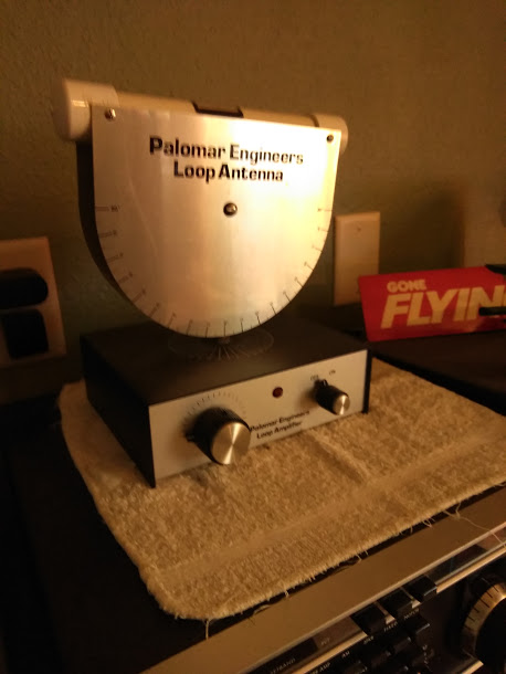

That's AM radio in style. If you can find ( or make ) a loop antenna, it helps a lot with BCB reception.
My last remaining Collins general coverage receiver - I don't know what agency specified this green finish, but I like it - reminds me of elementary school! Swapped an extra Drake R-7 even up for the 51S-1.
Win W5JAG
Win W5JAG
I once made a loop antenna from a copper tube, about 2 meter diameter, with matching anode coil of the same inductance, to tube both by a single 2-gang cap, with 12AT7 cascode. It was pretty cool! I listened to hams at 3.5 mHz talking about sound quality of their transmitters and microphones. 🙂
The receiver I used then, was a BC-348, and a Fisher stereo as a second converter and IF. 🙂
AFAIR,it was tuned to 1600 KHz - IF of BC-348.

....The low pass filter at the antenna input should take care of this, so I took a look at it, and determined it's not working properly - at the antenna terminal, I am only seeing an additional 3 dB attenuation of the LO at 59 MHz .....
So, it occurred to me that attaching a random wire antenna to a 50 ohm filter port might not accurately (duh) indicate whether or not the filter was working properly.
I put a 47 ohm resistor to ground on the input of the hi pass filter, and another 47 ohm resistor to ground at the output of the low pass filter, and retested the filter.
The signal generator is the cheap FeelTech FY6600 waveform generator. The measuring device is the Hantek 70 MHz DSO. Test frequencies were 30, 40, 50, and 60 (upper limit of the FeelTech) MHz. Signal amplitude was 200 mv p-p. At each test frequency, I checked the FeelTech output, and reset the level to 200 mv p-p, so the filter saw a constant amplitude across the measurement range.
The first FFT is at 30 MHz, and in order, 40, 50, and 60 MHz. Horizontal divisions are 15 MHz - I re-centered it on 75 MHz so the 12.5 MHz displayed by the scope tag is not applicable. Vertical scale is 10 dB per division
The low pass portion is five poles, intended to begin attenuation at a bit past 30 MHz. It appears to be working properly, possibly a few dB better than predicted, considering this is pretty mediocre test equipment.
The 5 pole BCB high pass filter is a virtual brick wall. At 2 MHz, the test signal is there - at 1.75 MHz, it is basically just gone. These measurements are consistent with the observed performance. Even the strongest local BCB stations (5 kw daytime) are undetectable unless the high pass filter is bypassed.
