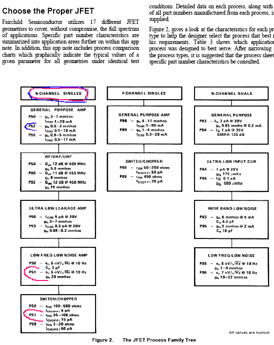

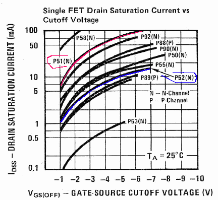

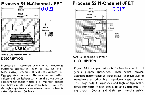

Did I already give a JFET rant?...
There are only a dozen(+/-) JFET masks/processes. There are 7 billion sort-out JFET part numbers.
Some users need super-low gate leakage. Some users need high-selection breakdown voltage. Some needed a super-low price and got a low-spec part number the maker could fill with "rejects" from high-price part bins.
For RF, you mostly want enough Vgs(off) to cover your signal, and enough Idss to swing the output (possibly even when de-biased by AGC).
For UHF RF you want the most Gm for the least C. Frequently this leads to super high I thus high Idss. There may be other issues with source lead inductance yadayada. If you are exploring the old spark-gap band, this hardly matters.
Some users need fair-matched pairs; not 1% but maybe 10% within a box/reel, so push-pull things work sweet. This might include you.
So yeah: mostly you pick an in-stock part with tolerable Vgs and Idss and low price, buy 100, and hand-bias, setting aside ones that don't reach your goal.
Here is an old process-selector page. I've marked some for some reason, probably audio. A few JFET datasheets still cite a Process Number. When in doubt, P50 will work well enough to clarify why you might prefer something else.

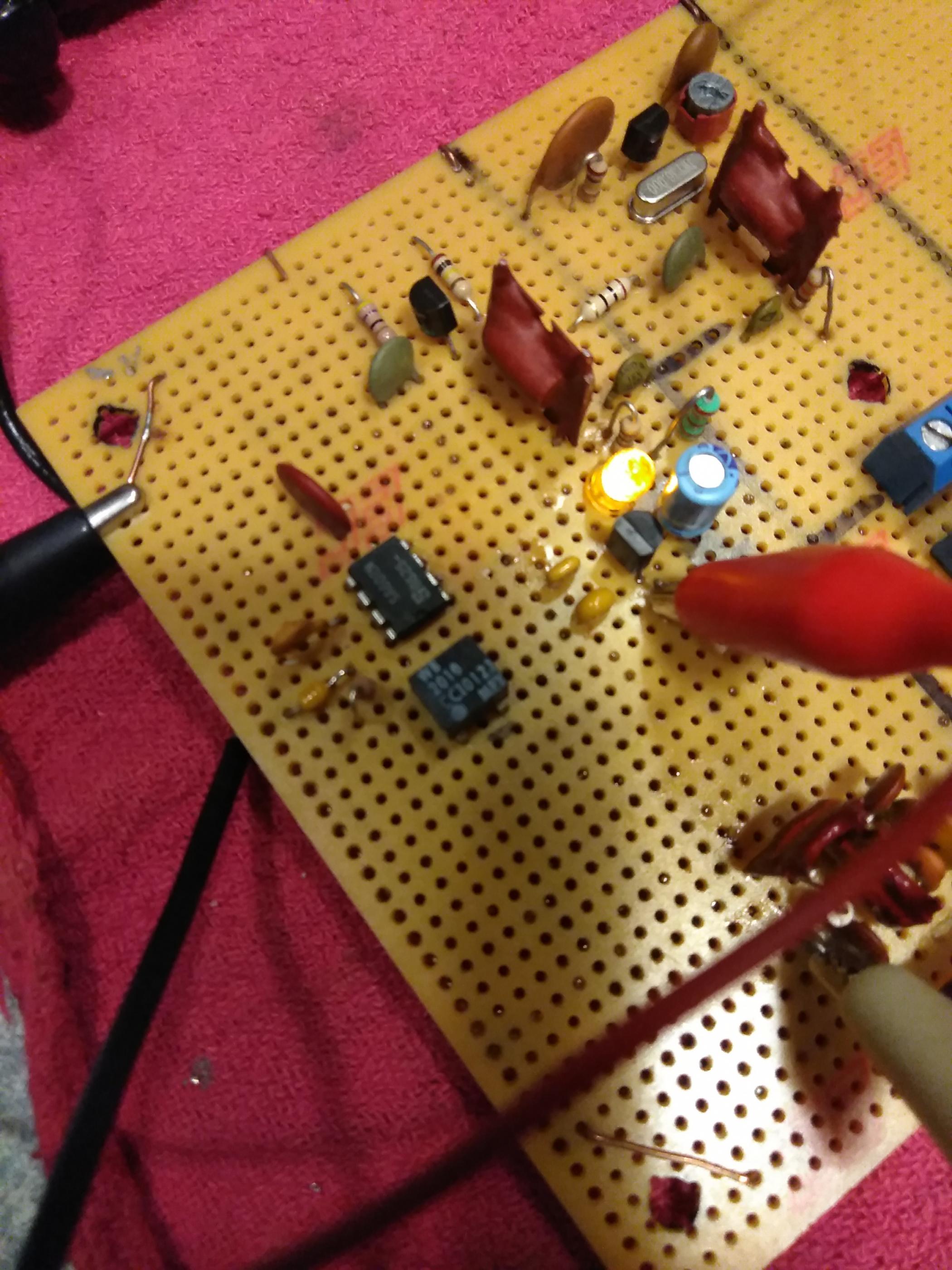

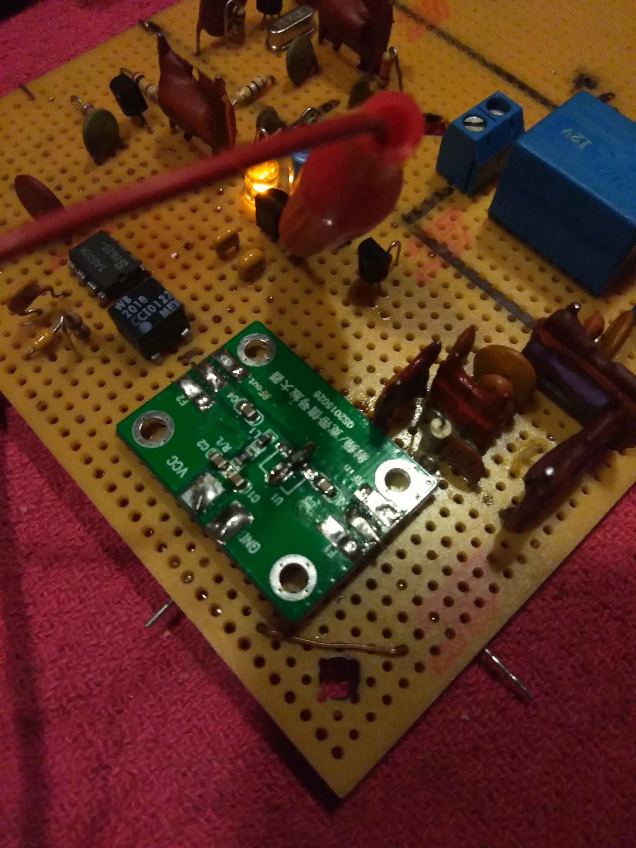

The broadband "preamp" should arrive later this week, so I pulled the narrowband amp to allow installation of the broadband part, and, at the same time, reoriented the chip on the board for a better layout, added one of the broadband CoilCraft transformers from an earlier post to allow for a balanced input to the chip, and the outcome was just terrible.
The result was severe cross modulation, worse than when I was overdriving the diode mixer, which was really, really, bad. This didn't make sense, since everything I did should have been an improvement. I didn't tinker with it Monday evening, but I did notice it didn't seem to work as well as it had the previous day. It didn't take long to work through the possibilities and isolate it to a bad SA602 chip.
So, I replaced it, and while the replacement was a lot better, it still didn't seem right to me. Counterfeit, junk, or bad chips? They did come dirt cheap surplus from China .....
Easy enough to test, as I had some real plastic DIP chips from the time the part was first introduced. A couple even had the old NE Signetics prefix. I pulled the SMD part, and installed a DIP Signetics marked SA602N with an 8625 date code. This predates the "improved" premium part, so would be equivalent to the modern NXP SA612. The old premium part would be 602AN.
This worked as expected. I threw what was left of the the strip of SMD SA602 in the trash.

The broadband preamp, in a hasty test installation.
The SMA fittings are soldered on both sides of the board, and I decided the risks of trying to remove them with my tools outweighed the benefits. I will have to move the mixer to be able to lay the board flat. These prefab boards are not that big, but they are bigger than my DIY layouts, and bigger than I budgeted for.
It works, no real opinion on it one way or the other right now. It's only getting 8 volts, it probably needs more than that. Seems like a decent quality board for $6 USD.

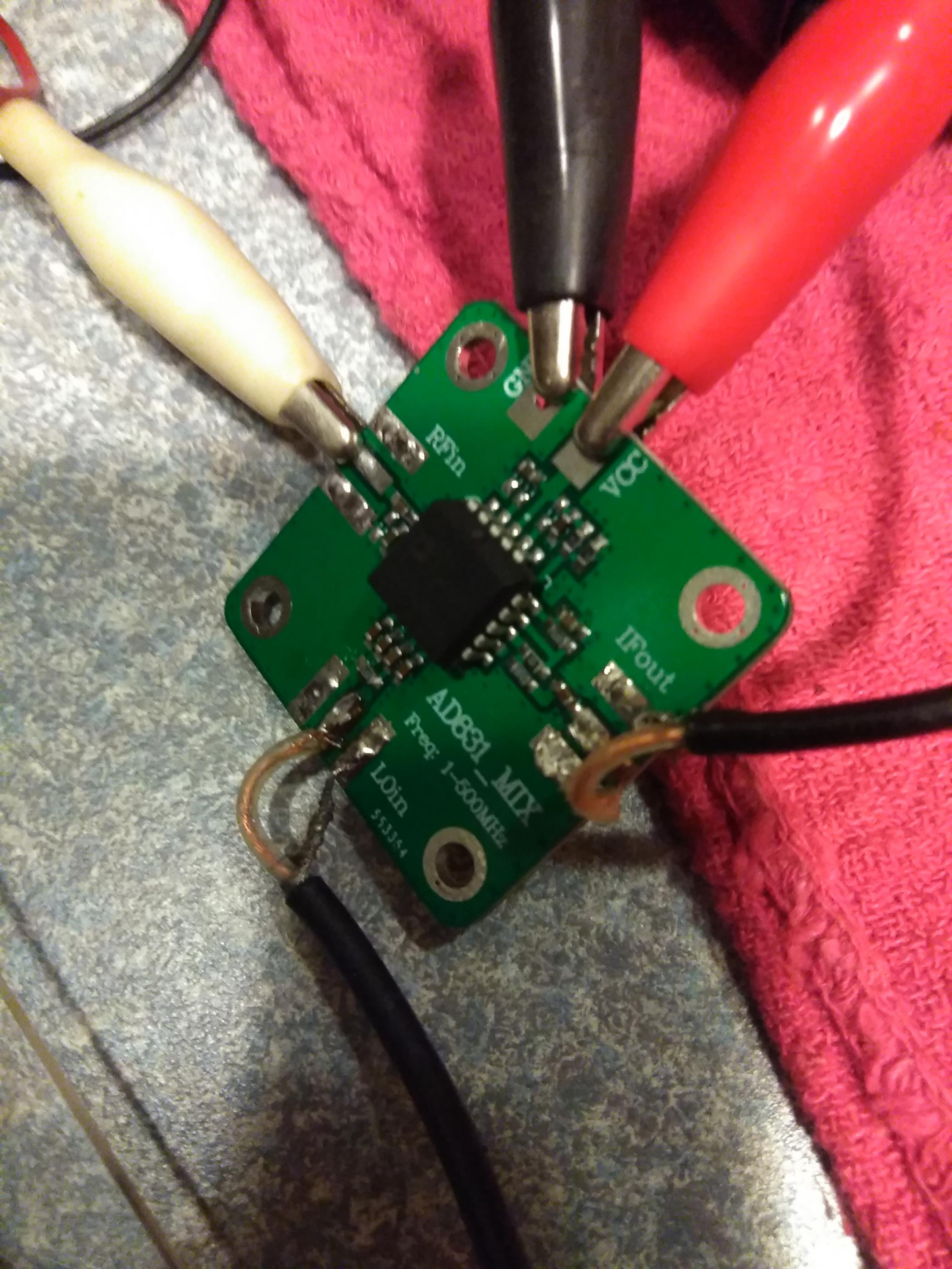

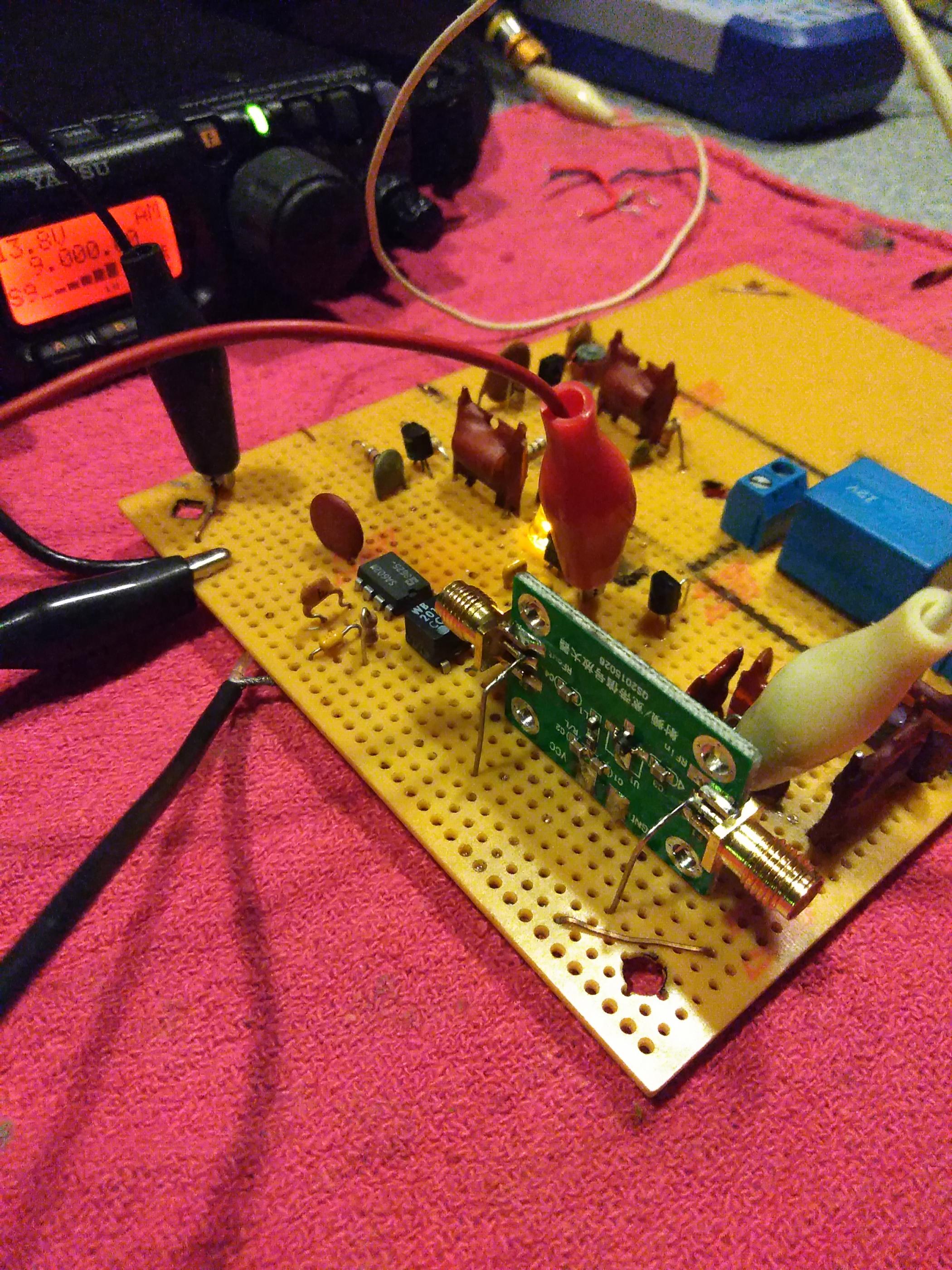

This is the ebay Analog Devices AD831 prefab mixer board, behind the narrow band MOSFET RF amp.
There are some things I really like about this - low LO drive, preassembled, cheap price. Some things I don't like are the size of the module, and it has a bone crushing current requirement - 125 ma. It also has a narrow operating voltage range, 9-11 VDC. Right now I am running it at 8 VDC, and it seems to work fine, even though it is out of spec. I ran it at 10 VDC initially, and didn't like how warm it ran.
This setup works pretty well, I expect it would be satisfactory in actual usage.

Been using it for a week or so; my impression is still the same - the cheap AD831 mixer board with the narrowband 40673 RF amp and SG-9 IF board makes a very satisfactory single conversion radio. The sensitivity is good, the AD831 doesn't seem to care that it is not matched on either port, it doesn't show any sign of overload on big signals; no indication of local broadcast stations breaking through, AGC action is good, audio quality is good.
Actually, it is kind of refreshing to listen to a radio that doesn't go through multiple conversions, filters, DSP, etc. like has been the norm for at least the last couple of decades. They do sound different.
Other than a better tunable LO, I'm not sure there is much, or any, practical improvement to be had here, given that the end product is to be a single band mobile rig.

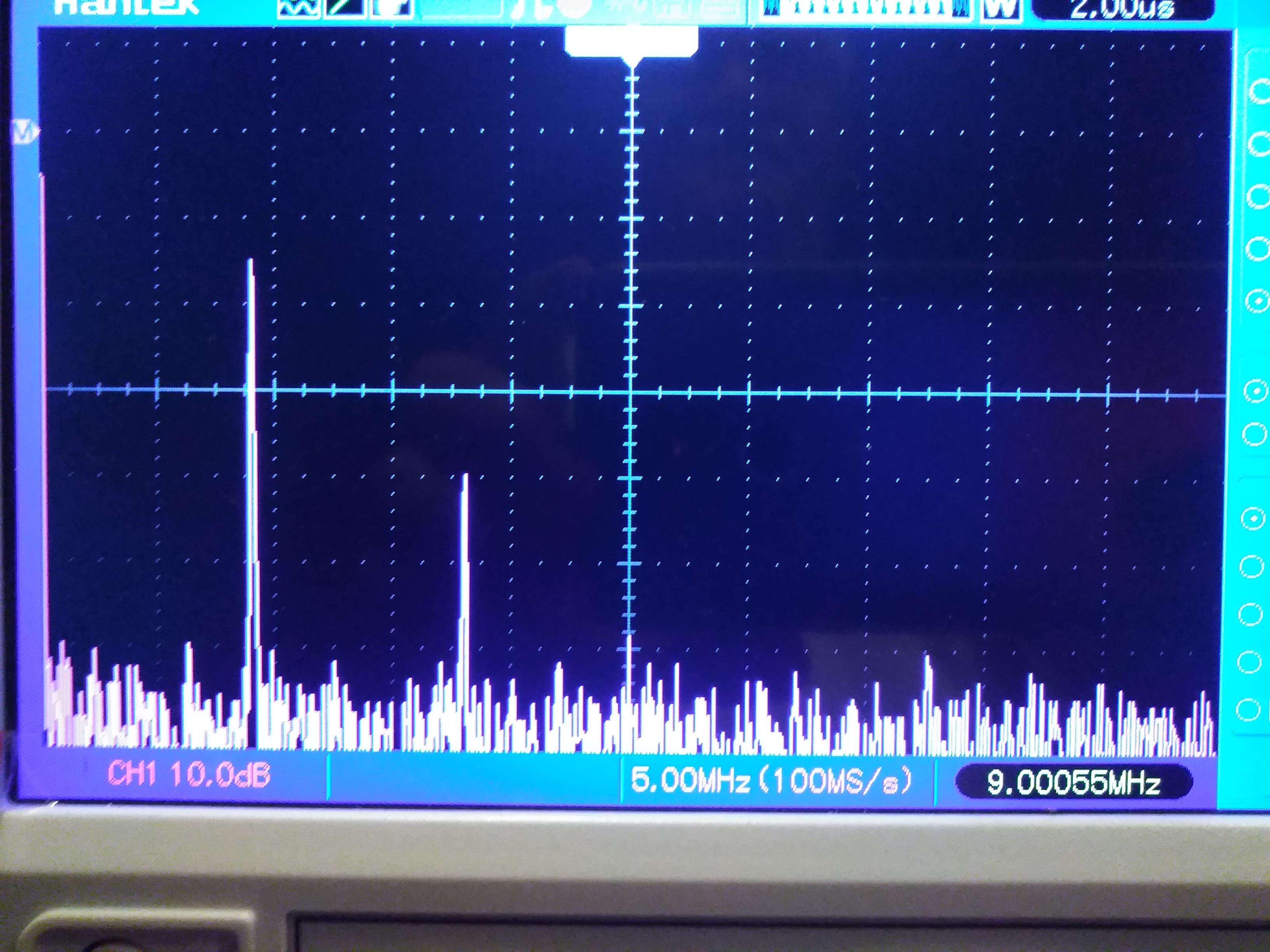

The pic is RF TX output. The second harmonic seems high. After the filter, the TX signal passes through a single tuned MOSFET RF amp, and then an untuned JFET buffer to the outside world. Drive is a 1 KHz sine wave from my audio generator. The SG-9 is not being overdriven; in fact drive level seems to make no difference. The second harmonic stays at - 26 dB at any drive level that I can see within the 8 bits of the FFT.

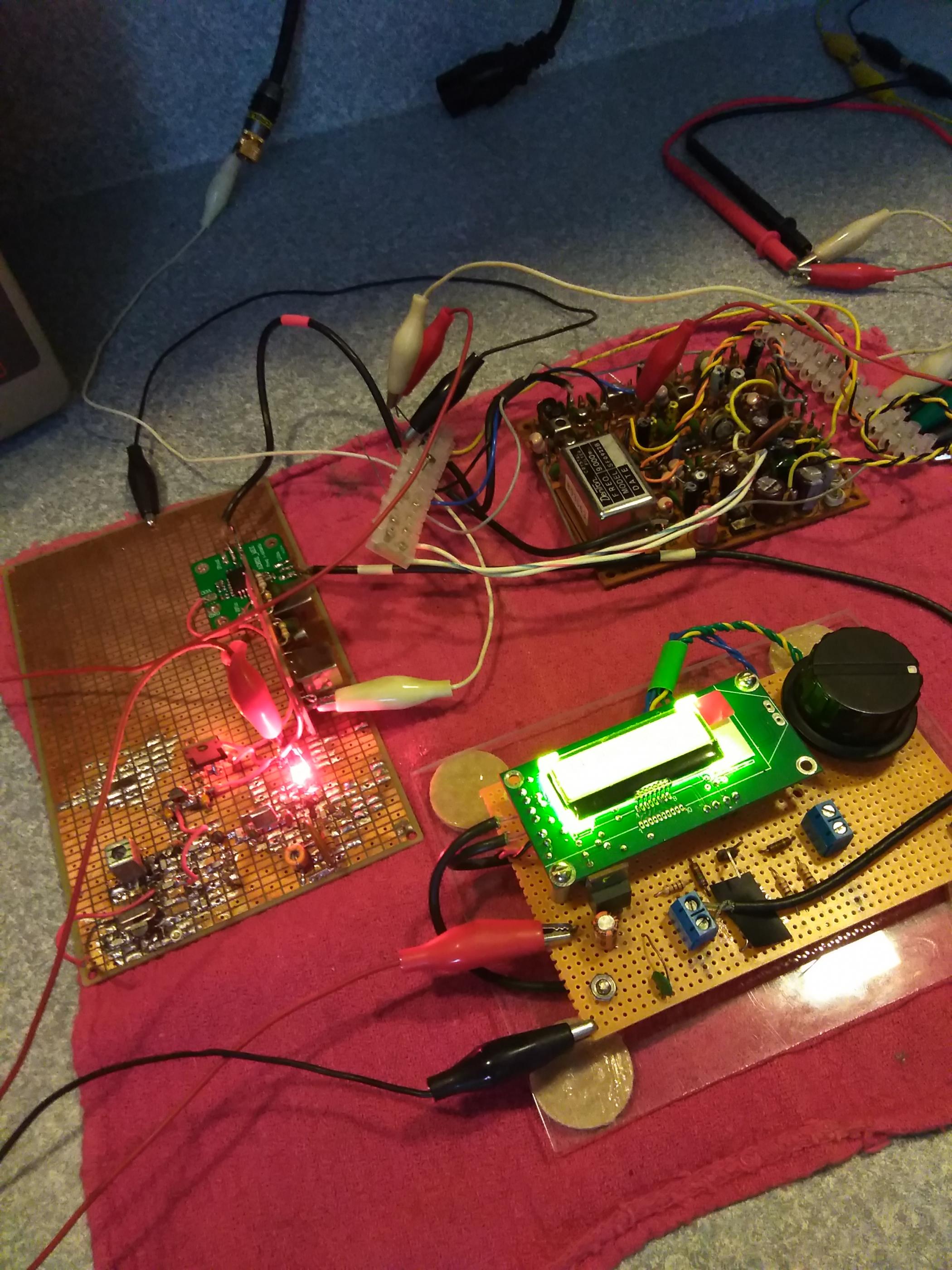

I've decided the RF performance of the MOSFET preamp / AD831 / SG-9 is completely adequate for the intended application. The AD831 looks to have a somewhat high SSB NF, but this does not seem to be a real world issue in a single conversion configuration, when preceded by the reasonably quiet RF amp.
I've thought some about the TX part of the transverter, but haven't melted any solder yet.
edit: Is NF anything I should be concerned with in a TX mixer?
