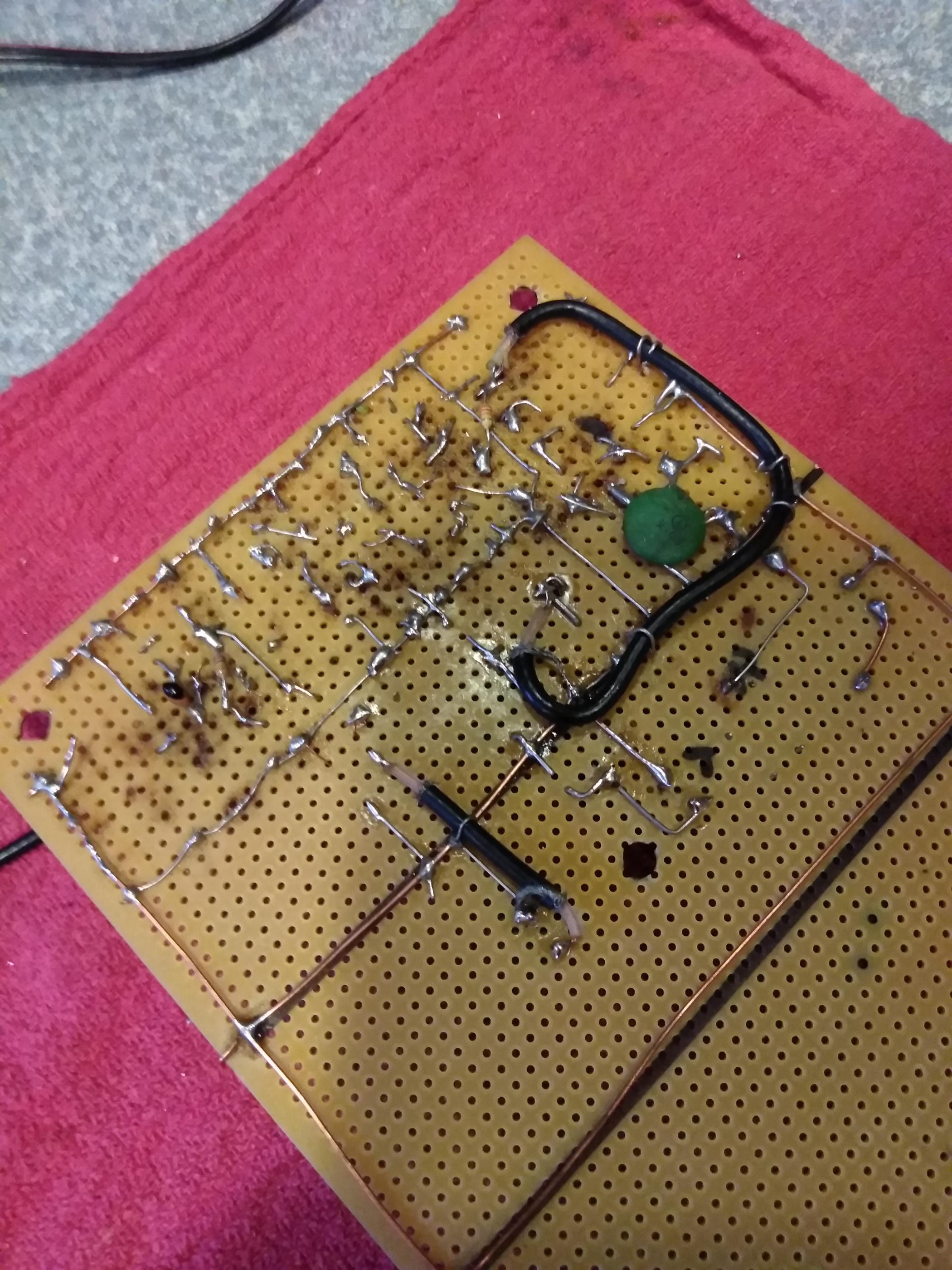

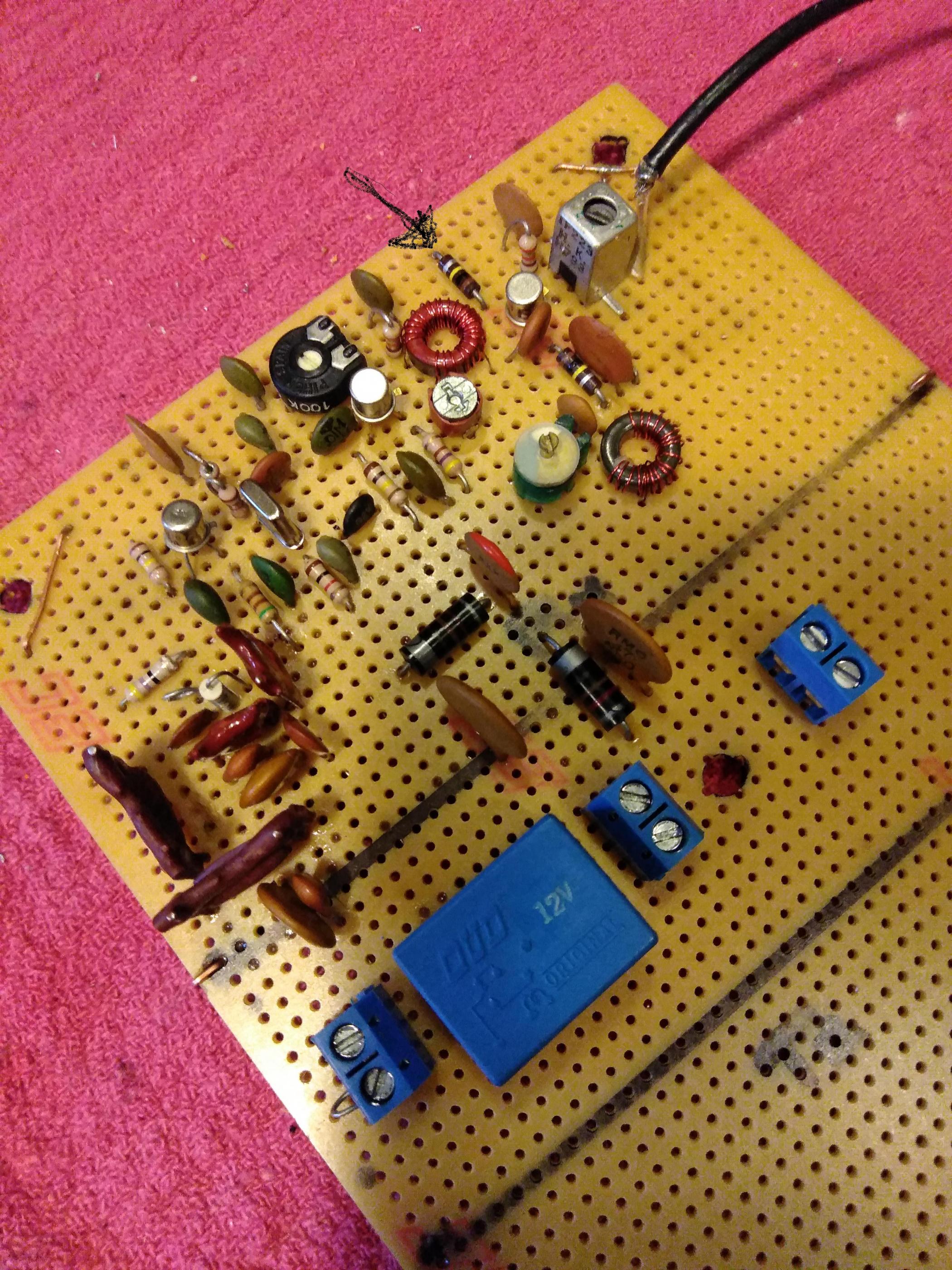

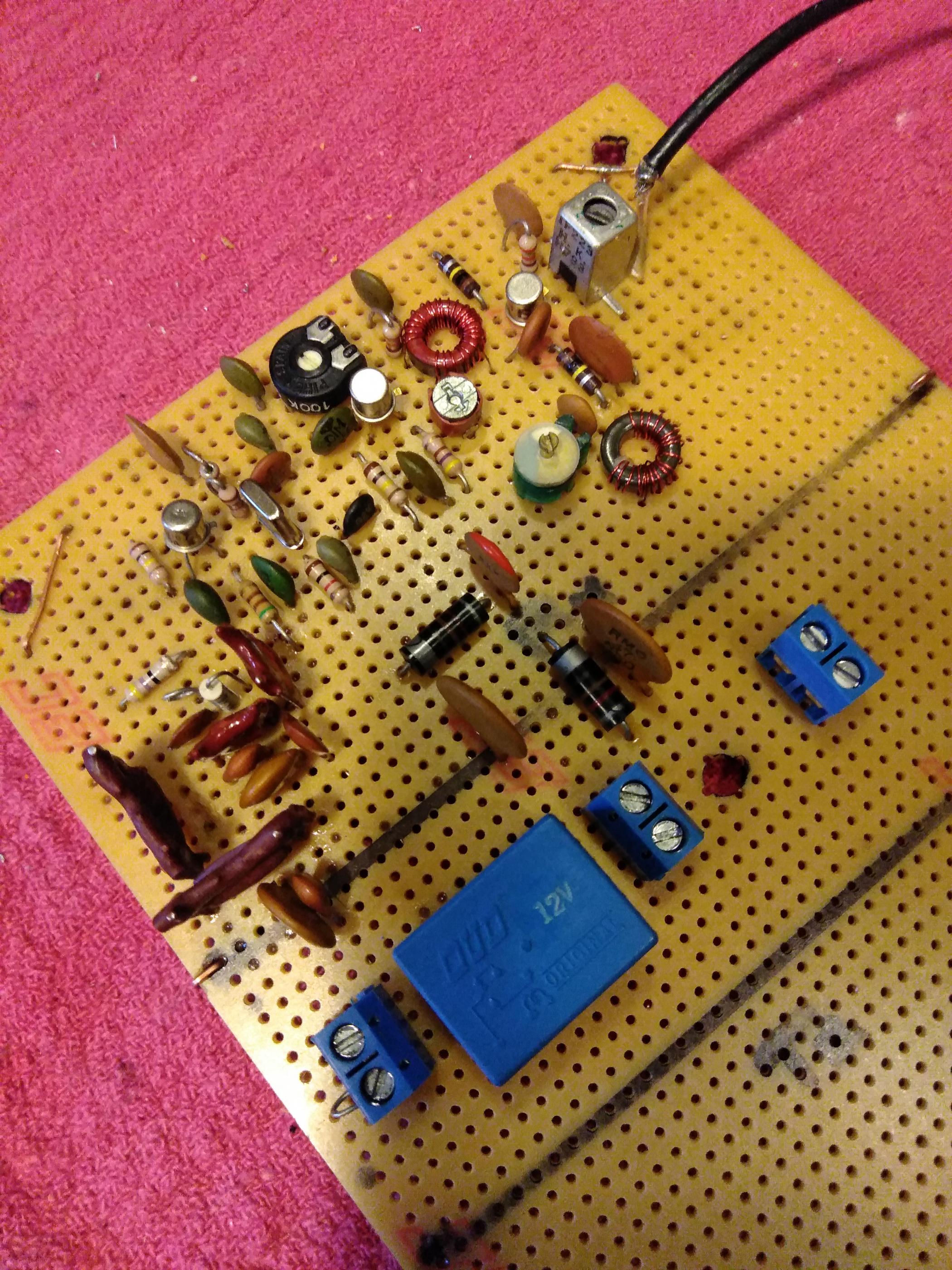

I added a low pass filter ( 90 MHz - 3 dB ) to the tunable LO, and a single tuned circuit to the fixed second LO to try to cut down on the junk going into the unbalanced mixers. The single tuned circuit is very sharp - it can completely eliminate the second LO when off tune. The coil is wound for about 1.3uH, and with the capacitor, it can tune the second LO at either injection frequency - 54 Mhz or 36 MHz to select sidebands.
The second mixer just isn't right - after the picture was taken, I added a pot in the source to play with the current, and may fool with the bias on the gates; but it is way too noisy. It's better when the output is chased with a filter, but I just don't think it's right. I don't seem to be getting anywhere with it, and I can't seem to fix it. As a last resort, I guess I could replace the FET in the event it's been damaged - in addition to the lightning jolt, it's been soldered and unsoldered a lot, but I think the likely outcome is that it will be replaced with something with at least some balance.
With the FT-950 fried, I'm using an FT-817 as the "IF". This is not a great receiver, but I don't think it is the problem. It's a bit of handicap not having anything suitable to look at the mixer input and output.
At least my soldering is a bit better - the FM tuner board soldering, back around post 86, is really rough looking - no way to sugar coat it, it's just downright bad - and it caused me some real difficulty. It seems like there is just not enough flux in this new solder I've been using - I'm now adding flux to the joints before soldering, and it seems to have made a big difference.
Win W5JAG

The first mixer is a genuine RCA 40673. The IF amp and second mixer are marked Siliconix 40673.
Killing some time tonight, I tried grounding the case of the second mixer, and observed a pretty dramatic noise reduction. I also observed that this completely removed any effect from the variable resistance I placed in the source. I observed a similar effect with the other Siliconix. The RCA does not exhibit this effect.
I suppose it's possible one or both are oscillating, but I probed them with a wavemeter and didn't find anything. I had some concern putting a tuned circuit in the gate would make an oscillator, but the RCA responded real well to this when I built the first mixer on a piece of scrap board. The Siliconix doesn't seem to.
I'm not sure what to conclude from this. I'm wondering if one or both of the Siliconix are junk. Or maybe they're not really 40673's. I bought them probably thirty years ago, before counterfeit junk was a concern. A real 40673 should have no problem with 45 Mhz, and apparently doesn't care what you do with the case. I have some "better" TI and Motorola MOSFET's. Maybe I need to try them. I don't have any more RCA parts, and they are probably unobtainium now. Genuine ones, anyway.
Win W5JAG
Win W5JAG

The 100K resistor, from gate 2 to gnd, marked here with the arrow, should not be there.
Hard to tell from my lousy cell phone pics, but on the underside of the board, there is already a 100K 1/8 watt resistor from the source to gate 2 to bias that gate.
I don't know if this is the root of the problem, but it would be cutting the dc bias on that gate in half. May be a few days before I can check it out.
Win W5JAG
Win W5JAG
That 100K resistor was it.

It's comfortably receiving a Cardinals ballgame on a fifty (50 !) watt (night time) BCB station, 1.58 MHz --> 45 MHz --> 9 MHz, 20 foot piece of wire connected to the junction of the high pass and low filters, RF amp off, -20dB attenuator engaged on the FT-817. It's showing S6, modulation peaking to S8.
I'll probably tinker with the bias and source resistance to optimize it, then possibly dismantle it to play with some other ( balanced ) active mixer circuits.
