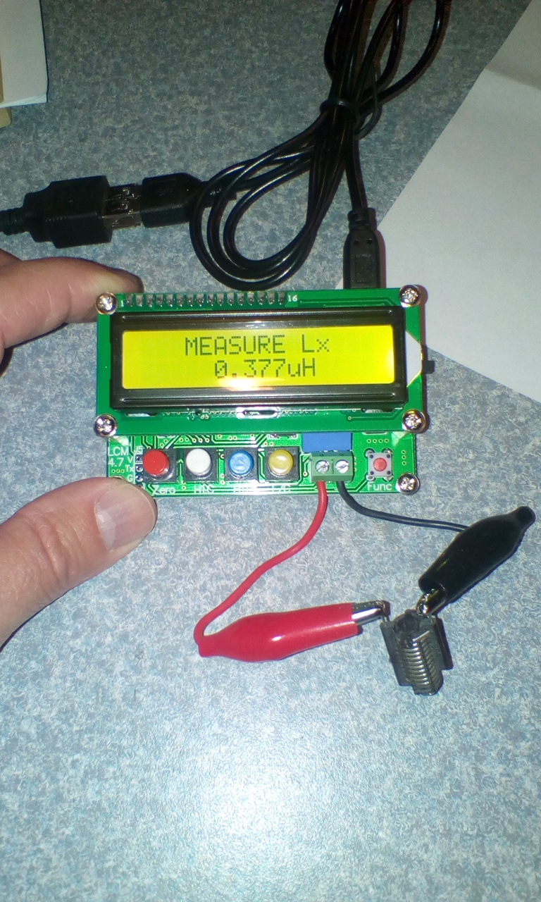

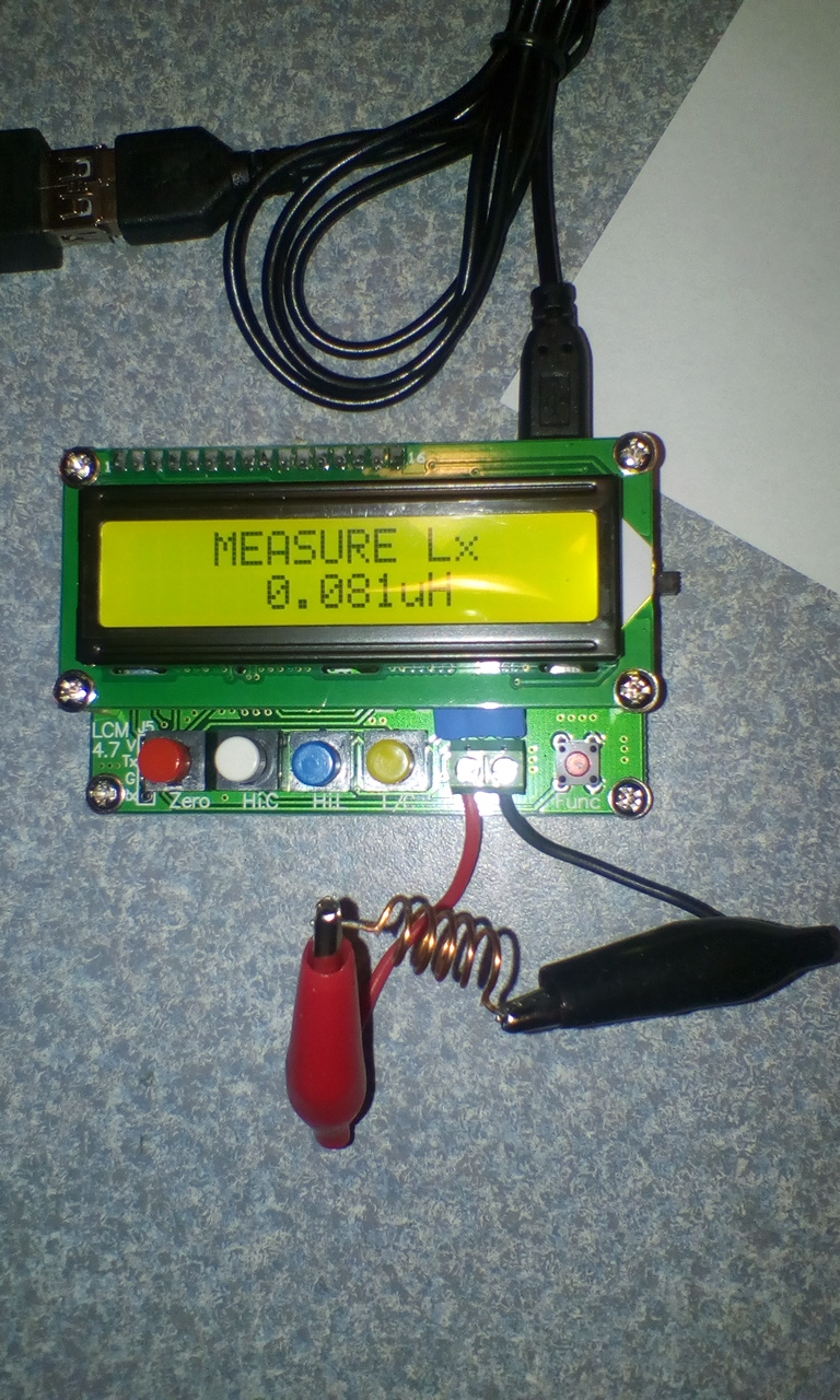

I'm going to have some LC circuits that I have no realistic way to accurately measure or characterize, so I thought I would try to select components as close to the calculated values as reasonably practicable, as a substitute.
I got an LC-100-A LC "meter" that has been on the market for a few years now from $13-25, or so, depending mostly on how fast you want it. I had been using a dip meter, but it is tedious, and ball park accurate at best. This gives only inductance, no other parameters, but for $20 ish, it's a bargain, I think.
Once calibrated ( easy ) this thing will measure a sack of coils faster than Jack can jump over a candlestick. It looks to be useful for all RF type coils. Pics are shown measuring a typical small value slug tuned inductor, and an air coil. I have not used it for C, yet.
I should have semi suitable coils in my parts inventory ( may not be shielded, though ), so, next stop, solder.

BTW for the inductance measurements above, one cannot
ignore the cables with the gator clips. That must be minimized.

...for the inductance measurements above, one cannot ignore the cables with the gator clips. That must be minimized.
It zero's out, more or less, in calibration. Cross checking it by measuring marked coils, it seems to read those correctly, or at least within their stated tolerance.

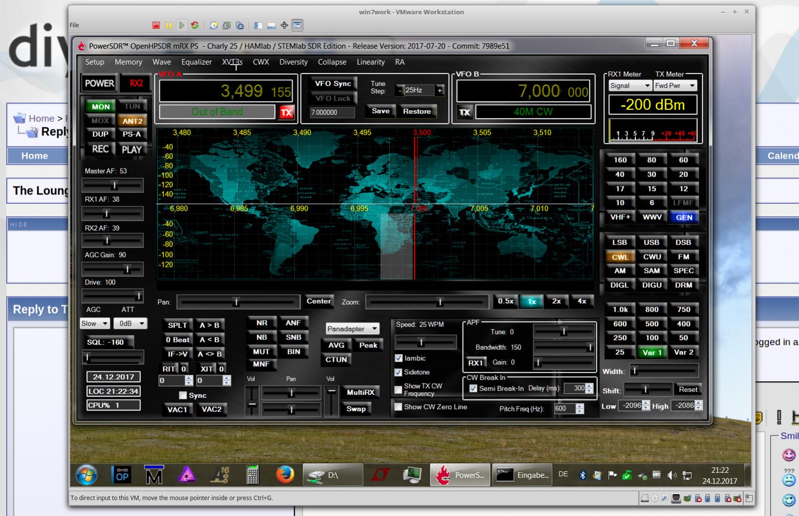

I've got the RedPitaya today. It is not much bigger than a credit card.
Gets quite hot & will definitely need a fan. I can see it on the lan and
ping it, but I have not been able to install some SDR software that
can use it.

Exactly that. I think it is available at Digikey, also.
I'm just trying the apps that are are delivered with it.
There is a signal generator, scope, FFT analyzer and
also a SDR, an implementation of HPSDR for it.
Currently, I'm a victim of the fact that I have spent much
effort to carefully hide my Windows virtual machines to
the network.
cheers, Gerhard, dk4xp

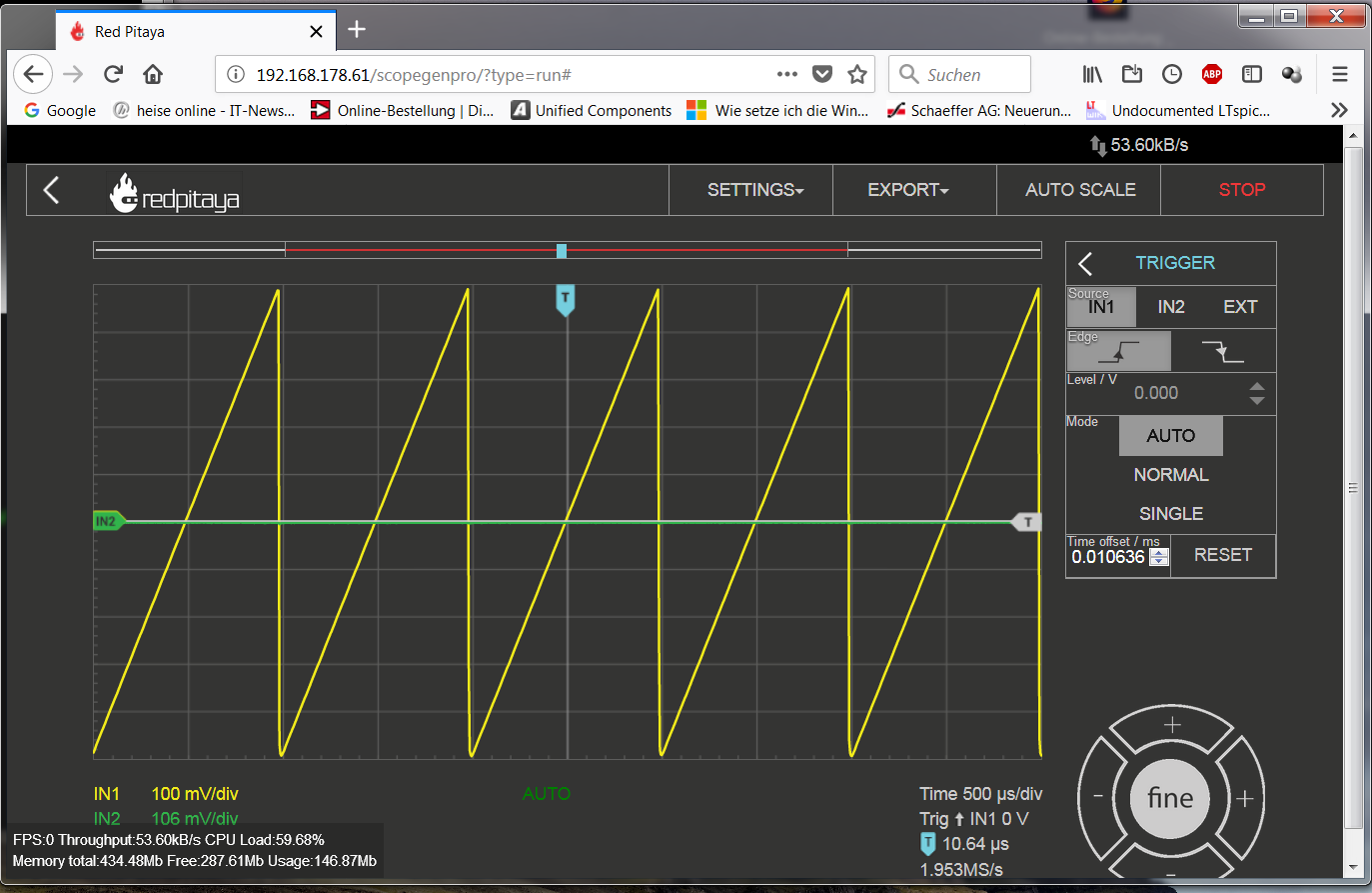

I wrote ping 192,168.178.61 Windows ping did not complain and pretended
that no other device in my LAN was visible. 😡
The SDR software still does not work, but the scope function does:
500 mV sawtooth from my HP3325B without the 50 Ohm load, so 1Vpp
is correct.
The scope function seems to access a web site in the Pitaya via firefox.
WOW, 14 bit 60 MHz scope!
At least the networking must be ok now.

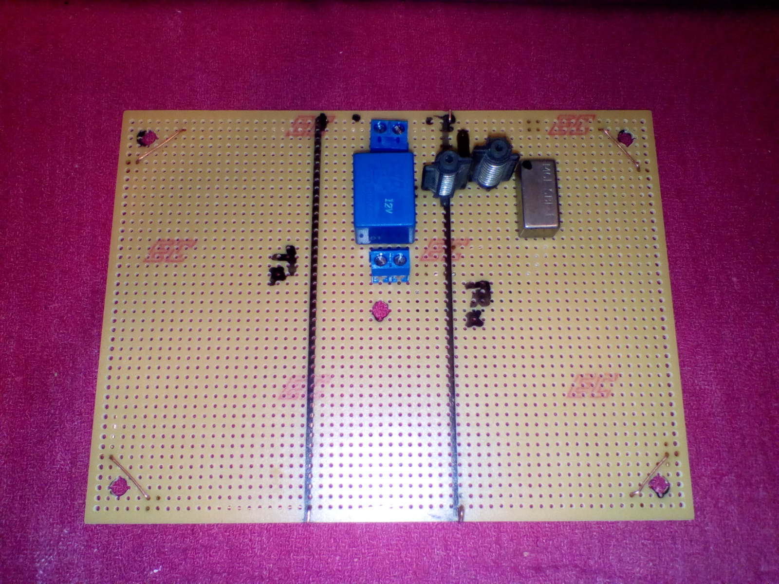

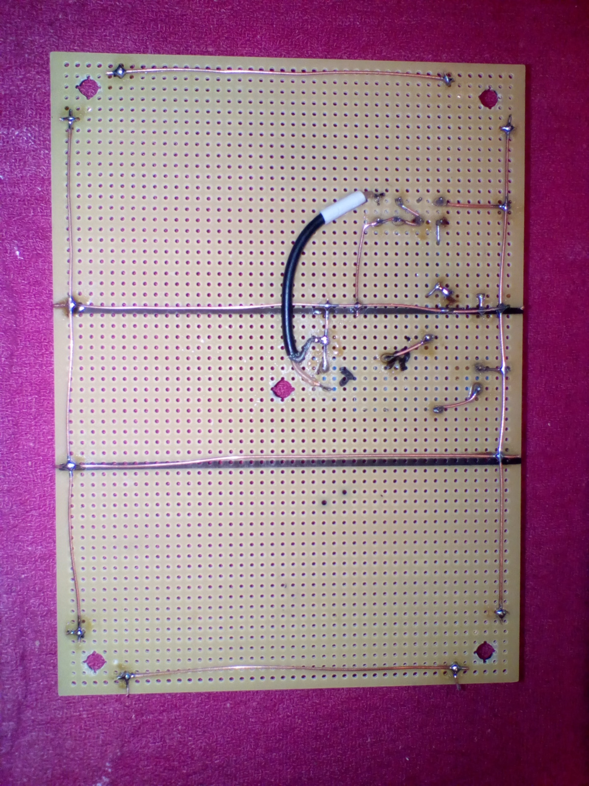

I finally got to burn a little solder on this project. It's been brutal cold here, and my ham shack is deeply cold soaked - like being in a meat freezer, so two or three hours was about all I could stand this afternoon ....
This board will be to convert the final IF ( whatever that turns out to be ) to 14 MHz via 45 MHz. TX on one side, RX on the other, T/R switching and misc. stuff in the middle. I put a relay in for antenna switching, for now. Not sure yet how I'll switch the LO's, or even if they need to be switched ....
I'm going to use the small aluminum box for the RF chassis, it's about 9 x 7 inches, so should be adequate. The xmtr pa will mount on the outside surface. This chassis is from an early crystal controlled, trunk mount / control head, 2 M FM radio I built, so won't need a lot of metal work.
Hopefully tomorrow I can finish out the front end, and test it for IF output at 45 MHz.

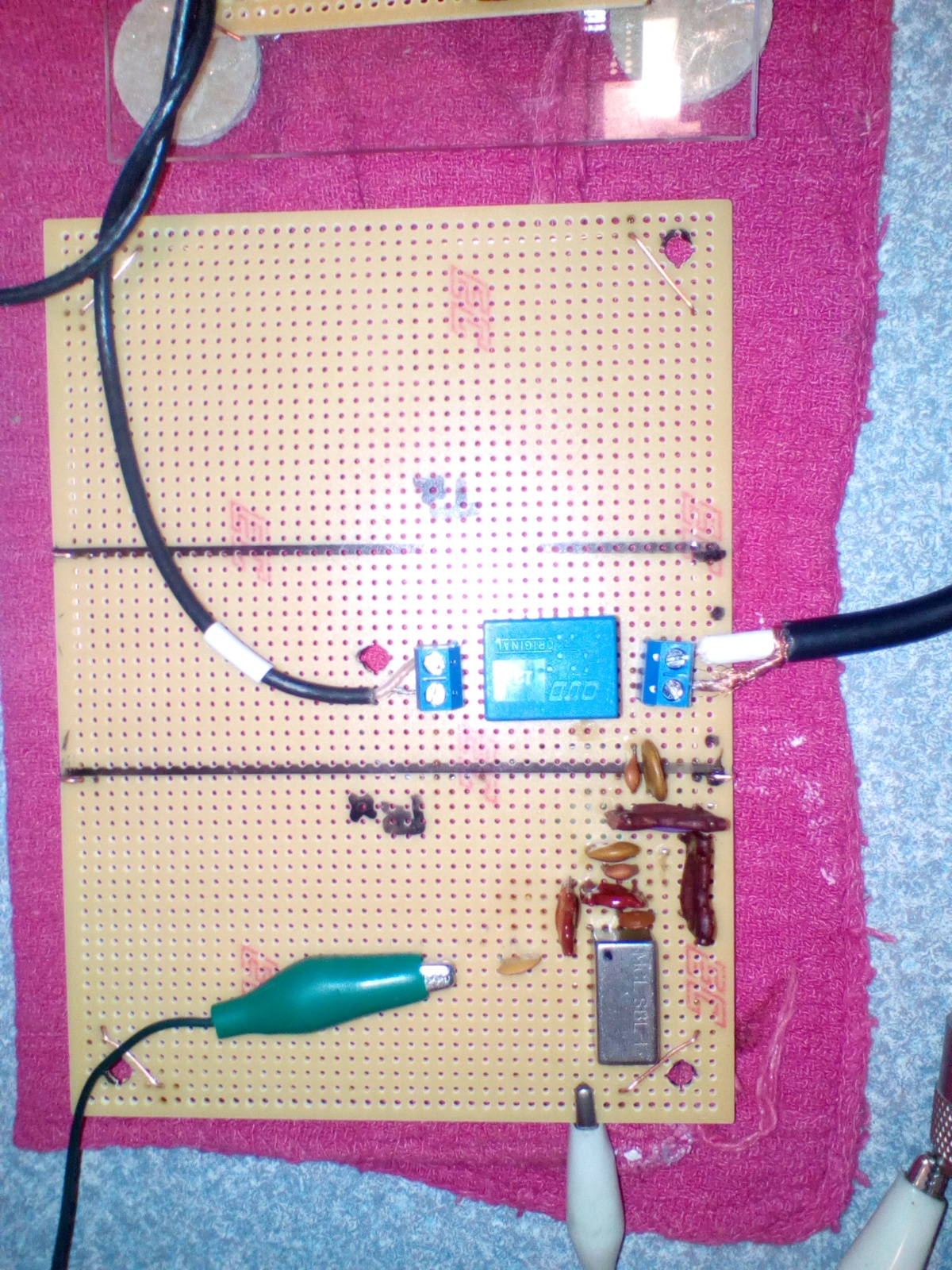

Modest success!
I didn't like where the IF port wound up, so I reoriented the mixer can.
I hooked up a two element beam to the RF input, the DDS to the LO port, and took the IF through a 0.01 uF disc direct to the #2 antenna input on an HF rig.
The background noise came up, and with a bit of diddling, got the Collins net on 14.263 MHz, even though band conditions are LOUSY here ....
The DDS needs to be calibrated - it's about 1.5 kc off. The sidebands are inverted - the rcvr is tuned to 45.000.00 LSB to get the net.
Not sure if I will stick with the SBL-1 or not, but, it's converting HF to 45 MHz .....

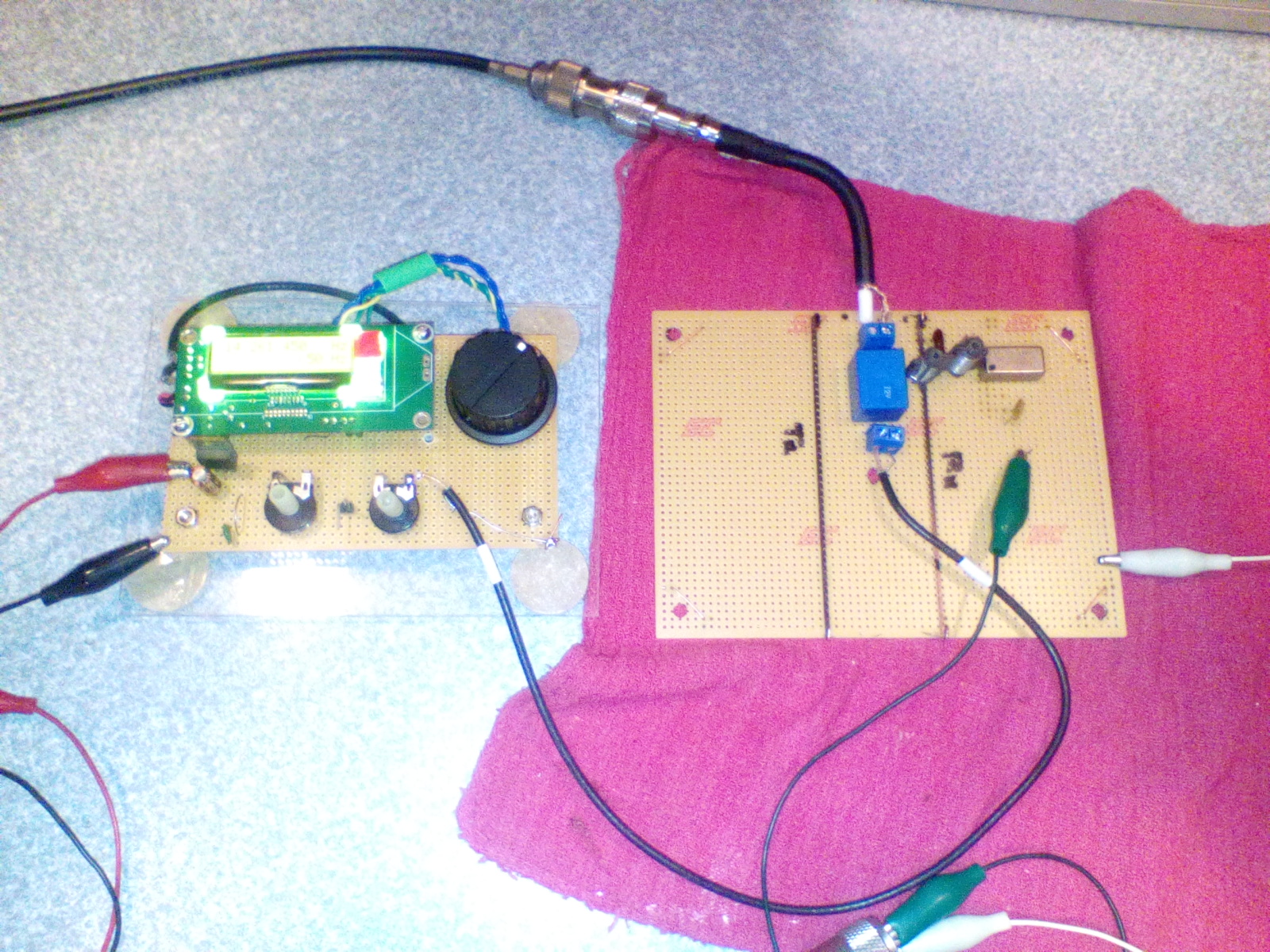

Modest progress.
A somewhat better front end. 5 pole high pass filter, feeding a three pole low pass filter, then into the RF port, basically bracketing the HF band 3 - 30MHz. The BCB interference plaquing the test setup is resolved. Tunable coils seemed goofy, since I have no means of sweeping them, so have been replaced with fixed inductors.
Less sensitive than I would like. The Rube Golderg attenuator on the DDS needs to go. I'm sure I'm losing signal taking the output through clip leads.
Still not sure I want to use a passive mixer. Listening to W1AW on 20m CW right now.
Win W5JAG
