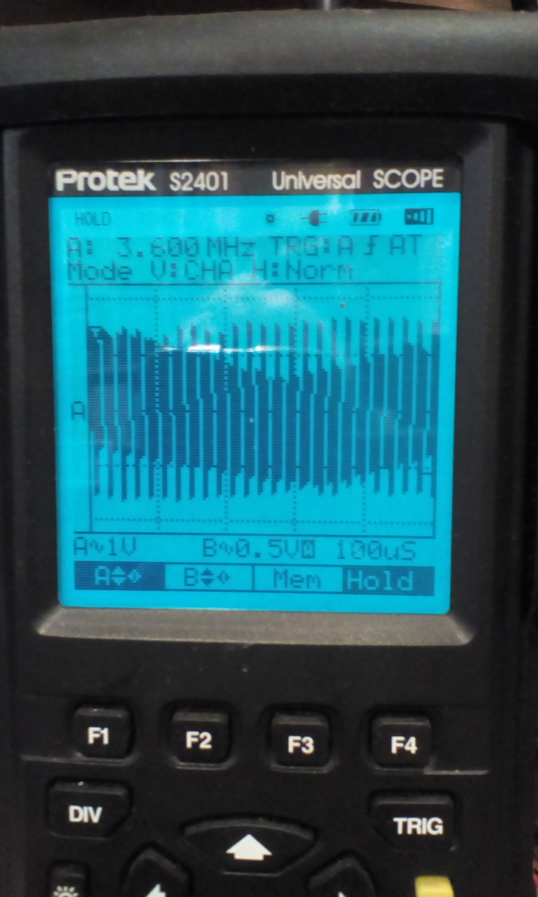

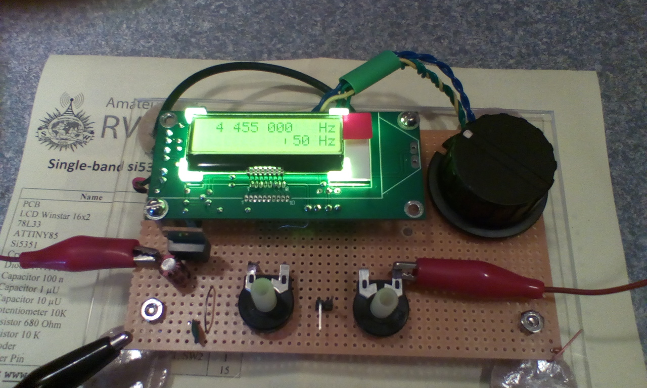

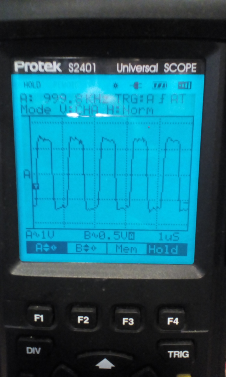

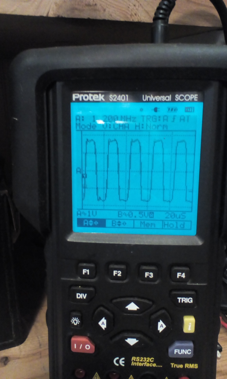

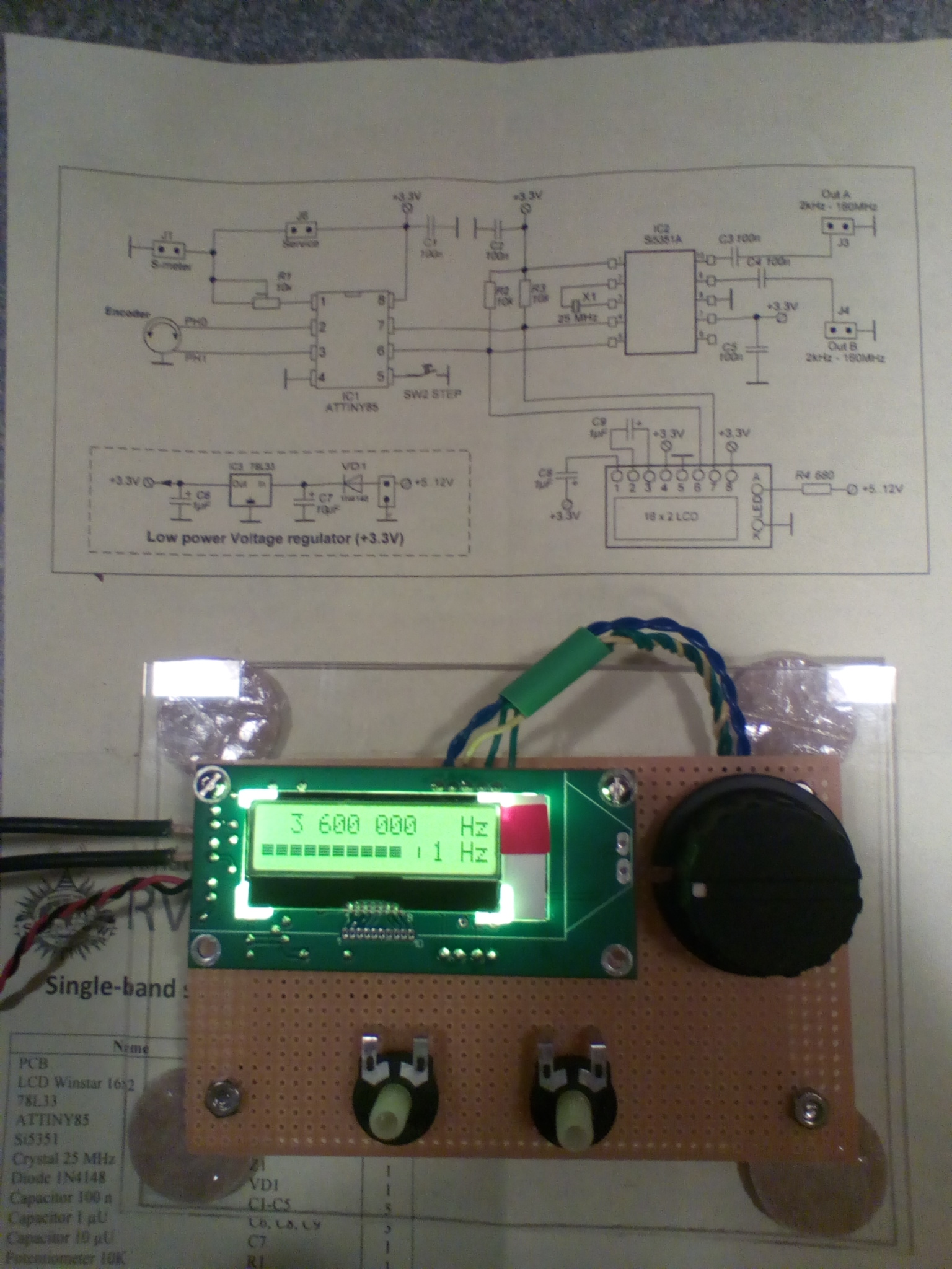

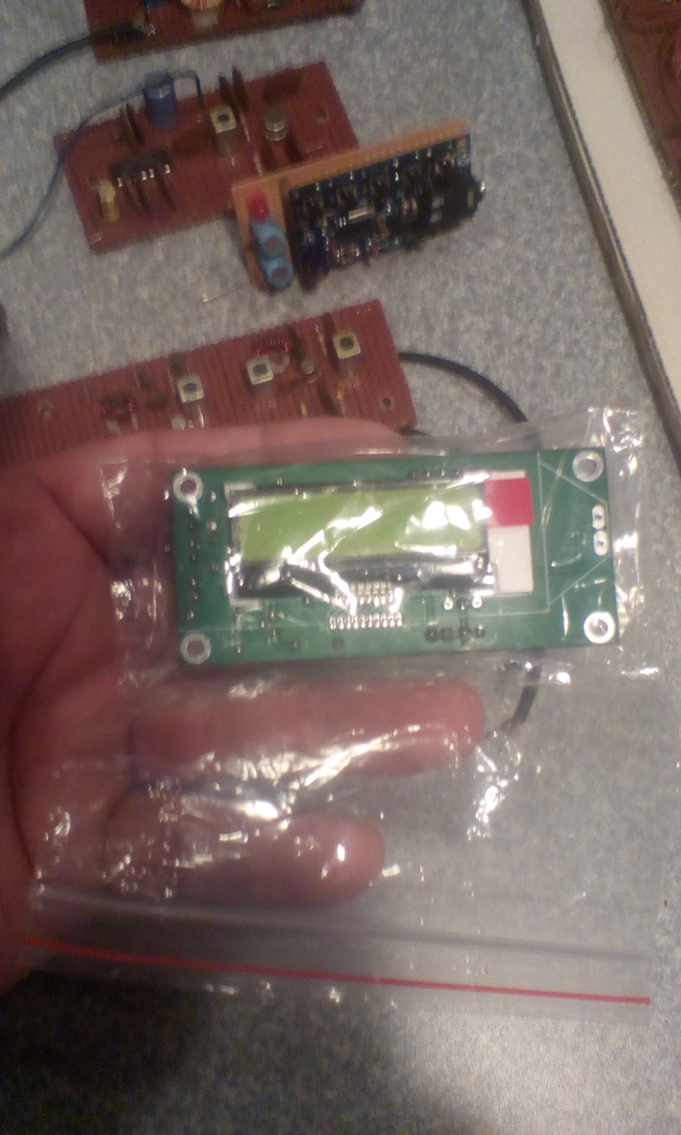

The DDS has arrived. As anticipated, it is quite small - looks about right for a mobile / portable rig. The idea here is to just put the whole DDS board in a control head, and run the RF back to the rig. I don't know how much RF this thing will put out, and whether cable loss will be a benefit or a problem. Using active mixers, I suspect cable attenuation will be a benefit, since I only need 60 -100 mv of RF injection.
Nor do I have any test equipment that can directly measure amplitude at the anticipated LO frequencies, so I will have to improvise something to figure this out indirectly. But at least the project can move forward, now.
Normally, a Friday arrival of a new part is a boon - but not this particular Friday. While I am at least 900+ miles from the nation's premier hamfest, I am but a mere ninety miles from the world's biggest gun show - 11 indoor acres of all things that go bang, which is this weekend, and W5JAG and third harmonic plan on being there.
To muddy the waters further, I was trying to get some data on some of my filters, and wound up at Rob Sherwood's web site. Looking at slideshows of some of his Dayton presentations, he says beginning in 2003, the high performance receiver trend now is back to DOWN conversion in the 5-10 MHz range for a narrow first IF, band pass filters or tracking preselectors, like it's 1975 all over again .....
Regardless, I am committed to a simple up convertor at this point General coverage and no preselector sounds pretty good to me. If I want to go the 1975 way, I can put one of his first IF filters in my R-4C and I'm there .....
Win W5JAG

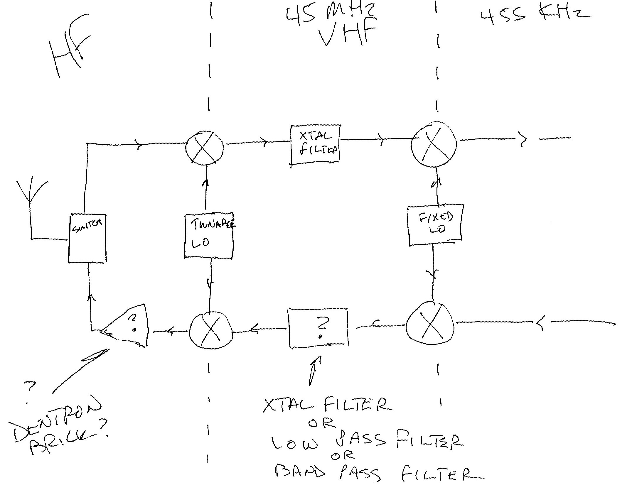

Here's what I'm thinking, if you guys can read my chicken scratch.
It may sound counter intuitive, but I think for my skill set, I'm better off keeping the common elements / switching to a minimum, and more or less (mostly more ) keeping the TX and RX strips, separate.
A big question mark I have, is that selectivity element at 45 MHz in the TX strip. Do I even need anything there? If I do, is a low pass filter OK? Or do I need to order another XTAL filter?
Some of this uncertainty relates to the repairability of that Dentron brick. If I can get it going, all my power gain can be after the last TX mixer. If I can't get it going, then I feel like I need to spread the TX gain over a few frequencies for stability purposes, hence do I need a low pass / band pass element at that 45 MHz TX IF?
If that makes any sense.
This is not a rush type decision, but I want to make allowance for this as I build out the RX. I need to get the RX going in at least some type of simple form, so I can run it in the car to proof it and see if I need noise blanking, etc., added in to it.
Win W5JAG
You will need a bandpass element there, probably a crystal filter. Just as with the receiver there will be an image in the transmitter. Lets say you are running your LO at 44.545 MHz and mixing that with 455 KHz to make 45 MHz. The mixer will create the sum (45MHz) and difference (44.09 MHz) frequencies. Lets say that you mix the 45 MHz with a 59.1 MHz 2nd LO to make a 14.1 MHz 20 meter transmit signal. There will also be a 15.01 MHz (out of band) signal which will flow right through your transmitter and out the antenna, possibly torqueing off somebody, including the FCC. A filter is needed to kill the 44.09 MHz image from the mixer. Since the image is only 910 KHz away, a simple LC filter will not be sharp enough.

Well, nearly both. I got back in town late Sunday night, so began trying to figure out the DDS. I got the assembled version, but had some glitches with it. I had it clipped up in a fur ball of jumpers, and once in a while, the display would just unexpectedly blank, which I blew off, thinking it was just the clip leads. Last night, I hard wired it up, and saw the same problem, and a bit worse. The blanking is solved, I think, by reflowing the solder joints on the display.
The bit worse, is, a bit worse - it has a provision to read a dc voltage applied to pin 1 of the microprocessor, ( 0 to + 3.3 ) and output that to a bar graph on the display, and it began doing exactly that, except there was supposed to be no dc voltage at that point. Looking at it on the scope, there was in fact an unwanted 3.3 volts at pin 1 of the microprocessor, and no apparent way to get there, except internal to the microprocessor. Somehow I corrupted the firmware, or the processor.
This was a real problem, as that pin 1 has to be driven high to program the DDS. I made a workaround by jumpering across the meter input to pull pin 1 low, and fashioning a kludge to drive pin 1 back high for programming. The kludge was cutting a pin off an old TTL IC, soldering a thin wire to it (not as easy as it sounds), and pushing this into the pin 1 socket so it is in contact with the real pin 1, and can be driven high to set the prograaming. ( Again, not as easy as it sounds ).
Oleg is sending me a new microprocessor.
In the meantime .....
If these are anything like the Chinese class D audio boards they may be anywhere from somewhat useful to junk.
Well, I don’t know. I haven’t really played with one, so don’t know what to expect.
Below are some pics. I have made up a test jig for it so I could go to work on the actual radio - each output goes to a pot for attenuation ( this looks to be a bad idea, and will be modified ), and a small 12 volt supply for powering test boards.
It is anything but clean. The 999 KHz shot is the fixed oscillator. The 1.2 MHz shot is the variable oscillator. Not the time base difference between the two - I believe my cheap scope was having difficulty with the harmonics, but the frequency counter display is correct. The 3.610 MHz capture clearly shows the second and third harmonics. The only good news here is my 1 MHz scope clearly responds out past 10 MHz. I verified the harmonic content with a general coverage receiver. The third is as strong as the fundamental, maybe stronger. The second is weak and raspy. Both DDS outputs exhibit the same behavior.
It may be better at the VHF frequencies I need for a tunable LO and conversion oscillator. It for sure needs to be filtered and conditioned to use as a low HF oscillator.
So, still at square one, maybe backwards one or two ....
... It may be better at the VHF frequencies I need for a tunable LO and conversion oscillator. ....
After playing with this a bit more, and doing some belated cursory research on this DDS chip, all this looks to be completely normal behavior. As best I can tell, the kit performs just as described. Properly used, it will be satisfactory for a single band transceiver, which is how it is described.
The data sheet says square wave output, but some of the pics I've now seen just barely approximate a square wave. The waveform ^^ above actually looks pretty good.
The data sheet says nothing about harmonic generation. The third harmonic is just horrendous. I can tune it through the 48 MHz region and stop the scan, and fully quiet my homebrew two meter receiver. The antenna is at least sixty feet away on the roof.
It may or may not be exactly on frequency. I think it's a little off. The firmware allows for exact calibration of the oscillator crystal. I haven't done this, yet, as I expect the crystal to age a bit.
This place: QRP Labs Kits has a bunch of DDS kits based around this chip and for support of this chip, as well as a fair amount of information about it, Arduino code and shield boards to support the chip, BAND PASS filters, etc., .
One of their kits has outputs to switch low pass filters - useful for transmitters, but it's not hard to infer that the same function could be used to switch in band pass filters to kill the harmonics and condition the waveform output to make it suitable for actual use.
Their kits can accept a GPS clock signal and use this as the reference - this resolves the frequency calibration issue.
So, anyway, with suitable filters on each of the outputs to clean things up, this will be a satisfactory LO, but it's not as plug and play as I naively expected. I think the same can be said of anything using this chip.

The data sheet says square wave output.......The data sheet says nothing about harmonic generation. The third harmonic is just horrendous.
The Silicon Labs chips use divider technology to make the output frequency, and therefore make square waves of varying duty cycles.
A square wave by definition contains ALL of the odd order harmonics. The distribution of these is defined by the duty cycle. A 50 50 duty cycle affords the highest 3rd harmonic content.
Many of the typical diode or fet ring mixers actually work better when the LO port is driven by a square wave. The reason has to do with minimizing the time where the diodes or fets are operating in their transition (quasi linear) region. Ideally you want one pair of diodes fully conducting while the other pair is off. The transition where the conducting and off pairs are swapped needs to be minimized, because that is when higher order mixing products are generated, and conversion loss increases.
If your synthesizer can operate at twice the needed LO frequency, the usual trick is to run its output through a divide by two flip flop like a 74HC74 to create a pair of complementary square waves with a 50 - 50 duty cycle.
The typical DDS type synthesizer outputs something more like a sine wave, since they have a sine wave look up table in ROM, and just play it through a DAC.
