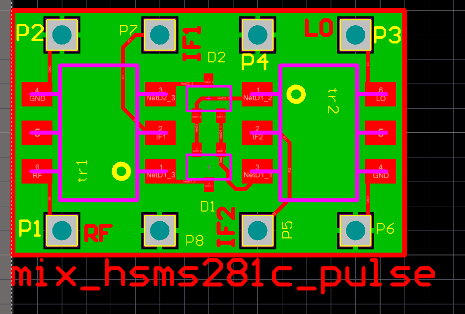

Since cost at Chinese levels is an argument, one would probably choose the SRA1H
from the junk box.
I have made mixers from Pulse CX2147 transformers and HP/Avago diodes, or
whatever they are called at the moment. IO pins are on 100 mil centers, so they
can be easily deployed on vector board or such. 7 dBm only but with known diodes,
which is important for my purposes.
There are other interesting transformers from Pulse and MAcom, all from Digikey
and/or Mouser. Quite cheap. CX2147, cx2049, cx2074nl, cx2156, maba009594,
mabact0059, mabaes0060, mabaes0061, cx2032nl e.a.

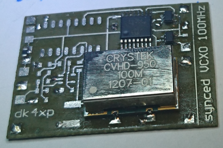

I have developed quite a library of stamp sized functions like this,
100 MHz VCXO locked to 10 MHz ref frequency.
4046 (in SO16) and LVDS input buffer were not yet needed in this case.
There are also inv /non-inv OP27, regulators, PIN attenuator macros and such.
Divide and conquer.
Also the board process is quite fast with presensitized material, less than
90 min. from drawing in computer to drilled board.
<My version of the G = 1000 low noise measurement amp (for Ikoflexer). >
The Rohde/Bucher book contains everything that's needed.

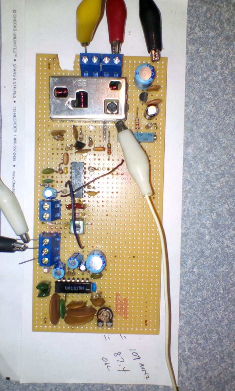

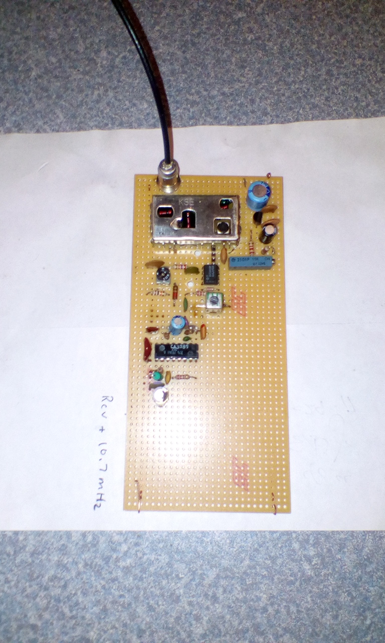

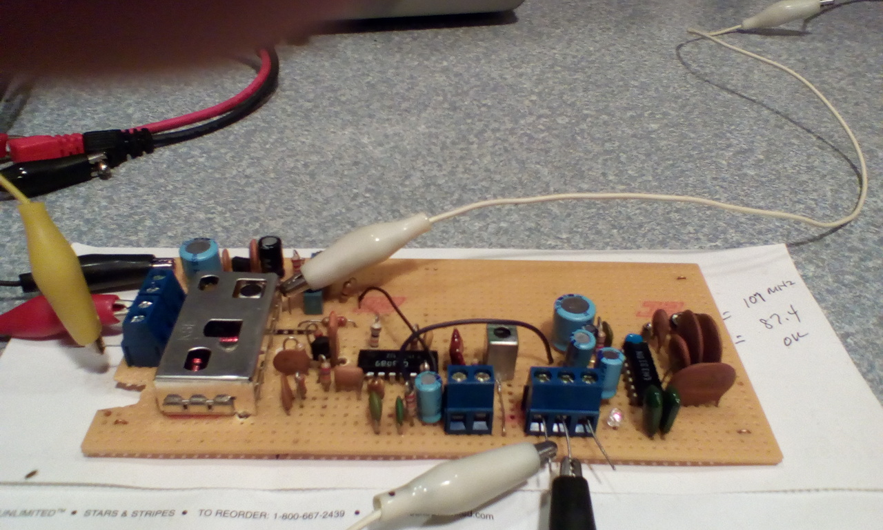

.... I have been thinking about slapping together a quickie FM tuner for football season ....
And done, with time to spare.
Prefab FM tuner module cut the time in half, probably. CA3089 FM receiver chip, LM1310 stereo decoder. AGC and AFC from the CA3089 applied to the tuner module.
Antenna will be something circularly polarized, probably a turnstile, on my roof tower.
The first variant used an MC1350 IF amplifier between the tuner and the chip. This worked well, but had a pretty big footprint on the board, and more gain than needed. It was not directly compatible with the AGC from the CA3089, adding some complication.
I removed it, moved the CA3089 closer to the tuner, and, of course, decided that provided inadequate gain, when the loss of the ceramic filters is about 12dB. So, I shoehorned in a 2N2222A, which looks to be about right. The first variant on that used transformer coupling to the second ceramic filter, but ultimately I just went with the ceramic filter as the load for the IF amp.
It's shown connected to the stereo decoder, but I also have the mono de emphasis network on the board that I can use. The decoder gave me a bit of trouble. I didn't have the right capacitors, so I had to parallel stuff to get close. At first, I couldn't get the onboard oscillator down to 19KHz, so I had to tweak the VCO values a bit. Once I had a good clean square wave at 19KHz, the PLL locked right up when it detected a pilot tone. The decoder is mostly the data sheet circuit; I returned the de emphasis caps to ground instead of the positive rail, because it was easier to fit them that way. It's wired for unity gain, which seems adequate to drive the small push pull amp, with just a low gain 12AU7 front end, built as part of the removing MOSFET's thread in the Tubelab sub forum.
The empty space across the top is to channelize the tuner - I am only interested in four or five stations - and hopefully an audio switching setup to switch the tuner and another aux input in and out, so it can be installed in a Tubelab amp.

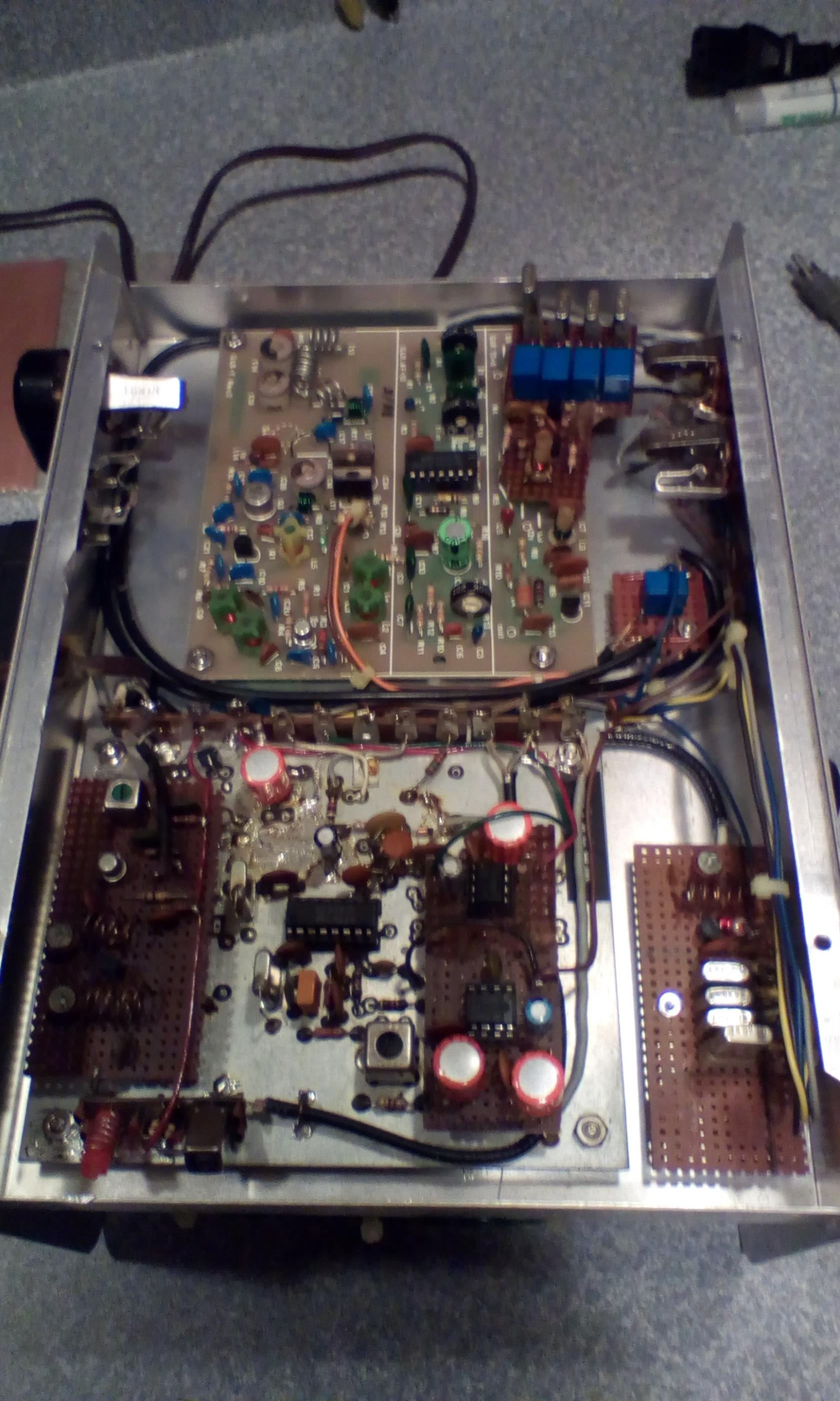

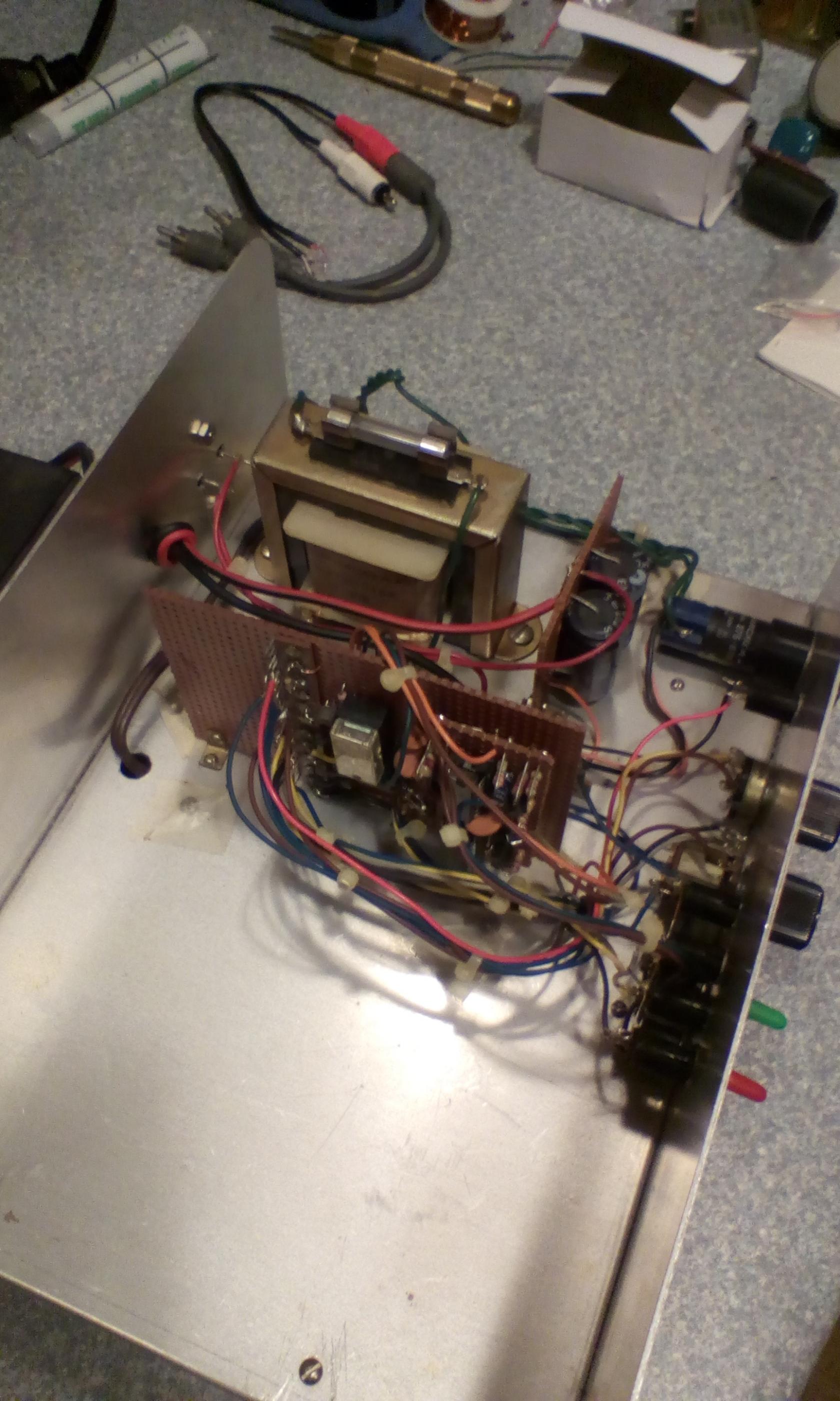

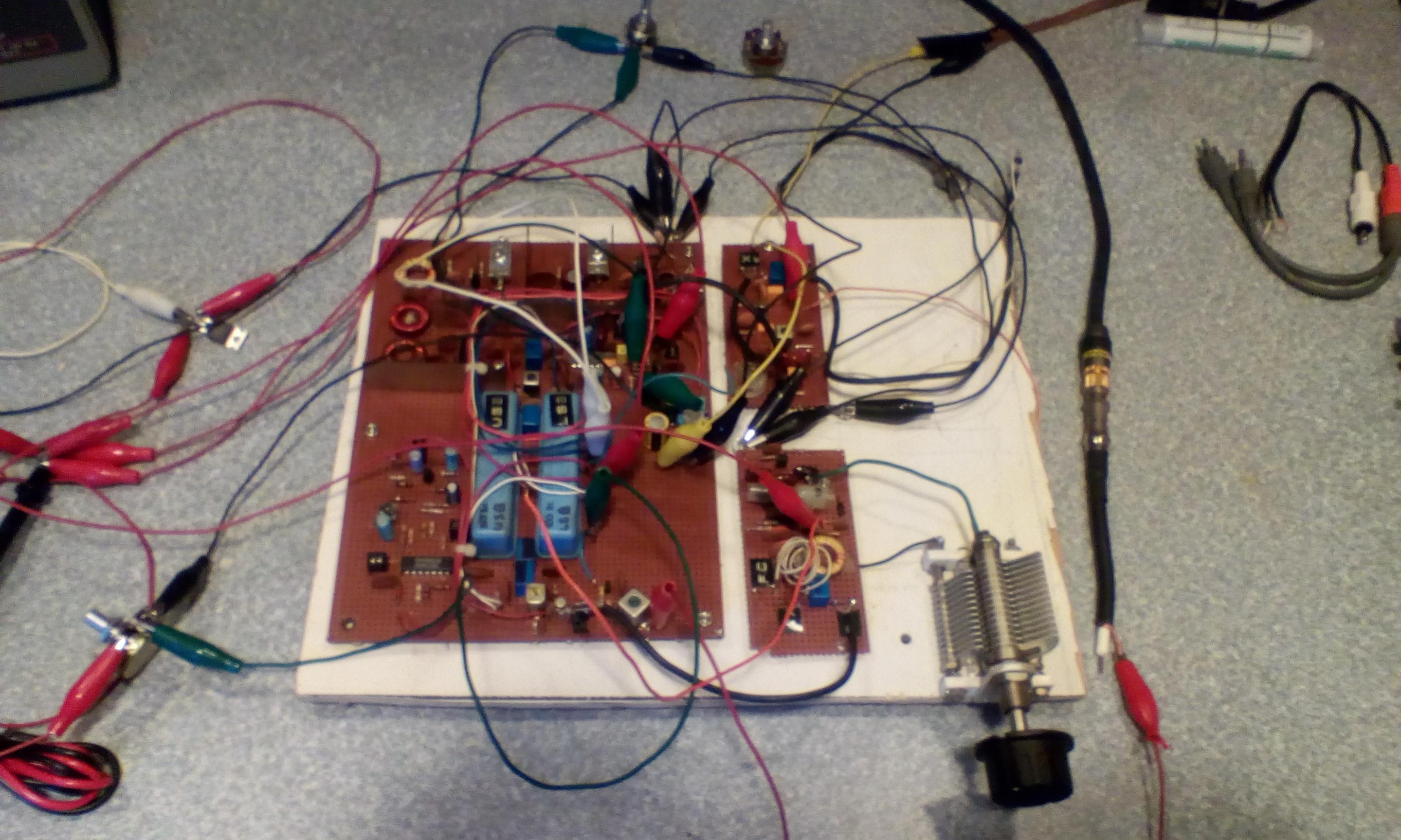

... Reworking my original very simple rig, about 90% of which still exists, and using it as a tunable IF - my original plan - is starting to look better ....
Powered up for the first time in twenty five years. The original metal chassis/ cabinet, shielded enclosures for the oscillators, etc., are long gone. I've seen some shocking clip lead fur balls, this is one of the worst I've perpetrated. This implements minimum function for the receiver - didn't fool with the TX components.
It still works.
The LC LO has got to go - it wasn't great back then, and time hasn't helped it.
The carrier oscillator looks good - it came right up at 455.0 KHz, rock solid, 0.5 V RMS sine wave, very clean.
I think the front end ( need to add another pole of filtering ), mixer, and USB / LSB filters and switching are OK. Looking at some of my drawings. I had a few wait ... what? moments. The matching into the IF, around the tail end ceramic filter, and some of the component values in general can be improved on. Level matching of the CO into the product detector also looks bad - way too strong, and needs to be attenuated, a lot. Basically everything behind the filter and in front of the final audio pa stage looks ripe for rework.
There's room on the board for a completely new IF / audio strip, if needed.
Lot of other projects going on, and I don't really need this, other than for learning purposes. I'll look at the TX after I get the receiver sorted.
Maybe begin an up converter after I get this one right.

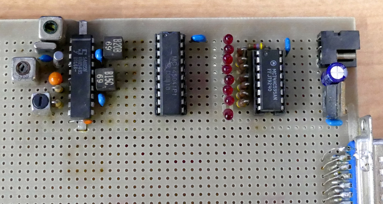

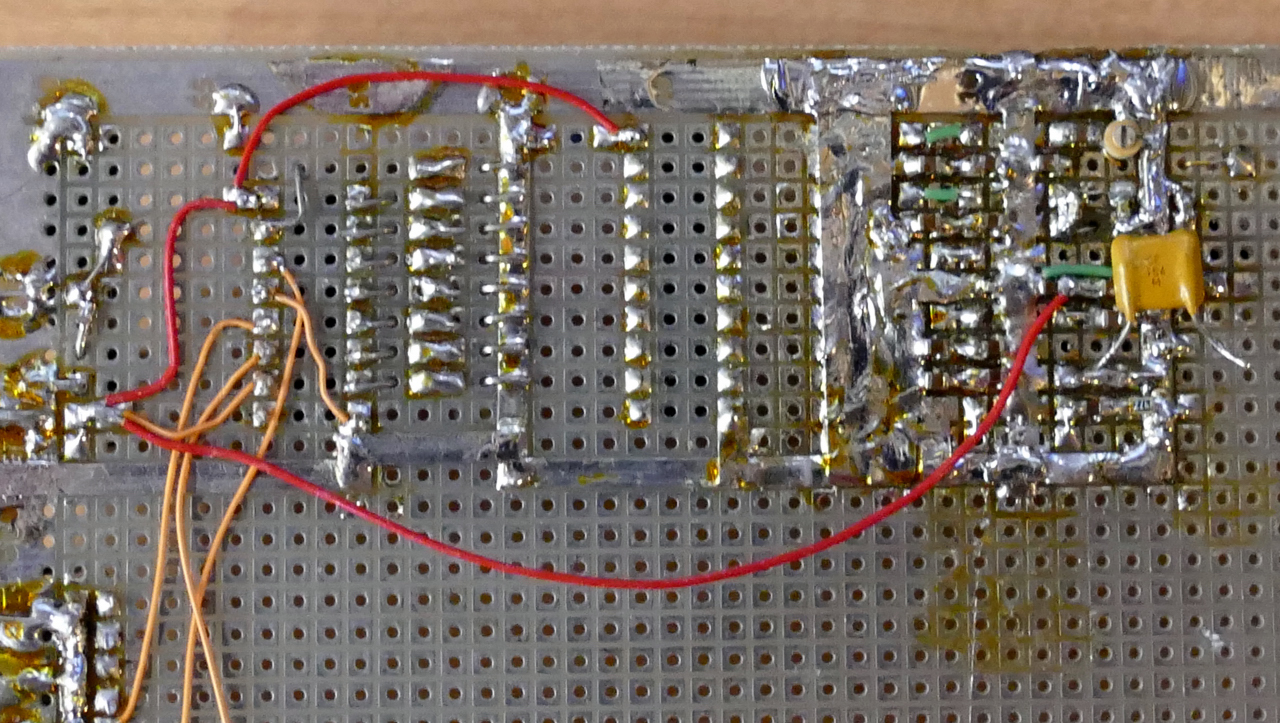

While digging through boxes of stuff looking for some old TSE boards I found an old project from the early 90's. It has a pair of digital chips connected to a parallel port DB25. In that era I was writing code for PC projects that ran on Windows 3.1 with Borland C. It was easy to read and write SPI uning a few pins on a parallel port with some canned Borland code.....those days are gone.
The board also has a complete IF strip including a RSSI (Received Signal Strength Indicator) capable of 90 db of dynamic range. That's where the test board stopped, and that was lilkely the end of the project, but those 3 chips plus a few foggy memories tell me where it was going. This was going to be a PC based RF spectrum analyzer. My guess is that the project terminated when two new PC operating systems came along, Windows 95, and OS2 Warp. Borland didn't make simple, cheap C compilers for either.
To my surprise the SA605 chip is still available in SMD only, so if the 455 KHz filters are available, SMD would be OK, this still may be a valid project.

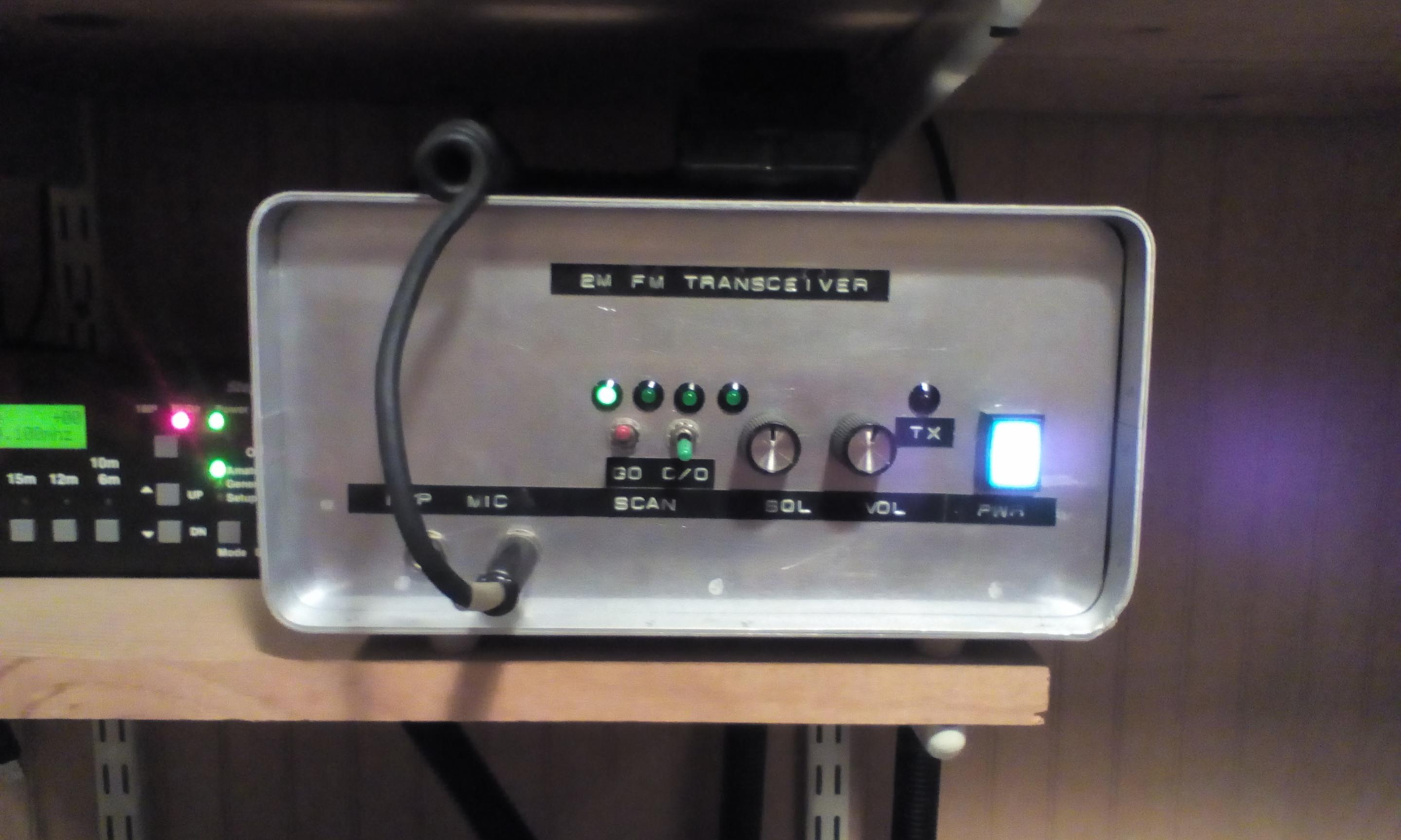

I used MC3357 for my FM rig, which is probably obsolete now, but I have a few stashed. The RX strip was built on a board for a 10m FM receiver that ran in QST, but I couldn't make it work to save my life. I wound up just building my own receiver around the miniscule bit of that board that worked. The TX strip is a GLB kit. I added a control board to make it a four channel scanner. I actually still use this radio. I don't have any of the drawings, but I found some drawings on an eight channel vhf/uhf scanner I made about the same time for a girlfriend that was pretty similar, but used a later chip ( MC3361? MC3363?).

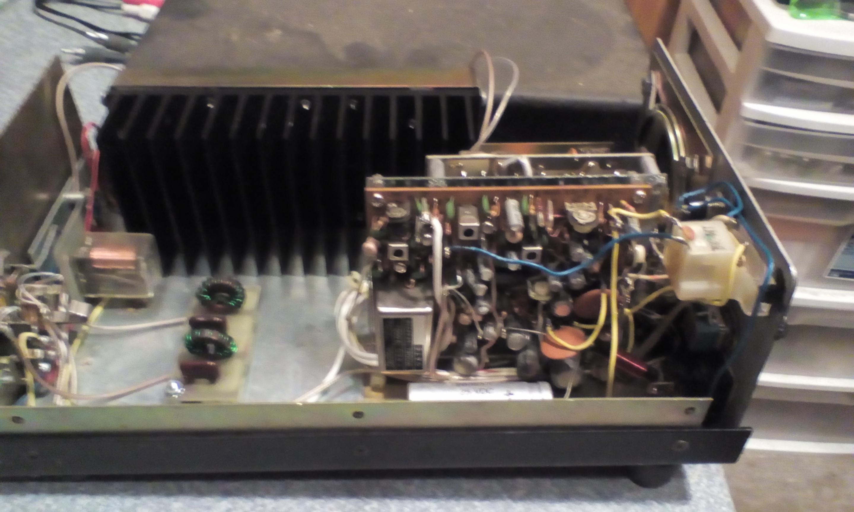

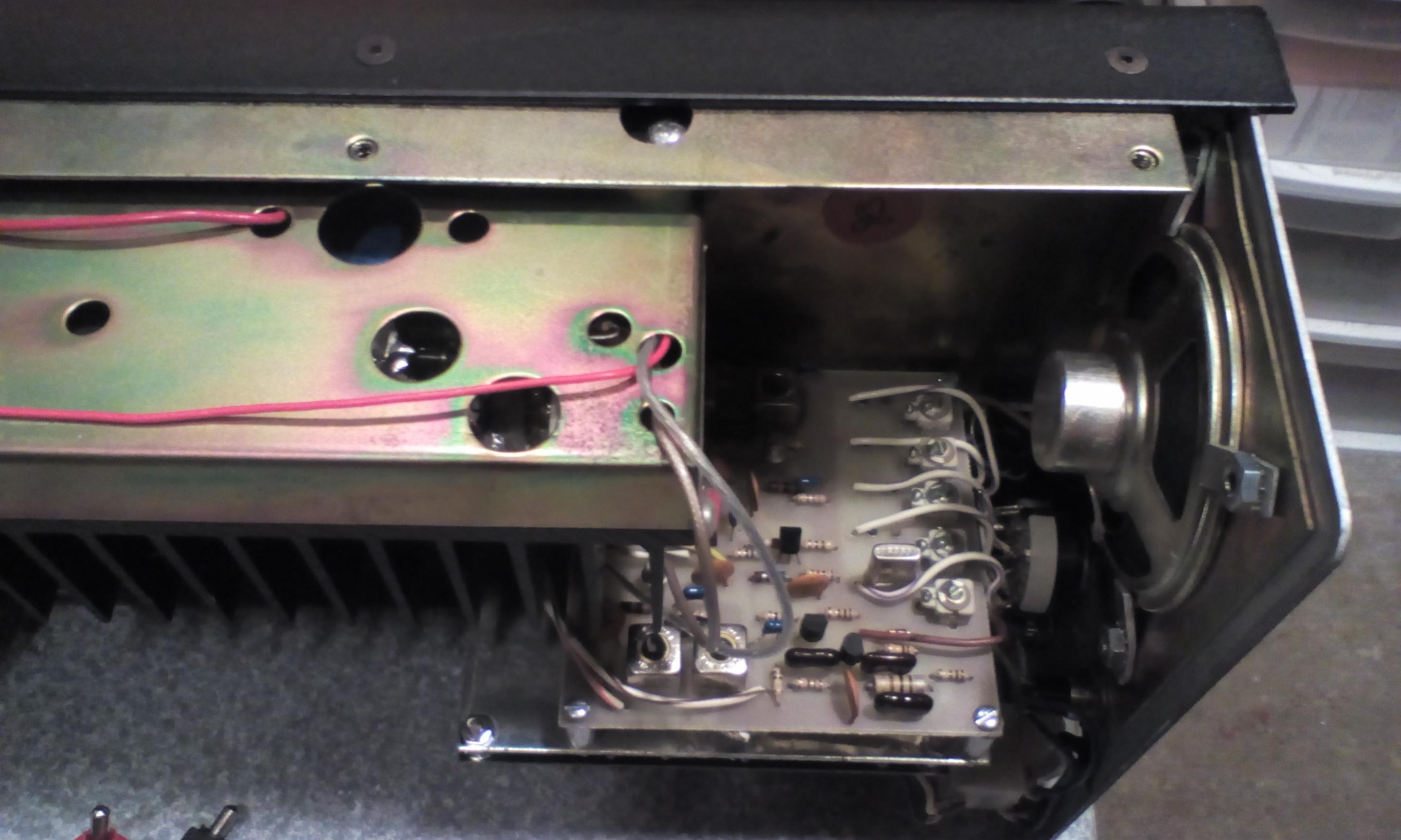

Poking around in the warehouse of junk, I found this Den( junk )tron utility transceiver that I bought for peanuts years ago. I brought it home and opened it up, and this thing has a Mizuho SG-9 SSB board in it. It's a complete 9 Mhz SSB system, all of the AF and RF on one board. Dentron just tacked their front end unto this board. The brick is 250 watts input, and it is driven from the output of a 3N204 mixer - probably a couple of milliwatts. I powered it up, and the RX works. Didn't test the TX.
So, I think when I move on to the up converter, that Mizuho board is my play for the 9 MHz IF and AF, and that brick will be the PA.

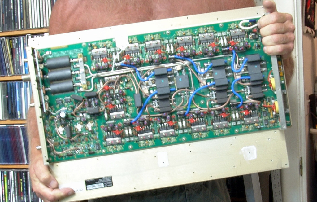

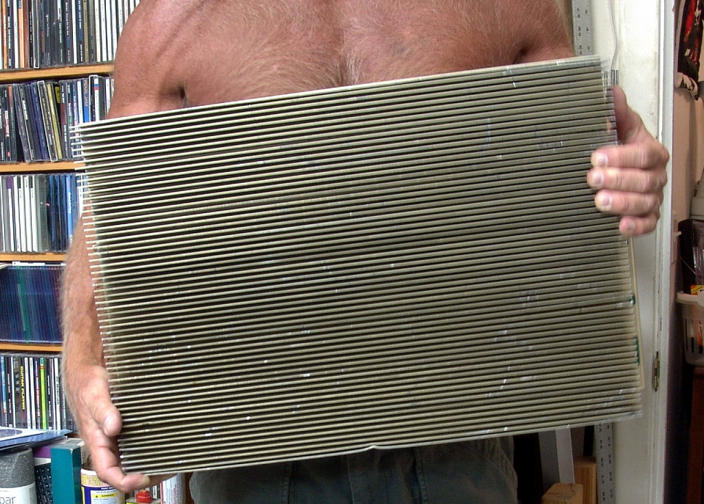

I got some surplus MRI amplifiers in Dayton several years ago. I took one of the small (1KW) ones apart and fired up one of the individual modules. It will cover 40 meters through 20 with 100 watts or more output, and 80 through 10 at 80 watts or so at reduced efficiency. It seems that the ferrite combiners get hot when operated outside their design frequency.
The first two pictures show a big (2.5 Kw) MRI amp that I got in Dayton for $50. I took the PC board off the heat sink (which weighed about 40 pounds) and sold the heat sink at Dayton the following year for $50! The buyer wanted to build a class A mosfet based audio amp. I still have the PC board, but haven't played with it yet.

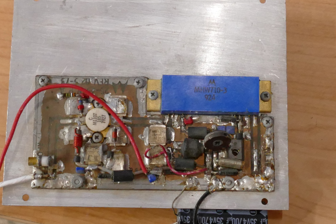

I found two "bricks" while digging through my old stuff in the past two days.
The first was a 50 watt amp for 432 MHz. I was using it for ATV at about 20 watts peak. It wasn't linear enough to be pushed any harder without saturation causing loss of sync.
The second was a 2 to 30 MHz RF amp I built in the late 70's. When driven with a "5 watt" radio on 12 volts, it made about 100 watts and would not blow up with any load, even a short or an open. Driven a bit harder and run on a 36 volt supply about 250 watts flowed out. It would blow up in a spectacular manner at this level, usually blowing the covers off the output devices. The transistors in each amp were house numbered parts. Who knows what they really were.
Neither of these have seen power since the early 80's. The ATV repeater we used ate a lightning bolt and was never rebuilt. We used to "text" each other on ATV by connecting an Apple II clone's output to the PC electronics ATV board. Some hams might have engaged in video games through the repeater too. I sold the ATV setup at the Miami Hamfest shortly after that, but kept the amp. The buyer already had a better one.

I'm dubious that the PA in that Dentron is a real 250 watts, but inside the cabinet was a couple of pages of specs and schematics that says 250 in, 135 out. What got me giddy was seeing the milliwatt level drive going into it.

I hope the brick still works, or isn't fried too badly.
And .... it's FRIED. The push pull output pair gets it's B+ direct from the power terminal without so much as a smidgen of protection, no fuse, looks to have no foldback protection, just ...disaster waiting to happen .....
Hooking 12 volts up to the output pair made my power supply groan in delight so I'm sure the output transistors are a dead short. No indication on the schematic what they are - probably the old helicopter type. Likely the cheapest junk they could get away with .....
Now I know why it was cheap!
