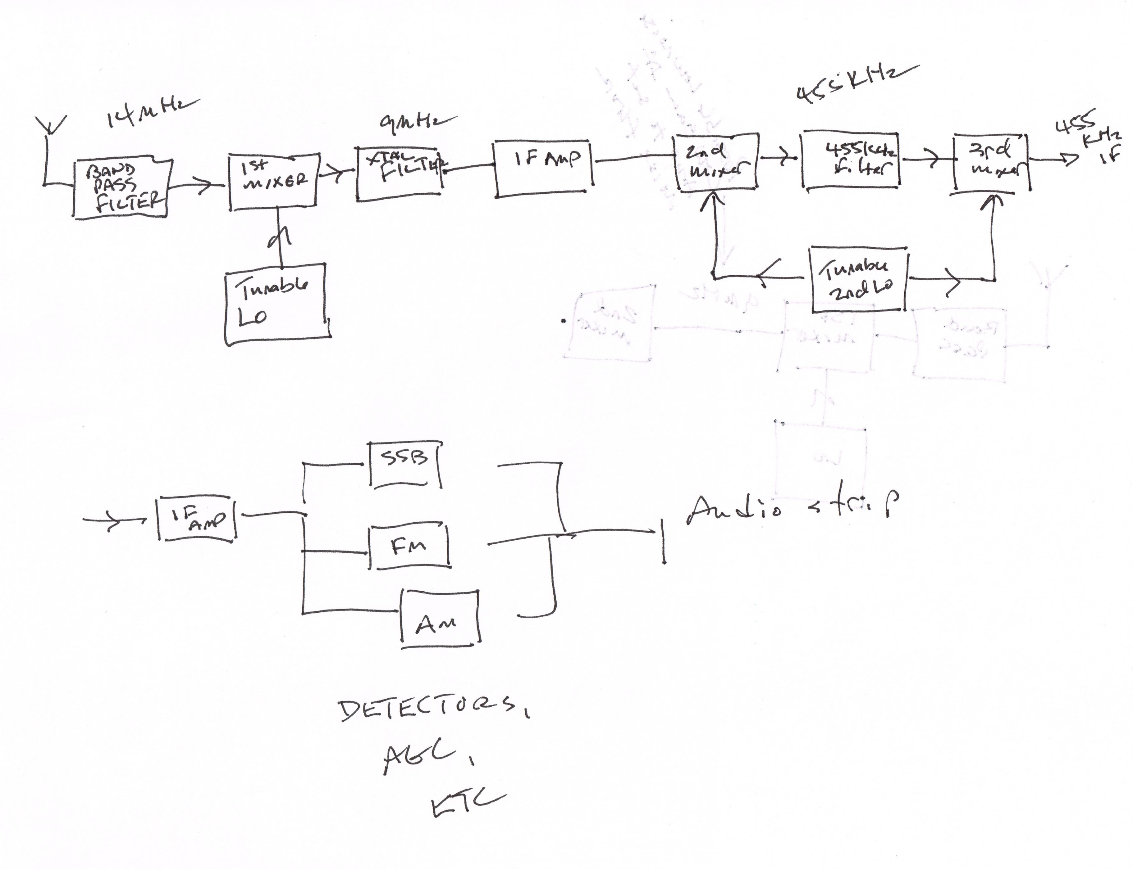

You guys planning your own HF transceivers....I've been intending on building another SSB rig....I have enough boards built up to assemble a single band ( 20 meter ) SSB / CW receiver.....I have some matched LSB/USB filter sets
My initial plan is to use a canned mixer (I have several) and a frequency synthesizer (EBAY Chinese PLL and DDS boards on their way) to convert HF up to a 45 MHz IF (eliminates image problems with the same LPF needed in the TX), then stuff the 45 MHZ IF through a crystal filter (I have several), where it will be converted to I/Q baseband with a Soft Rock board then processed in a PC. VHF will be upconverted to 315 MHz filtered, then converted again to 45 MHZ, frequencies from 200 MHz to 1 GHZ upcoverted to 1206......
315 and 1206 are chosen because there are cheap SAW filters available.
I have a block diagram for all of this on an old hard drive somewhere. It was an idea from a time when the parts weren't common yet, times have changed.

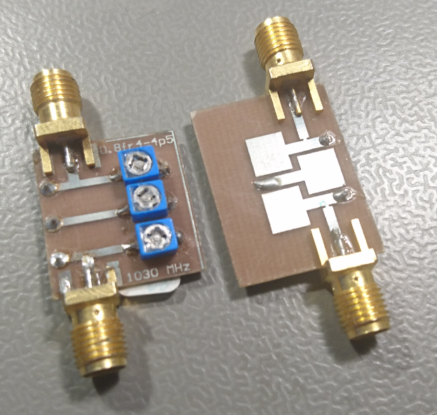

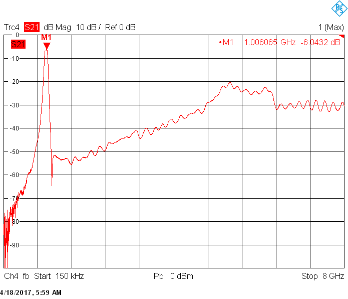

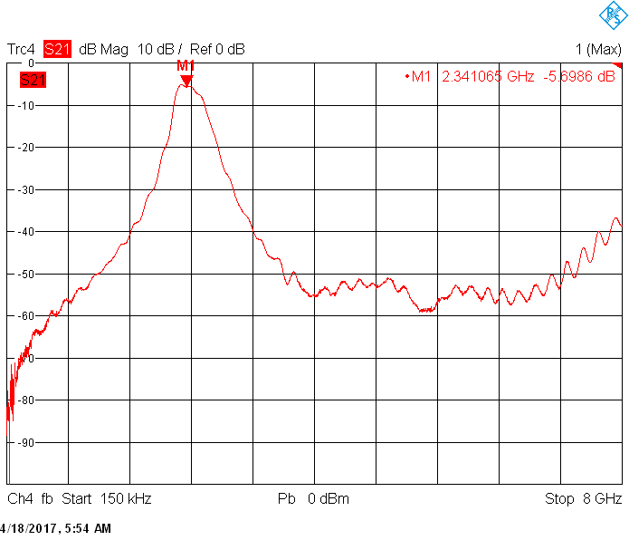

I have made some ustrip / stepped impedance filters on FR4; that work
quite good if the capacitive ends are substituted by capacitors. The high-
current sections are less impressed by the board material.
The combline result is not from the filter with the silly plastic caps.
Thats from a filter with resonator width 3 times as wide and fixed caps.
The stepped impedance filter took a lot of electromagnetics simulation
time, but the real thing is quite close to the simulation. That was for
a downconverter to receive Amsat Oscar40, but AO40 never worked.

I would like to do an up converter, but the only non HF filter I could find in my junk box was a 60 KHz wide McCoy centered at 30.100 MHz - I don't see that as being any more useful than 9 or 10 MHz.
Win W5JAG
But still you can do upconversion from DC to 10m. Maybe you need a trap for 30.1
in the preselector.

The filters in a receiver serve several purposes. In a typical superhet the front end filters (before the first mixer) serve to suppress the 1st image response, and possibly reduce, by bandlimiting, the total RF power hitting the mixer. With a low IF frequency the image response limits the width of the front end filter, and an IF frequency like 455 KHz (assuming single conversion) means using a tunable filter, or breaking up large bands like 10M into chunks.
Up conversion makes the 1st image response a non issue such that the LPF in the TX is sufficient filtering.
The filter after the 1st mixer (often called a roofing filter by hams, but by nobody else in the RF world) serves to limit the total RF power seen by the receiver's IF circuitry, or data converters. Ideally this filter should be just wide enough to allow only the desired signal to pass.
When we did mission critical two way radios for police fire and military, this is exactly what we did. The front end filter allowed the desired frequency band to pass, say 450 to 470 MHz, then the crystal filter after the mixer allowed one RX channel to pass, typically a 25 KHz wide channel, though 12.5 KHz channels were also used.
The typical IF frequency for VHF and UHF radios was 45 MHz. These crystal filters are still available for a reasonable price, although the leaded through hole parts have become scarce. I have some through hole parts I got from Digikey several years ago. That's what I intend to use for the IF filter in an up conversion HF rig.

I'm thinking something like this is actually do-able ( for me ).
Additional bands could be added with the correct bandpass filter, diode switching, and changing the first LO frequency. Transmitter blocks wouldn't be hard to add in, as long as some allowance was made for T/R switching the common blocks while the RX strip is being built out.

Reworking my original very simple rig, about 90% of which still exists, and using it as a tunable IF - my original plan - is starting to look better, as well as just building out a DZ Sienna, which is sitting in a box in the back of my office.
