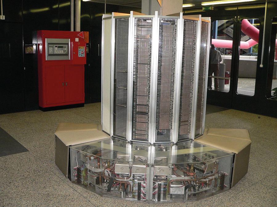

Look back at pictures of the old Cray supercomputers - their cylindrical shape was dictated by the speed of light (slowed down by the properties of cables and dielectrics and striplines). The fastest thing in the universe was already inconveniently slow for the worlds fastest computers - and that was decades ago. 😱
The speed of light (and therefore RF signals in PCB striplines) hasn't increased since then, but electronics has become much, much smaller, which has helped enormously, by shortening the distances that signals have to travel.

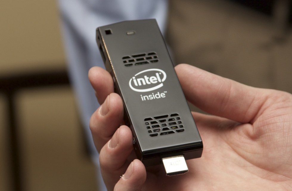

Still, it boggles my mind that you can plunk down $100 or so, and walk off with a gigahertz-clocked computer the size of a large USB thumb drive.
Neither Cray supercomputers nor USB-stick computers come anywhere near being feasible DIY electronics projects, needless to say.
-Gnobuddy
