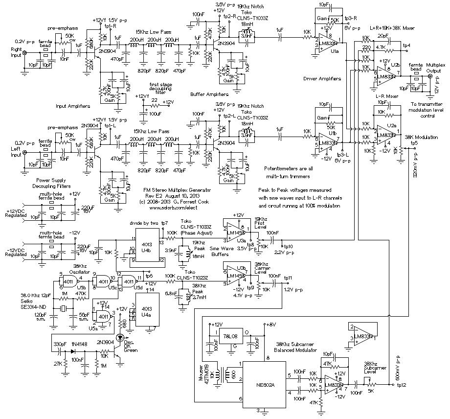

Coming into this discussion late, I'll offer upload of best stereo modulator circuit I have seen thus far on the web. (Have seen better on commercial units and one custom built by a friend back in the 70s, but I don't have those schematics.)
(I'm sure the purists here will have comments about which op amps are used.)

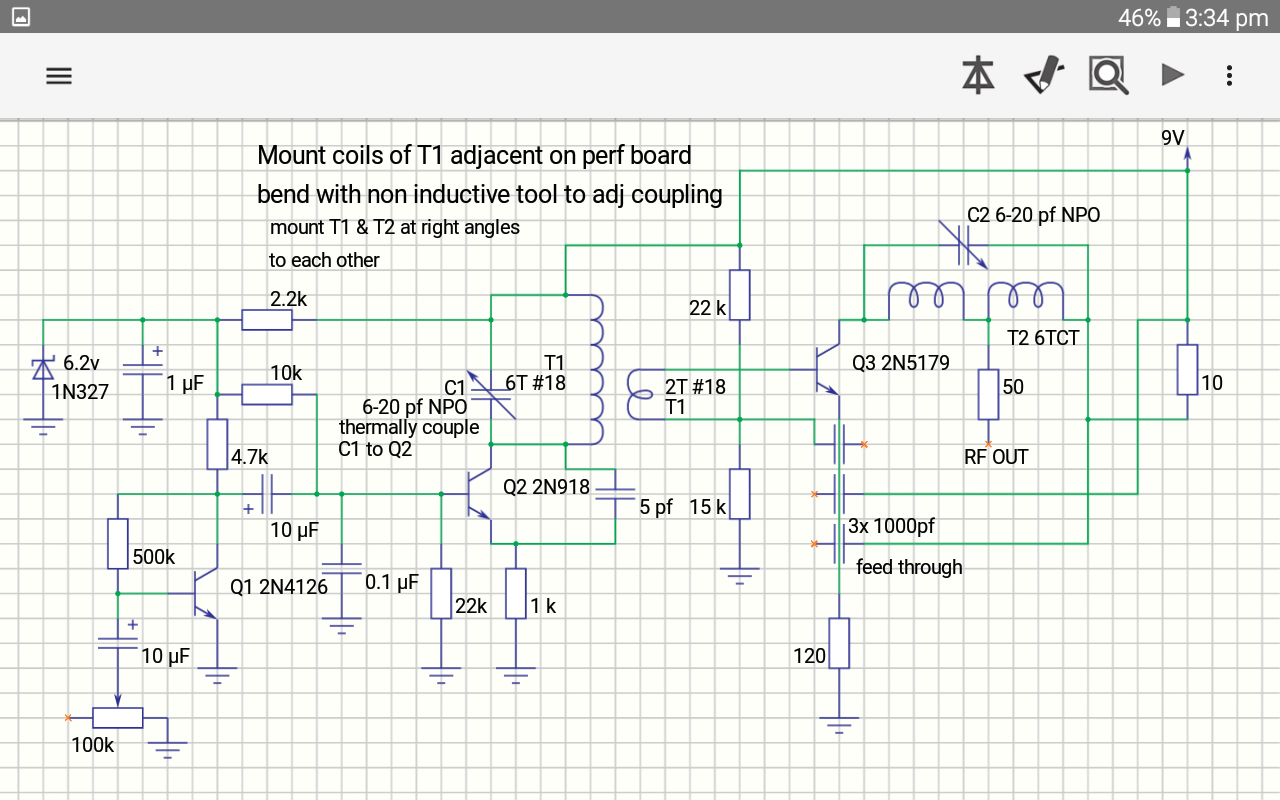

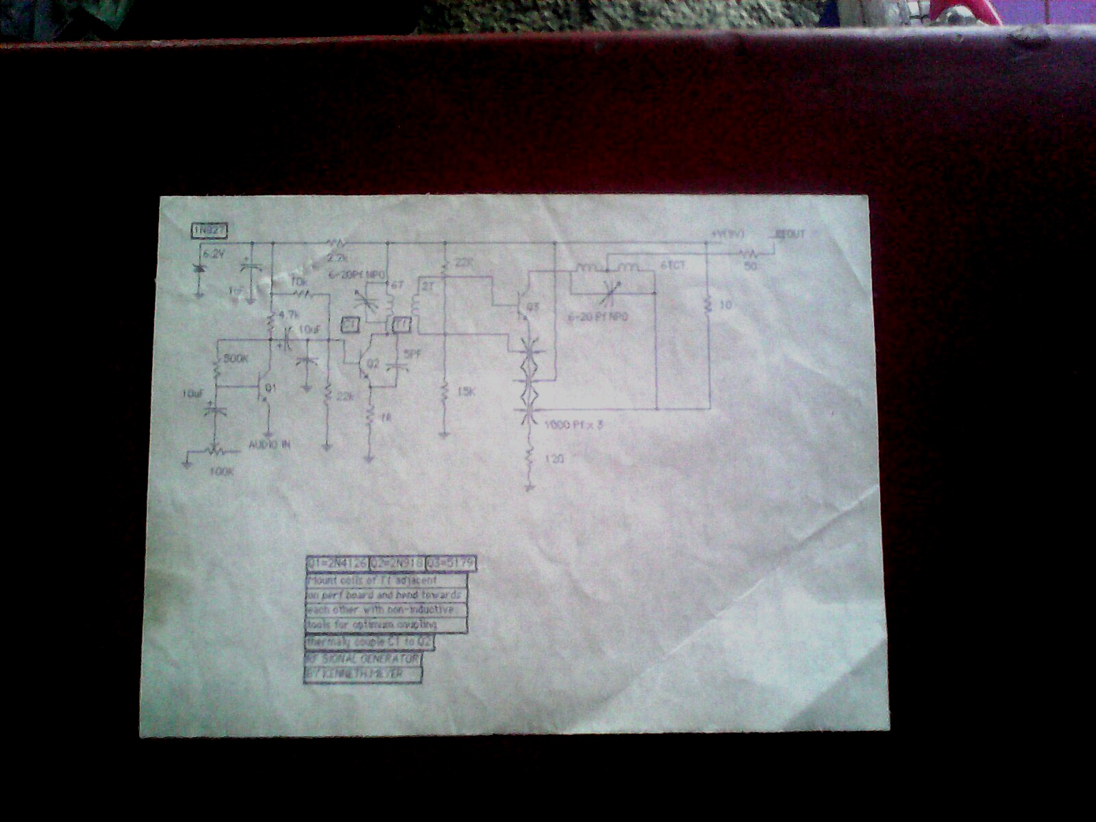

Okay, here is what I've got. One is a pic I took of schematic. The second is a quick drawing I did on quick copper on my tablet to clarify values. Good thing I did that as I discovered an error. That audio input transistor can NOT be a 2N4126, as that is a PNP. THINK it likely a 2N5172. Which I know the designer is fond of.
Odd looking caps on final are 1000pf feed through caps. Thermal coupling on C1 & Q2 is just a blob of epoxy between transistor case and cap body. Adjustment Caps aren't critical for range. 5-30pf would work. NPO is important for temperature stability.
Will find number of that input and post it. The others are correct.
I think you could use 1/8 w resistors. Electrolytics 16v. That 0.1 bypass on base of Q2 is just disk. Oh, as I recall coils were wound on 3/16 form or stick. That 10 ohm feeding final probably needs to be 1/4 or even 1/2 W
Doc
