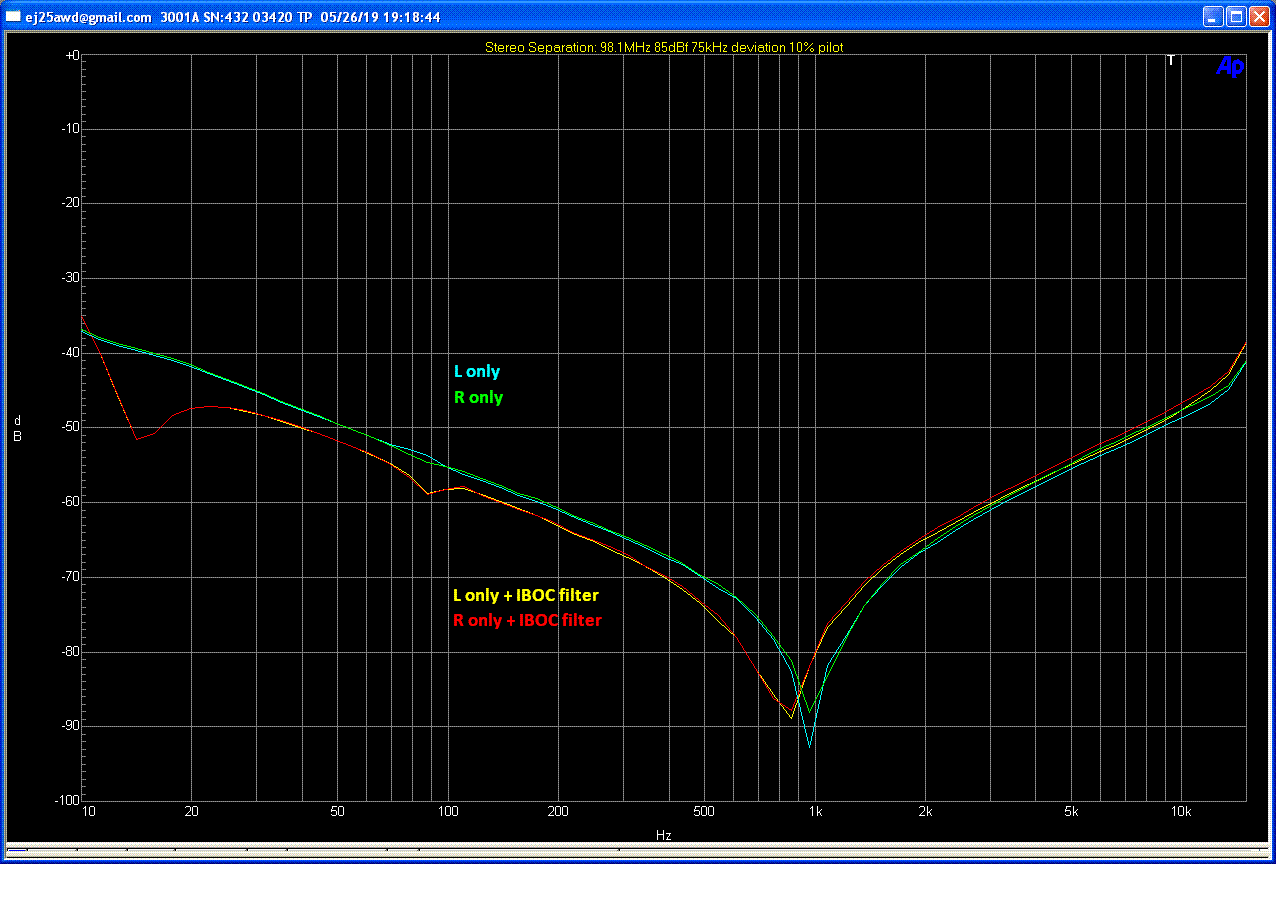

The problem is caused by the stereo decoder. Ideally, a 38 KHz sine wave is generated from the 19 KHz pilot, and multiplied with the input signal. That results in AF from the 38 KHz side bands which with the LPF-ed input signal are fed to a matrix circuit to produce L and R. Such a decoder was immune to SCA and is immune to the HD side bands. It's cheaper to multiply with a square wave and thus arises the interference from the 15 KHz wide side bands of odd harmonics of 38 KHz. Various solutions have been used, best of all was by Pioneer. It used a digital demodulator (monostable) at 1.4 MHz and the pulse train was used to switch a (with the 19 KHz pilot locked) 38 KHz sine wave. Various articles at 88?108 MHz
One solution to IBOC self-noise on 50% duty cycle square wave MPX decoders that demodulate random noise with the 3rd and 5th harmonic of the 38kHz square wave is an IBOC filter. The IBOC filter removes most of the noise present in the 114kHz and 190kHz region.
I have designed and built a filter that has minimal impact on stereo separation.
Here's a plot of the early version.
https://sites.google.com/site/ej25awd/IBOC Filter Frequency Response 1024.GIF
My latest iteration was installed in a Tandberg 3001A and the measured stereo separation degradation was negligible as shown by the plot below.
Cyan and Green are without the IBOC filter and the Yellow and Red are with the IBOC filter installed.

Separation graph looks good. It would be interesting to see the phase response of the filter. A band stop filter (99...129k and 175...205k might introduce less phase shift than a low pass filter. I'll investigate the issue as an almost ideal stereo decoder could be made with just 2 S/H circuits plus proper (but simple) timing derived from the 19 KHz pilot: no multipliers or matrix needed, nor a 15 KHz low pass filter. It's the issue that such a decoder is sensitive to all 38 KHz harmonics that requires attention.
Group delay of the above filter from 10Hz to 53kHz is less than 1usec.

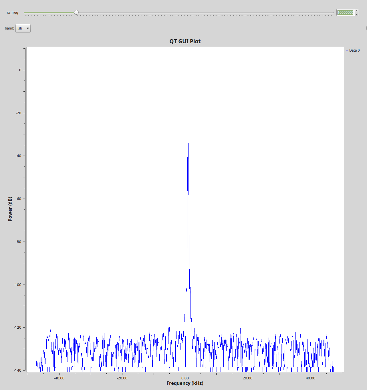

Today it was too warm for me me to go outside and work in the garden
(good excuse), and my RP was collecting dust much too long.
So I installed HDSDR in a windows7 virtual machine and also Gnuradio
and GnuradioCompanion on Linux. Both seem to work.
HDSDR has too much windows, waterfall diagrams of RF and demodulated etc.
I'd like sth. simpler, just enough to do QSOs. It also should be able to
decode / send CW. Have not done that since eons.
Charly25 and the RP transceiver seem to require extraneous hardware; that
is exactly what I do not want. I want nothing but a 432 MHz transverter after it
to do some motorcycle-portable EME QSOs with my pal with this huge antenna.
This is the 10.001 MHz output of my SMIQ generator in GNUradio companion at -11.3 dBm.
🙂 Gerhard

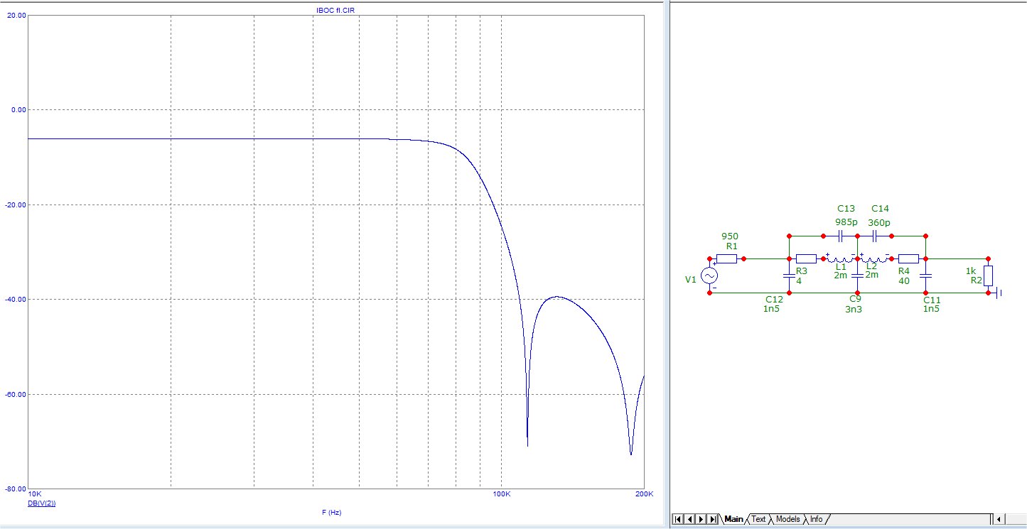

The graph on the google site denotes a low pass filter with damping poles, and is easy to reconstruct from the graph. Shown on the pic, only the amplitude response.
The group delay of your design from 10Hz to 53kHz is almost 3x worse and the amplitude flatness is 0.07dB worse. It is close to what I have but not as flat. The seemingly small differences do matter since MPX decoding rely on the flatness of these 2 parameters.
The reverse engineering from the graph was a 3 minute job for me and as I don't need such a filter, I didn't optimize it.

That is impressive
Here's the simulation of my design. The series R of the simulated inductors were taken from the actual prototyped values. Sorry no schematic.
The IBOC filter is still useful for minimizing splatter of an adjacent station when listening in stereo. I have a distant station that is 200kHz away from a local station that I'm receiving in stereo with minimal interference when using the IBOC filter.
A tuner even with a narrower IF filter will sound harsher without the IBOC filter. The IBOC filter will help in reducing adjacent interference. Stereo reception in general will also be quieter since we are not decoding most of the noise present above 53kHz.
The IBOC filter is actually an adjacent + RDS + IBOC filter.

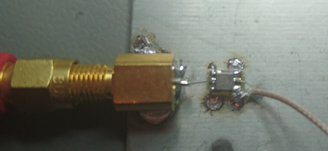

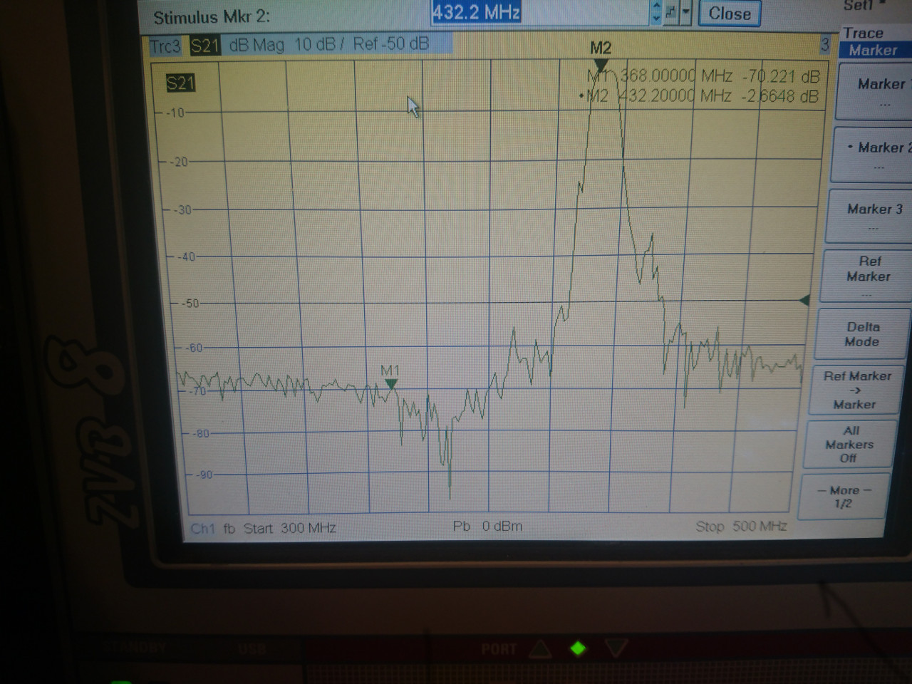

Worst thing is that you cannot trust the documentation. A different Linux
and everything is different.
My 432 MHz preselector filter was easy. I took a SAW filter from
EPCOS/TDK or whoever owns that company this week.
It is for remote controls and costs €1,50 @1 pcs.
Input and output are close to 50 Ohms, bandwidth is just enough.
loss is 2.7 dB, my mirror frequency is 70 dB down.
It can't get much simpler. 3*3 mm.

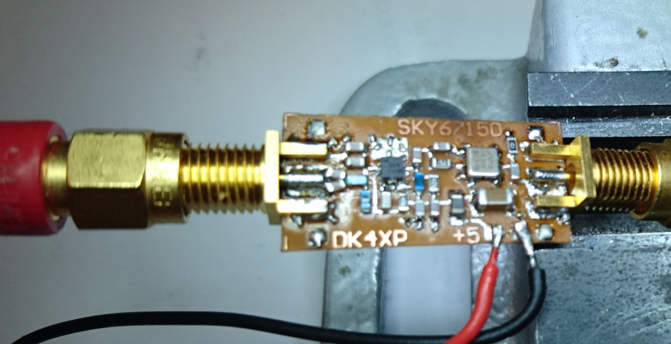

I have made a preamp for 432 this weekend.
Gain is 3 dB lower than promised for the demoboard and the
SAW filter is also not as good as measured alone.
I have not measured the noise. If that is OK, I won't complain.
I need 2 stages anyway and with 2 filters all will be nice.
The two stage version is etched already. it will have an additional
pin diode attenuator. And everything no-tune.
cheers, Gerhard
