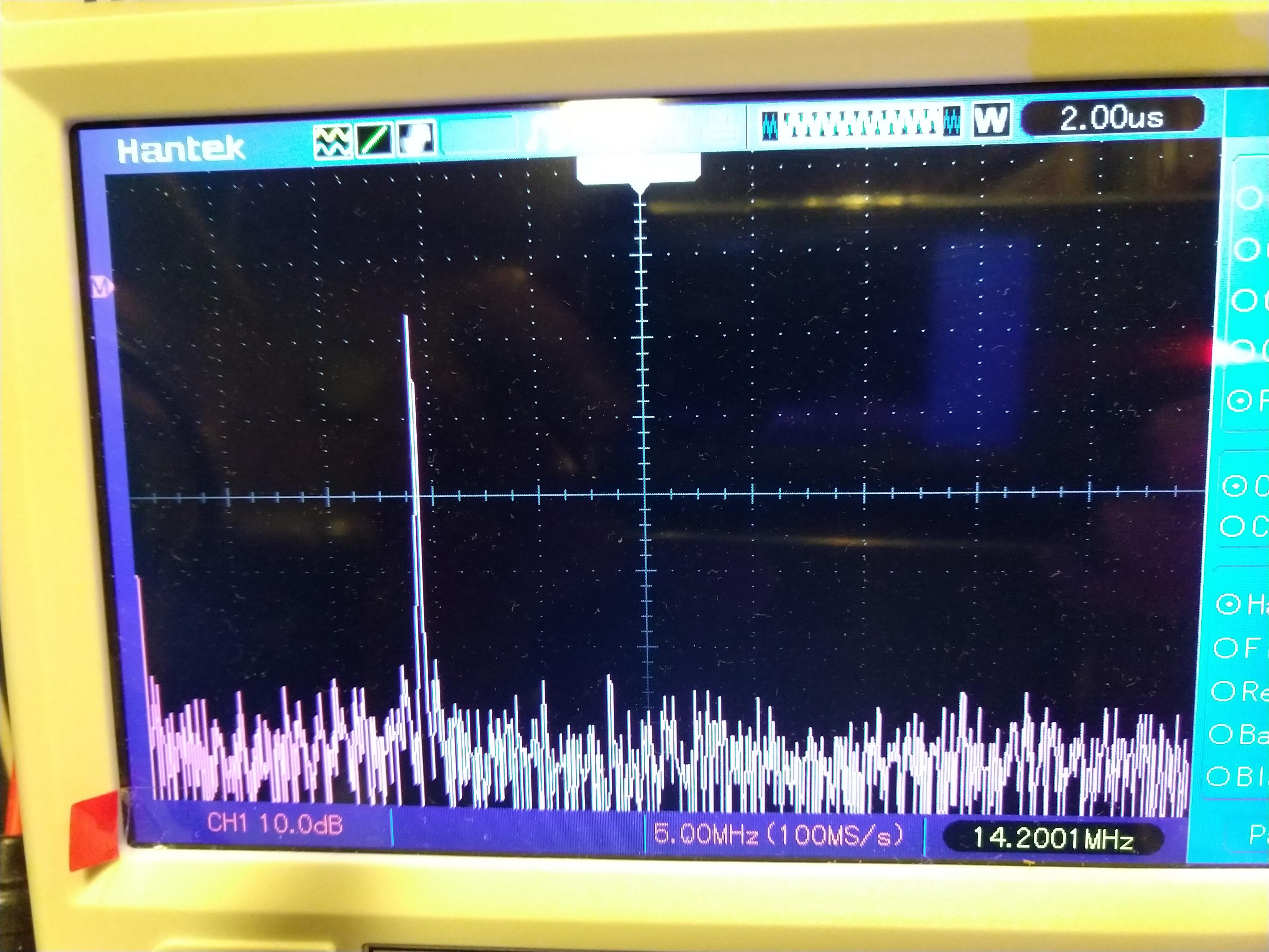

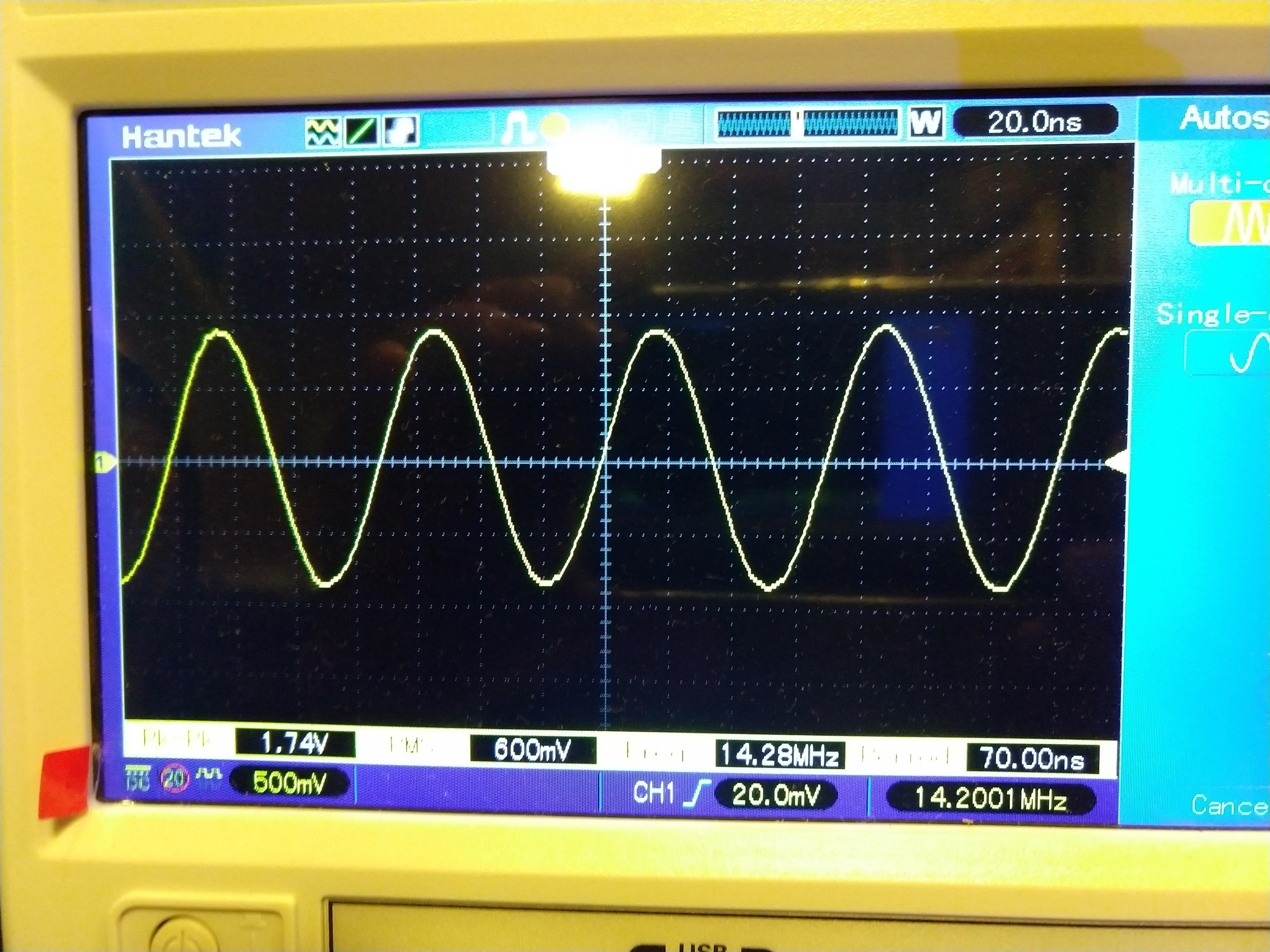

No joy with the Baofeng chips - could not get them to draw any current, so for now, I seem stuck at a couple of milliwatts. It's a decent couple of milliwatts, the MMIC adds very little second harmonic, but just a couple of milliwatts.

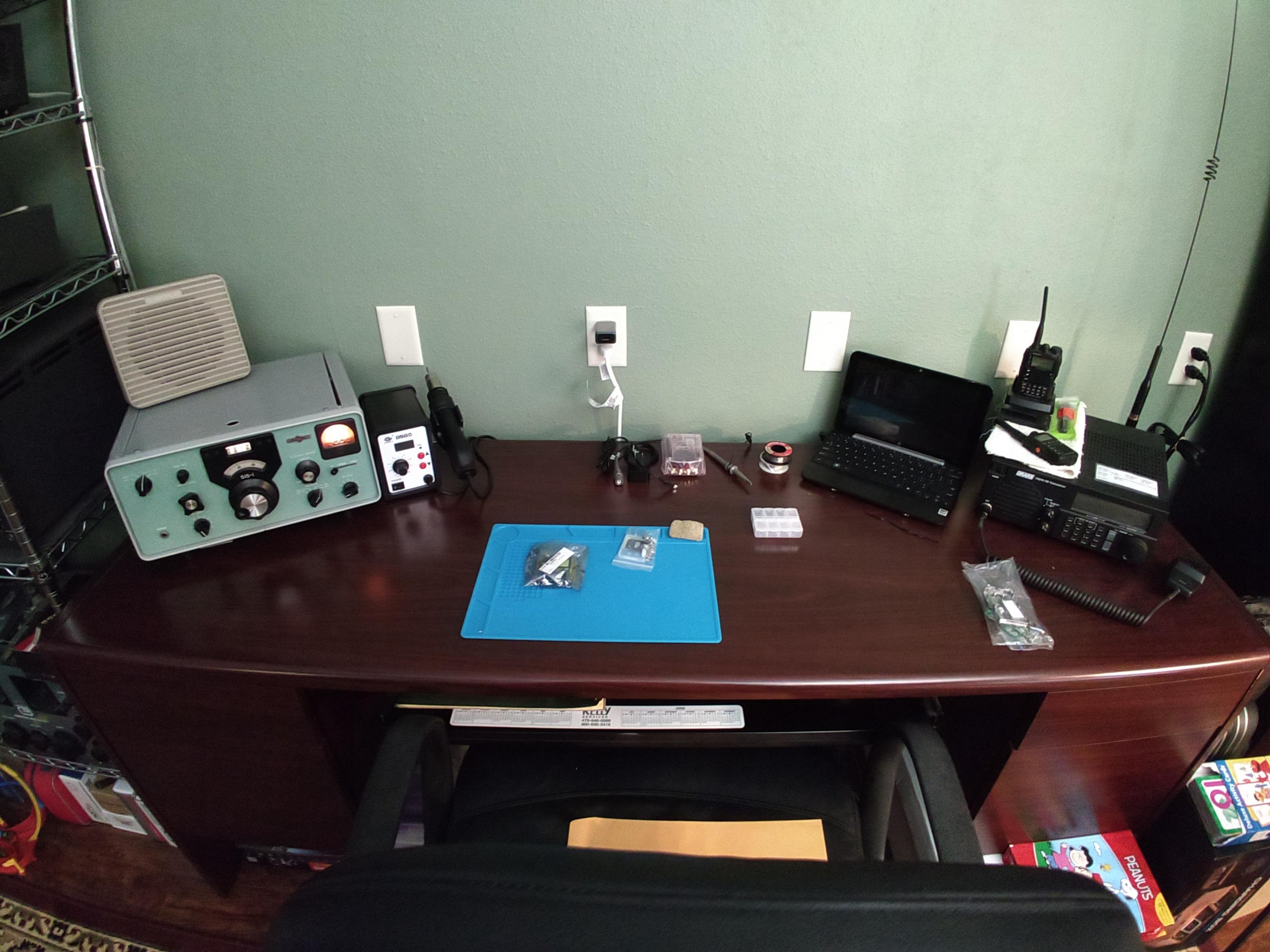

I cleaned off a desk for some light soldering at my office - the Red Pitaya is in the center, flanked by a general coverage receiver and VHF / UHF rig. I can't get it to connect to my wireless network here at the office, and the little netbook on the desk lacks an ethernet port for a direct connection, so somewhat of a dilemma. I'm using the specified dongle, which the RP recognizes, and it sees my network, but it won't connect.
I never cared much for linux, or any of its flavors. Hope I don't have to learn it. I suppose I could bodge / force a link by plugging the RP into an old wireless router, and connecting the netbook to that. I'm sure I have one here, somewhere.

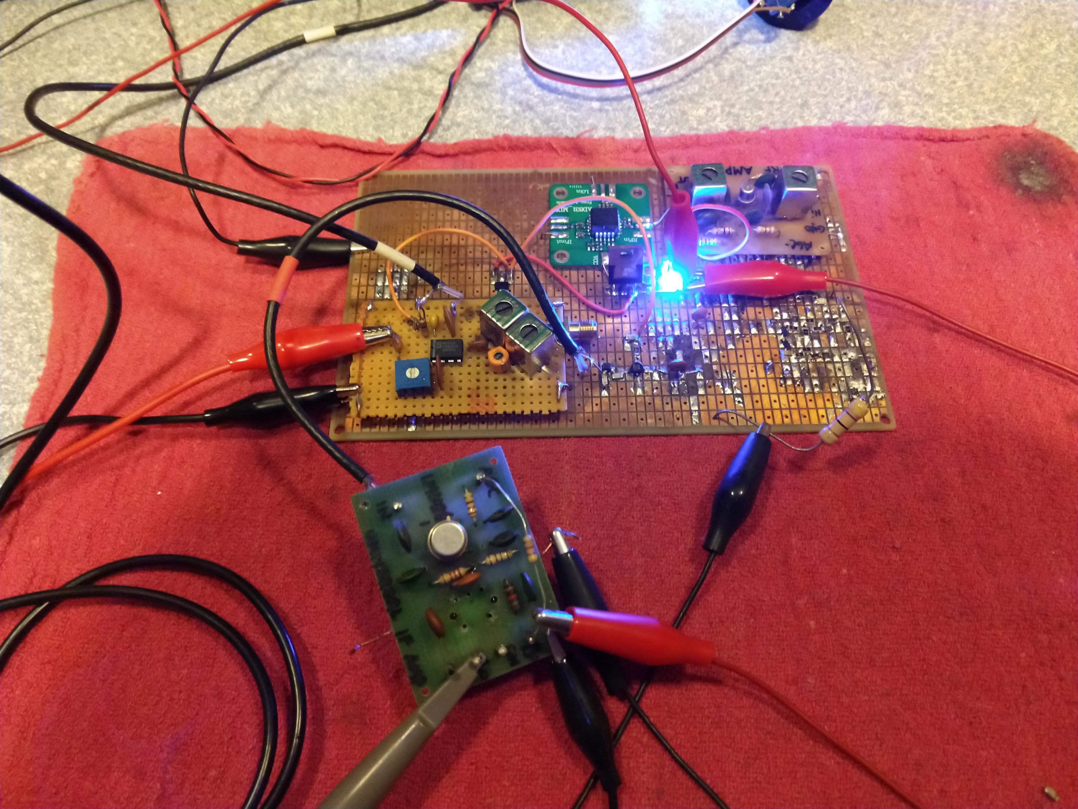

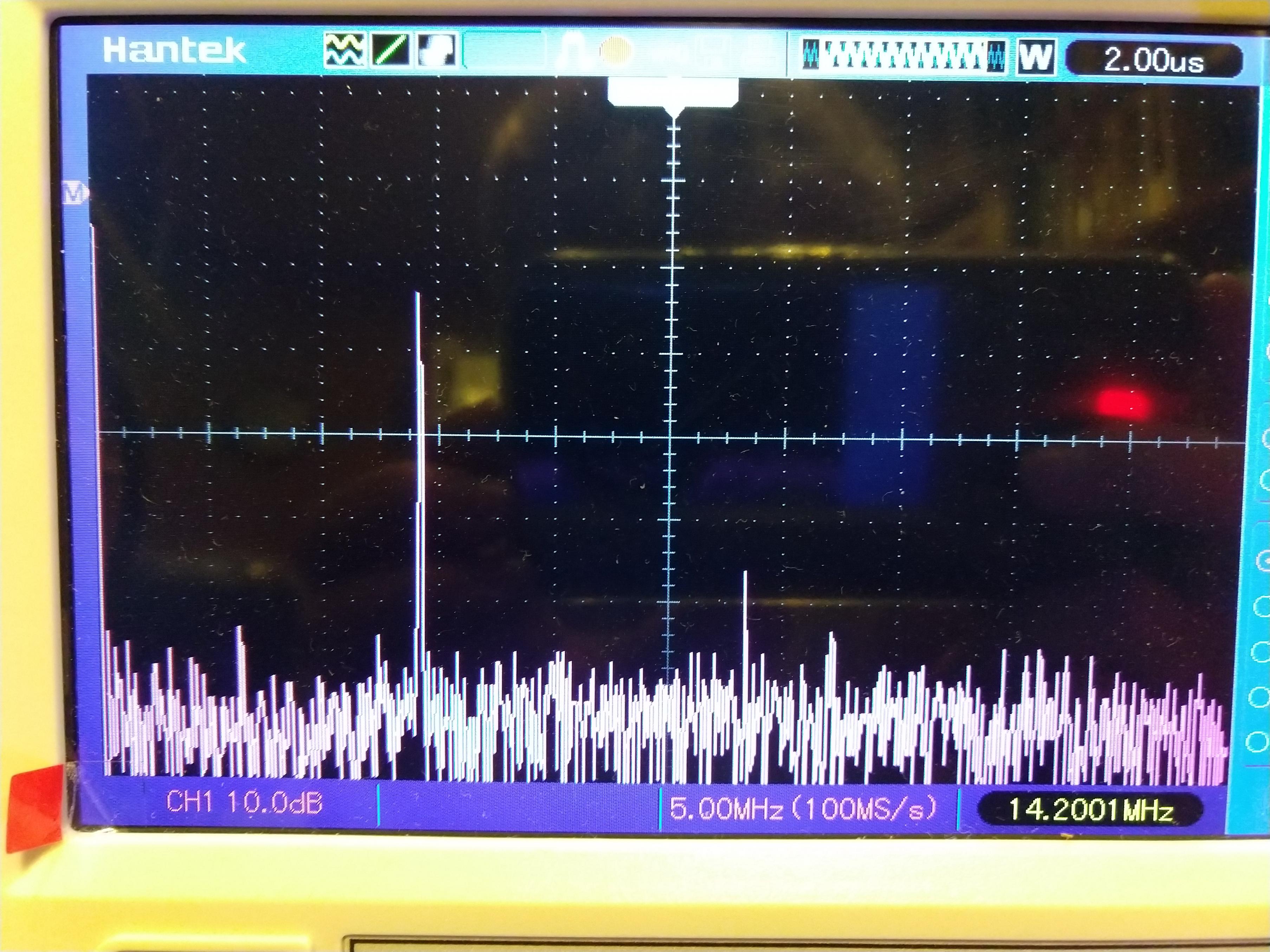

I subbed in an LM3053 amplifier after the mixer. I didn't have a transformer that fit, so I tacked one to the back of the board for testing.
This seems to work pretty well, is a good match to the bandpass filter output without any additional matching, and doesn't require any special voltage considerations. For now it gives up broadband, but seems to be much more resistant to overload. I'm getting about 6 dB more gain than the MMIC, with identical drive, no stability problems as far as I can tell. Plus, there is a DC input to control the gain that might be useful, if I can figure out how to do ALC.
I have a bunch of MC1350, so might also try one of those in this position.
