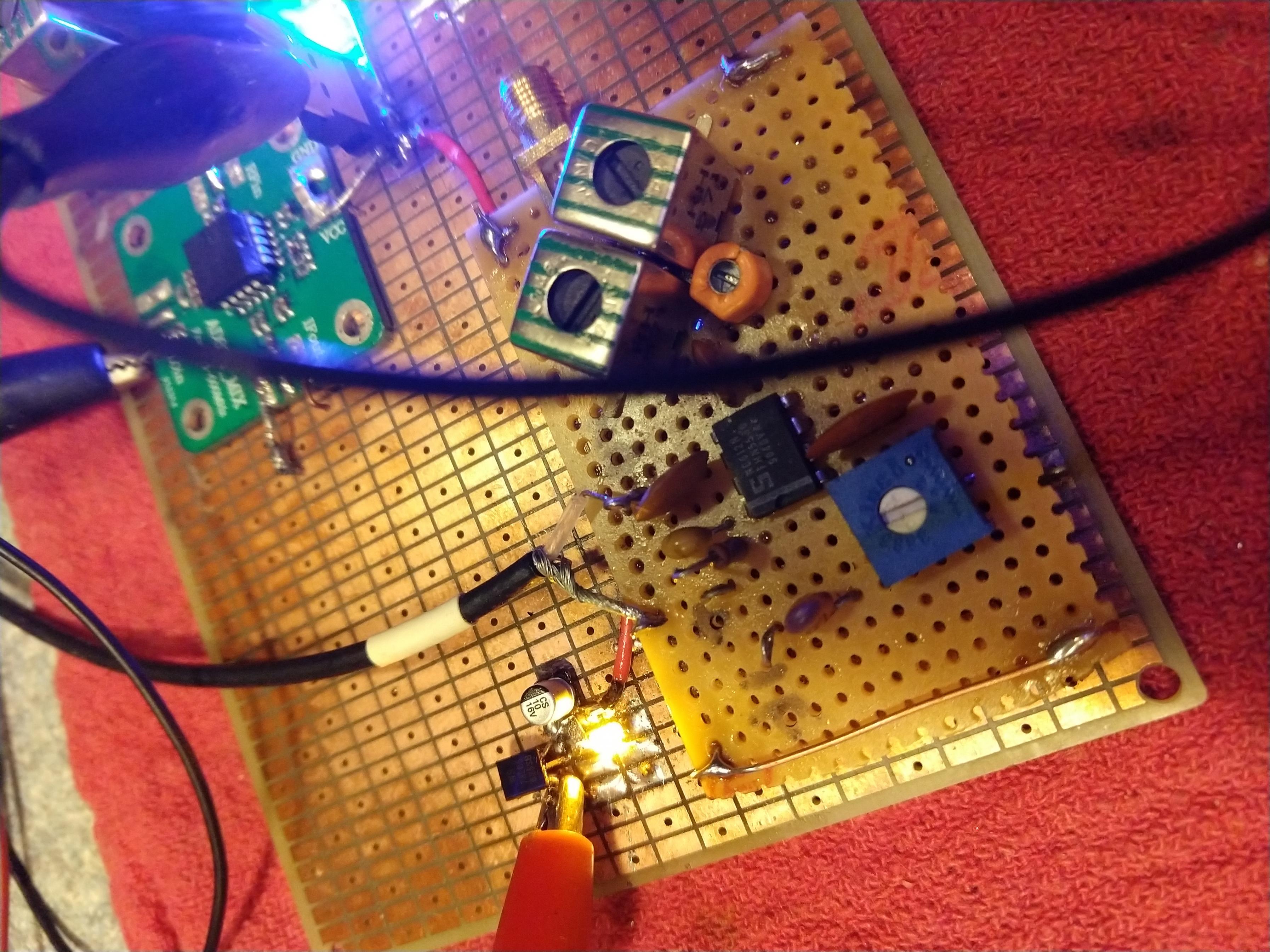

Adding a few ma to the zener worked, and brought the output up by the zener voltage.
I then removed the zener, and installed a floor sweeping quality, yellow LED, in its place. Interestingly, the LED lit, and brought the output to 6.9 volts without any need for additional positive voltage. Adding a few ma to the LED brought it to 7.2 volts output, but, considering the trouble of adding in a 1206 resistor after the fact, probably was not worth the effort. I was afraid an 0805 might overheat.
I did not get a chance to try the two resistor trick.

It appears that all three tricks can still work, if, like me, one is over stocked on 78XX.
I pulled the LED, and used a 680 ohm resistor for the sense resistor, and a 1.2K resistor in the ground leg, and got 7.7 volts out of the 78L05.
Input is from a 7809 that powers the AD831 board, so overhead is probably marginal, but it only needs to supply 3 ma. It is not convenient to pull the voltage for the 78L05 from a higher potential.

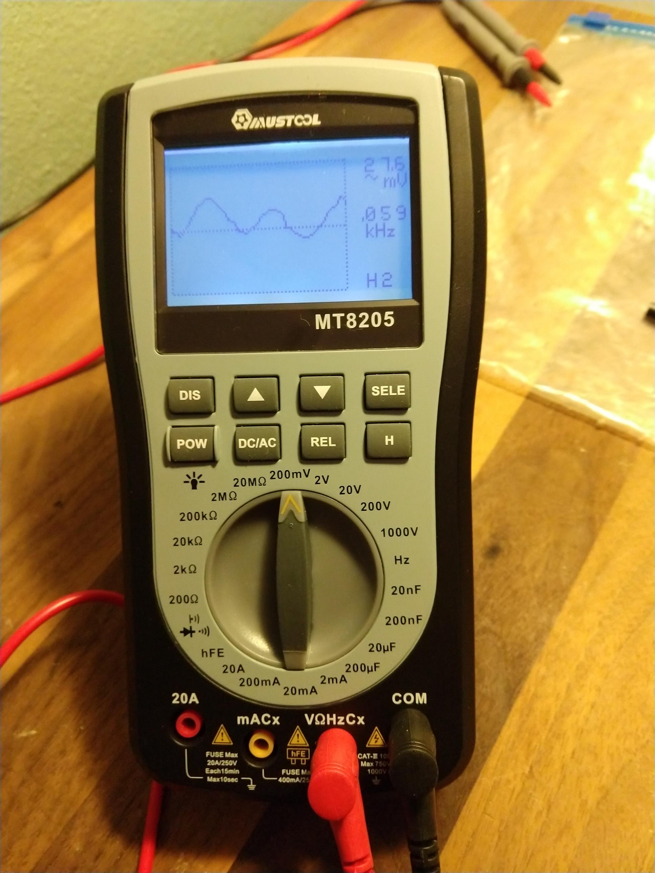

Yes, it's really a DMM with a high input impedance (10M IIRC). The analog meter reading is derived somehow, and seems fully protected from slamming the peg on overloads or reverse polarity. Still very useful for looking at changing voltages, currents, etc.
The variety of inexpensive, hobby grade, test stuff on eBay is breathtaking. AliExpress probably more so, but eBay always seemed more convenient to me.

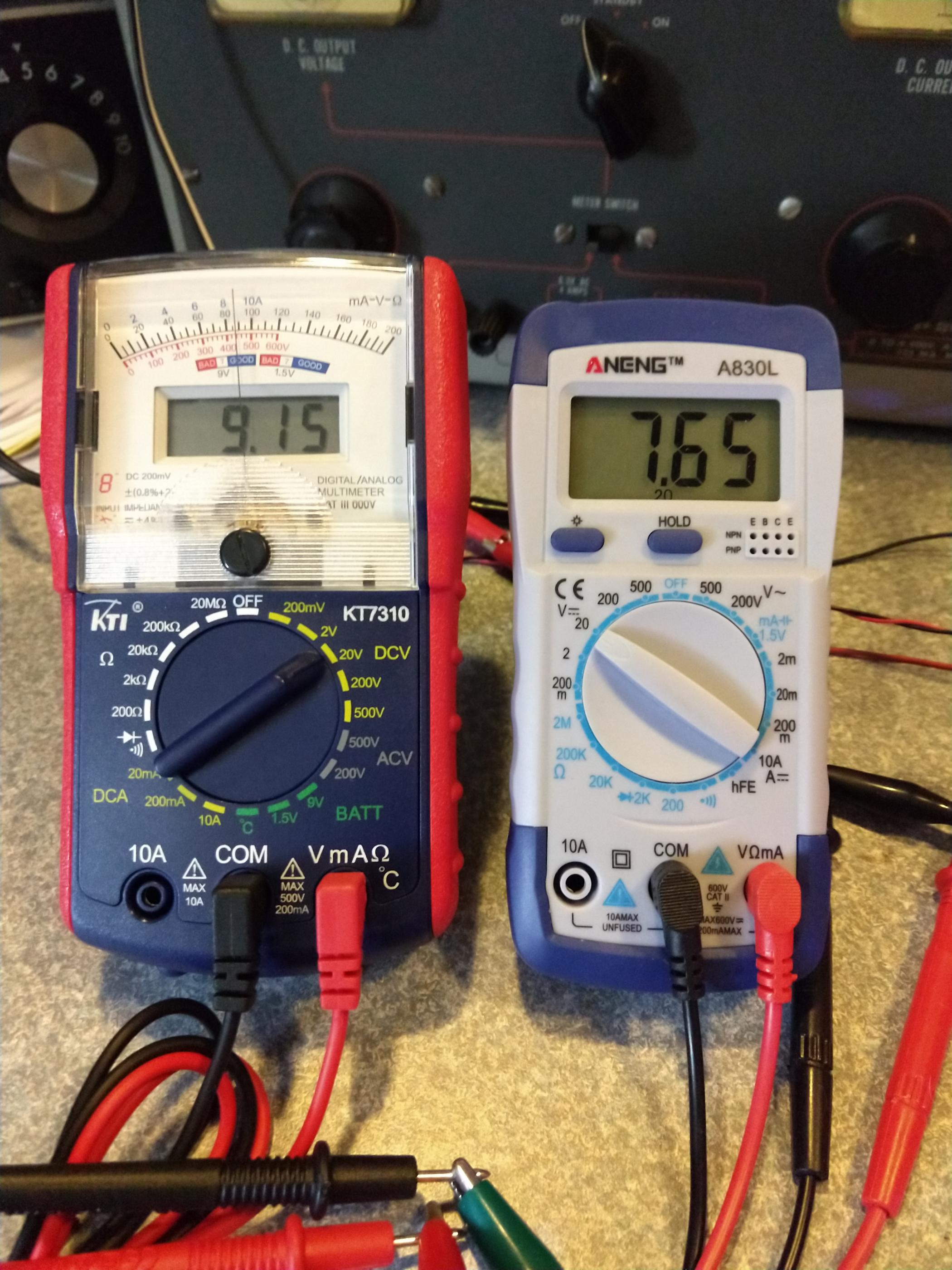

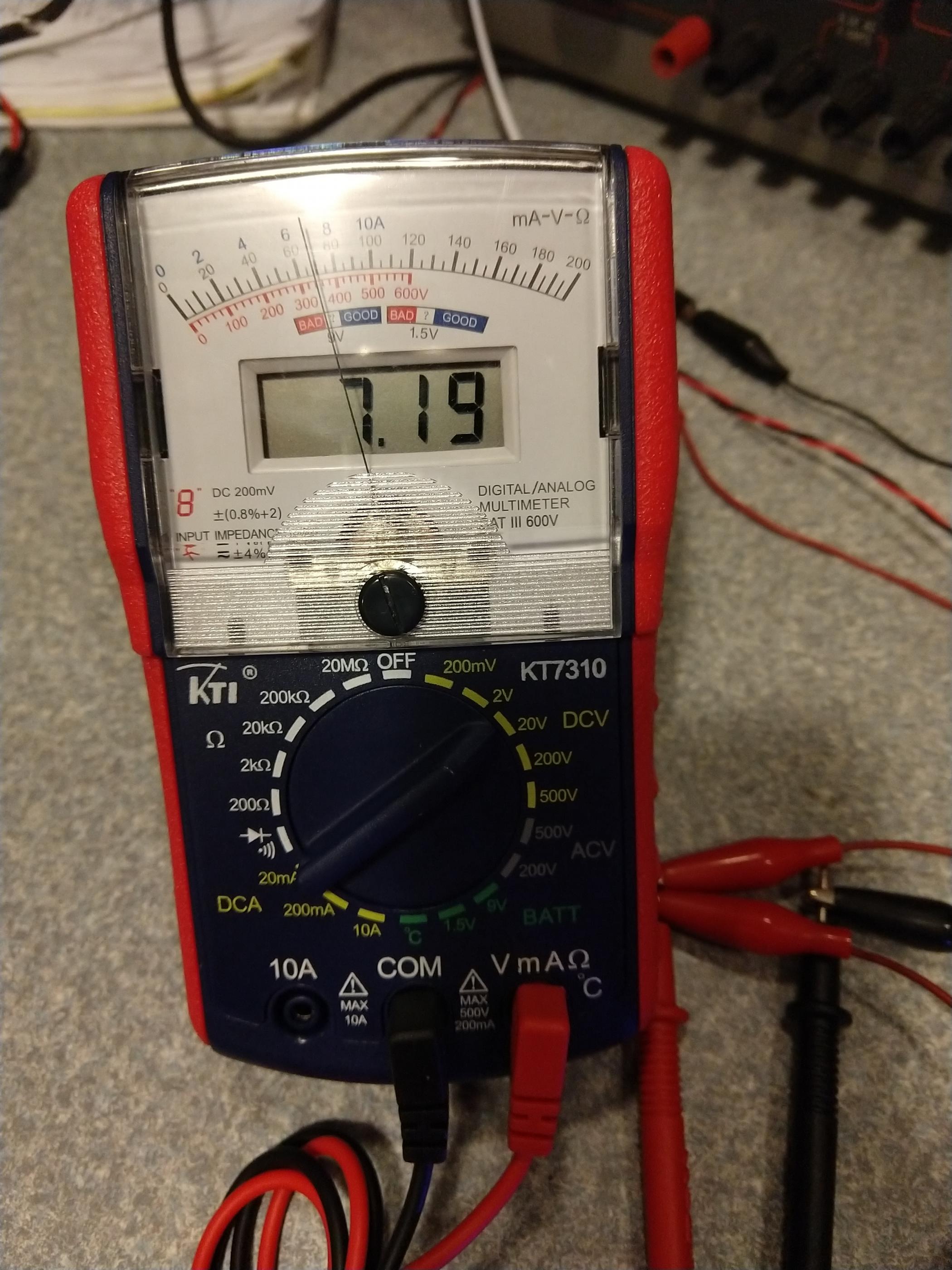

It reminds me of an early car with a buggy-whip socket. Which can sometimes be a good idea.
The specs suggest it is 20k/V, which implies not-buffered. You say it seems buffered. I'm actually full-up on both needle and nixies now, so I guess I can't care.
Well, the listing says 10M; if there's an easy ( not time consuming ) way to check it, I can try to determine exactly what it is. It has no provision for zeroing the meter like a traditional VOM:
KT7310 portable digital analog dual display multimeter 9 functions in 24 ranges | eBay
Of the cheesy, cheap, ebay DMM's out there right now, this one is actually my favorite - it has a graphical display with a bandwidth out to about 15-16 KHz. It's pretty good at measuring very small AC voltages. Of course, in true fast and loose fashion, it's typically listed as an oscilloscope.

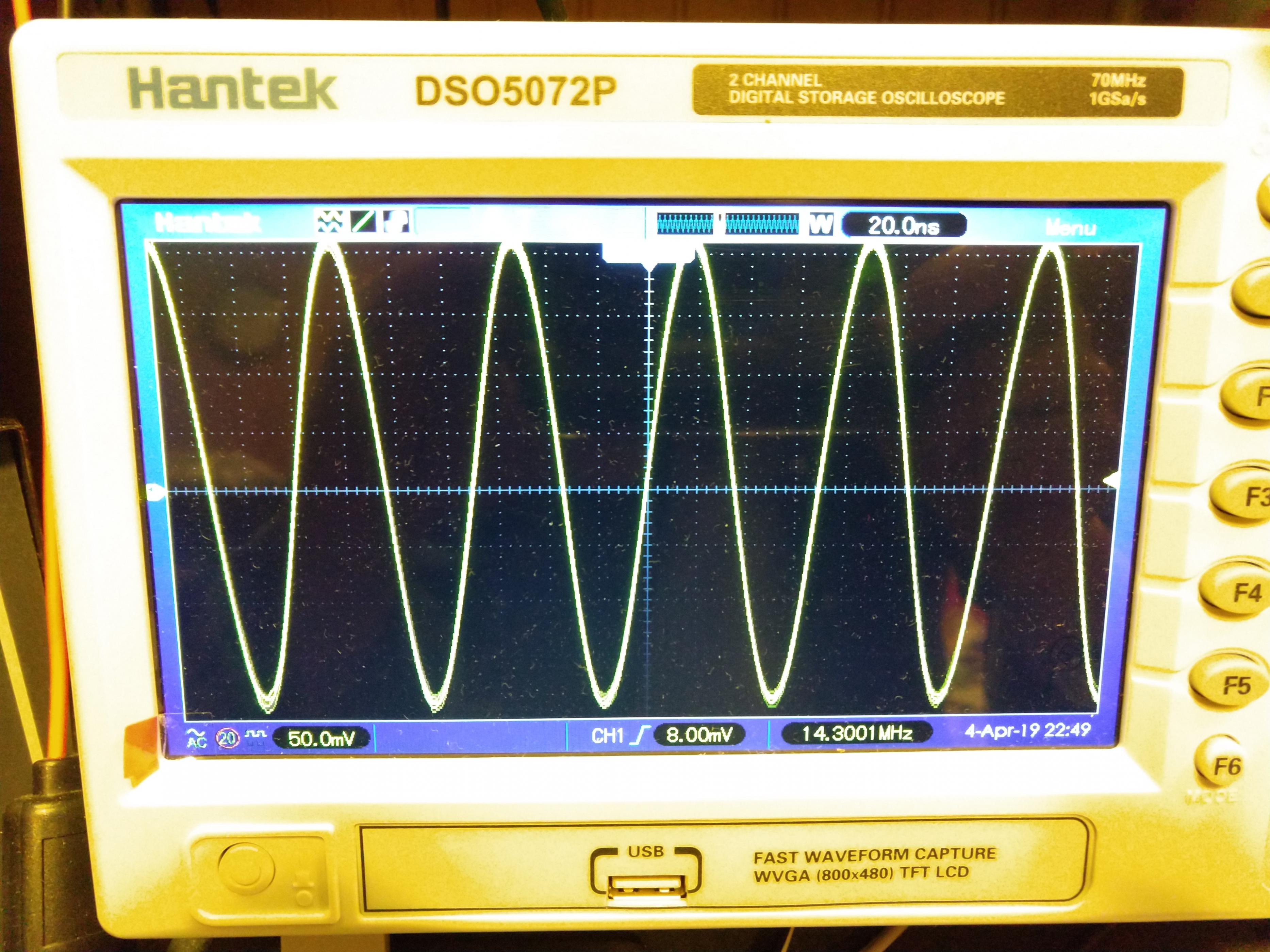

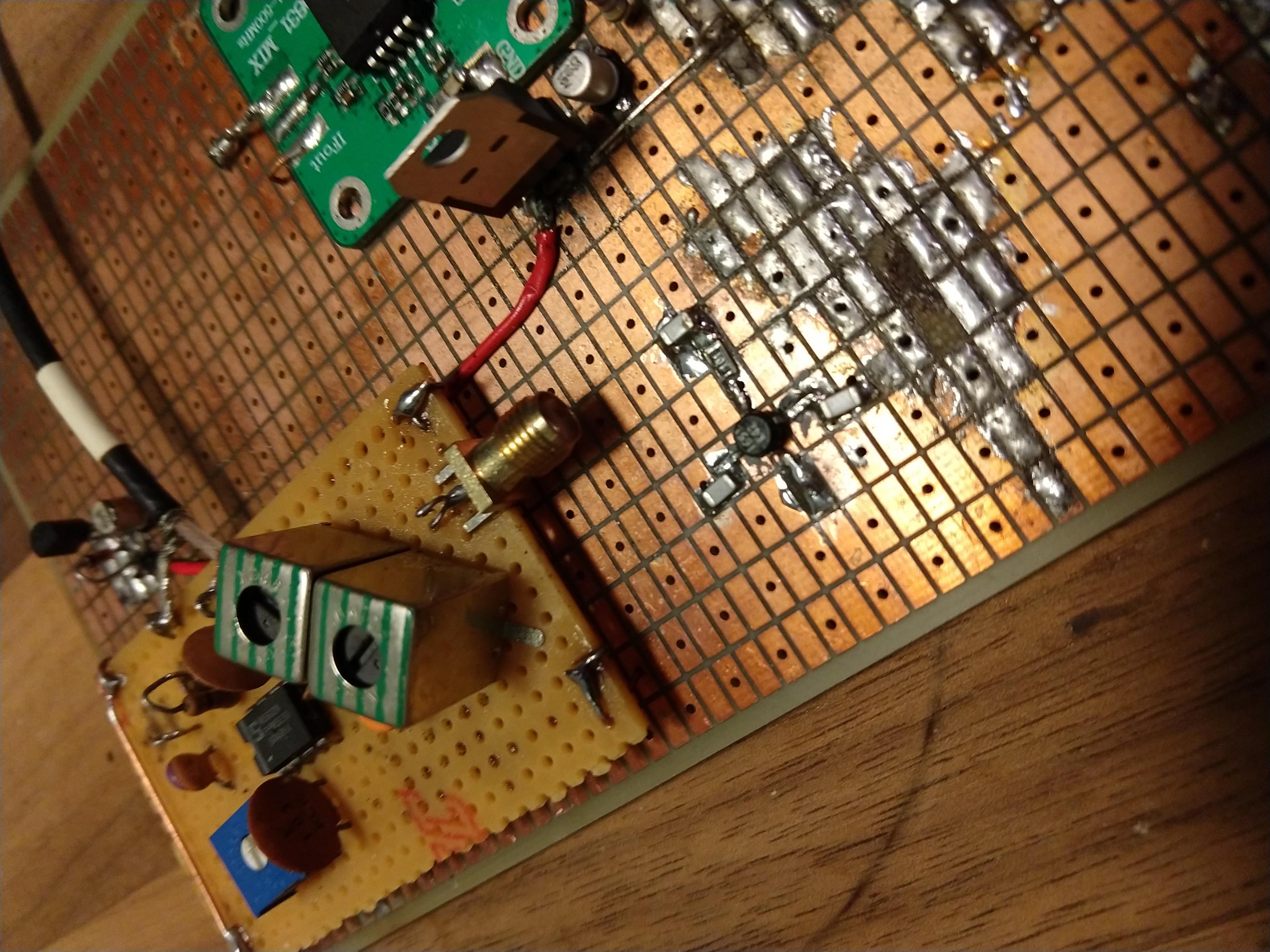

No real progress to speak of - since the tx mixer output looks clean, I dropped one of the NEC upc1651 MMIC's ( last seen as an unsatisfactory broadband amp on the alternate, perf board based, wideband front end ) on to the current board to play with as a gain block. Haven't tested it yet, other than to verify it draws the correct amount of current. Should work, may need some matching at the input.
Since I haven't had much time to work on this, I bought an extra SMD rework station and I've been putting together a travel kit of extra tools / very modest test equipment / common use leaded and SMD parts to allow for a little bit of work when I am at the lake house, or even in spare time at the office.

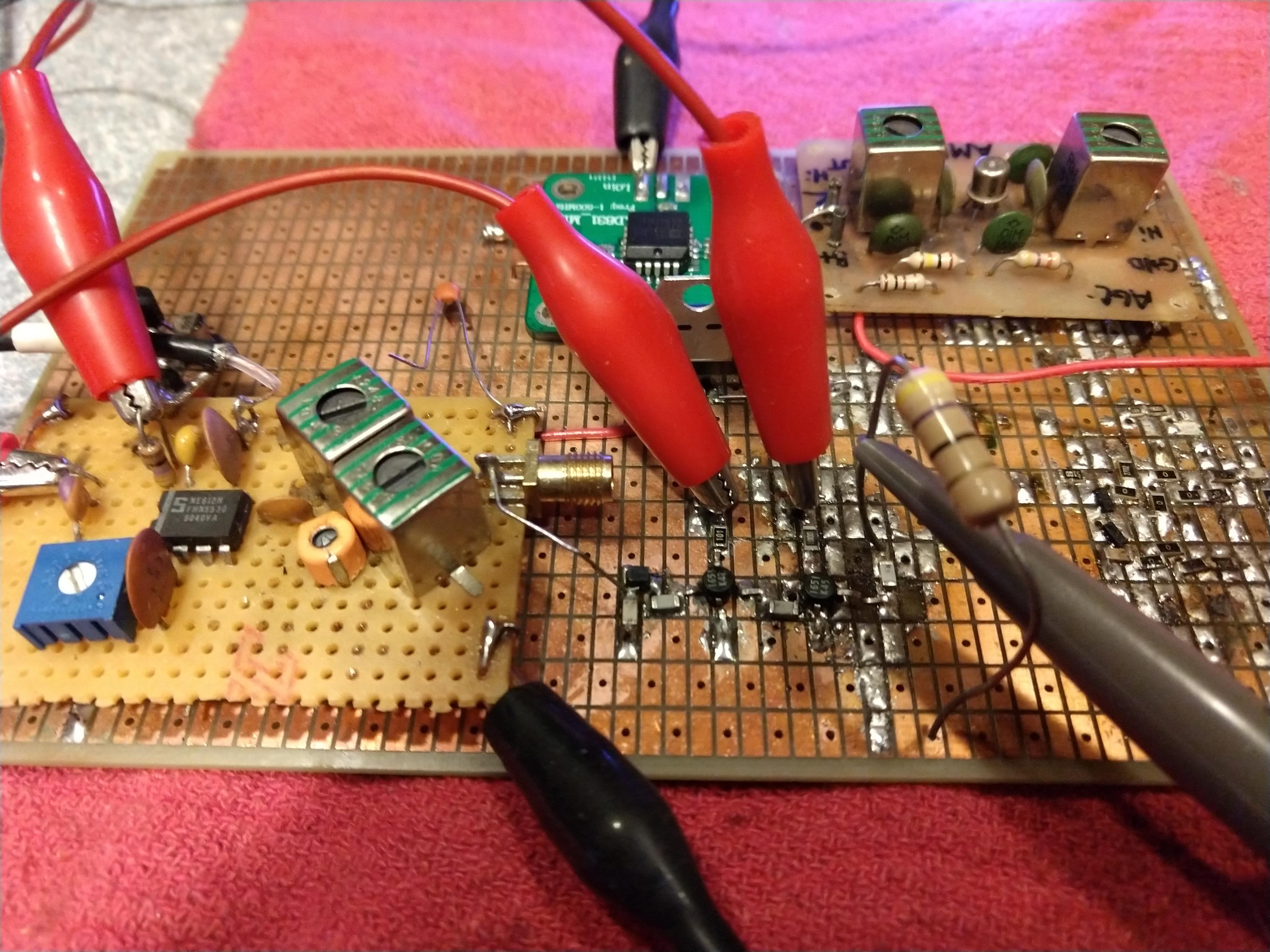

I tried driving the upc1651 direct from the secondary of the last transformer in the bandpass filter, and the results were unsatisfactory. I was not able to get much RF out of the upc1651, It was unable to drive the 50 ohm load.
I added a small LC network to match the bandpass filter output ( I guessed this was about 1000 ohms ) to the 50 ohm input of the upc1651 MMIC, and added a second upc1651 in the signal path, thinking that the matching would be poor, and that two chips would be needed to get to the rated +5dbm output of the upc1651 chips.
The second chip smoked out as I was bringing up the voltage. I took a look with the scope ( second pic ) at the input to the second chip, and apparently I got the matching pretty close to right - it sure looks like a peak of +5dbm at 50 ohms going into the second chip. The waveform out of the first MMIC looks pretty good.
So, I'm going to have to pull that second chip and select a more robust 50 ohm gain block, or maybe go with a narrow band gain stage. I'll have to think on it some. I would like to get to about 200 mw or so, which I think will be enough to drive an external power amplifier.

So, assuming I am at +5 dbm peak at 50 ohms, as it appears I am, I need another 15 to 18 db if my arithmetic is correct.
Tubelab suggested this chip as a gain block several months ago:
Mouser Electronics
I took another look at the datasheet, and it looks like it could take me to 20 dbm ( 100 mw ) but the spec sheet cuts off at 50 MHz on the low end.
