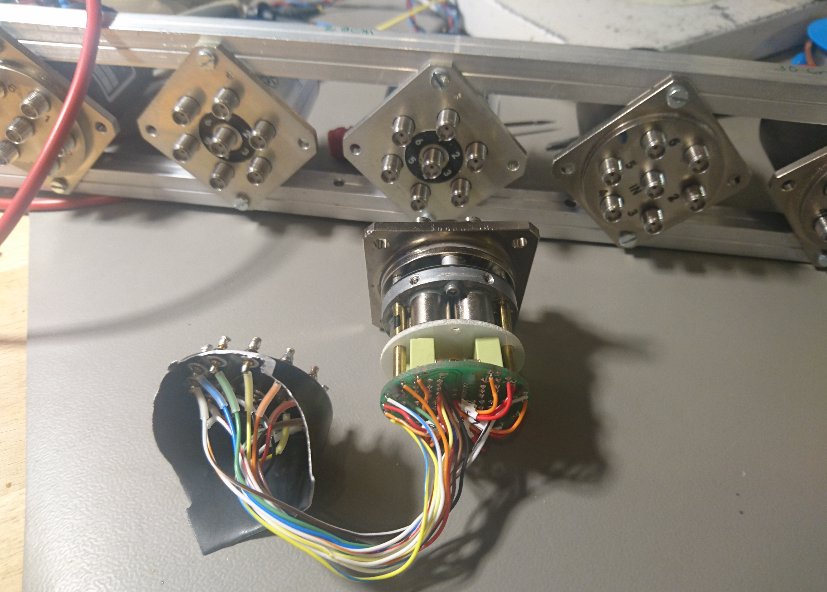

I have that ADC finally running. It was a lot of software, so I wanted to do something
with bolts & nuts. I decided to build the delay line for my phase noise tester. Two of
the ADCs will later process the noise sidebands more downstream.
The delay line will be used to enforce phase quadrature between two mixer inputs.
That is done with 3 * 2 Coax relays, each 1-to-6 and many, many coax cables.
A coarse, middle & fine stage for use between 5 MHz and 100 MHz. I have collected
the relays over the years on ebay & flea markets. It turned out that 2 of them had TTL
drivers and both of these had defective bits 🙁
They were impossible to open in a gently way, so I filed a hole into the can and then
peeled it away. I hope the coils are still ok, I do not need the TTL drivers.
Gerhard

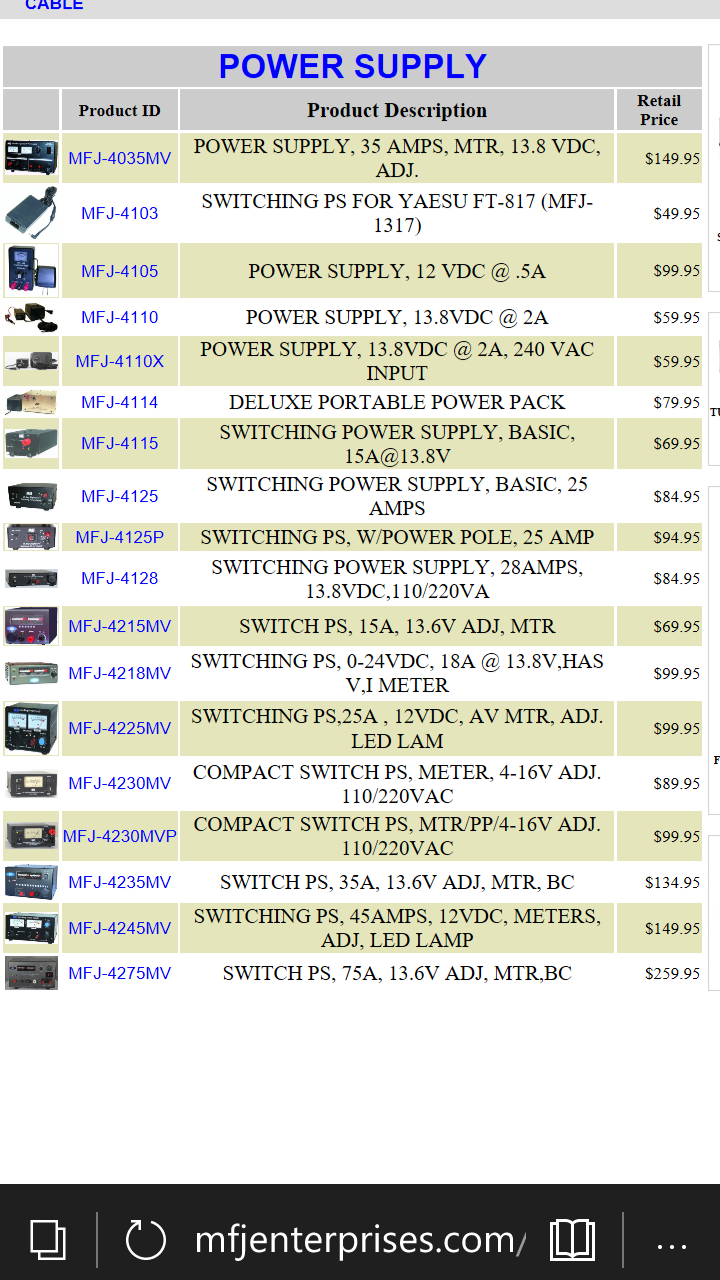

google a linear 3A 30V triple supply. can be paralelled to get 6A. there are many switchers that inject lots of noise into the ground.

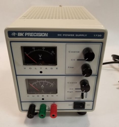

Any suggestions for a lab supply on tube heaters.
I like the adjustable metered supplies but looking for maybe other ideas.
Hash is usually the issue on audio apps. 4v to 13v needed.
Found a solution to my question.
B&K 1730 totally linear dual-range bench supply.
Perfect for heaters during prototype stage. Sets noise baseline for switchers later.

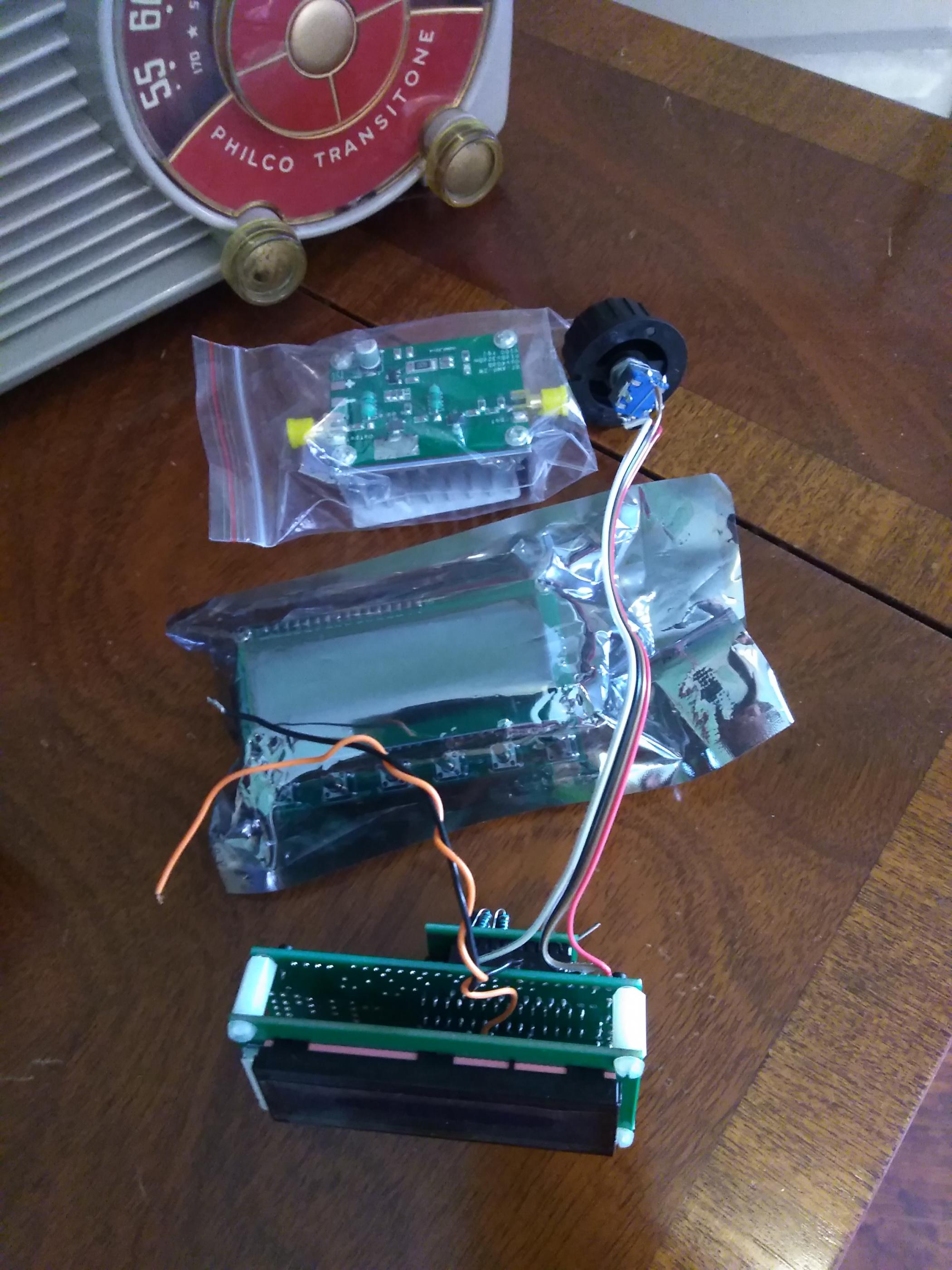

Stuff has been trickling in ....
The small module at the top is the broadband linear amp. It looks pretty nice, compact, decent construction, etc.
The sealed bag has the AD9850 DDS. Pretty barebones - what is in that bag, is what I got. No encoder, no pigtails for the onboard connectors. This is an observation, not a complaint. The price is certainly right, if it works. I don't have the correct connectors, so I'll have to hard wire to the board, or try to find some at one of the electronic shops up around our second house. I'm back at the office for a few days before I head back up there.
The third pic is the QRP Labs Si5351 frequency synthesizer. It is almost the same size as the DDS. The DDS is a bit larger because of the pushbutton switches along the bottom. The Si5351 board gets by with two buttons on the back of its mainboard. I've played some with the programming on the QRP Labs frequency synthesizer, and I'm pretty impressed with that aspect of the device. It's really a nice piece, the Si5351 notwithstanding.
Its turned pretty cold here, so even though I am back for a few days, I don't anticipate doing much work out in the shack.
Win W5JAG

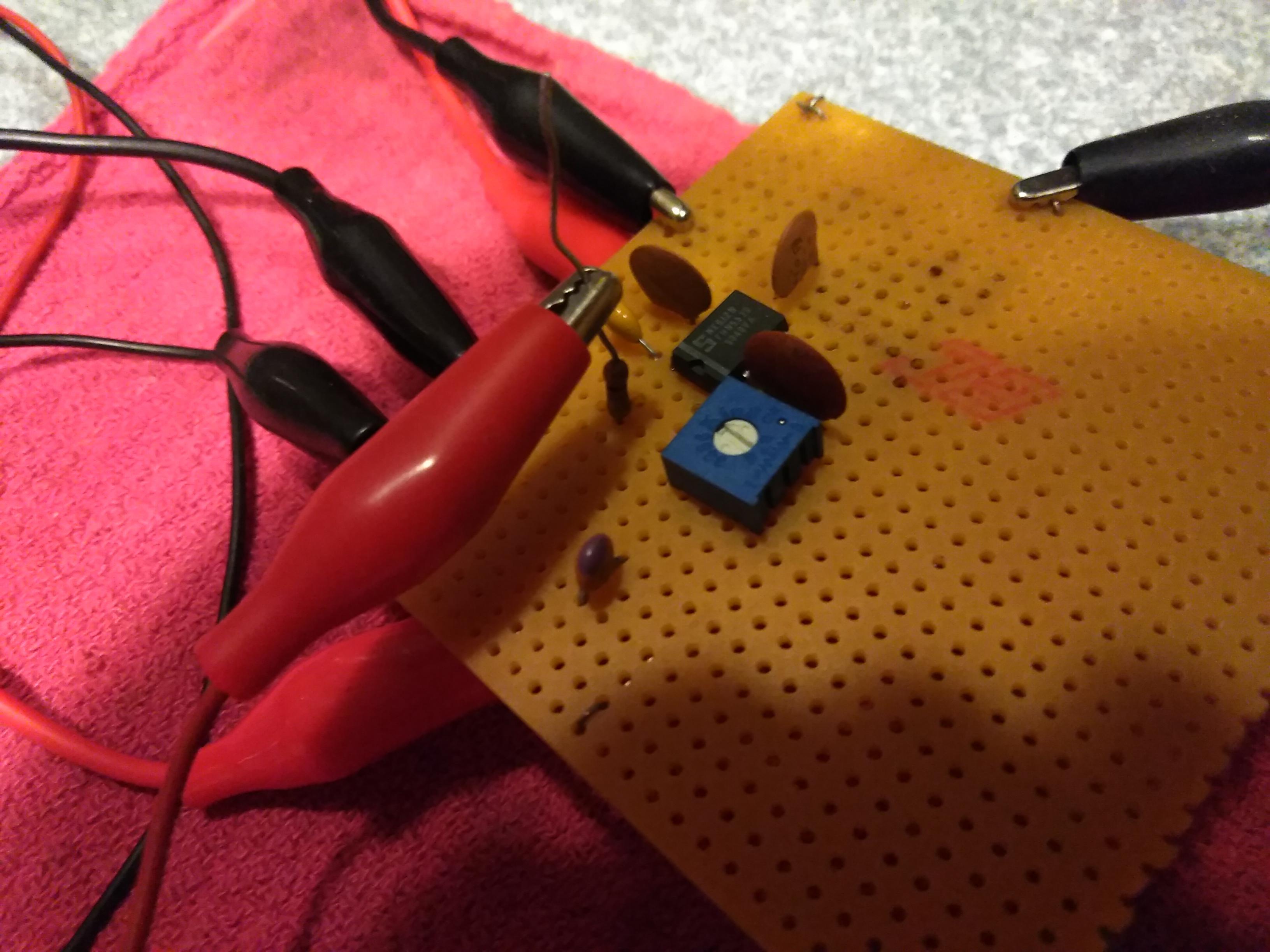

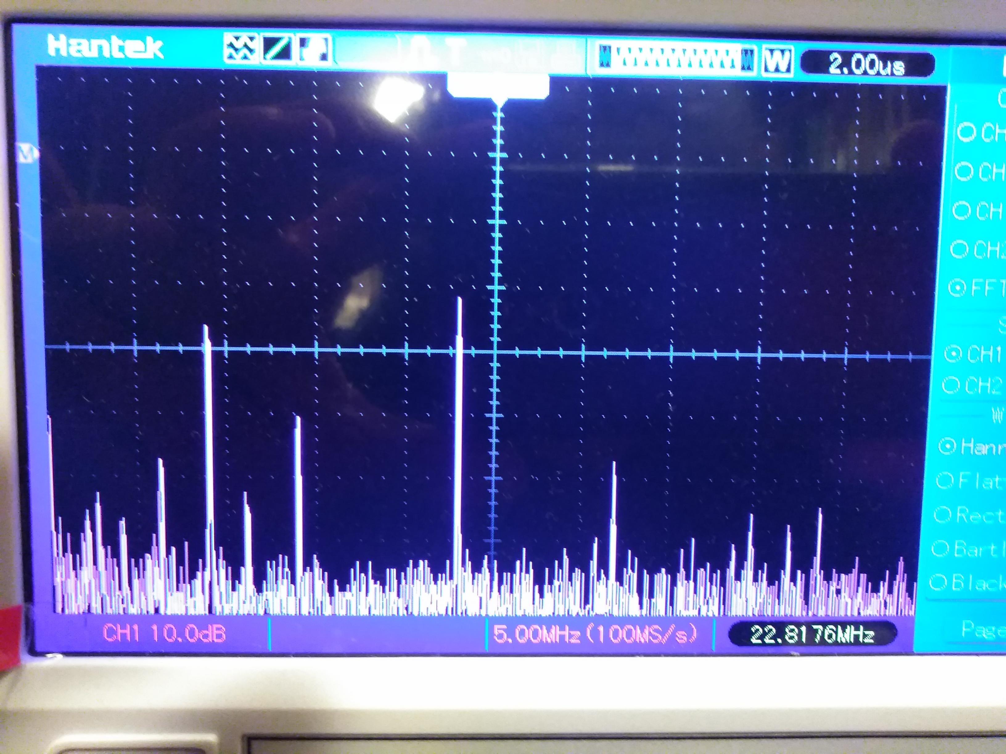

Check this out, Hams:
Ordinary SA602 (DIP) mixer chip, 6 volts B+, wired in the typical manner - single ended input, and output taken single ended through one of the two output pins; the unused output pin is floating, EXCEPT a 1 meg trim pot is connected between the two input pins, with the wiper to ground.
9 MHz goes to one input pin, the other pin goes to ground through an .01 cap.
LO goes to pin 6.
The FeelTech DDS is used as the signal generator.
First pic is the test setup on a piece of scrap perf ( sorry for the lousy pics ).
Third pic plainly shows the 9 MHz simulated SG-9 input, the 23 MHz LO, and the 14 MHz mix product.
Center pic shows how adjustment of the 1M trim pot has brought the 14 MHz signal up 7 dB, and nulled the LO port. The DSO is counting the desired output signal.
So, it does look like there is merit in pursuing the idea that the Si5351 spurs can be nulled sufficiently to make a clean TX with ordinary bandpass filtering of the mixer output.
I expect that balancing the output should null the 9 MHz input to some degree, but I'm not sure that is even necessary - it is easily filtered out.
A caveat: it takes a very low level of LO to do this: I have the FeelTech set at 0.3 volts and then that is fed through a 22 pf capacitor to the LO port, so conversion gain would suck, but I don't see that as a big deal in a TX strip. Gain can be made up later.
Win W5JAG

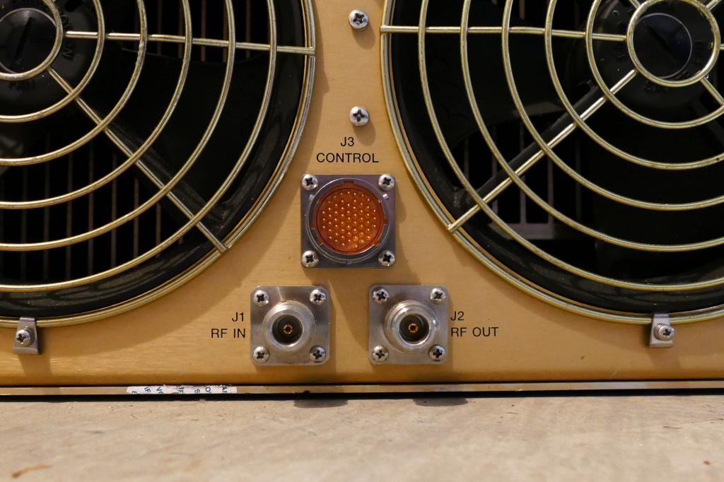

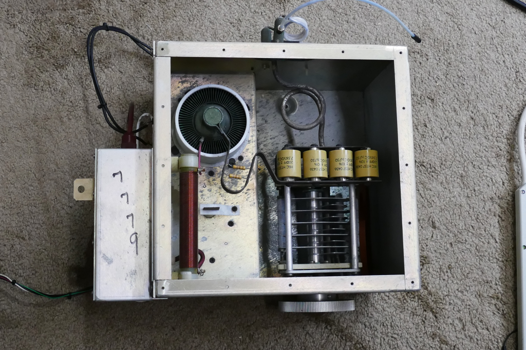

RF stuff??????
I went on a road trip to Florida last week, and of course stopped in at ESRC for a big box full of vacuum tubes.
I also went black Friday shopping at Skycraft Surplus while the women slugged it out in the malls. Got several precut 1/8 inch aluminum top plates for big amp chassis and a BIG box full of assorted SMD parts, most on reels, all for $30.
The RF stuff however was already waiting for me in a friends warehouse where it has been for a few years. I didn't have room for the 10 KW water cooled HF ISM amp, but I did drag back a 1 kilowatt amp that covers 400 to 450 MHz. It is 5 RU tall by 24 inches deep and weighs in at over 100 pounds....fun getting it out of the car and down into the basement. There was another cube with a large ceramic tube and a PI network that found its way into my car along with a 30 dB attenuator rated for 300 watts. 432 MHz EME anyone?

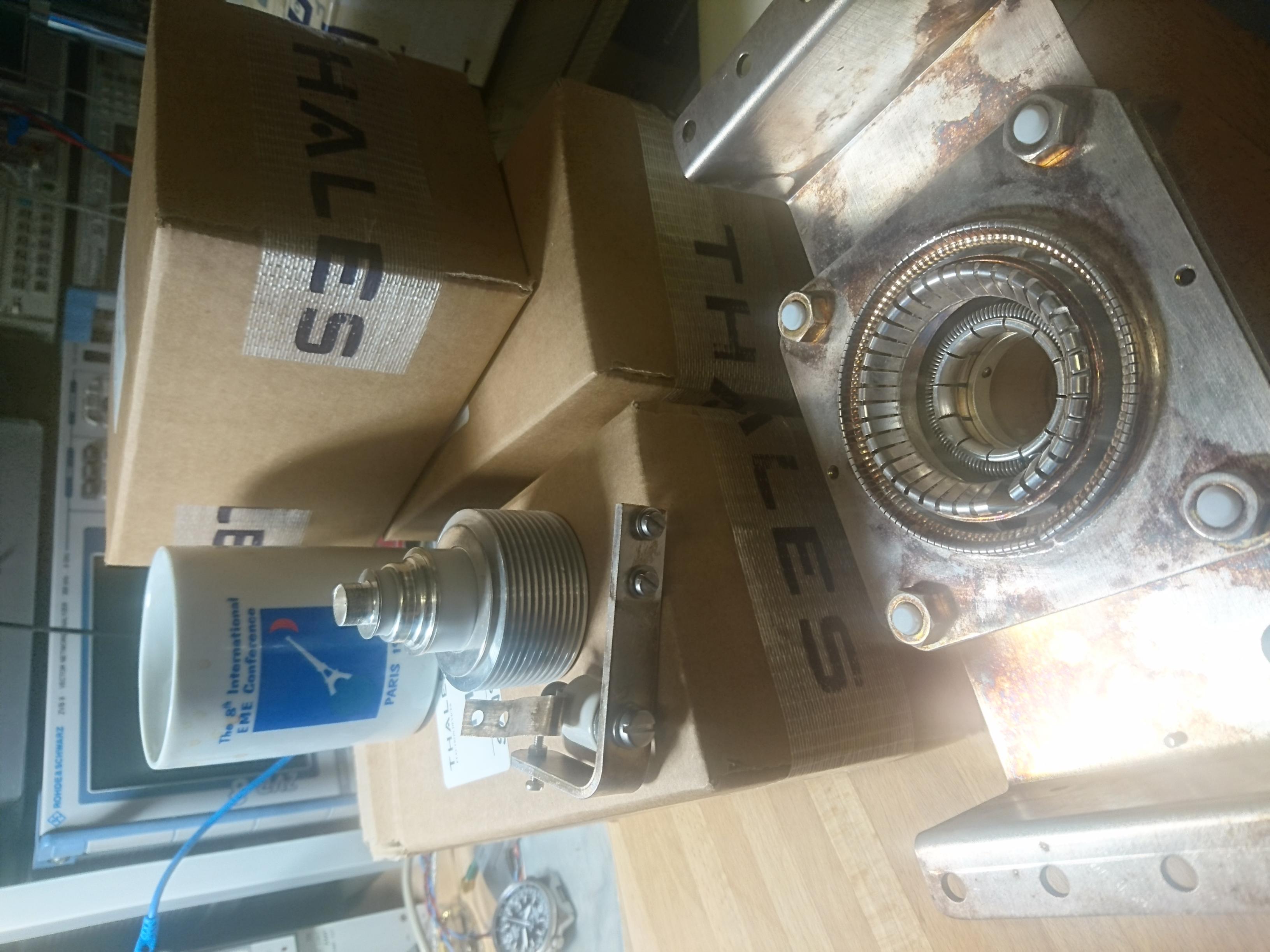

I have found that stuff in the basement this week:
One Coax socket
3 pcs. TH316 tubes, boxes still unopened (all but one, I was curious)
I have no idea what the spark gap is for.
The used coffee mug happened to be still on the table from
earlier this day; it is on-topic by pure co-incidence.
A friend of mine is really active; with his new antenna, 10W
and a 4 element should be enough for 2way qso.
< http://dl7apv.darc.de/Neue Antennen/Neue Antennen.htm >

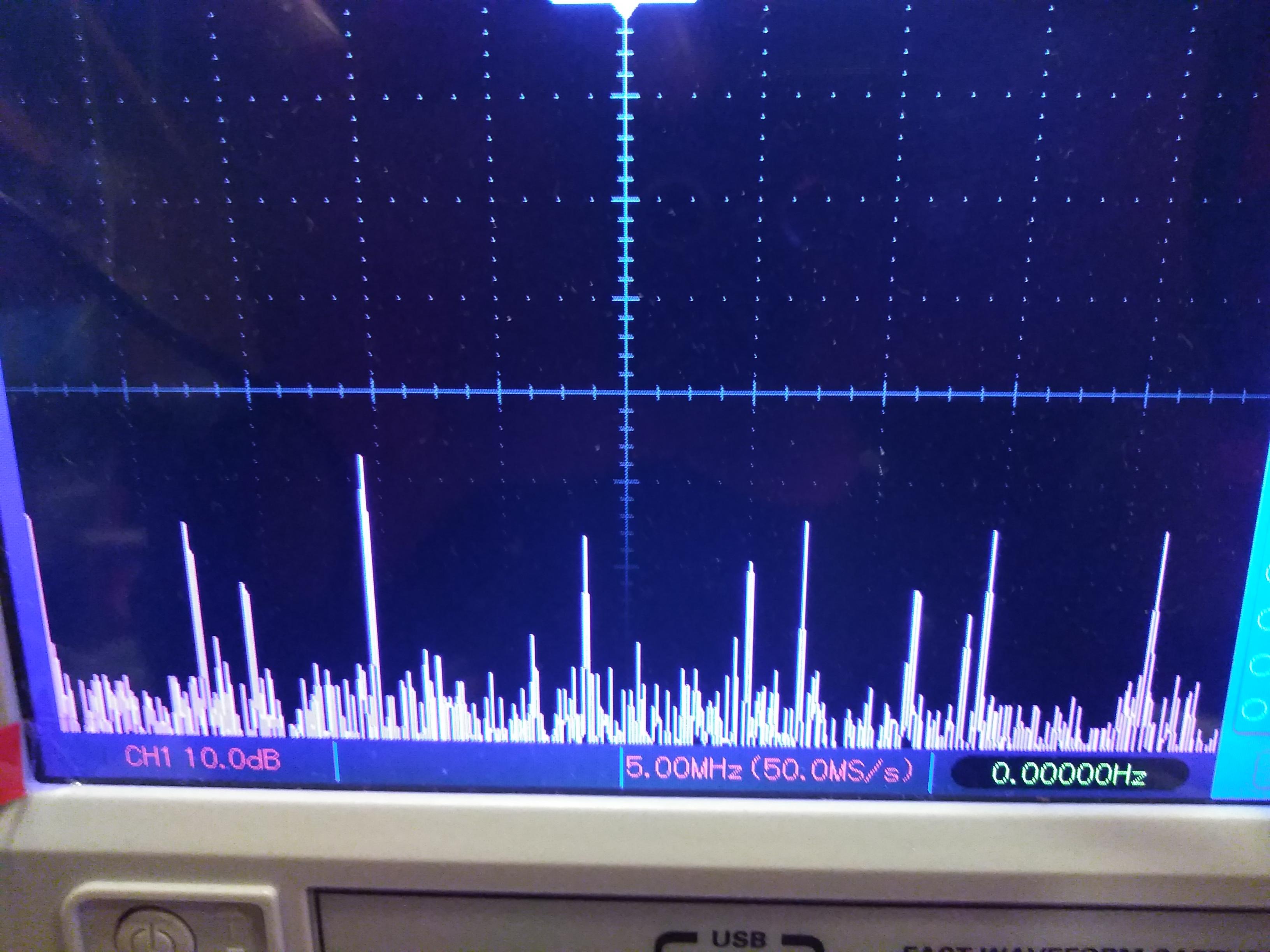

A quick test setup, using the SA602 in the singly balanced setup; 10 dB ish attenuation on the Si5351 LO.
The tallest peak is the 14.3 MHz mix product. Looks like it will work at first glance.
Haven't tried to optimize the LO drive.
Win W5JAG
Win W5JAG
So, unless someone with more RF experience than myself is seeing something that I am not, then, for a 20 meter rig, it looks like those rogue spurs seen at 16 MHz and 10 MHz, and their mixing products ( which move around as the device is tuned ) in the S15351 output spectrum, are adequately cancelled in the SA602 output spectrum, so as to make the SA602 usable as a low level TX mixer in the singly balanced configuration, even though it is designed and marketed as an RX mixer. (Holy run on sentence, Batman).
I think there is more improvement to be had by optimizing the LO drive, and, in any event, LO level will have to be tweaked for the AD831 RX mixer as well. The way this thing has gone down, I totally expect that the optimal LO drive point will be different for both devices.
Interestingly, it looks like the 59 MHz ish output, which works for a 6 meter rig with a 9 MHz IF, should be acceptable to use with the simple HEP MOSFET mixer already on the board and working, should I decide to go with 6 meters, which is still a distinct possibility, the drawback being that a 6 meter rig that would need to be in service by early Spring for sporadic E season. At the glacial pace this project has proceeded, that may be unrealistic.
Win W5JAG
Win W5JAG
