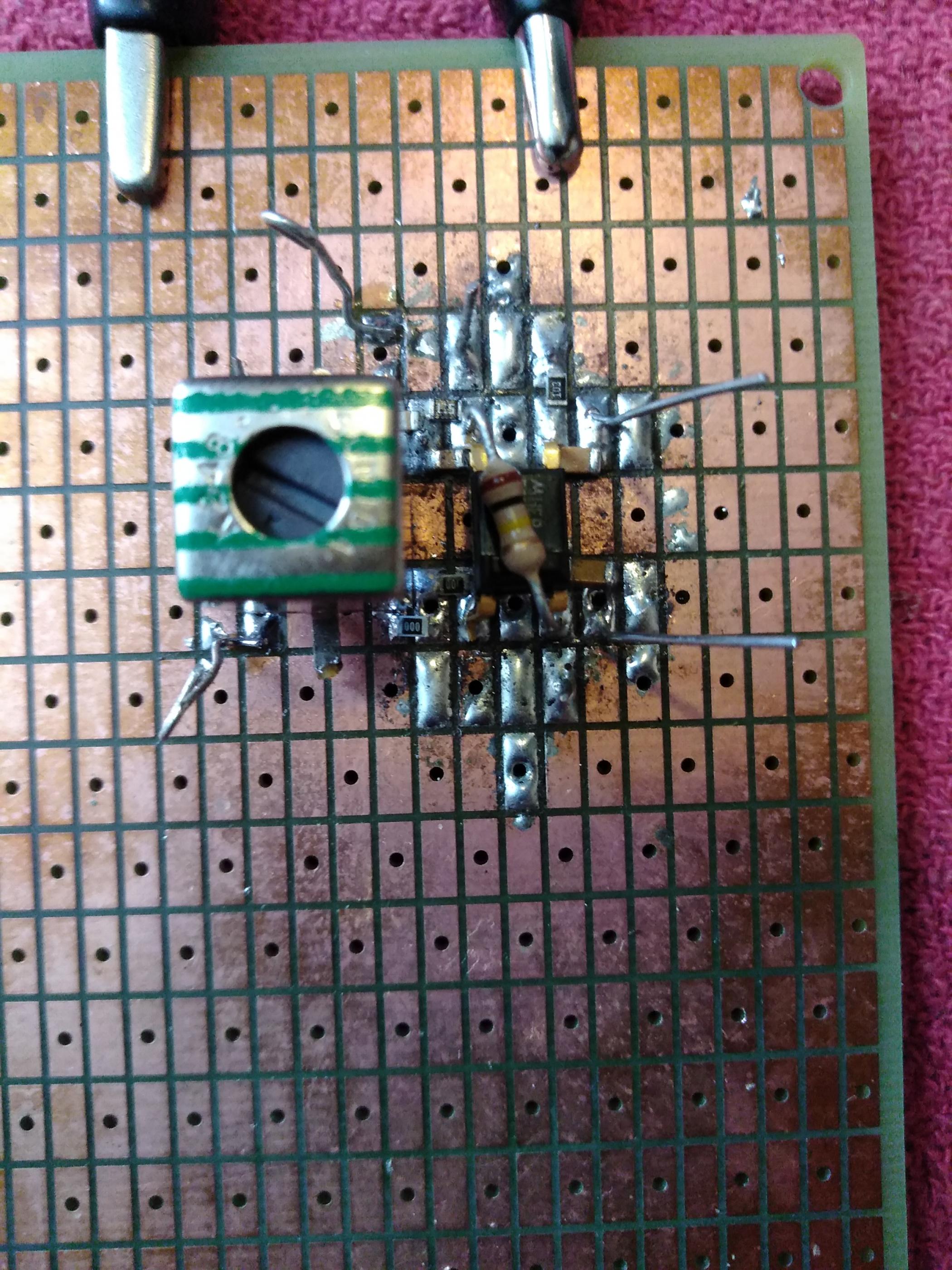

What can I say? I like dual gate MOSFETS. If that AD831 didn't work so darn well, I'd have stuck a DG MOSFET in it's place by now .....

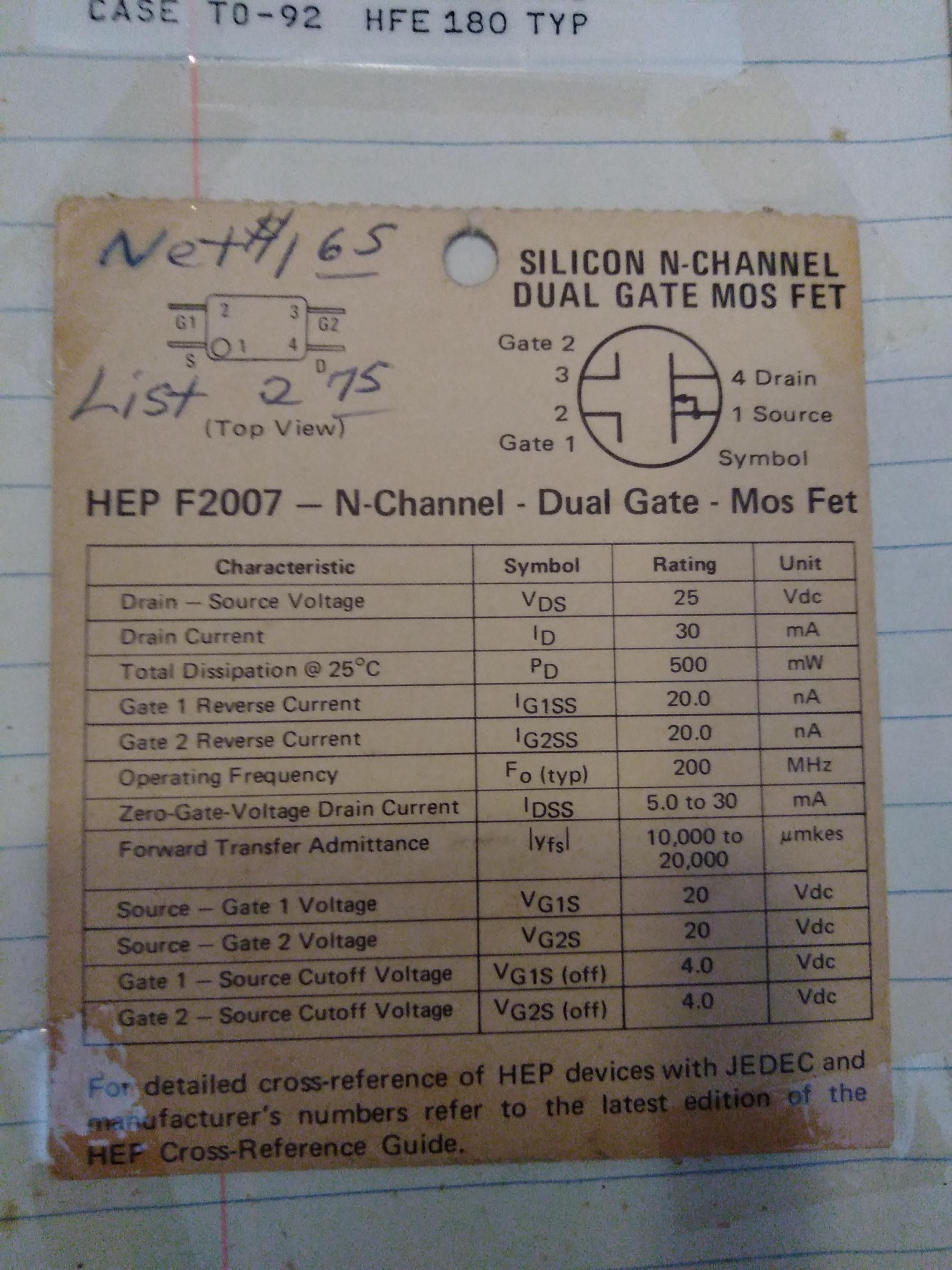

I can't remember what I bought last month, but I am near certain these ancient HEP semi's came from Smith's Two Way Radio in Fayetteville. AR, when I was in college. They were likely long discontinued even by that time.

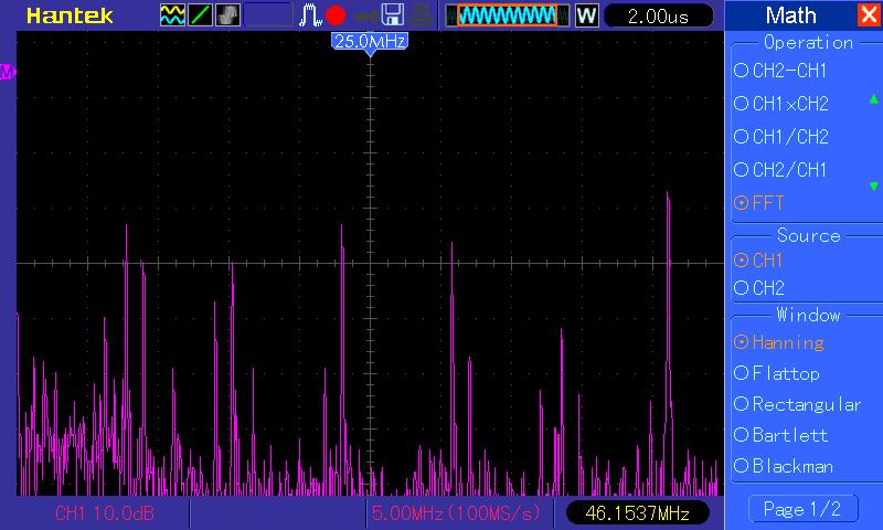

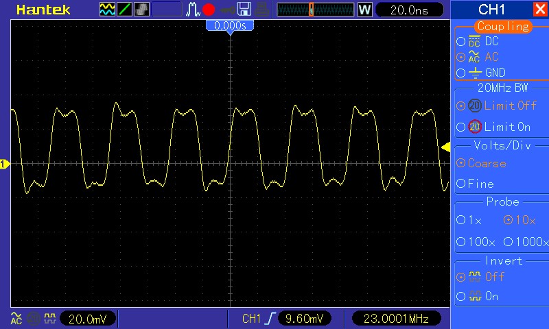

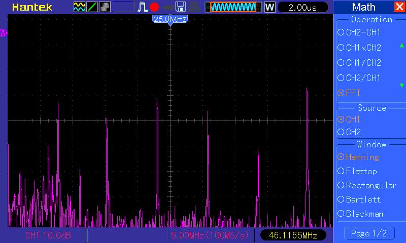

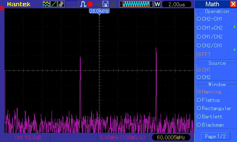

First pic is the 23 MHz ish LO output. The spurs are actual spurs of the Si5351 whatever, they are NOT being generated in the MOSFET. Note the nasty spur ( well, they're all nasty ) at 15 MHz

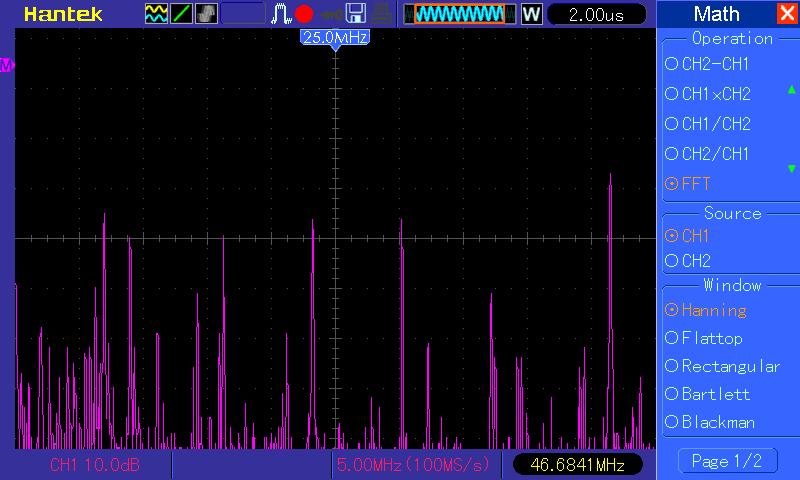

Second pic is with a 9 MHz 200 mv signal injected into the mixer. The desired 14 Mhz output is visible next to the 15 MHz spur, about 6 db down.

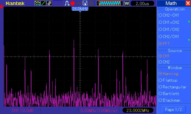

Third pic is the LO being moved about 200 KHz, the spur has moved 1 MHz - it's a traveler.
So, too close to filter out, moves around so can't be trapped.
I have smacked the Si5351 whatever with a hammer. A big one. I derived great satisfaction from this - pretty much ALL the satisfaction I have ever got from the device.

I built out the QRP Labs Si5351 VFO, but forgot to take any pictures of it. There are plenty on their website
It differs materially from the other device in that it has more sophisticated control firmware, 2 fixed outputs plus a tunable output, a 27 MHz reference instead of 25 MHz, and modular construction.

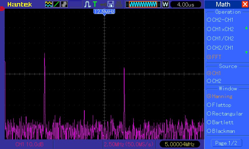

In terms of cleanliness, it's a little better than the other one, but not that much. The synthesis architecture of these devices is just apparently really dirty.

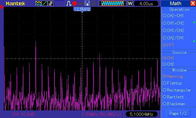

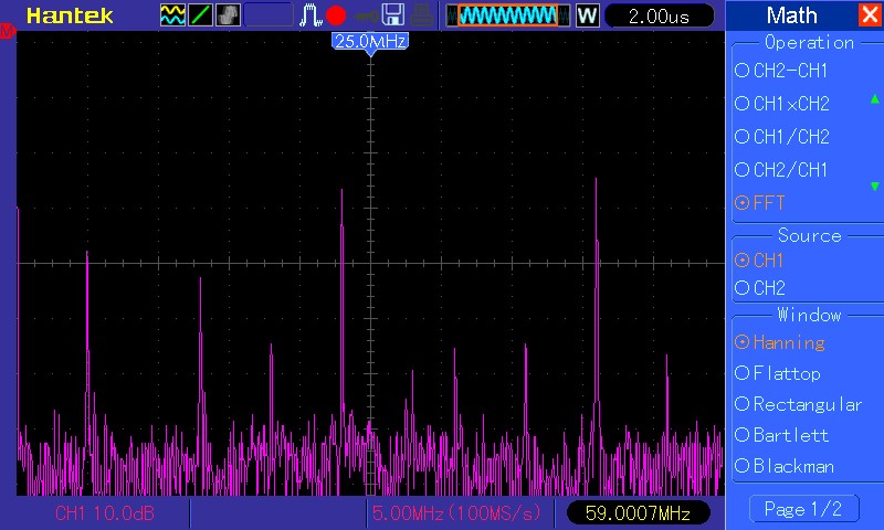

The screenshots pretty much speak for themselves. Multiples of 5 MHz are quite clean. Deviating from a multiple of 5 MHz … all bets are off.
5 MHz would be one LO choice for a 14 MHz rig with a 9 MHz IF. Look at what a difference 100 KHz makes.
23 MHz would be the high side injection.
59 MHz would be high side injection for a 45 MHz first IF, or a 6 meter single conversion rig with high side injection and a 9 MHz IF.
I have not turned on any of the fixed outputs to see what effect, if any, it has on the tunable LO
I guess with a balanced TX mixer to null out the LO port, and enough bandpass filtering, it can possibly be made to have a clean enough output to be legal. The way I read the rules, the TX has to meet the spurious emission requirement at the antenna port on the radio - even though a mobile antenna would tune very sharply and cut way down on the transmitted junk, you can't count that ...
