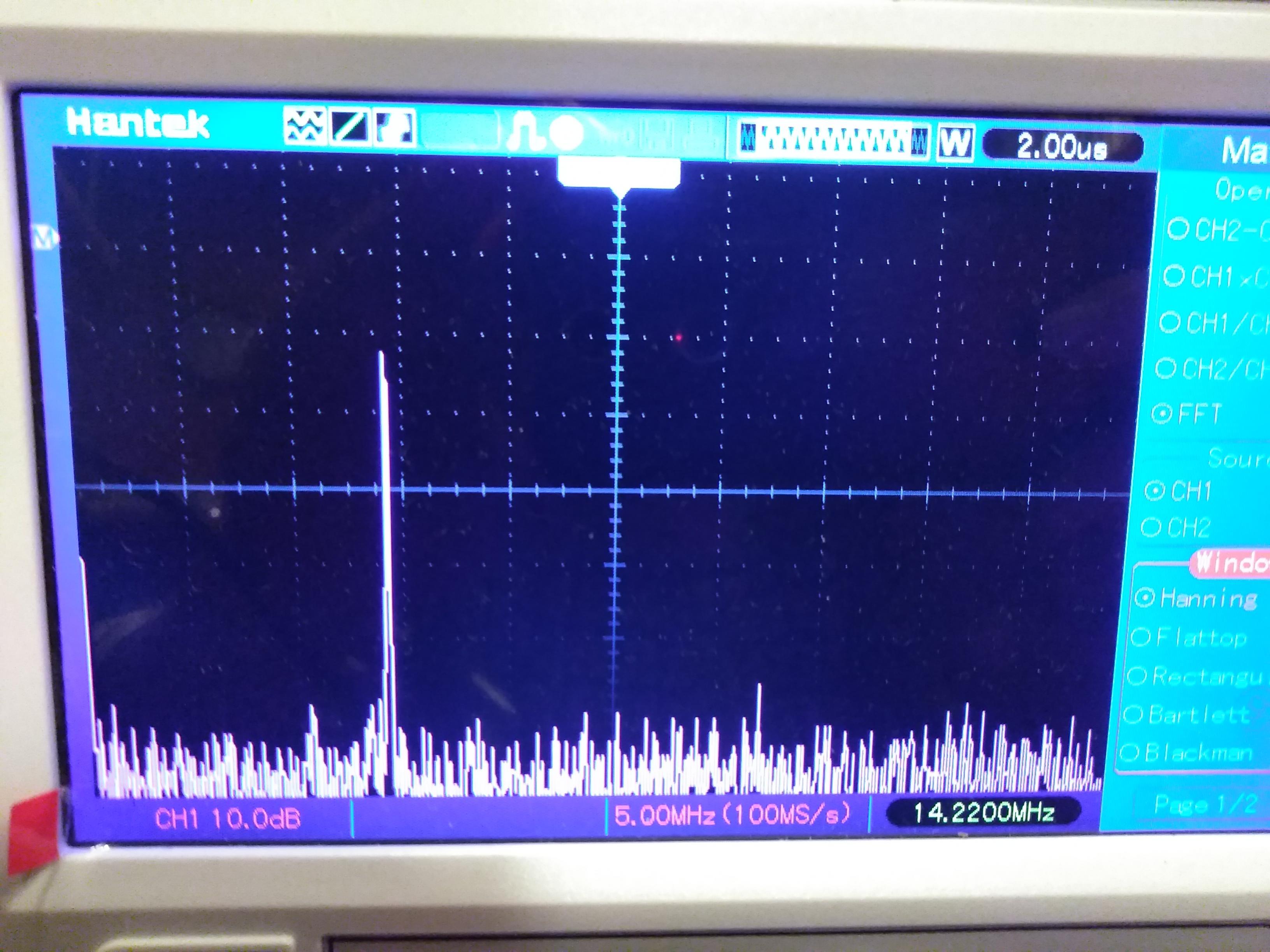

Getting better.
The 9 MHz IF is 34 dB down. The tunable LO is all but banished. The sum product is 28 dB down.
Need to take a little capacitance off the tuned circuit. This is with the FeelTech as a signal generator.

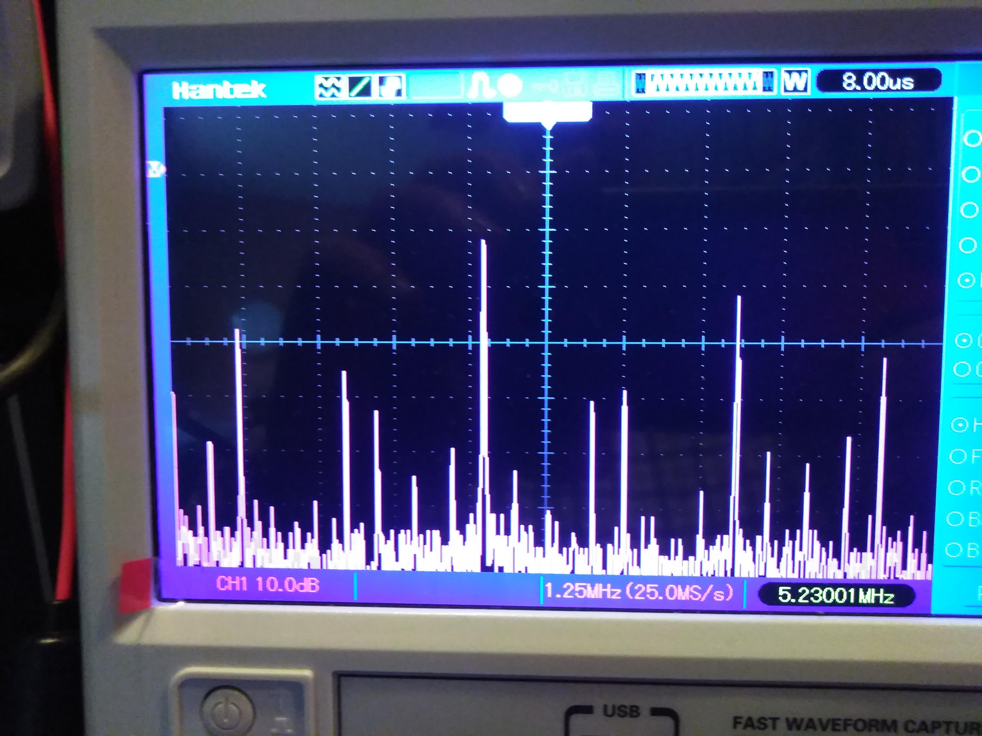

This is with the Si5351 spur maker.
No balance or bandpass filtering on the output - just raw single ended output through a .01 cap at pin 4. 100 mv on the RF port to simulate the SG-9; 250 mv on the tunable LO port. 7 volts on the SA612.
The small spike out at 39 MHz is the sum of that really undesirable spur that would have been too close in to the 14 MHz output and the tunable LO. I think, the arithmetic looks right ...

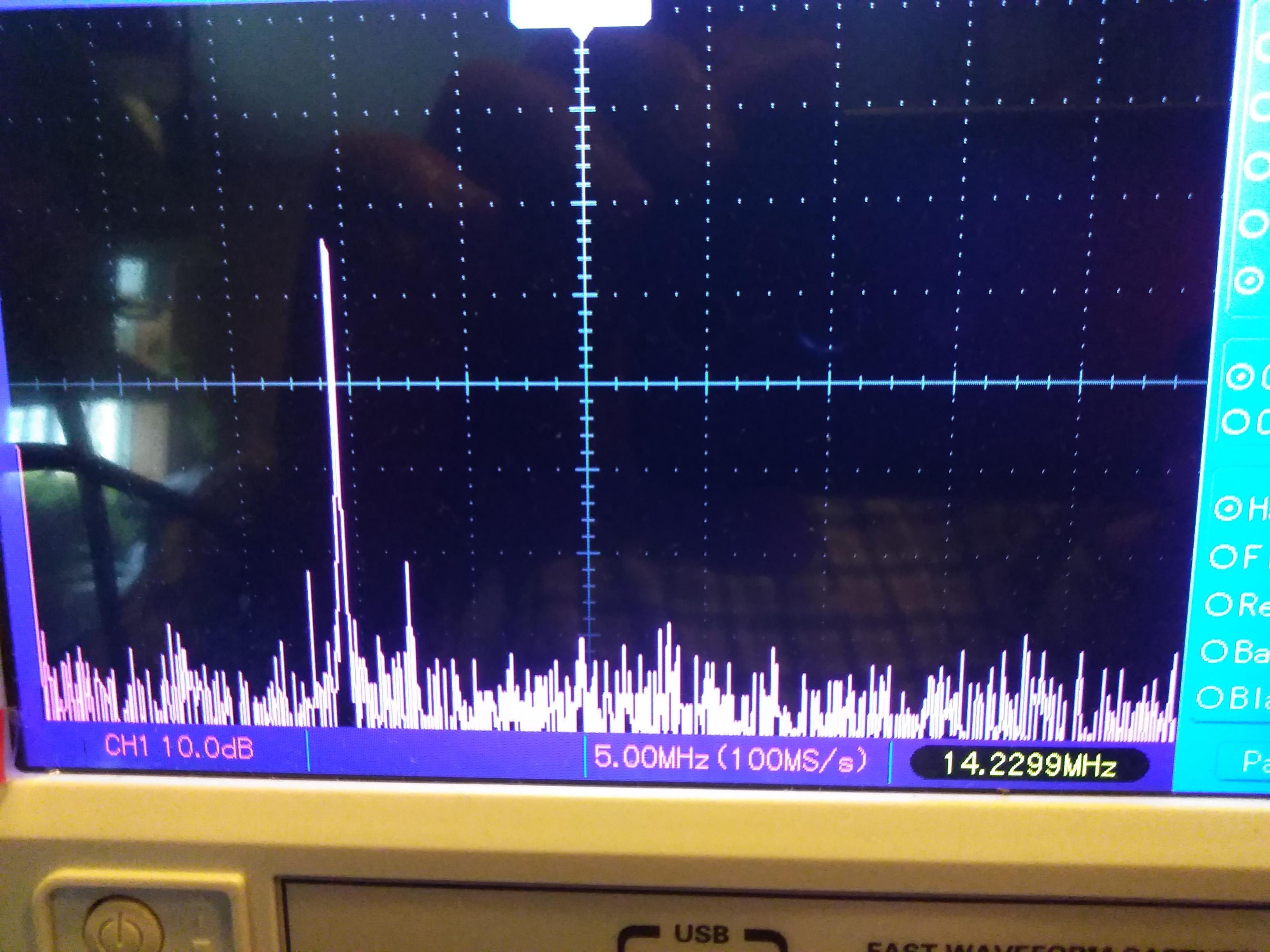

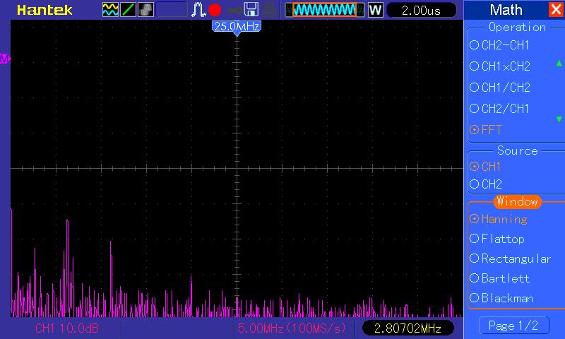

Here is a bit of an odd result.

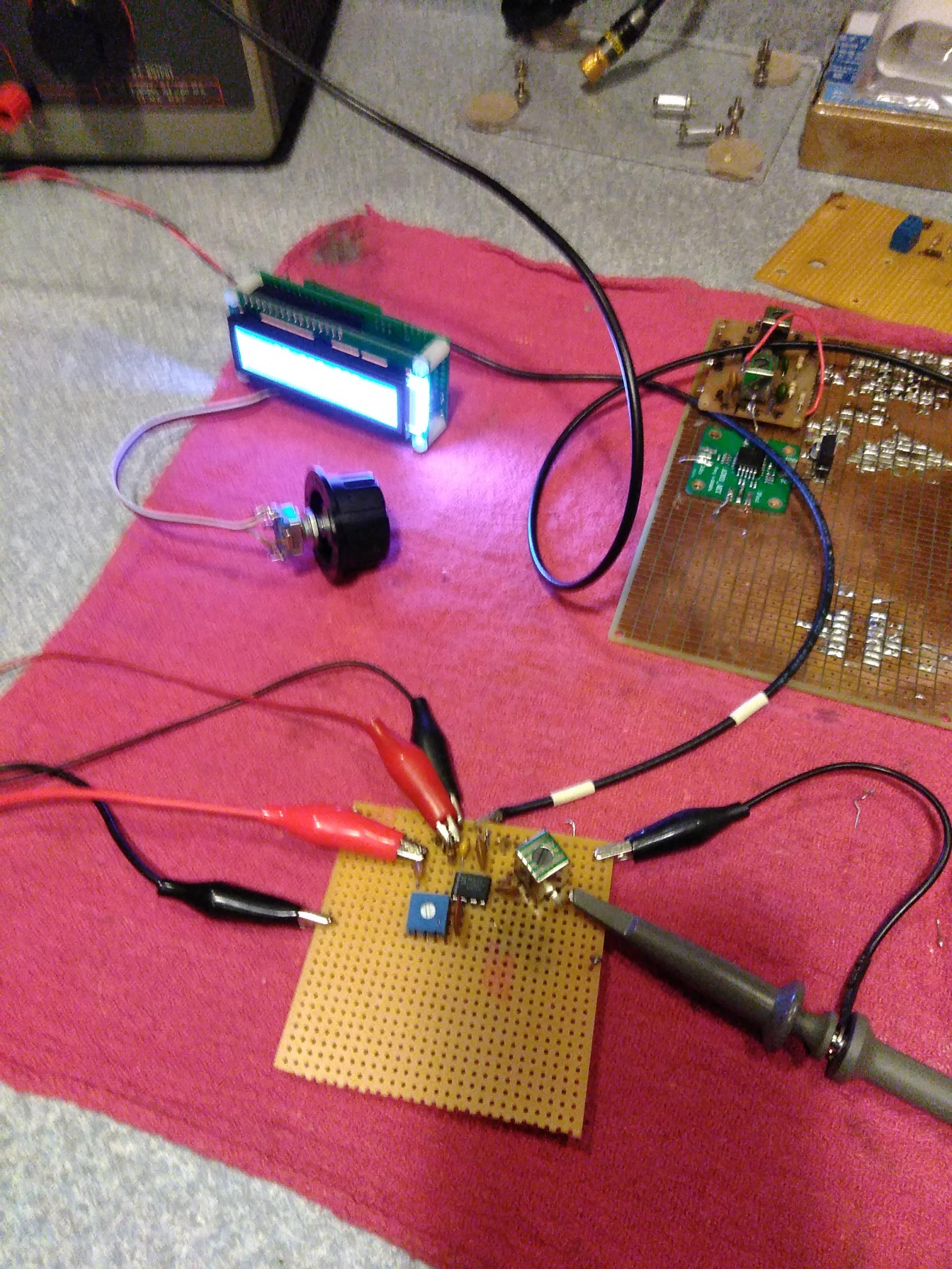

Si5351 / SA612, same operating points as before, except the load is a surplus 1000 micro henry slug tuned, shielded coil, The intent was to tie the two output pins together for balance, and create a balanced broadband output of sorts, and take the output from the secondary of the transformer.
The coil has pins for a secondary, but in fact, as I learned by accident, they are just there for mounting purposes - there is no secondary ...
First pic is the scope lead attached to pin 4 of the SA602 - no coupling cap.
Second pic - wait for it - is an accidental short of the can to the output pin 4 of the SA612, creating, I guess, some kind of low value gimmick capacitor between the can and the unconnected output pin that the scope probe was attached to, making an 18 dB, across the board, attenuator.
Which makes for a pretty decent looking output ... except it doesn't balance out the 9 MHz input ...

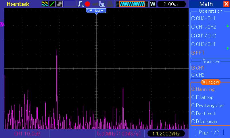

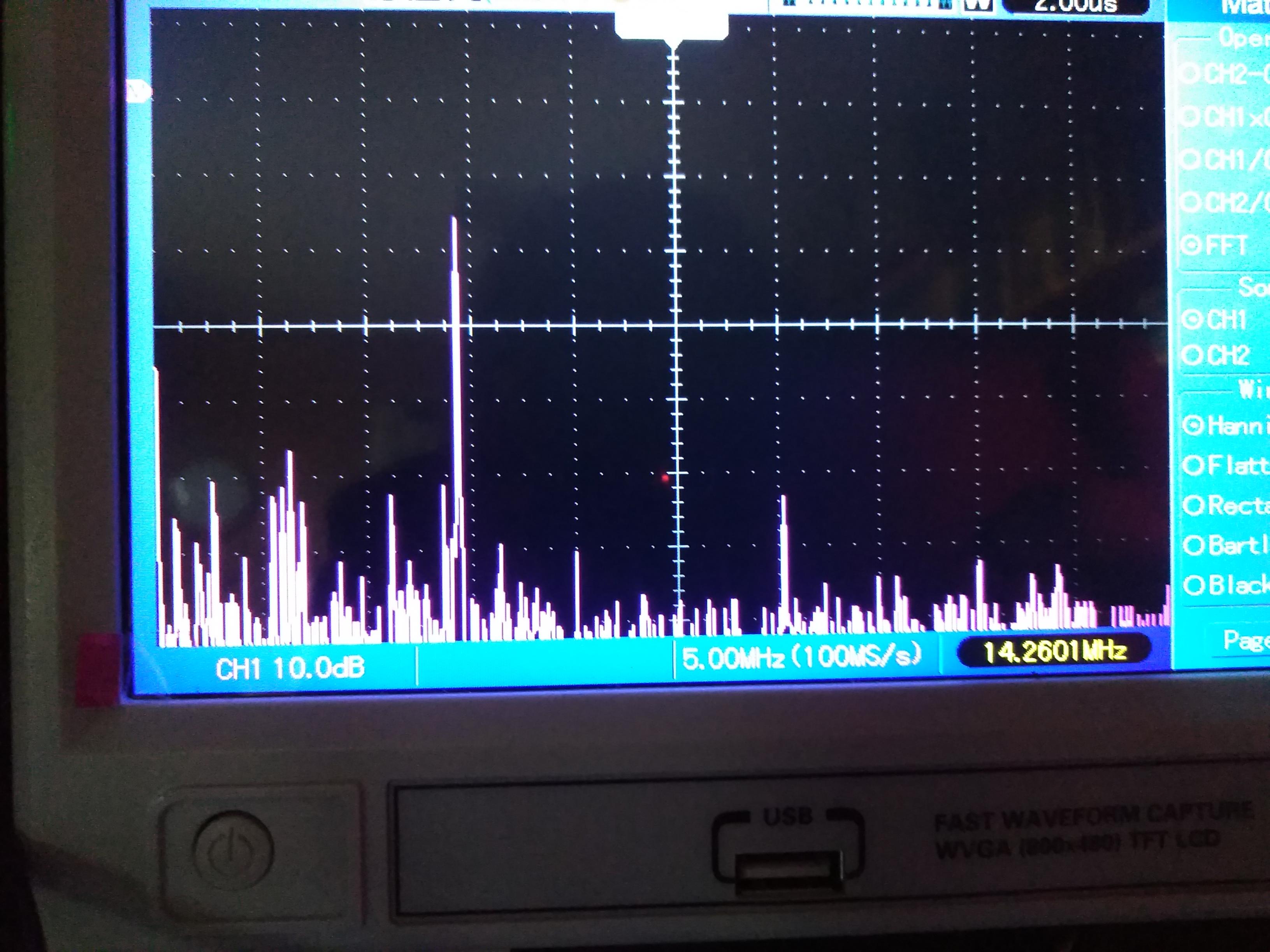

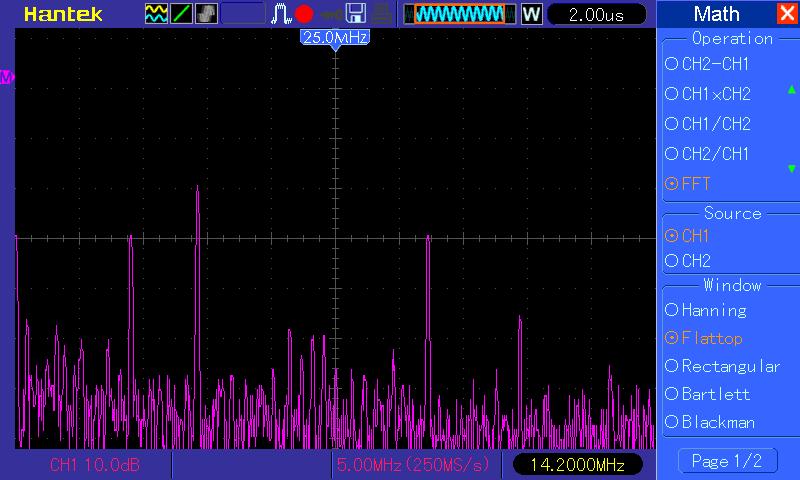

This is the current Si5351 / SA612 combination - the LO and the spurs from the Si5351 are down in the FFT noise. The 9 MHz IF is either down in the noise, or a few dB above it - hard to tell.
The output from the SA612 is being taken single ended to a single tuned circuit; the scope probe is on the secondary of the transformer. The accidental creation of the gimmick output suggested that much lighter coupling out of the SA612 could be beneficial, and, in these grabs, a 100 pf disk isolates the tuned circuit from the mixer output. Previously I had been using .01 uF. Lighter coupling might yield additional improvement.
I had thought about using MC1496, but this result with SA612 is better than I expected, dirt simple, looks to be adequate to my untrained eye, and, given the way this has dragged on, and the now obsolete status of MC1496, I don't think I'm going to play with it.
I think there is still some additional benefit to be had from a second tuned circuit on the output, so may play around some with that, then play around with that cheap linear amp, to see if it is really linear, and if I need any additional drive for it.
As always, comments, criticisms, and suggestions on how to proceed are welcomed.

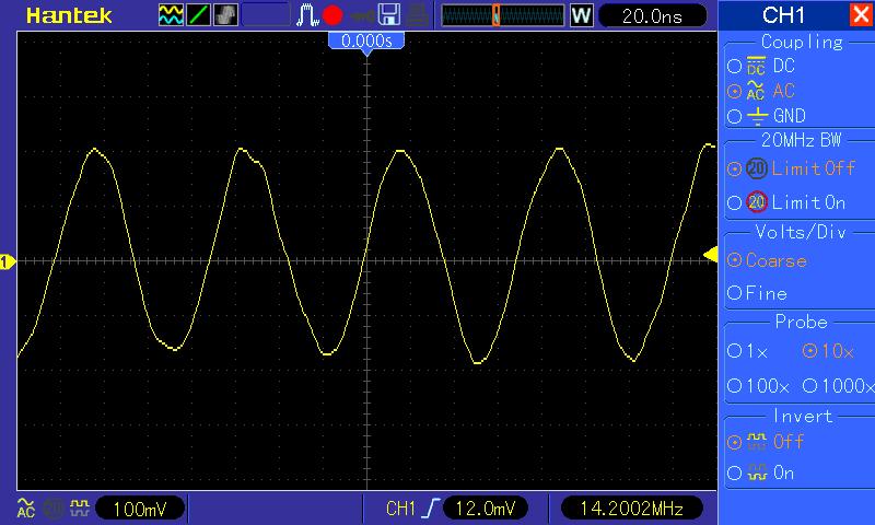

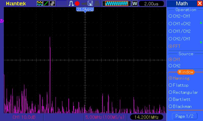

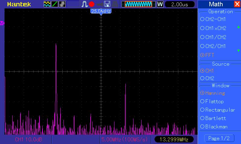

Si5351 / SA612 tx mixer output; double tuned bandpass, top coupled, stagger tuned to +- 1 dB across the phone band.
The junk around 5-7 MHz is, I think, phantom FFT artifacts.The signal around 32 MHz is the IF plus the LO. The signal around 11 MHZ, if real, is a mix product with one of the spurs, I think.

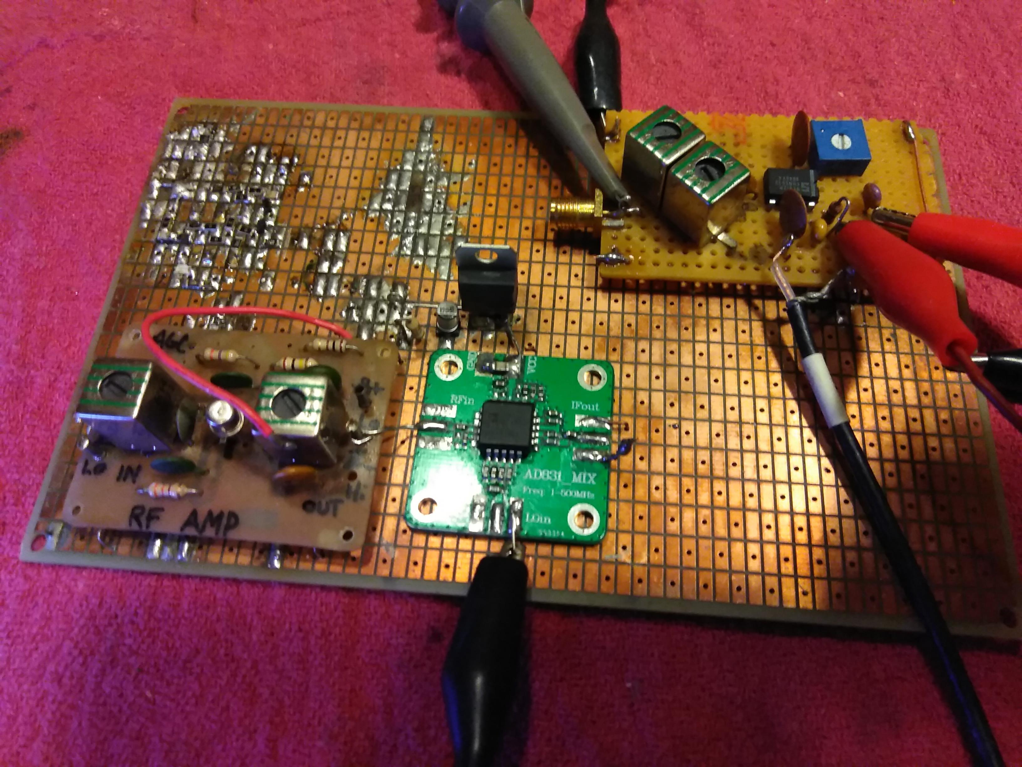

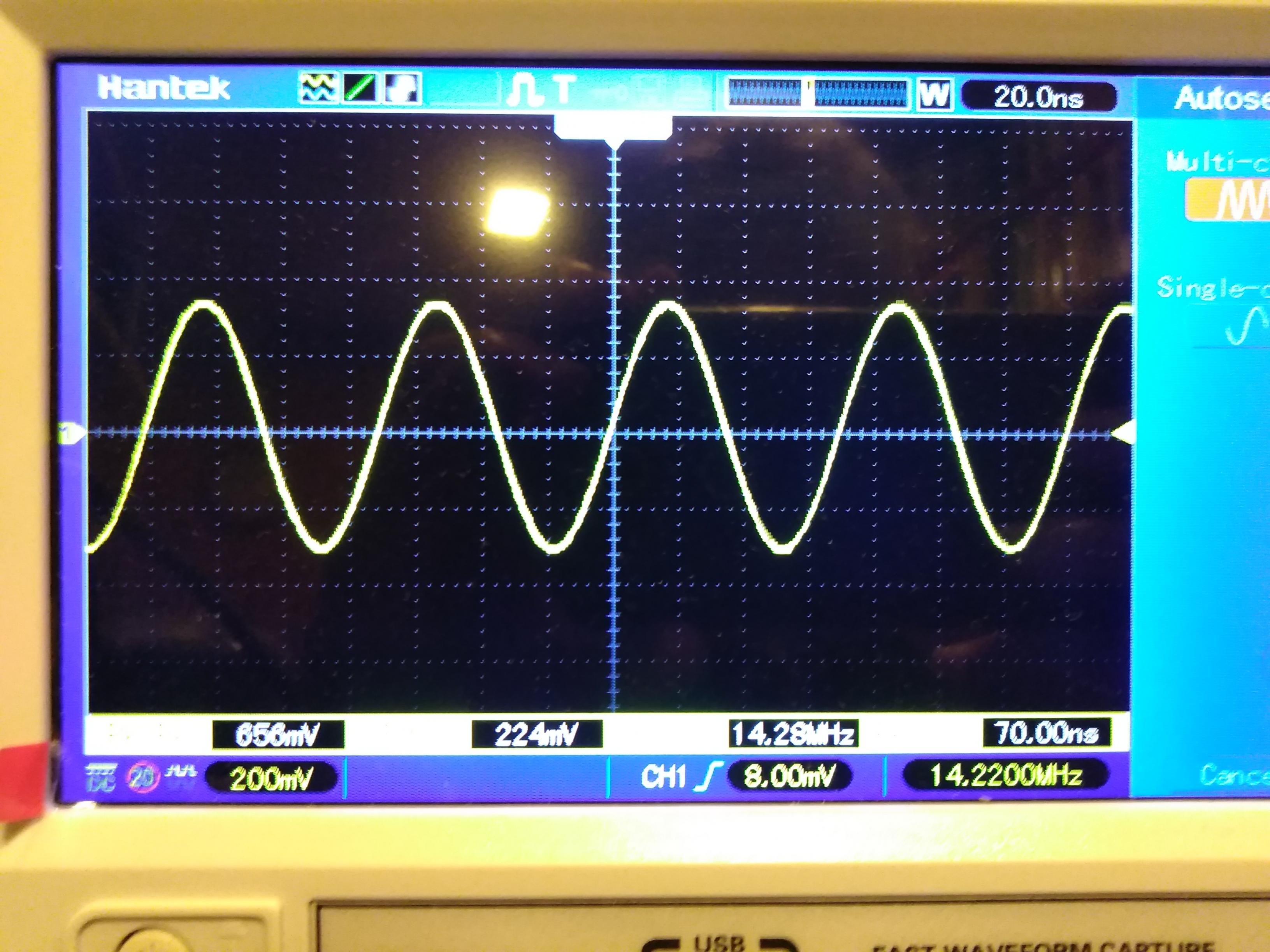

Starting to see a light at the end of the long tunnel.
A few more tweaks and putting the TX mixer over a proper ground plane cleaned it up considerably. It is now at the limits of my mediocre test equipment. It is much better than I expected to get, considering how nasty the Si5351 looks straight out of the chip, and considering that the TX mixer is really an RX mixer. This should be a clean sounding transmitter if it works in the real world like it does on the bench ...
I added an SMA connector to the mixer board output, to make building out the rest of the TX strip more convenient.
I am going to do up all the switching, case it, and start real world testing of the prototype. Not sure about the linear yet, but I still have quite some work to do before that is an issue.
If this works in the real world, and when I get there, now that I (sort of) know what I am doing and what works, a 6 meter transverter will follow, and should be easy ...
Then maybe a new IF board better suited to an up converting front end.

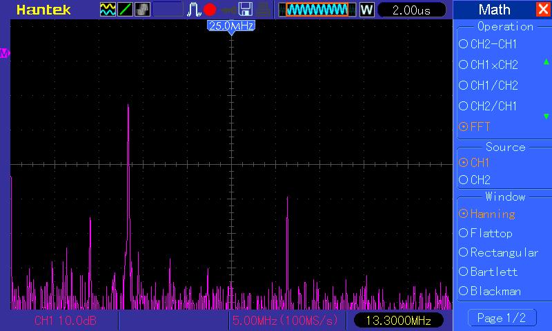

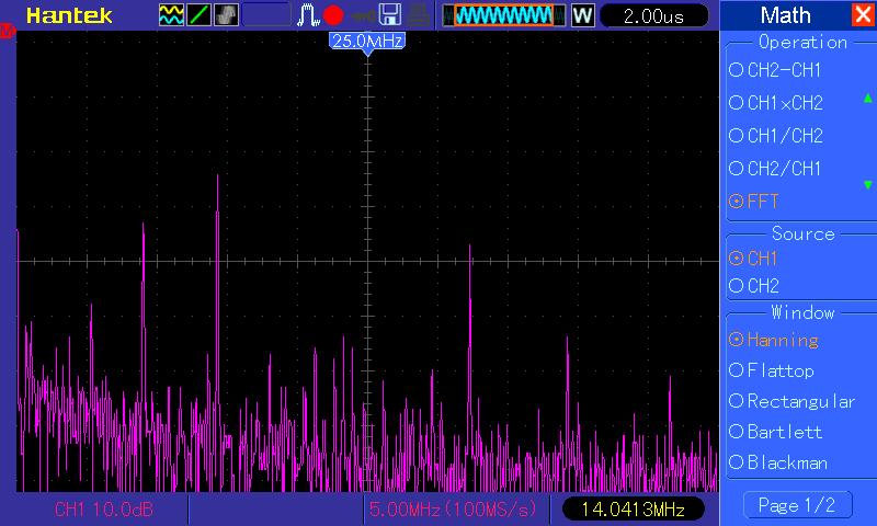

Yes, the SA602/612 looks to be getting the job done here, with a really simple, ham DIY friendly circuit.
Just out of need to know, I flipped the LO around to use a 5 MHz low side injection to get to 14 MHz, and attached pics of the LO input to the mixer, and the spectrum at the output of the bandpass filter. Sorry, I left the jump drive at the office so cheap cell phone pics are all I have.
The 5.23 MHz LO FFT is centered at 6.26 MHz, the output FFT is at 25 MHz ish.
I did not rebalance the mixer, so some improvement is likely possible. Regardless, even though low side injection is clearly not as good as high side injection, the output still looks usable - the two close in spurs are almost 40 dB down.

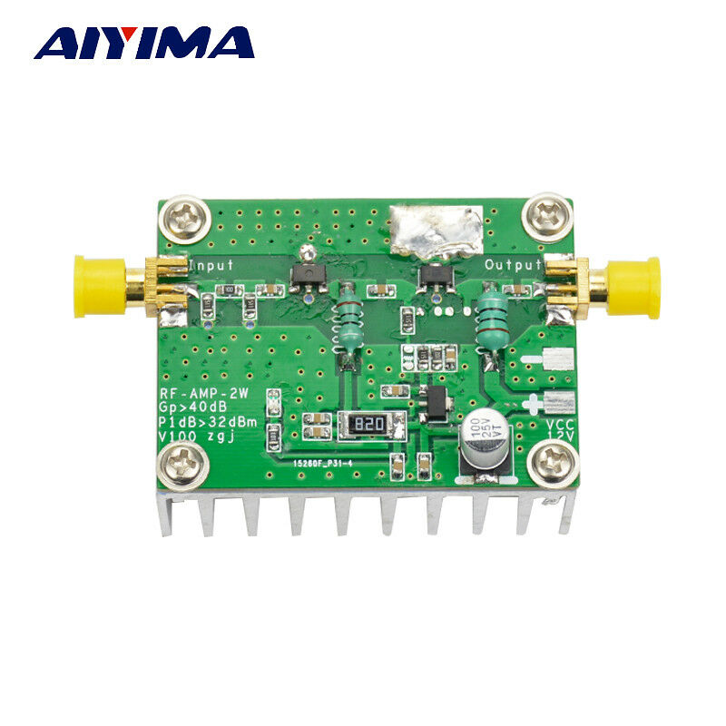

Is this a linear amp?
This is a picture of the RF output board, from the eBay listing. The part I received is identical. It is described as an "Amplifier Type: A class of linear amplification" and linear is used more than once in the ad copy.
eBay ads can be somewhat fast and loose with the truth, which I have no problem with for cheap stuff, but I'm wondering if this is one of those instances, or if there is something I don't understand.
I don't see any bias to the first transistor, so it seems to me that can only be class C operation? On the board I received, I cannot make out any part numbers on the transistors. I thought that would be handy to know when I blow them up playing with it. ( edit: could it be a chip with an internal bias network? Do such parts exist? ) The other three terminal part is a 78L05.
What looks like a pi attenuator on the input, is not wired as such on mine. It has two 51 ohm resistors to ground with a zero ohm resistor in between, so this seems like a 25 ohm input?
I think it likely I will actually need to substitute the correct parts for an attenuator if I use both stages; I'm wondering now if I should just remove the input transistor and replace it with a zero ohm jumper, and just use that last stage, which does look like it could be class A. I have about 0.6 volts p-p coming out of the mixer.
yes, there are hundreds of different kinds and the SOT 89 package is quite common for them.
The devices are probably not simple transistors. They are most likely 50 ohm gain blocks and are probably not identical. The first one is probably internally biased and probably provides most of the gain while the second handles the power and probably has somewhere near 10 db of gain.
Any numbers / symbols at all on the parts?
Well it can't be class C, with RF that works only over a narrow band of frequencies and needs a tuned circuit.
Perhaps there are other layers on the PCB with connections we can't see...
Why not apply 12v and measure the voltages on the transistors to see?
Even more radical: "stuff" some RF in and see what happens.
