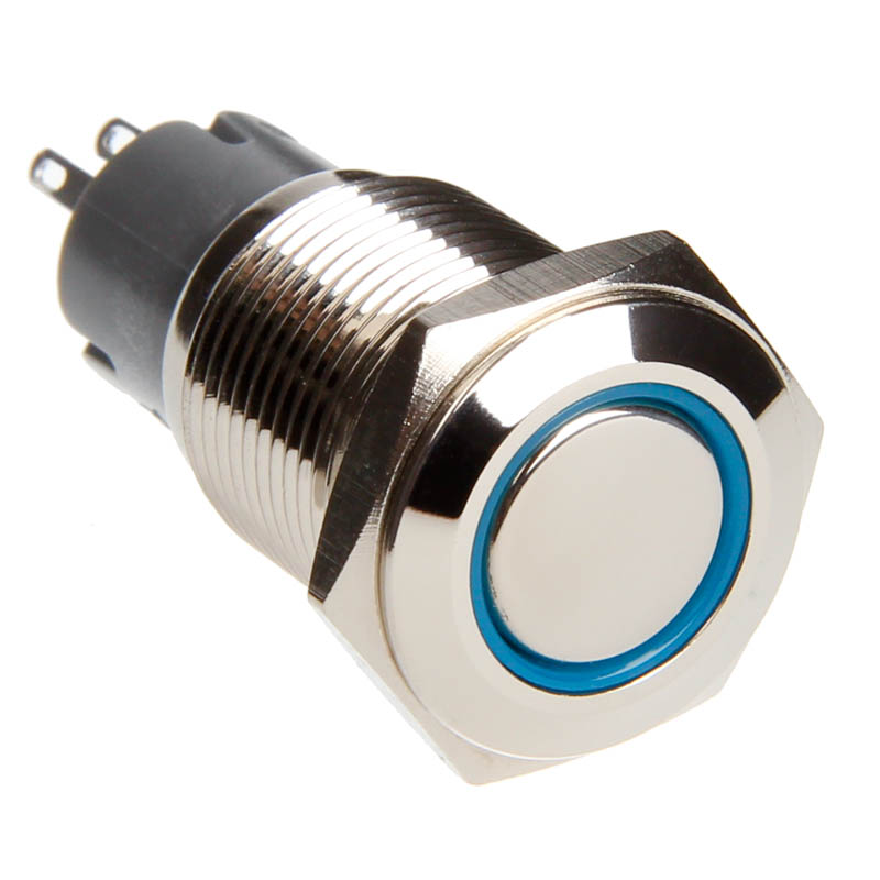

I use this.
I think that the led inside is for 12v.(led+resistor).
When first time testing,i used a discrete led.
I will try again with the discrete.
Mistery solved!
There are 3 different situations.
OFF=the lowest luminosity.
ON at delay time=a little brighter.
Delay time passed=full luminosity.😉
In my previus test i haven't the rails connected so system don't passed to real ON.(FLASHING LED).

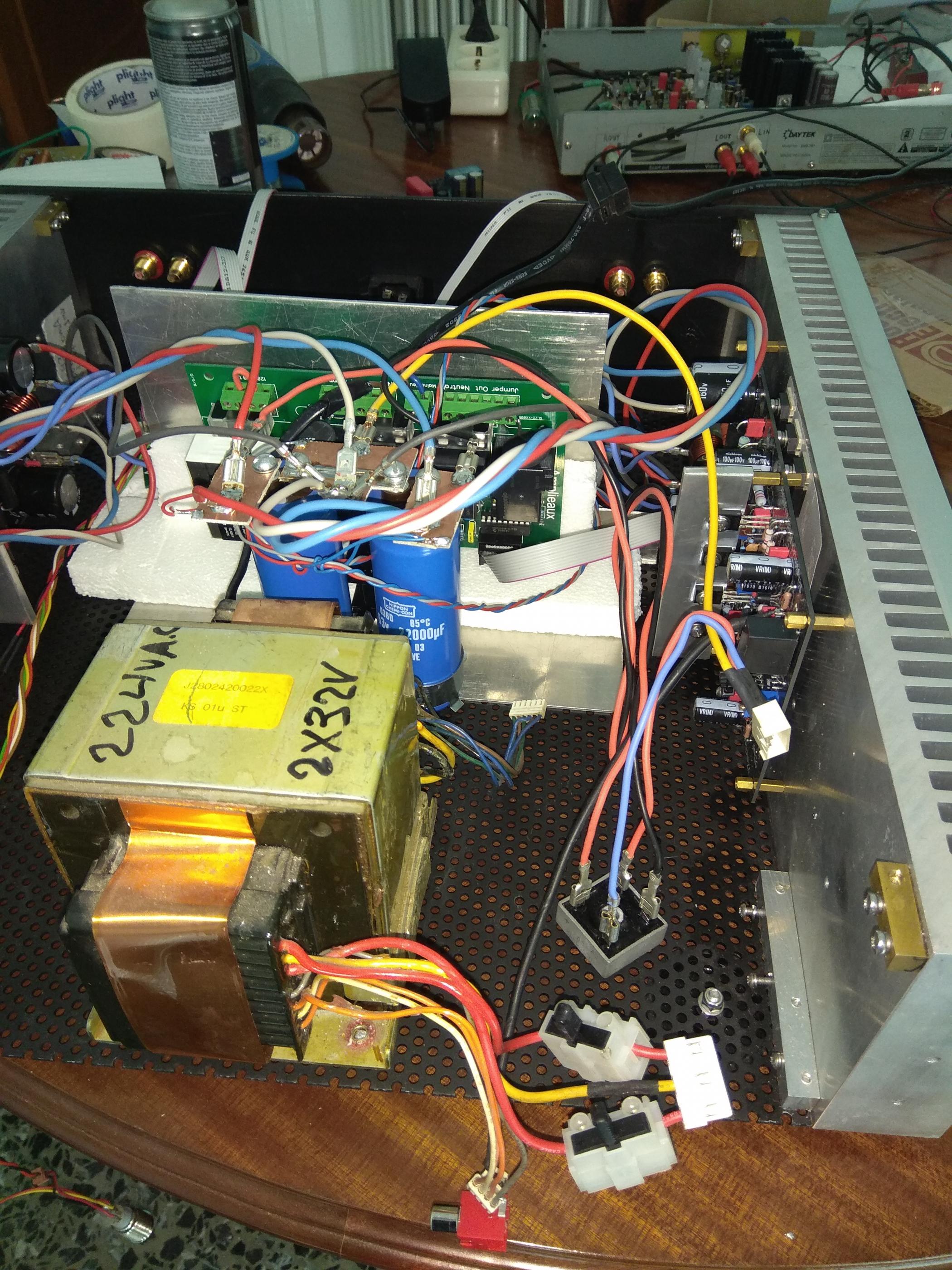

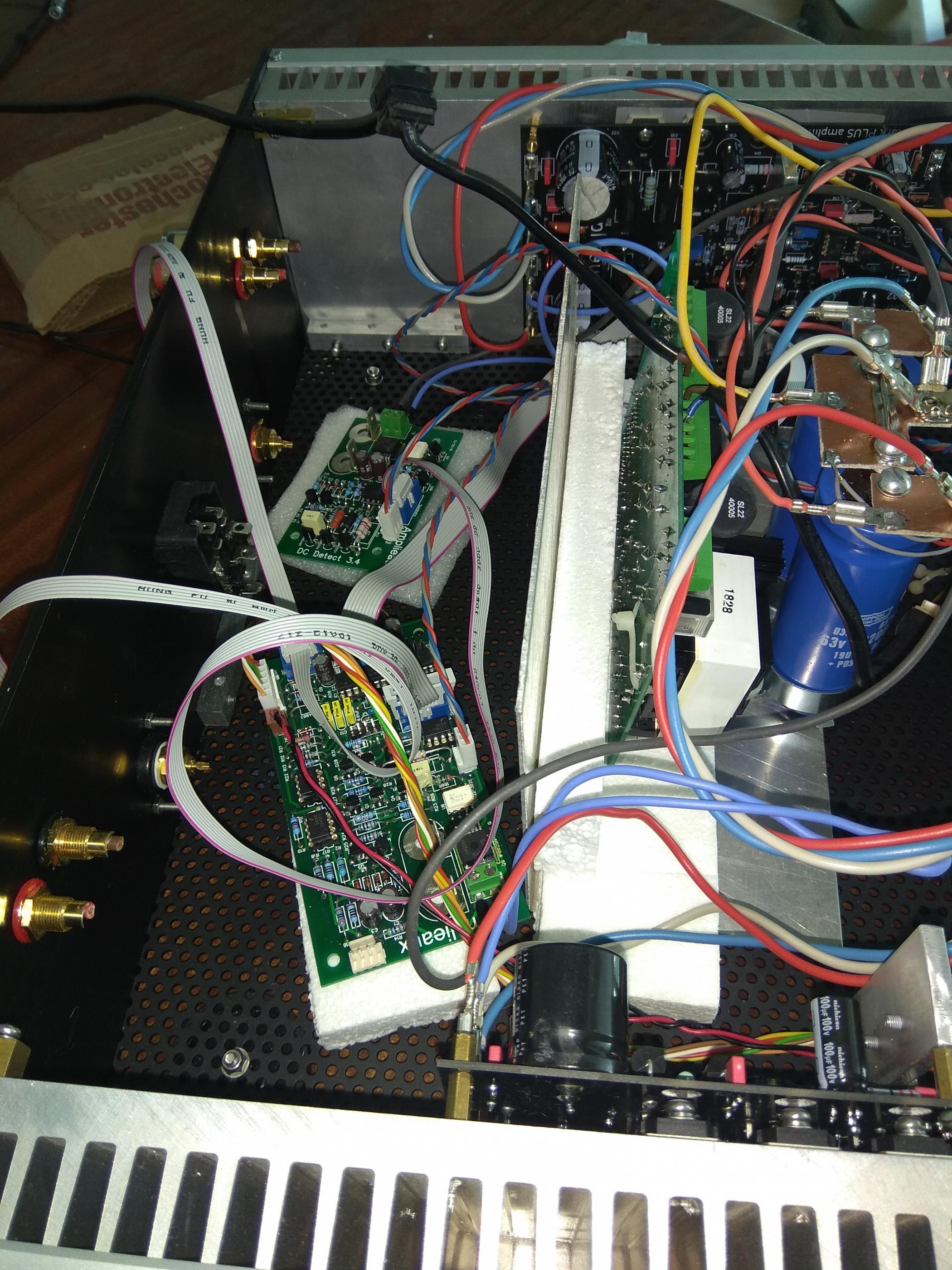

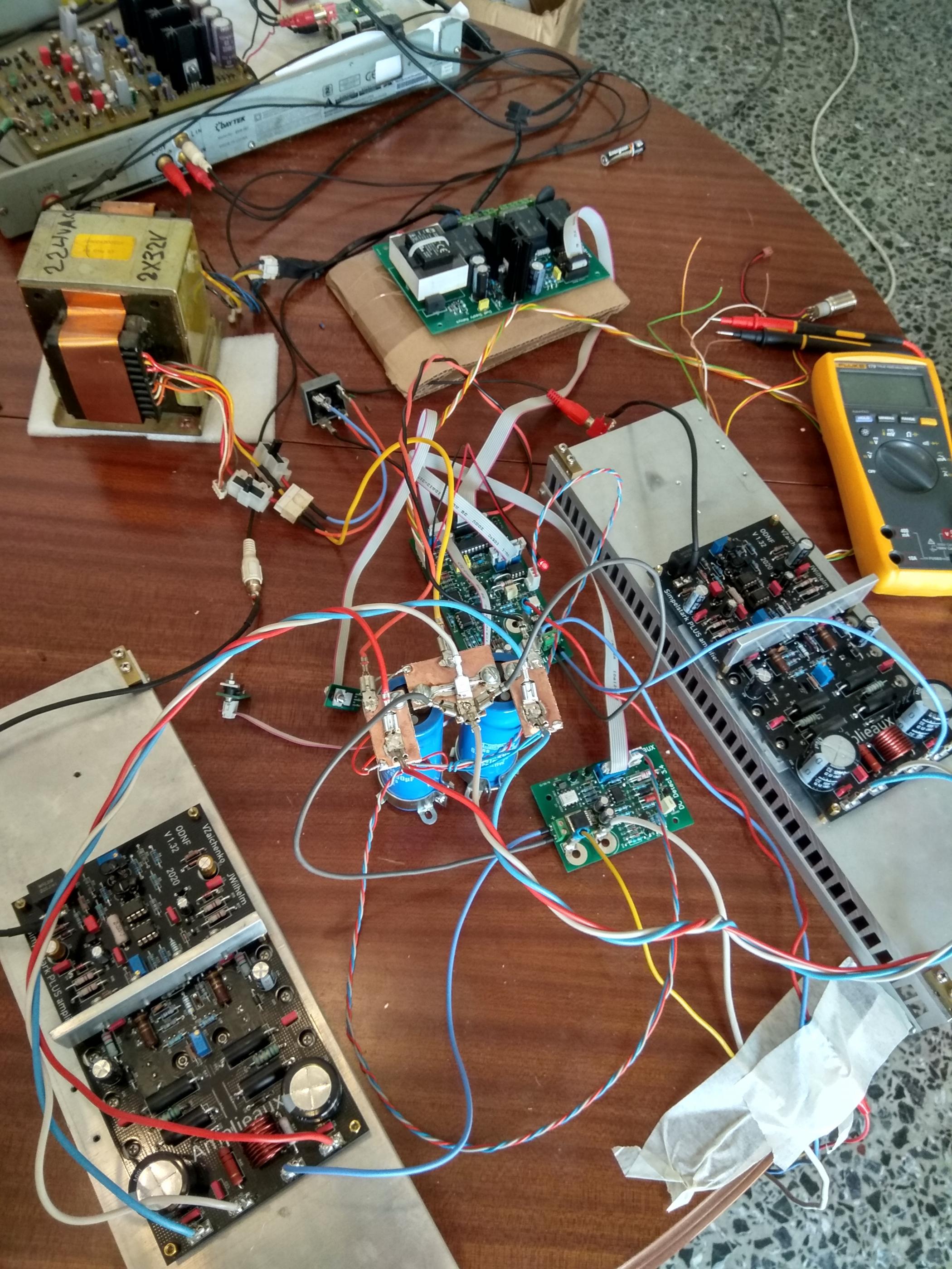

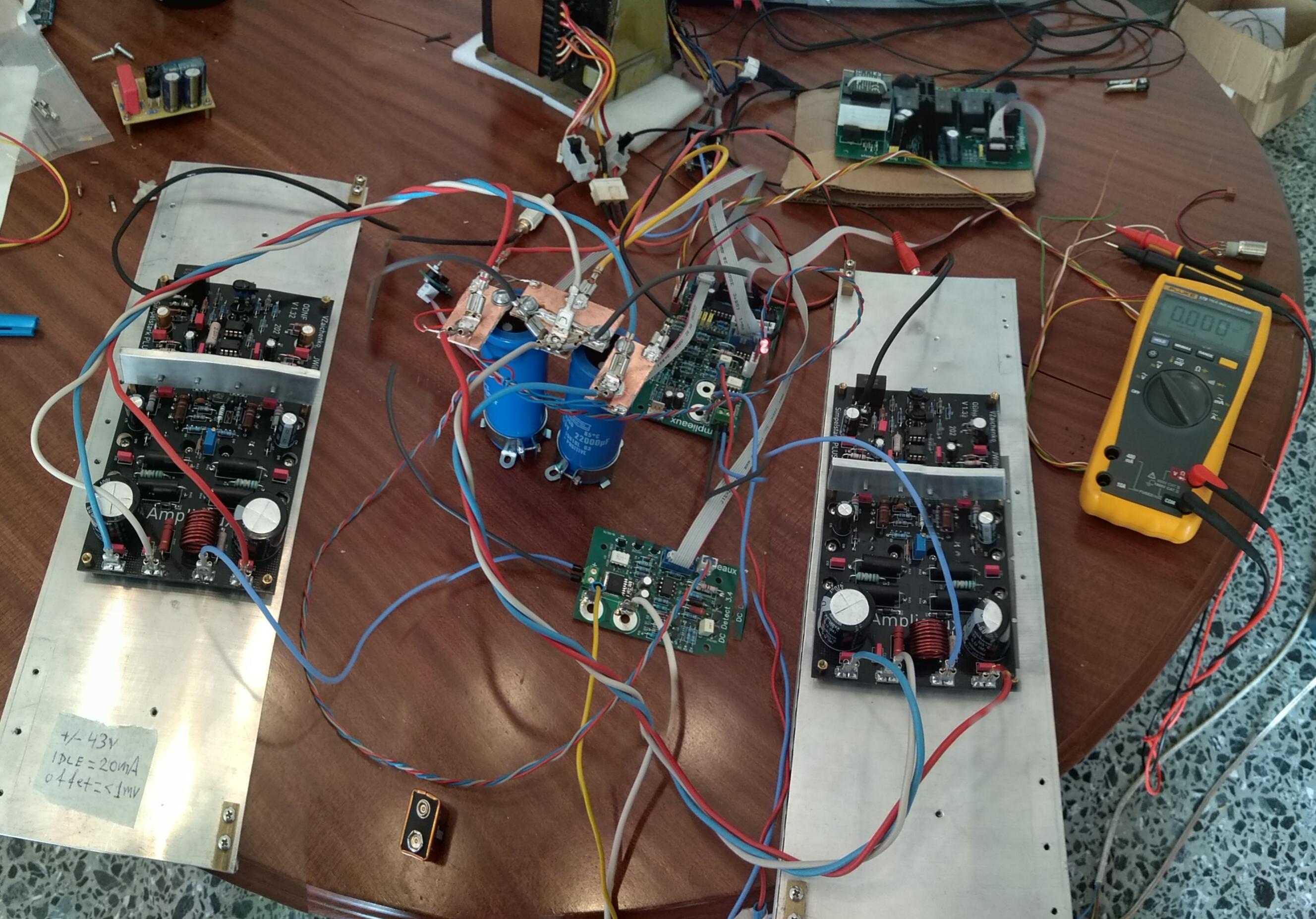

Here is the full setup.:drink:
