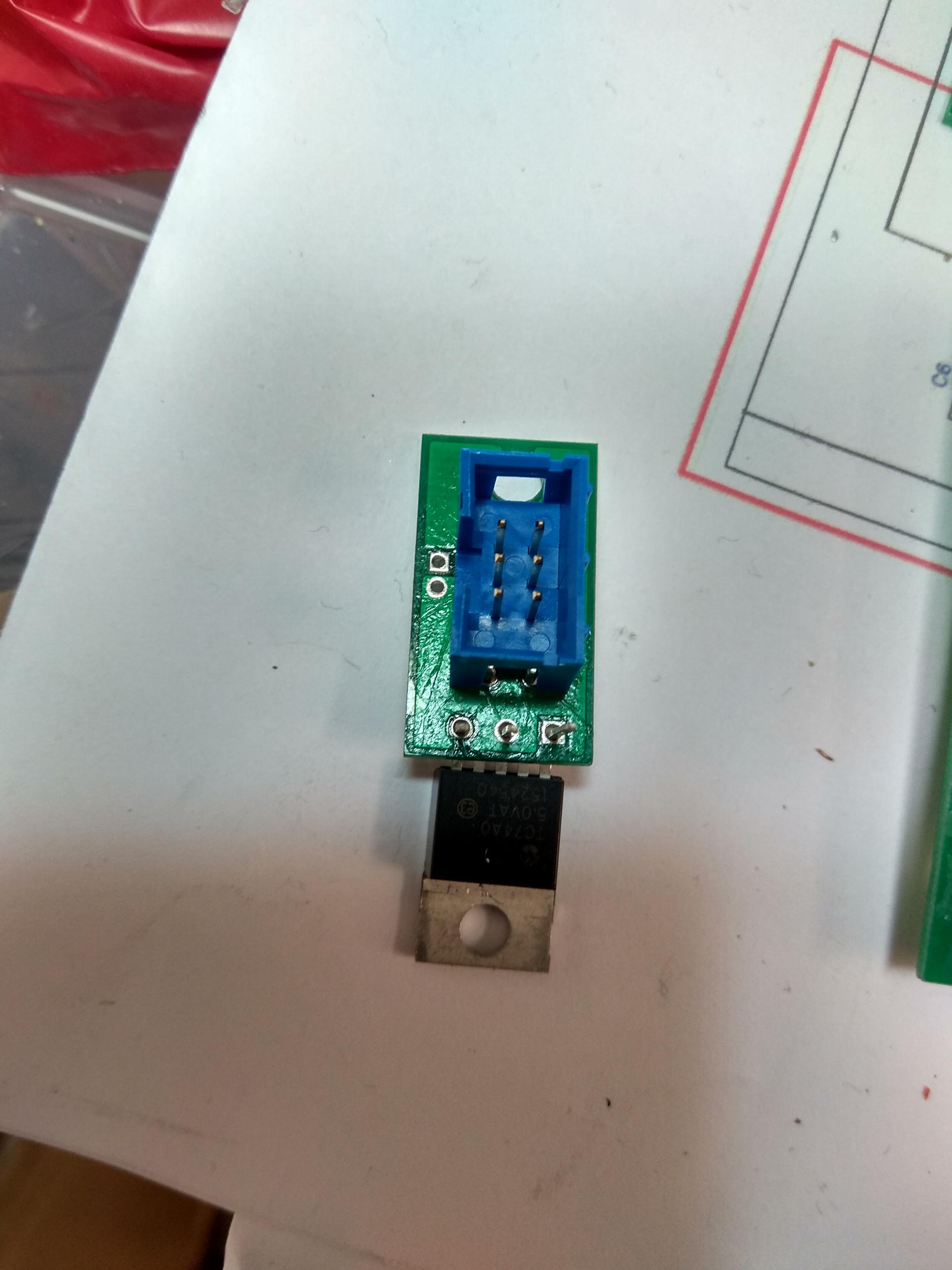

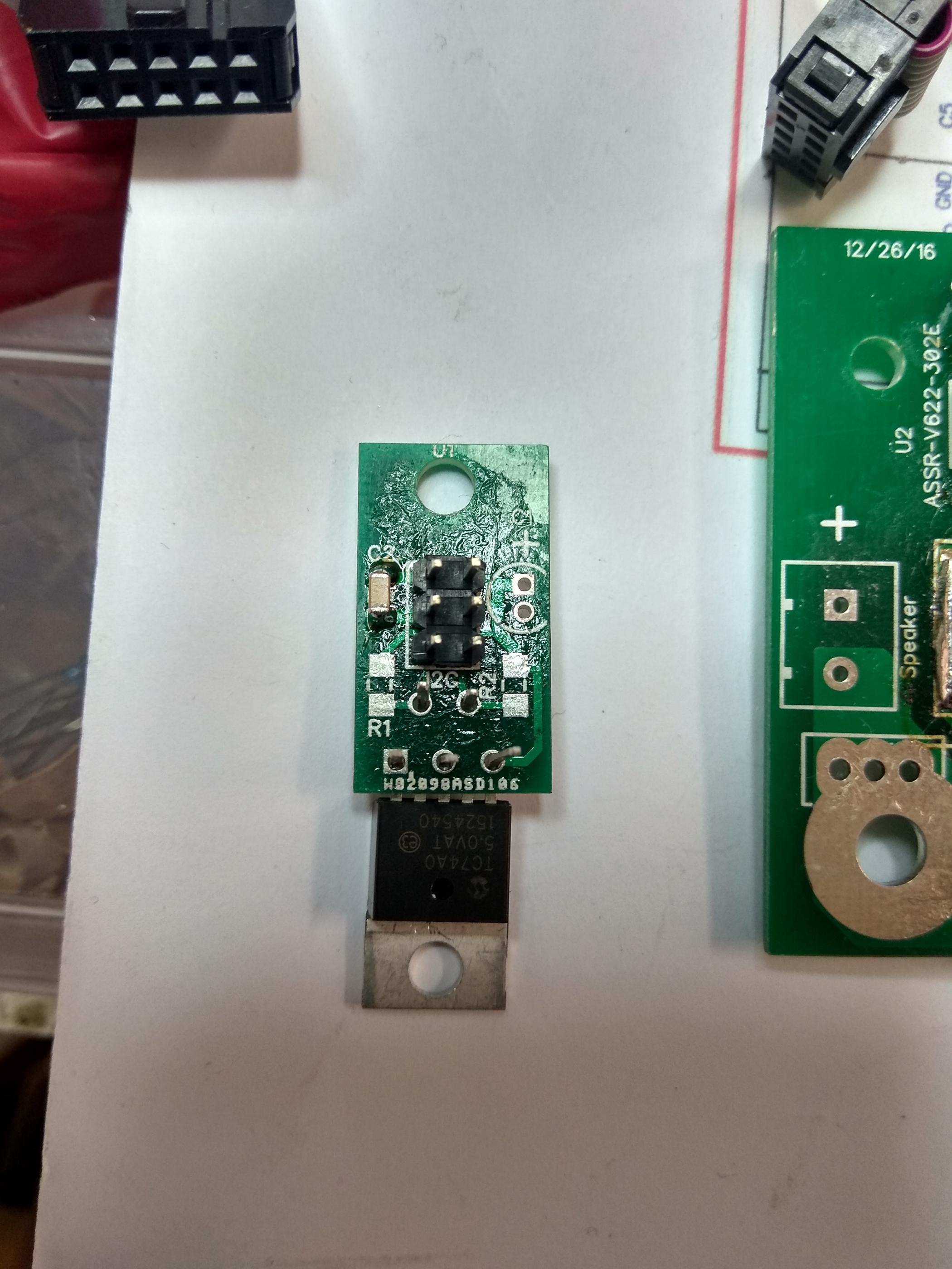

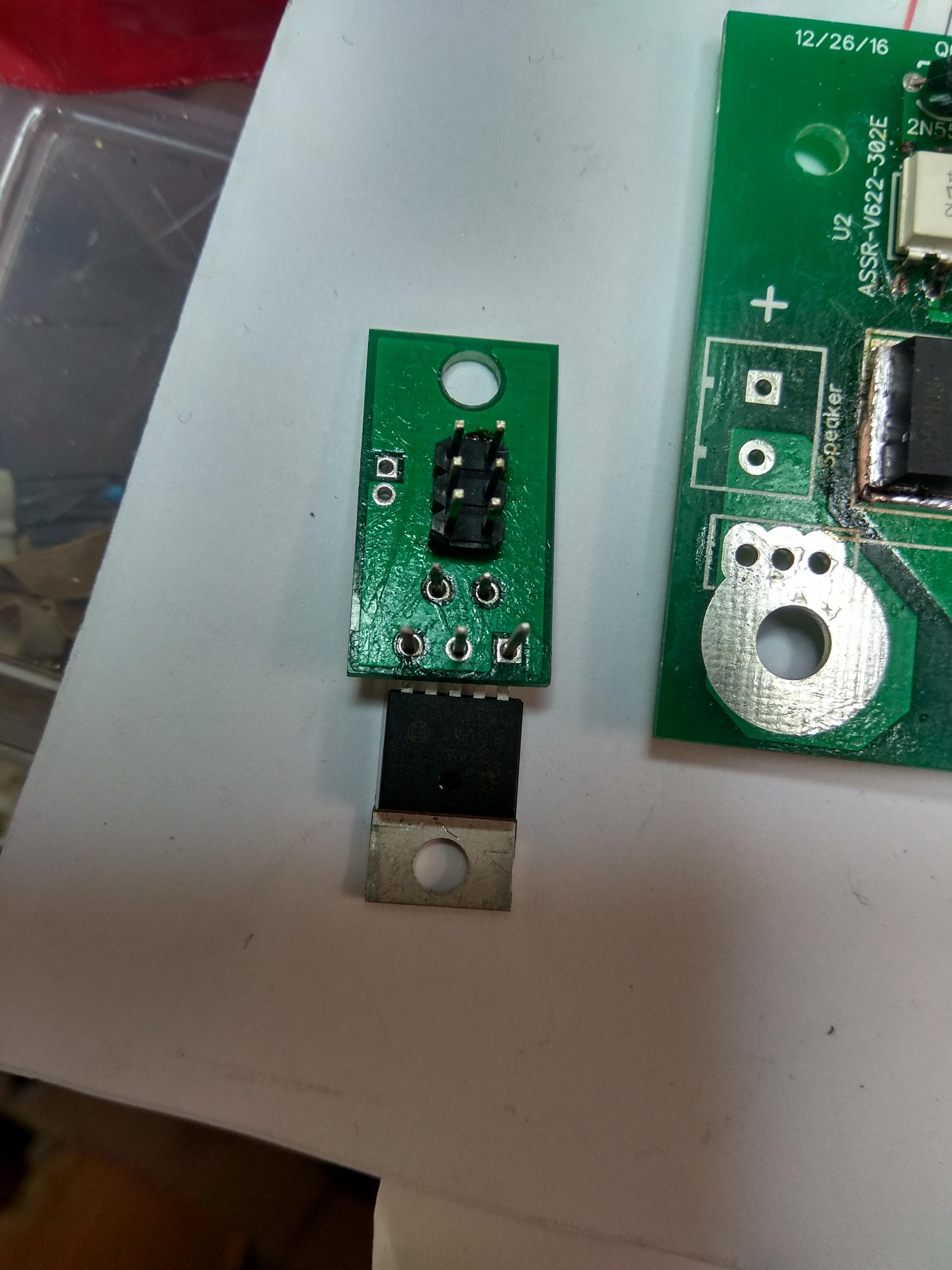

No, according to TC74AO pdf data, this will be the right way.

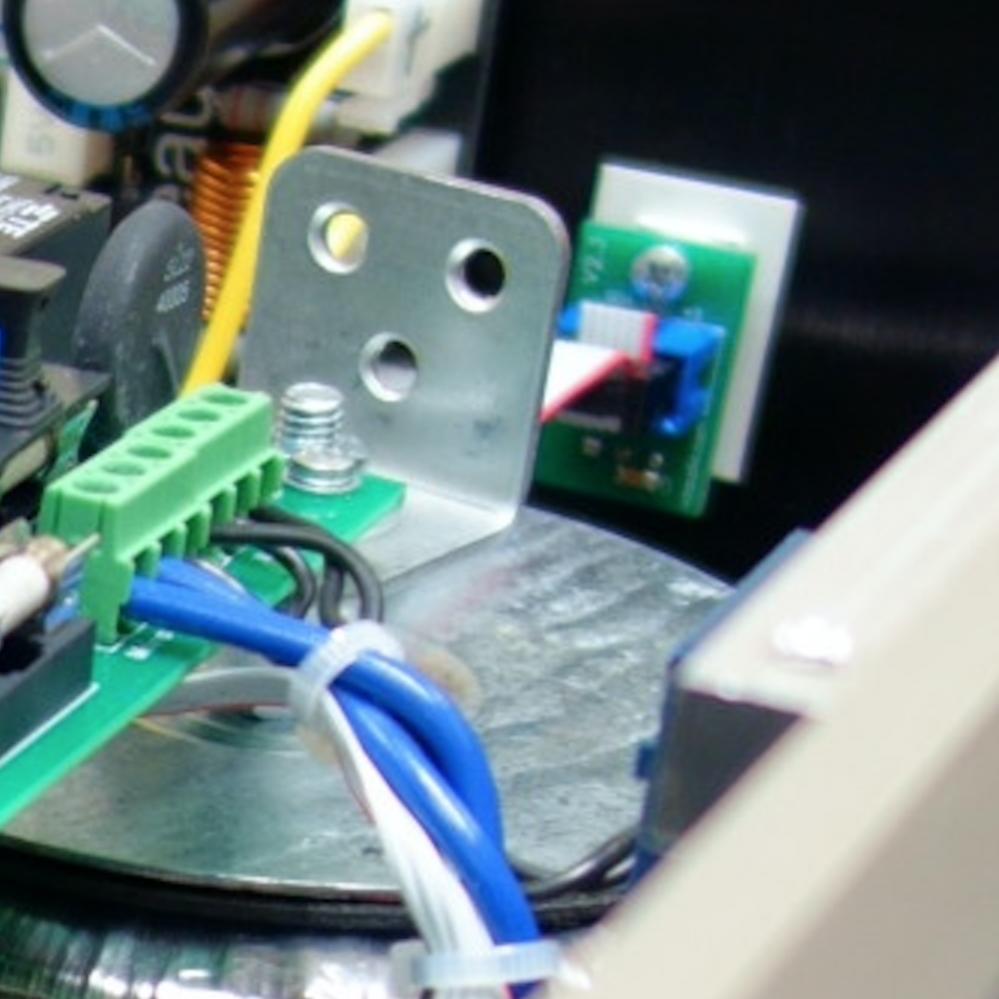

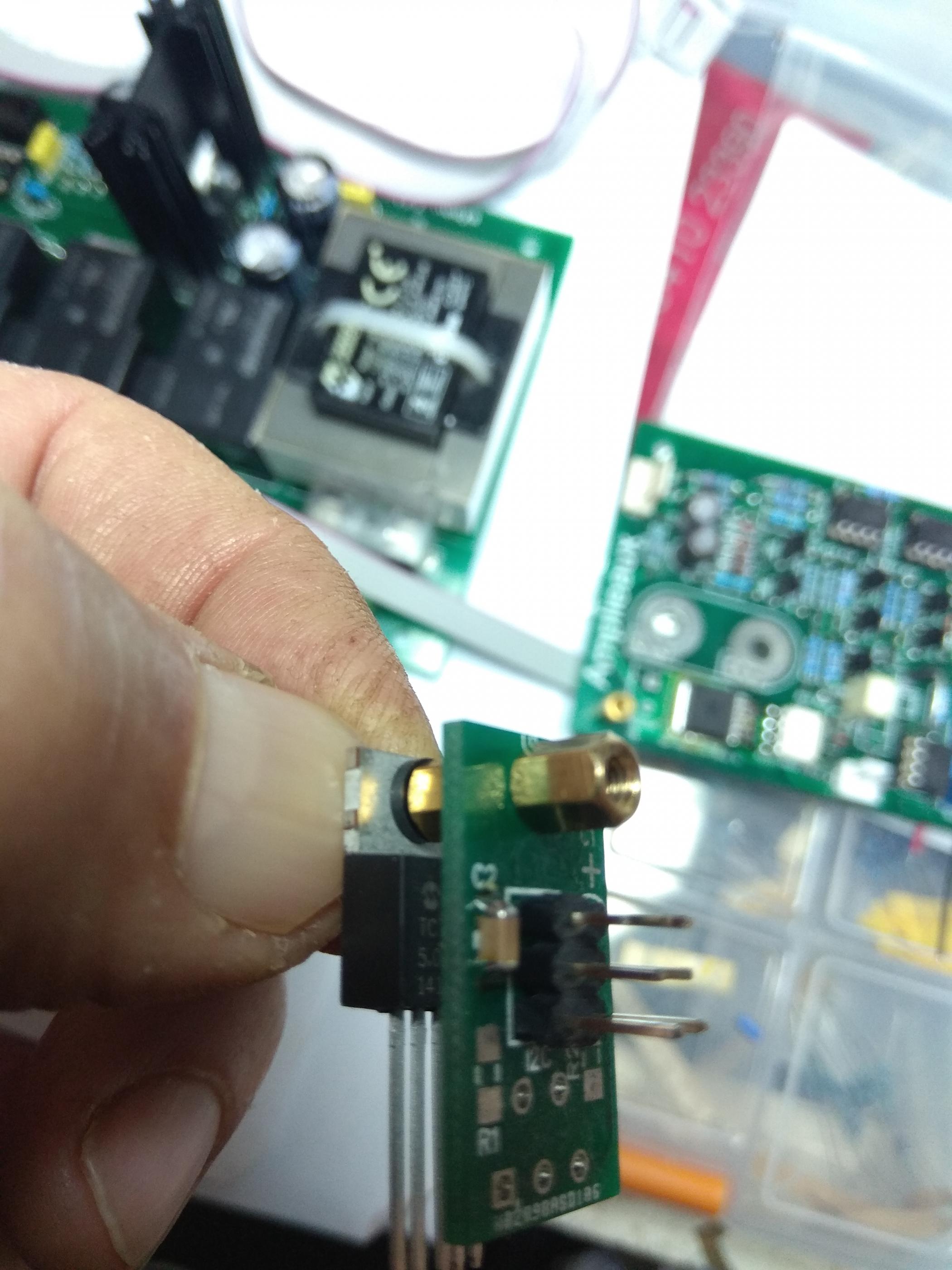

Hi Thimios,
Your version of the temp sensor is a bit different from the one I used, but as far as I remember, in all the versions the sensor part is placed under the board, so that the screw goes through both of them (a plastic spacer is used in between).
See the fragment of my build.
Valery

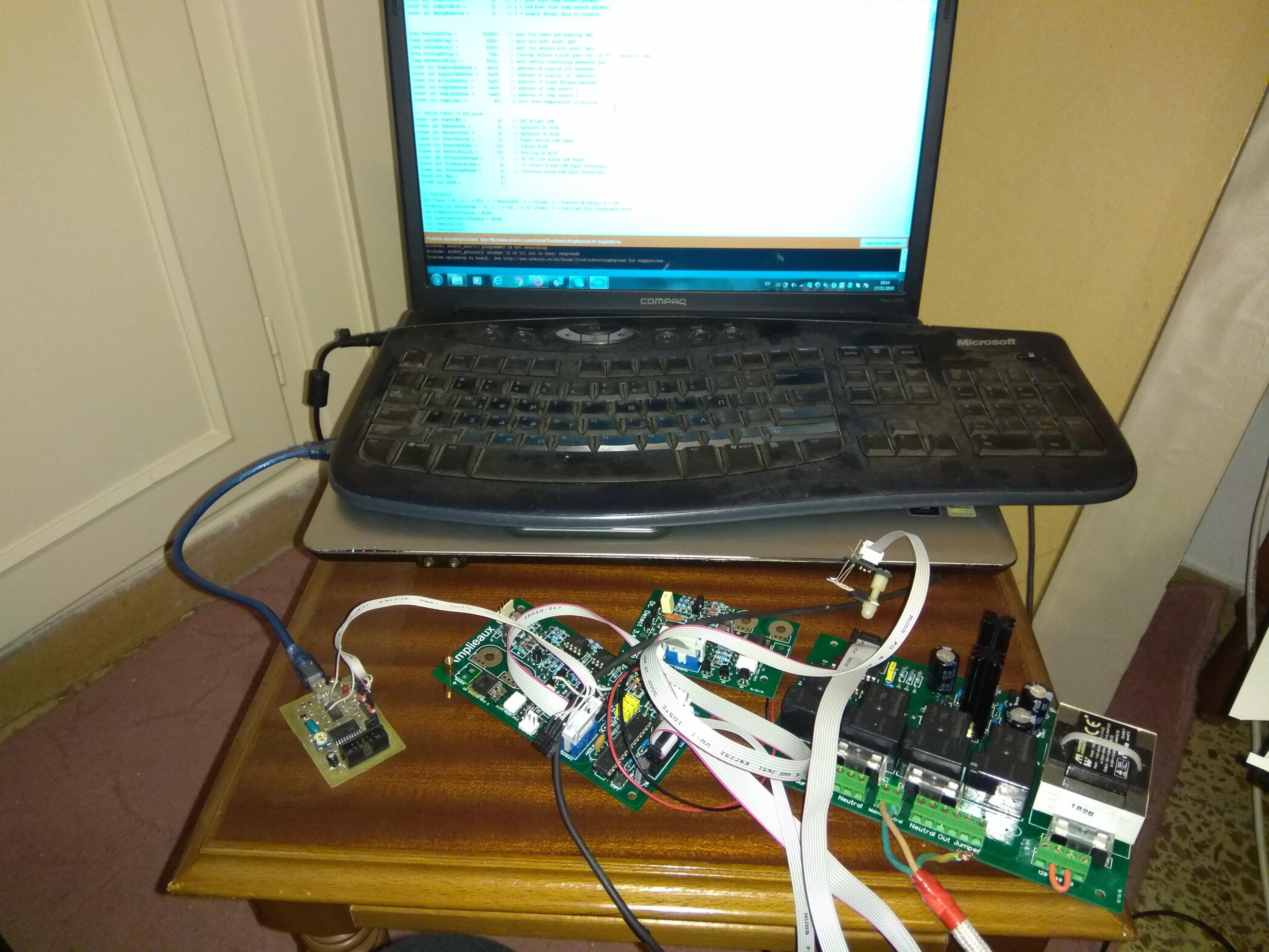

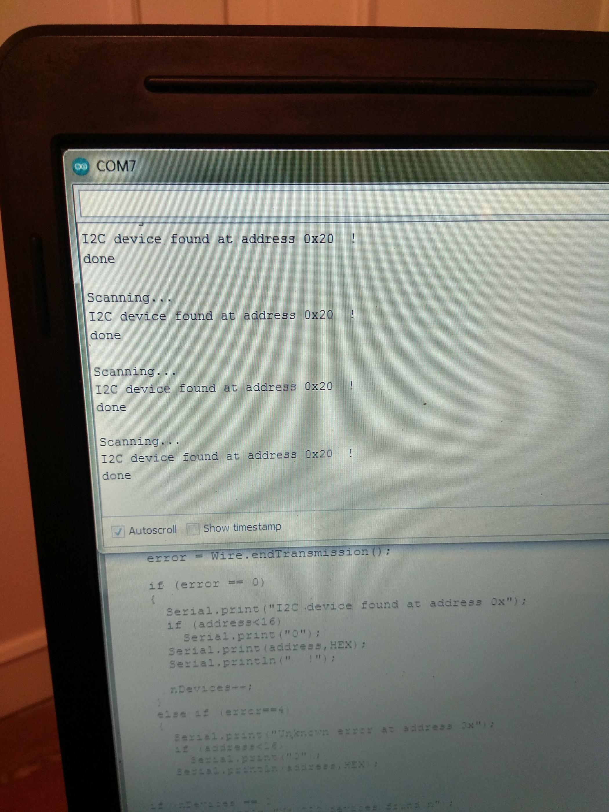

Picture n1 serial scan.
n2 main software Leaded!
I have one question only now.
Led is on even when amplifier-protection is off.
Led is on but with a little higher luminosity when system is on, is it right?
