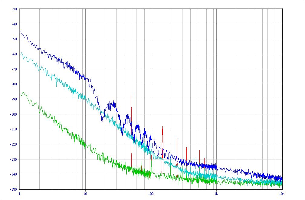

Please see attachment of P/N measurement. Ref is a Oven OSC @ 10MHz. Do not take attention to the Spikes. these came from other noisy equipment during this measurement. Jitter calculated for this Oven OSC: 135fs @ 10-10kHz.
The upper curve is the OSC with build in DPLL. Check the abnormal ripple from 10Hz to 10kHz. This OSC is a Si530 (24.576) with calculates jitter 2.3ps @10Hz - 10kHz(SPec on datasheet is: 0.6ps @ 12Khz ->20MHz), but others with DPLL may measure the same ripple?. The middle curve is a TCXO (24.576).
I think your phase noise graph is very valuable because you seem to have made those measurements by yourself!
May I ask you some questions to you?
1. Which device do you use, Agilent E5505A?
2. Do you measure a phase noise in an electromagnetic dark room?
3. How does a power supply quality connected to the oscillators affect on resultant data?
4. Is it possible to measure phase noise of actual I2S SCK or WS signal in a digital audio circuit?
5. The "Jitter" you referred in your post must be a "Phase Jitter". Can you also measure "Period Jitter" by using other suitable instruments such as Teledyne LeCroy digital oscilloscopes and compare those two jitter values?
Please feel free to ignore my complicated and detailed questions above.
Hi Bunpei.
Answer to above:
1) An old P/N meter from Aeroflex PN9000 was used.
2) No.. I do the testing in a normal "office" lab
3) This test is not so critical as first expected. I use a Linear Lab supply and local decoupling close to the osc (100nF//47-220uF)
4) Very interesting question. I have never done this before, but will give it a try next week and return with a PM.
5) No.. :-(

Hi Bunpei.
Answer to above:
5) No.. :-(
Do you have more information about 3) power supply. What is model number or spec or somethings ? Thank you !
