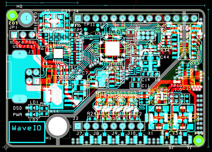

The pcb have 3 clocks. 48mhz always on ( grey xo near regulator ) for USB PHY. MCLK is from 2 Fox. The Fox turn on/off by 2 enable traces. All trace on top of board. No trace in ground plane (one small one). So it is easy to remove Fox and can use any pair of 22/24M xo.

LP5900 is 150mA. LP5907 is 250mA. Maybe this board need/use LP5907 because XMOS + 3 xo (1 disabled) + atmel > 150mA ? Or is XMOS use 5V and 3.3V ?

Aha, i've clearly missed the grey oscillator and took one of the expressos for core clock and the other one - for asyncronous I2S reclocking.
This is a nice little board then, thanks for clarification!
Yet still the external oscillators input thru the connector would be great, either thru slave-compatible MCLK or by separate pins or whatever.

The very first on designing a PCB is thoroughly understand it's power requirement in every possible loading condition😀
althought the latest xmos specification of this new chip still have no detail power consumption on each voltage.
but no need to worry, there are still over 50% headroom for the LP5900 in the current pcb power arrangement.
the original XMOS require a power up sequence of different voltage, the new chip should also this requirement but the datasheet still haven't this kind of information of the new chip. I think you can follow the old xmos chip datasheet and it should work.

microvia resistance negligable and for decoupling is imaterial, it is inductance that is the concern (approx 0.0004 Ohms).
4 layers would allow for interplane capacitance on the power pair, improving decoupling, this would improve the decoupling further and would allow more room to optimise routing. Also it would improve the impedance of the power supply to the pins of the device and the decoupling caps.
This would also allow for a decent ground plane directly under the top layer optimising signal transmission. For the difference in cost you would get a much better product, and more in keeping with a higher end audio image.
Microvias would be a bit of overkill for this design, but personaly I would feal better parting with my money if it was a 4 layer design. Even nicer but costly would be a HDI design with outer layers all ground and signal burried on the first layer down.
All that said the simplicity of the design allows it to be done on two layers and work, the above points I made are just going the liitle bit extra for the best signal integrity.

the effect of increase capacitance on DC-DC converter LC filter is included in all basic theory of all DC-DC converter😀according to the datasheet, the switching frequency is 1MHz, the effect of changing capacitance and the inductance can be calculated easily.
There is only 3.3V 1.8V 1V in the new xmos, the power up sequence combination is less the 9😛 I have tried all combination in the very beginning, some work but some do not work, but I forget to write it down. Anyway it can be tested very easily, you should have fun with it.
Using external power to the 1.8V/1V is also tested in the very beginning when testing the power usage in every loading condition(different load condition includes 44.1k->384k, playing different frequency/tone in different volume, the current usage change when changing music volume, the effect of increase oscillator frequency to each voltage power usage... etc.,)
the datasheet has the pin location for 1.0V and 1.8V. You can simply remove the inductor and supply external 1v and 1.8V power to the positive pin of the 22uf capactor, be care overvoltage and reversevoltage can damage the xmos chip immediately. Some low quality power supply has power on overshoot, it's also danger.
