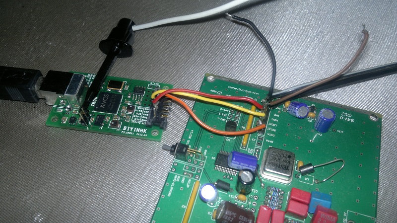

I connect XMOS to AMB y2. y2 have wm8741 + src4192 + Guido Tent XO + OPA2365 + ADP151 3.3V regulator. I remove FB1 on XMOS and use same power from DAC. This have shared ground so connect BCLK, DATA, LRCLK only. MCLK is Tent 24.576Mhz on DAC. I test with SACD rip/ PCM convert from Ray Charles, Depeche Mode, Norah Jones, Dire Straits, Berliner Philharmoniker, etc. SMPS is no problem. Sound is excellent even like the photo. I compare with CM6631 and Fox Expresso for MCLK. XMOS is sound better. 🙂
Maybe low noise regulator will be amazing sound. I can get 1.8V regulator but hard to find low noise 1.0V. Any recommendation ?

I did not listen for change. I don't think it can be changed from this regulator only because dc-dc converter will still make noise.
But this device is crazy. I think it have switching so it must be bad, but it is not bad. Seem like impossible to be good, but it is very good.
So maybe my change have no big result but I change because I don't like dc-dc converter in my hifi.
I will continue the changing and finally I will listen.

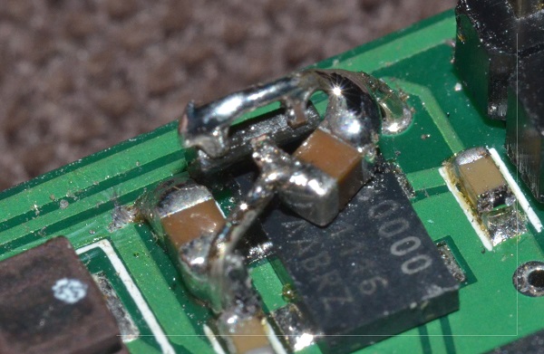

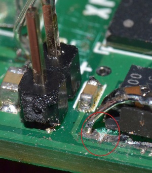

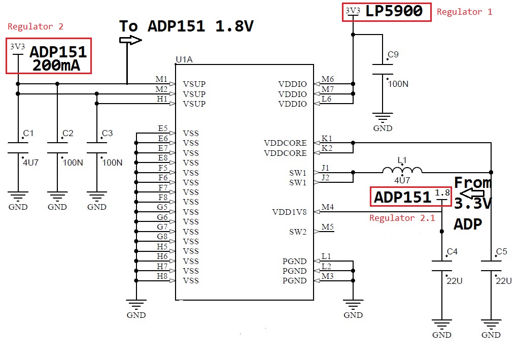

Now I change the 5V supply XMOS VSOP to 3.3V with ADP151 3.3V. I cut pcb trace, and fit ADP151 + 2uF X7R on input and output. Again, no problem, 🙂 but maybe XMOS feel a little bit hotter. I forget to measure temperature before so this is unreliable guess.
I must wait for TLV part to finish changing.

switchmode power supplies, if designed properly can be lower noise than almost any other type, especially down in the low frequencies where it matters for audio. with everything in the right place (filtering, EMC etc) with a good design, I would take a switchmode supply over a linear one for lower budget stuff. this is one area that audiophile 'wisdom' is wrong, still stuck in the ancient past. regulation at high frequencies, like we see in digital logic is better suited for switchmode than an LDO, which usually have pretty average dynamic performance and rely on the caps for transient response.
The 1V supply may need over 300mA when workingThis XMOS use ~155mA. I change 1.8V to ADP151. No problem. For 1.0V I will try TLV71210.
There is no headroom when using TLV71210 and according to the famous P=VI equation, if the LDO is 3.3V input 1V output, P=2.3V*0.3A, the small LDO need the dispatch 0.69W when running, it will be quite hot. If the input is 5V, 1.2W is converted to heat in the LDO, it should overheat immediately...
Thank you for this warning. Maybe this is not for other diyer to copy. 😱 And maybe no reason to copy. 😉 Although the datasheet says 10mV noise, but sound is excellent. 🙂
This is current working power. Device have two main 3.3V regulator and this is no problem at this time but I will test longer. 3.3V ADP supply power for 1.0V and 1.8V. XMOS is 49 deg C. Total current is 155mA. Current only change small amount for sample rate change.
I want to fit 1.0V ldo and if it is working, then remove power to VSUP (M1 M2 H1) so no switching noise. This can work if current enough ? VSUP only supply DC converter ?
I think NCP694 is a better regulator for this to be safe. It is 6V input max, 1A load and 30uV noise. I can add 6.8R 1W series resistor to input. This can share load from 5V for less heat and also be RC filter. Resistor rating P = I x I x R = 0.09R @300mA.
Datasheet says M1 and M2 are input for DC converter. They have a share trace so I can cut. What s H1 ? Datasheet also says DC converter can turn off in registry.
So I order parts. As I am waiting, I have listened for changes. I think XMOS is improved with low noise regulators. 🙂 I see the 48.000Mhz xo use 1.8V so I think I can understand the reason.
No output impedance of NCP694 is provided in the datasheet. Same for TLV71210... Their transient performance charts should be compared...
Output noise is not important as we power so crude thing as uC core - it's noise wil be MUCH higher then regulator's.
It's all about reg's output impedance, and its ability to regulate the load = suppress it's noise.
I understand but I cannot get information. So I guess for more current ability = lower output impedance, so NCP ( I get 694H not 694D, D have extra transistor with more RDS ) better than TLV, and it is more safe. Can you recommend a part ? I ask before but no answer.
Or maybe DC converter can keep using ?
Well, I choose NCP because this is best part I can buy, and I will use 470uF or bigger, very low esr solid polymer cap. 😀

I noted some questions regarding layout for the U8 PSU. The current public data-sheet states:
The most important thing you can do here is getting C1 as close to the XMOS device as possible - C2 can be omitted. The example schematics in the data-sheet are to be updated very soon (I believe there is a release scheduled this week).

The DC-DC converters should have a 4.7uF X5R or X7R ceramic capacitor and a 100nF X5R or X7R ceramic capacitor on the PSUP input pins M1 and M2. These capacitors must be placed as close as possible to the those pins (within a maximum of 5mm), with the routing optimized to minimize the inductance and resistance of the traces.
