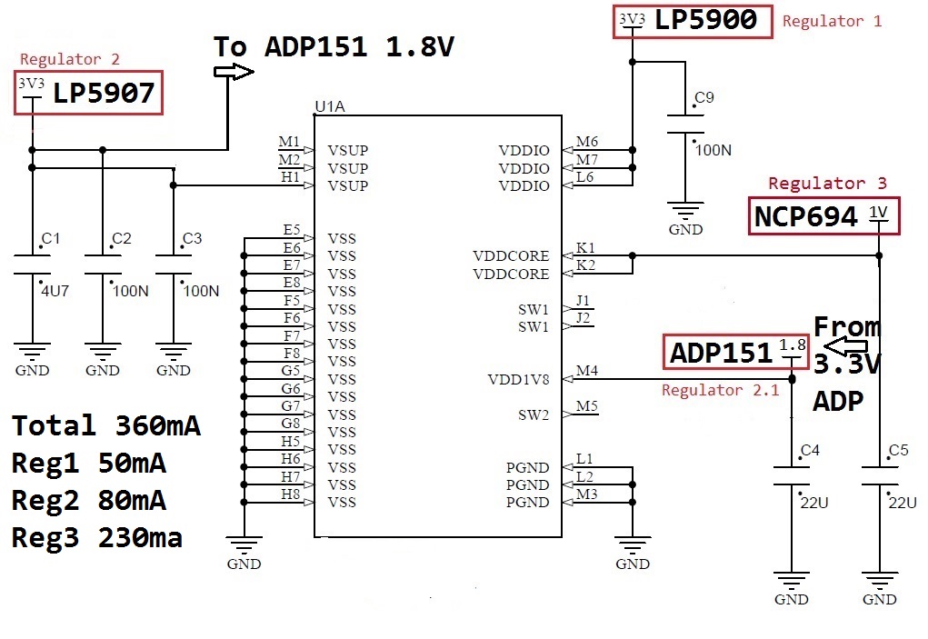

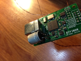

The power circuit is working. It is easy to hear the improvement of linear regulator and no DC converter. Cut the trace is working. 🙂 Maybe no need for isolator.
I use 3R 1W for replacement FB1. I use 10.1R 5W for 1V regulator input. 10.1R gets hot @ 40 degrees above room. XMOS is 24 degrees above room. Power is in the attached.

Here is trace for M1 M2 I cut and turn off Dc converter. I also add 100uF after 3R, and add 10uF ceramic after 10R, and 470uF polymer cap after 1V regulator. It is finished and the sound is very good. XMOS is excellent ! I agree with the review that said XMOS is best.

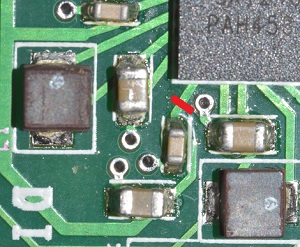

Thank you for many diyer asking about the decoupling cap distance🙄
A photo with a ruler is used for better visual understanding. The current design is 2mm from the chip, if you find your design has decoupling cap longer than 2mm distance is considered to be too long and poorly design😀 Diyer are always like to testing the limit, it will be moved to 1mm from chip in the next version🙂 instead, micro via has inductance and the board thickness(1-1.6mm typically) decouple cap distance length. With 1mm length and trace to groudplane capacitance, it should provide better result than microvia easily😱
Any suggestion and improvement are always welcome!
Hi DIYinHK
Regarding decoupling. A thumb rules is that 1mm pcb path = 1nH. So there may be 2mm from the edge of the Xmos chip to one end of the caps termination. The other end of the cap has approx 1mm to the via and extra 5mm back to the edge of the Xmos chip. But the edge of the Xmos chip is not correct point to measure from. the correct point is the dedicated Vdd pin and the related Gnd pin. this may be 2-5mm extra. A total of 10 to 14mm = 10 to 14nH in serie with the decoupling cap. Placement of the via is also not optimal. The optimum placement of the via is on the side of the caps GND pad and not the end of the caps GND pad. this wat you can keep the PCB distance to the thickness of the PCB + a bit more = 1.5mm+1.5mm(2*PCB thickness)+2mm(heat relief) = 5mm = 5nH. Please also place the via closer to the Caps GND pad instead of using long heat relief between the caps GND pad and the via.
A better way to decouple (read low pcb inductance) is to place the cap on the button side of the PCB, direct under the Vdd and the related GND.
If you dont want to mount components on the button side , then pleace rotate the cap 90dgr so the Caps GND pad places closer to the Xmos chip.

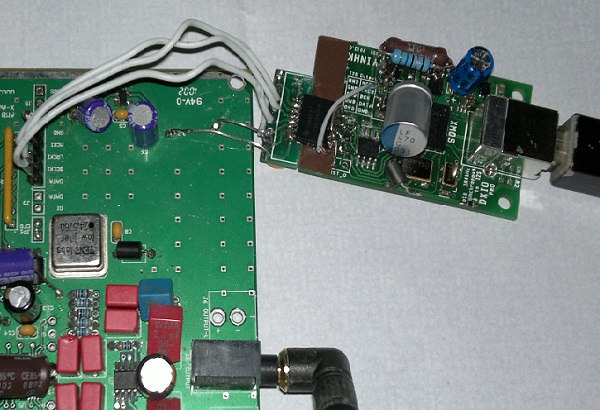

I add isolator TI ISO7640M. I Supaglue extra PCB. 😉 Vocal is smoother and there have more detail but also little bit more sharp. Maybe this is not great isolator or maybe it is the crazy mess. 😱

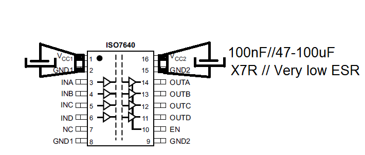

Hi..
Did you decouple the isolator?
If not please try this.
Solder a SMD 100nF between and direct on pins Vcc1-GND1 and Vcc2-GND2.
combine with e-lyt as close to the pins as possible.

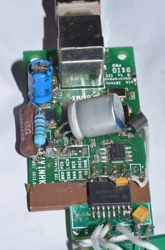

I change resistors on input to iso7640m from 100R thick film to 15R thin film and improve solder. The sharp has gone. It is not the iso make this sound. It is my bad solder and wrong resistor. I use Vishay melf resistor
http://docs-asia.electrocomponents.com/webdocs/0d99/0900766b80d99de8.pdf
I also move iso power wire direction so it is next to ground wire and not across signal line and iso. It is from LP5900 near the xo. Also add 22uF tantalum on iso power input across X7R.
No more to do. So, now the next toy for playing....😀

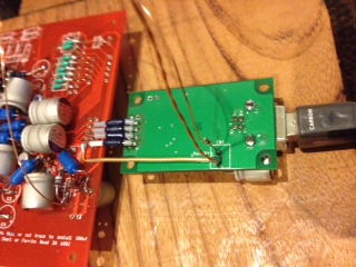

I hacked it in my good old Audio-gd Compass. Removed power from PCM2707 (R27, R28), removed 75ohm i2s resistors (R8-R11) and soldered pins there, removed USB input resistors (R6,R7) and soldered a USB cable there (so I can change the module 🙂. R4 was 1MOhm resistor between usb Vcc and GND used for PCM2707 powerup on Compass powerup - used that point for power connection to the internal USB cable. Didn't bother going for the internal +5V line across the PCB, used USB power connected only to the XMOS. XMOS is always on when USB is connected and not only when the whole unit is powered on. Works like a charm! No more 16bit 44.1/48 resampling.
