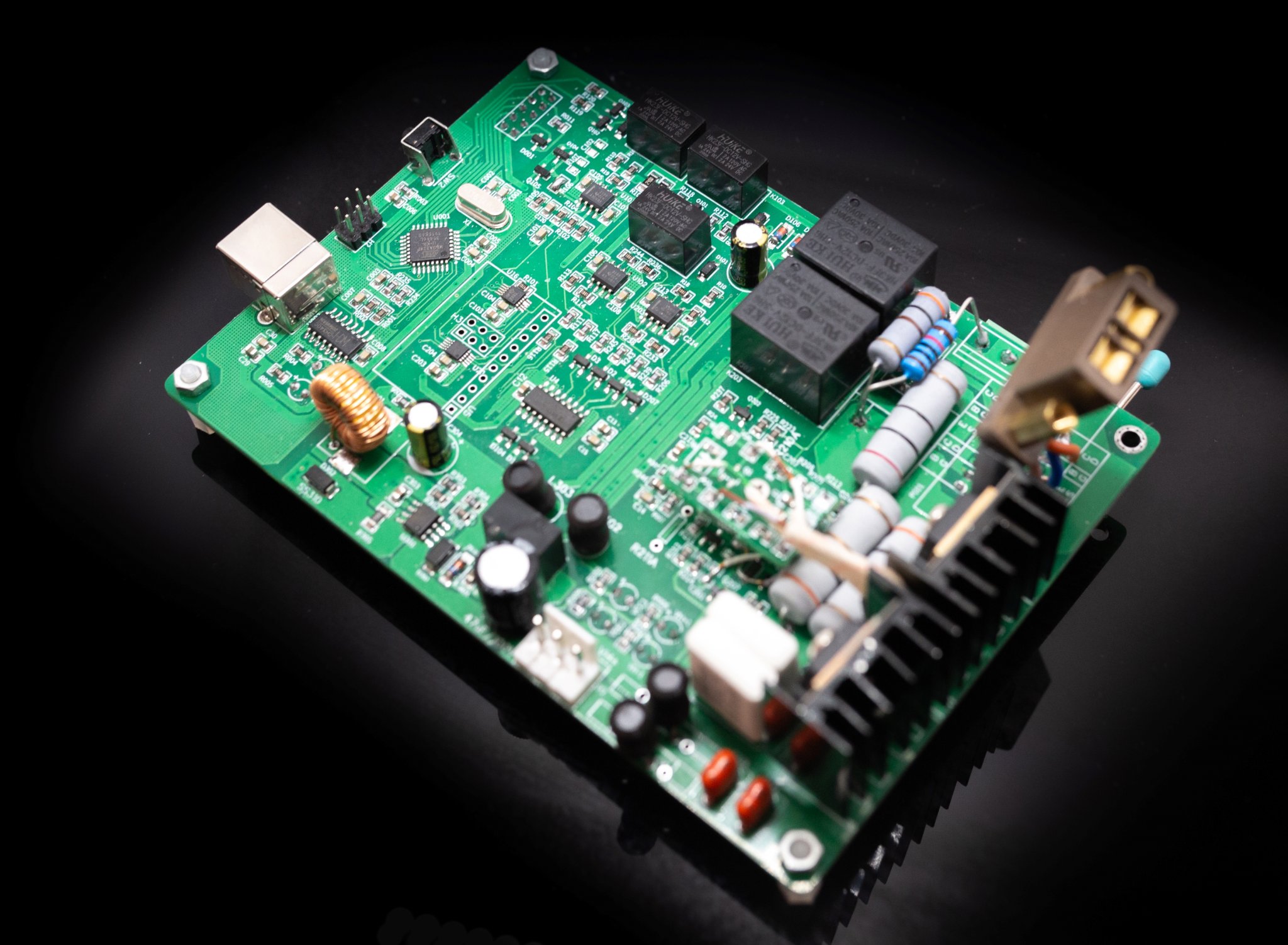

I asked for 2 fully-assembled tracer samples with expansion module, which means they can perform their best capability; and the package is on the way to my place.
Since I already have one iTacer, and I have started layout PCB with NANO module, please let me know if anyone is interested for evaluating the iTracer, and I'll make a plan.

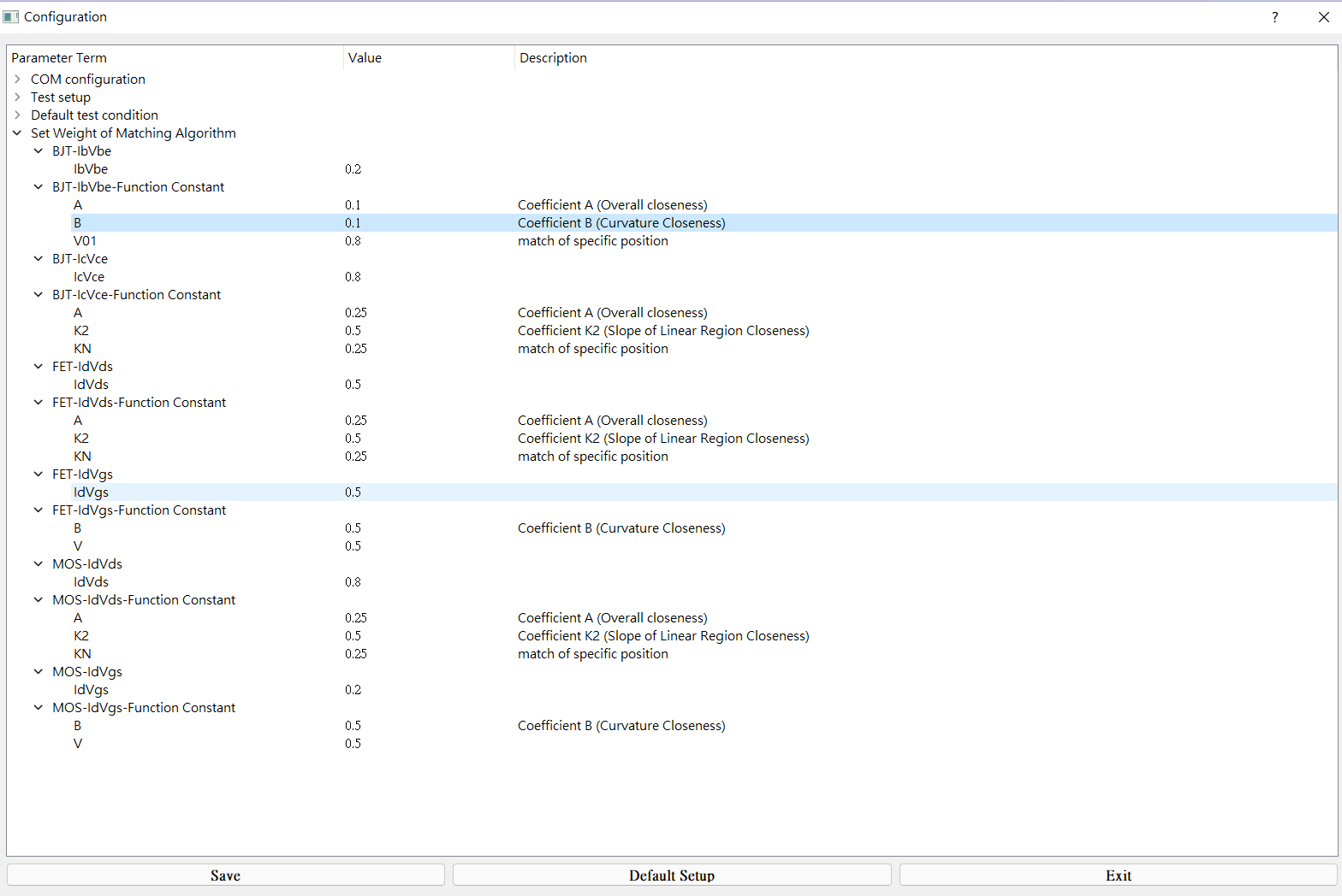

(I just found this Configuration window.)
Based on applications, users can set their own weights of coefficients, which inluence the curves by their own way and extent.
So, if you are awared of these coeffients (as explained before, the coefficients of the fitting functions),
you can actually define your own definition of "matching", or leave it default, let the designer of the software helps you to match by optimized weightings.

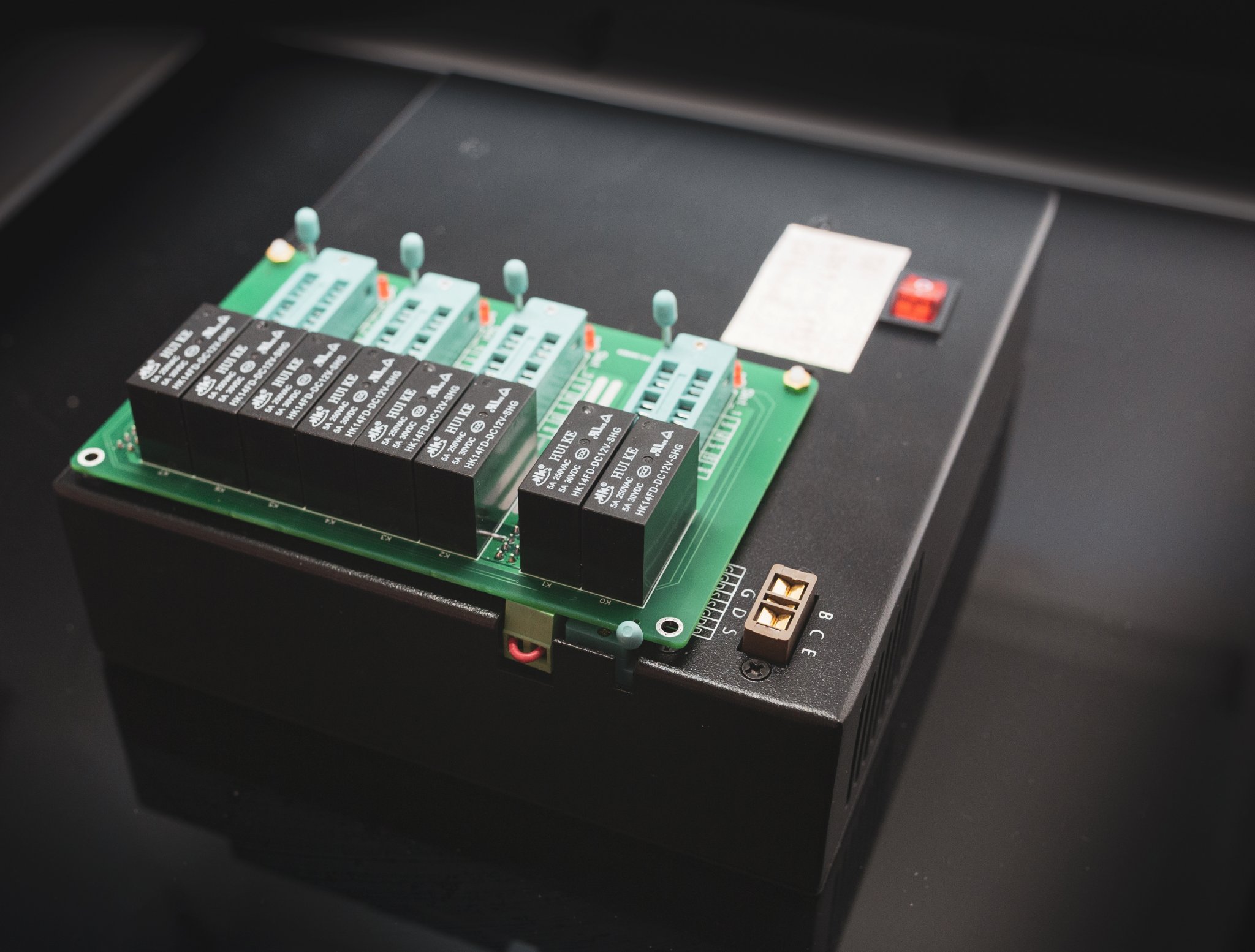

Hi Everyone,
This is the iTracer with expansion module installed.

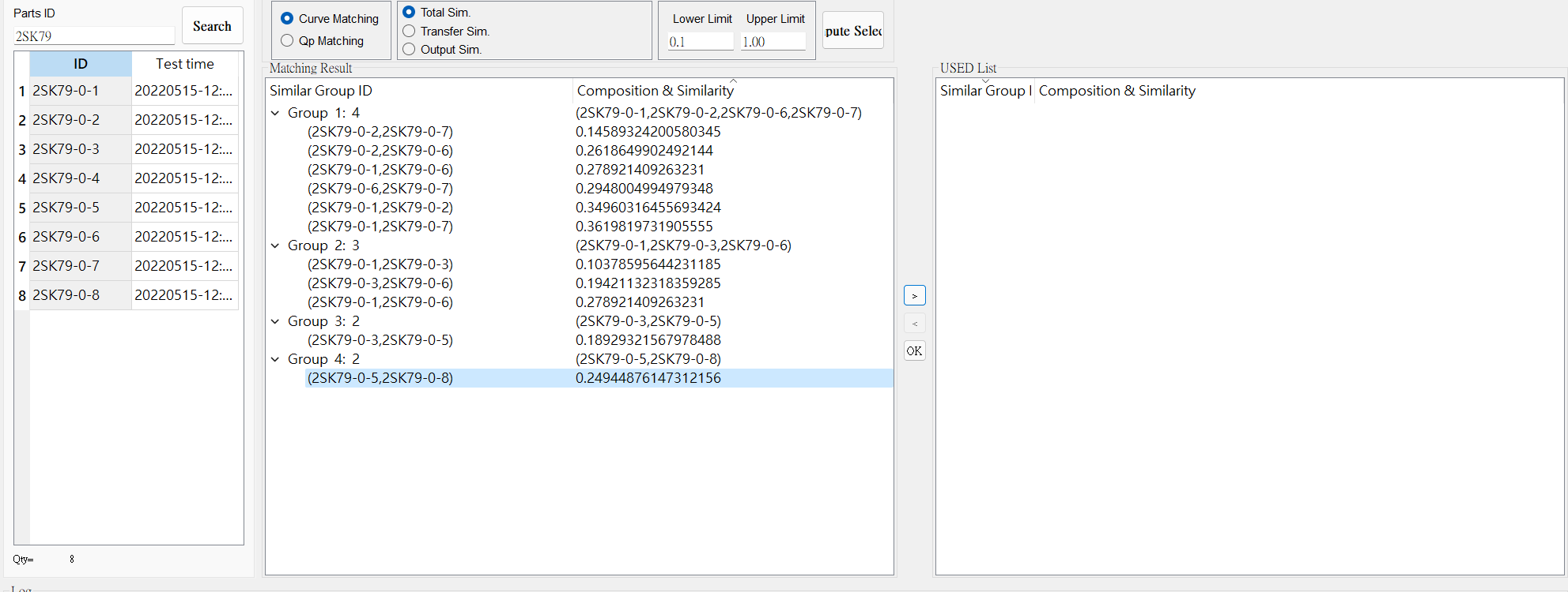

Using Expansion Module for measuring 8X 2SK79 at once, and the traces data will automatically be stored into database;
This means, once you assigned a permanent ID to a 2SK79 (for example, 2SK79-0-1, see below), you are not in a hurry.
Just open up data, and do anything you want, in the case below, the similarity of these 8x 2SK79 are calculated.

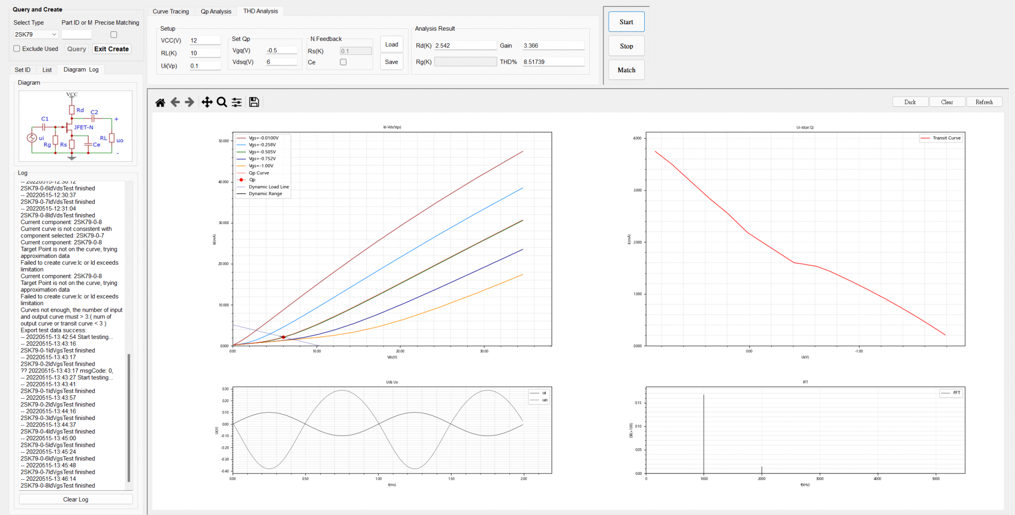

Although the THD/FFT Simulation Analysis is still preliminary,
yet it still provides DIYers a very intuitive and comprehensive point of view to quickly evaluate the properties of DUT,
and its behavior, based on the data you just acquired from iTracer nearly real-time!
This Analysis Tool tells you what's gonna happen if you use the DUT and the basic circuitry as Diagram on the right shown.
Hereafter, it performs simulation and show the results as FFTs and Waveforms.
For hobbyists and amateur DIYers, you don't need to know detailed and tough electronics, this Analysis Tool is developed for these users. Because you don't need to know exactly what all these curves mean; you just look at the simulated results of each transistors you measured,
and let the intuition take the rest of charaterizing, parameterizing transistors. That's all.

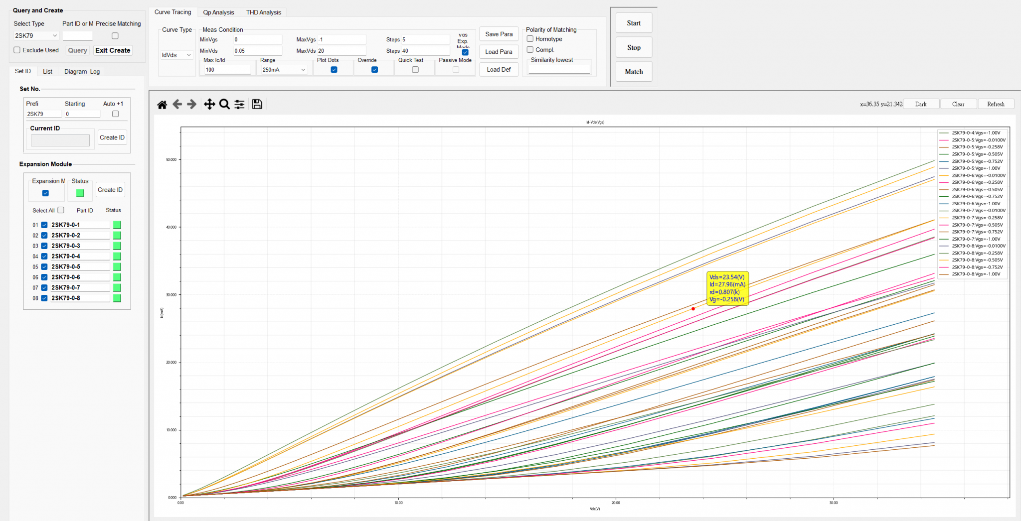

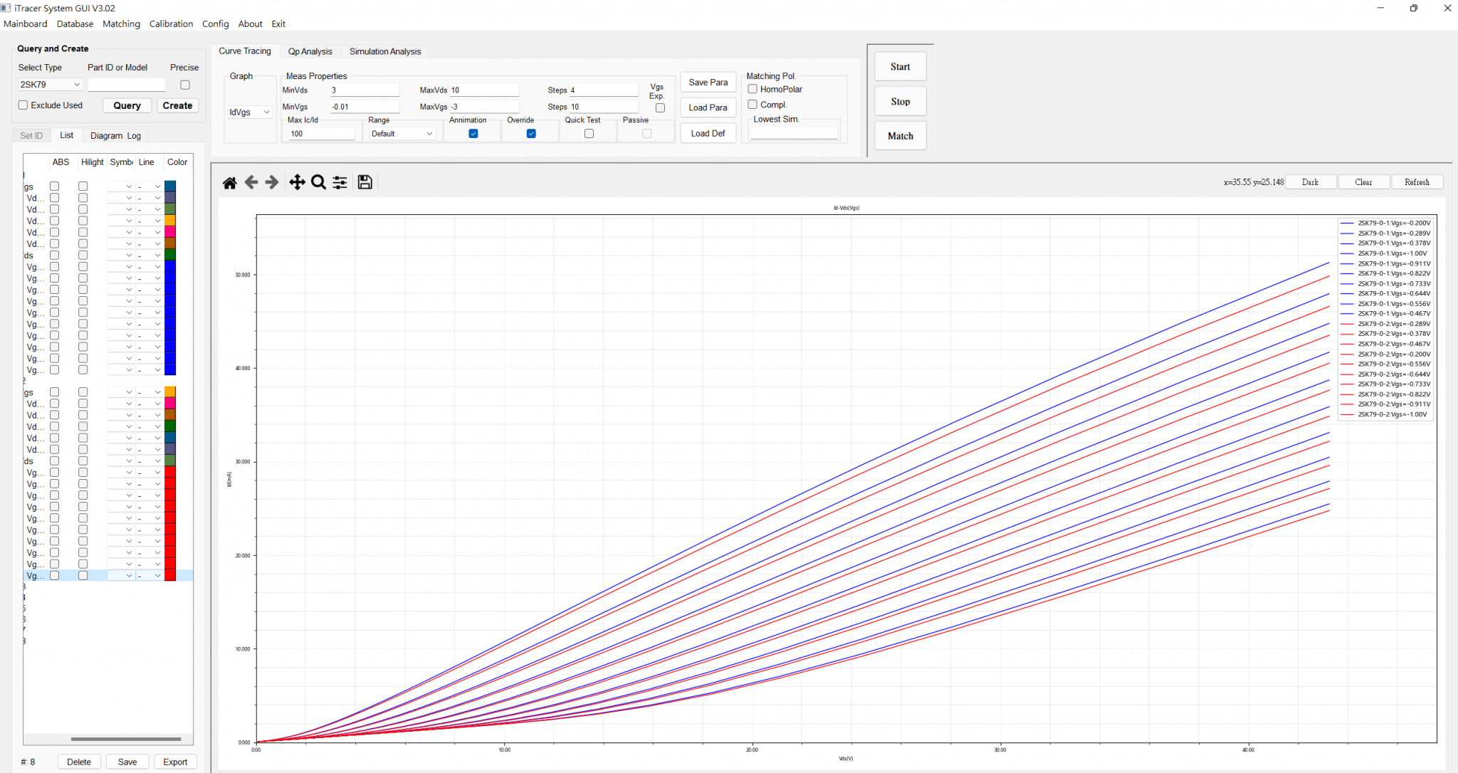

The curve comparison is hard to read because of the seemingly random choice of line colors. I'd suggest to use the same color for all curves of the same part.Using Expansion Module for measuring 8X 2SK79 at once, and the traces data will automatically be stored into database;
View attachment 1054271View attachment 1054272
See here for examples: https://www.diyaudio.com/community/...-by-vgs-and-curve-tracing.381338/post-6896899I'd suggest to use the same color for all curves of the same part.
Thank you, very impressive! I will report this suggestion to the author and see if changes could be made.
I think that would be Python.Very impressed with the software/GUI.
What toolkit and language are you using?
Hehe - I thought it was! Could tell a matplotlib plot anywhere.
Can I ask the toolkit? It looks like of QT, maybe TraitsUI?
I hope it's wxPython, not QT. WX is more portable and allows native GUI elements on most other operating out there.Hehe - I thought it was! Could tell a matplotlib plot anywhere.
I’m a fan of WX also. I’m mentioned TraitsUI, it’s a framework for programming reactive GUIs but you can select the between WX and QT (mostly).
Solved! I forgot that the color can be changed manually, user can assign any single color of the same devices.The curve comparison is hard to read because of the seemingly random choice of line colors. I'd suggest to use the same color for all curves of the same part.
