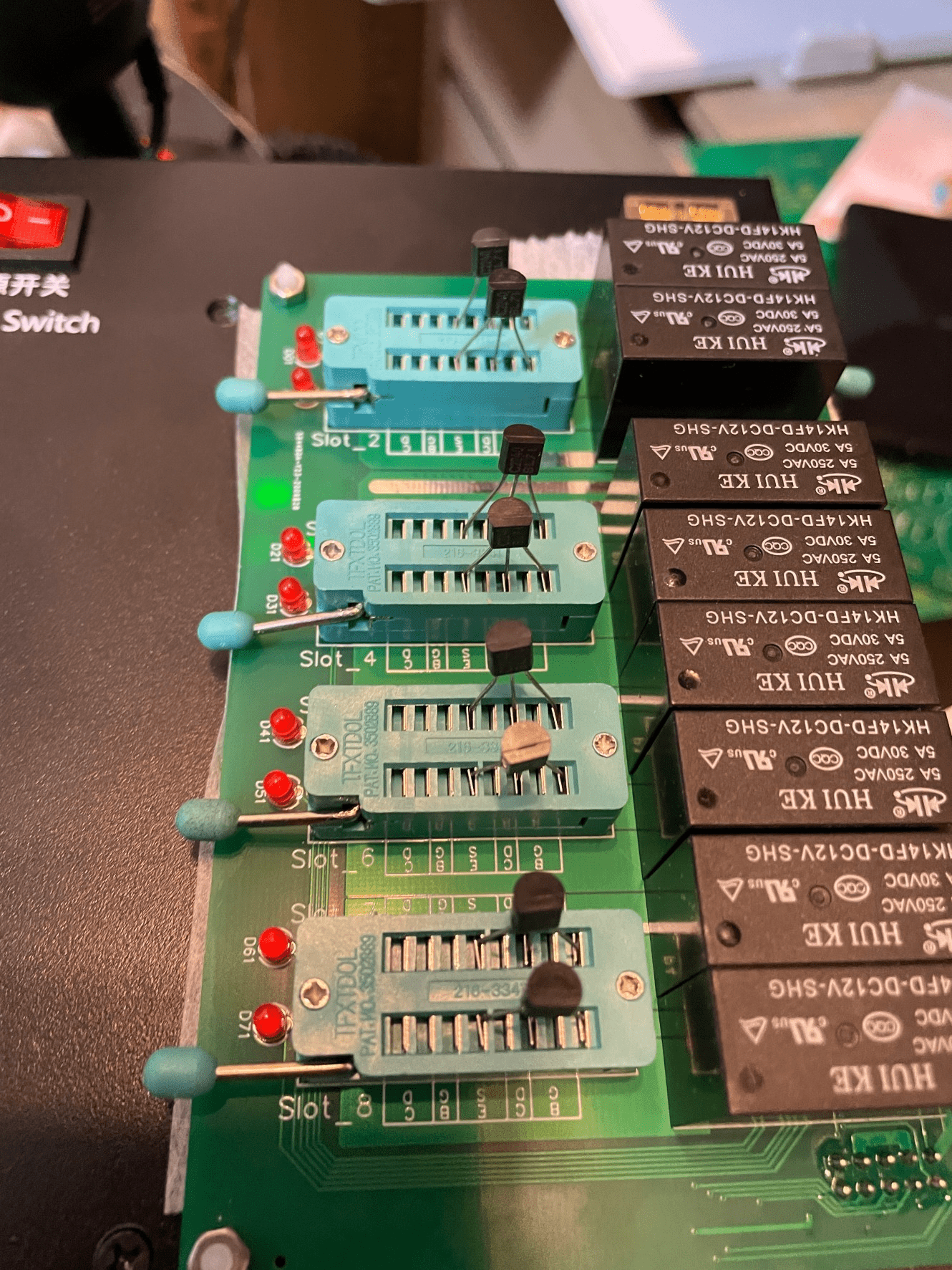

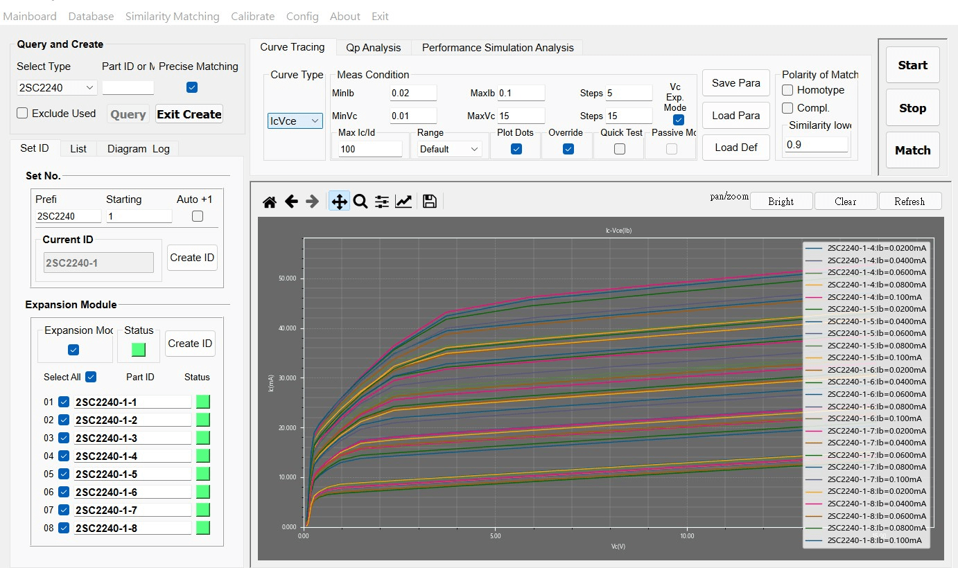

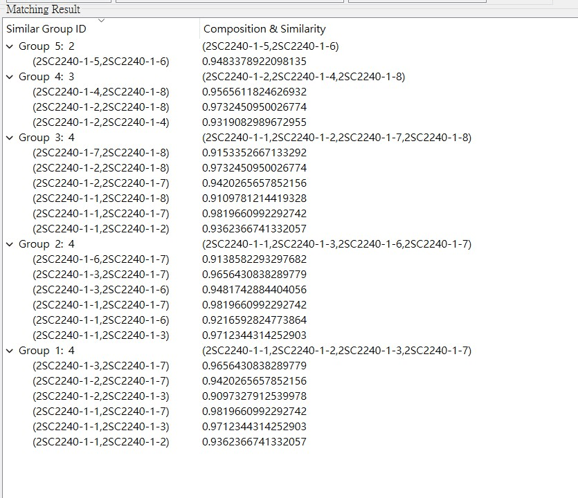

Get some test results today.
I used 2SC2240 X8 and the Expansion Module, and the result is good.
The device automatically switch the DUT, up to 8 pcs at a single test is allowed, this is convinient for amateur use.
There's also ingetrated mathematical algorithem to calculate the similarity of each pair, and the software would tell you the similarity as numbers, eg. 0.96(96%).

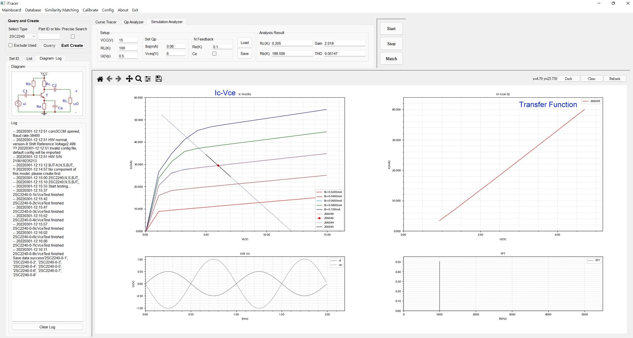

Further, the simulation analyzer works. There is a basic template circuit, by setting the working point and some other parameters, it gives you THD, Gain, the output waveform, and.....FFT!
The system is under development still, so any suggestions are welcomed. Our goal is to make a affordable, yet powerful component tracing, matching system for amateur DIY users.

early voltage? Do you mean Ic-Vce while Vce<5V or so?Can you plot early voltage vs Vce?
No, I mean plot Early voltage at each Vce. It drops in quasi-saturation and when approaching voltage breakdown.
Yes, I must admit it, however it's a novel function that's under development, so, consider it a "bonus"; but it will get better for sure.Looks quite good. Although the linear FFT scale makes that plot pretty much useless.

I have pass your ask to the engineer, please wait for a while.No, I mean plot Early voltage at each Vce. It drops in quasi-saturation and when approaching voltage breakdown.
Sorry, the software is not able to do this right now, but it's possible to export data and plot it using Excel.No, I mean plot Early voltage at each Vce. It drops in quasi-saturation and when approaching voltage breakdown.

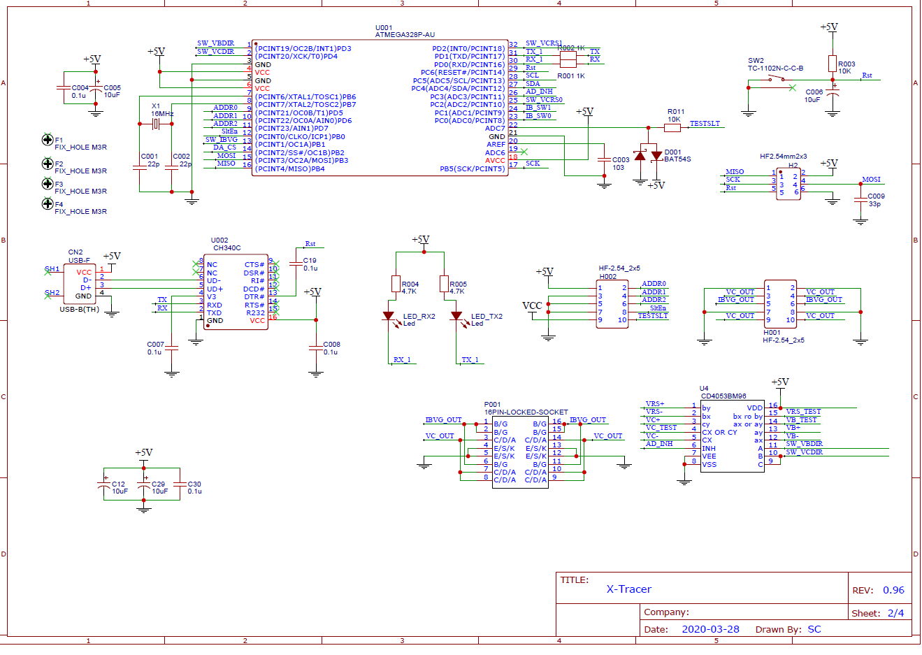

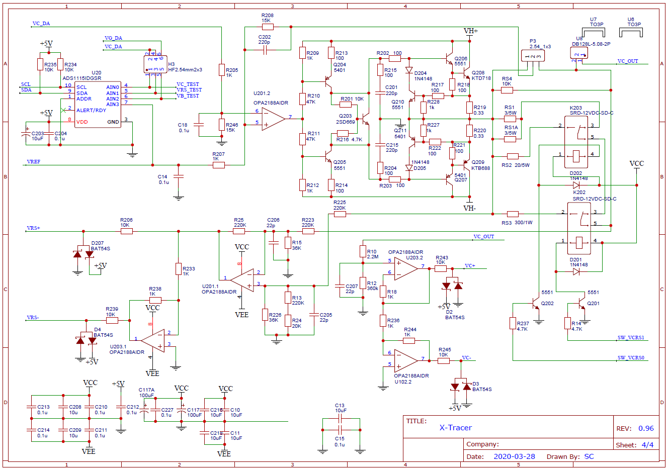

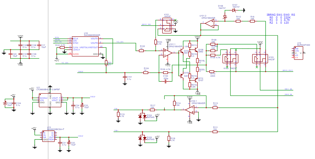

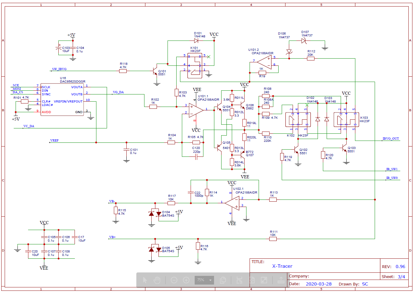

So, I am working on the PCB for international users, and there're something I want to improve/change.
The first thing is Vref, the voltage reference, early version uses internal Vref of the DAC; but I think adding LTC6655 (LCC-8) and MAX6225 (SO-8) provide better performance for the system, and it's up to the usesers choice. Also, the MAX6225's pinout is very common, many other Vrefs with SO-8 footprint are compatible.
Would it be a good idea to replace the original Ib-Vg channel amplifier with buffers like BUF634? The discrete versus IC.
