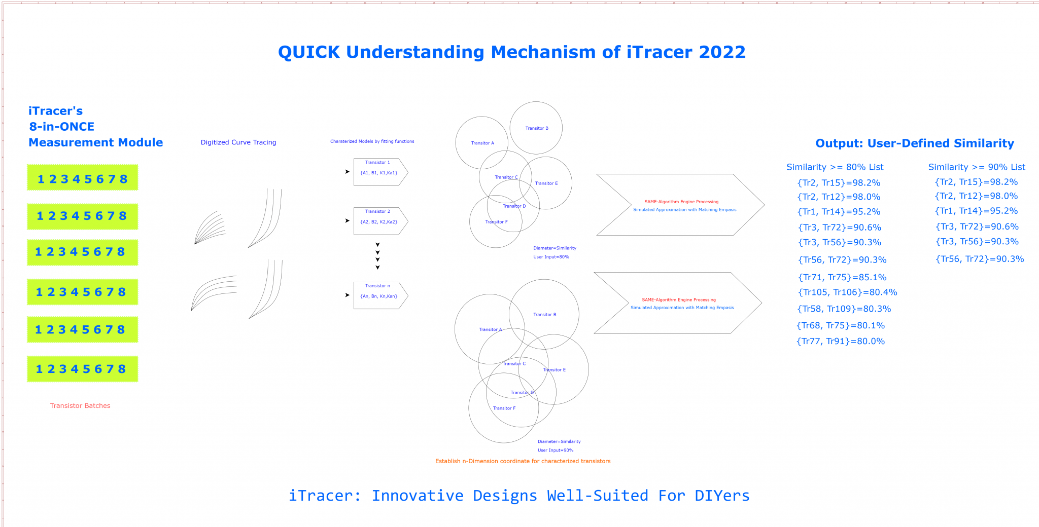

Since begining, compared with other tracers, the author of iTracer makes more efforts on its transistor batch <matching> and <pairing> ability.
Theses efforts are mainly shown on the software aspect.
For example, how do we gonna do if we need to identify matched pairs from a batch of 100 transistors?
For sure we can use curve tracers and plot traces of these 100 transistors, then compare the curves one by one.
If the plotted curves are close or overlapping, one may think: oh! These 2 transistors are the matched pair! Job done!
However, what we are thinking about is how close is enough to say they are matched?
Two derivative question raised:
1. Can we quantify "close"?
2. Is there better way for quicker, automatic measuring?
Hence, mathematical models and algorithms are developped for this tracer project:
1. The iTracer can measure a batch of DUTs up 8 pcs at once, automatically(by swithing relays).
2. After measurement and proccessed, every DUTs can be quantified based on their own curves.
3.With quantified DUTs, the software can rapidly and accurately choose and select matched pairs, and tell you how similar/close they are by numbers!
Ex.
Matched Pair No.20, Similarity=96%
Matched Pair No.5, Similarity=94%
And of course, you can make your own definition of "similar", enter a number like 0.8 and the system will tell you all the pairs that are 80% similar with each other in this batch, easy and simple!

You could probably write PhD thesis about different transistor matching approaches. However, "matching" parts and expressing their "overall goodness of match" by a simple number makes no sense if you ask me. It is better to first understand the needs of a given circuit with respect to characteristic(s) that need to be matched. Do parts need to be matched for gain? DC operating point? (Non)linearity? Etc.? Only once you know what you are looking for, you can start to analyze the curves and match the relevant parameters.
Thank you for your poins.
Indeed, the idea of "matching" is not a easy thing to explain.
Simply speaking, our idea is to made "matching" more than oberving curves but less than involving something like statistics, because it's hobbyist-oriented; yet there is gonna be a manual that explains the details (publish later).
But I will brief talk about this here, and I have to clarify that it not just a simple number that decides the "overall goodness of match", or perhaps "similarity" in the following.
We propose another way to represent curves of transistor, and also another way to represent the extent of similar.
In the chater of the manual:
.......Take adventage of Curve Fitting Function
More ideally, it is better to develop mathematical models of curves, by using fitting functions to describe curves, then calculate similarity based on them.
Utilizing SPICE model is an excellent way to describe semiconductors’ characteristics. These models are based on semiconductor’s physical properties, and there are too many parameters that are hard to get. SPICE is unnecessarily too complex for hobbyist-grade matching.
Alternatively, we choose another approach.
The curve fitting function could be used to describe curves.
Both input and output transfer function can be curve-fitted. Mathematically, by means of parameterizing, the <characteristic vectors> can be made on the basis of fitting functions. The distance between vectors could be seen as the similarity of different curves, with weightings and some adjustment.
Estimating Function Similarity
Once fitting functions are established, similarity could therefore be calculated based on them.
Calculating similarity basically consists of three steps:Establish Fitting Function’s specific “vector”
Use any measured points (x, y) on curves, one can thereby solve the function to get corresponding constants.
Take BJT for example, the BJT output function can be desbribed as:Ic=A−Ke^ (−Buce)+K1uce|Ib
We got 4 coefficients A, K, B, K1 in the formula, which can be obtained by solving the function using measured points, (Ic, uce) in this case.
Once constants of fitting functions are available,
we propose to define a vector called “characteristic vector”, <A,K,B,K1>|Ib in this case, which can be used to represent the curves.
Establishing Similarity
The components of the “characteristic vector”, <A,K,B,K1>, paly different roles on their own to influent the curves.
In short, by establishing a 4-Dimension coordinate, similarity could be seen as the distance of 2 points in the dimesion (sort of),computed by averaging and weighting on the basis of <A,K,B,K1>.
...................................................to be continued.
