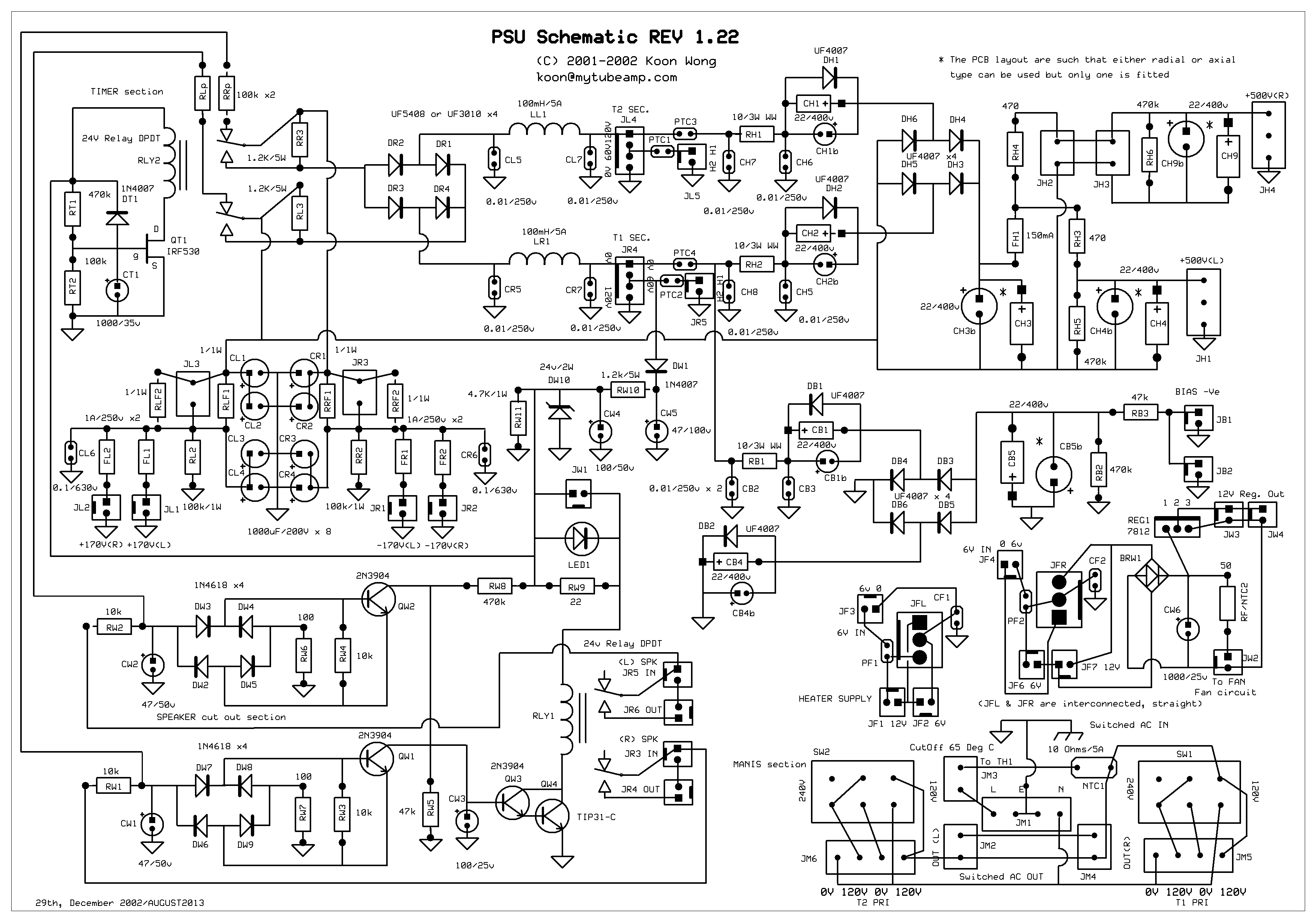

Hi Chris and Banat!
I tried the R33 shorted out and I got HT2:+172VDc and HT4: -171VDc. Looks good!
HT3:-502Vdc without load. Is it O.K. without load??
Next will be to try the 39K/5W bleeder resistors. Can I use a higher value with lower wattage resistors?
Greets:
Tyimo

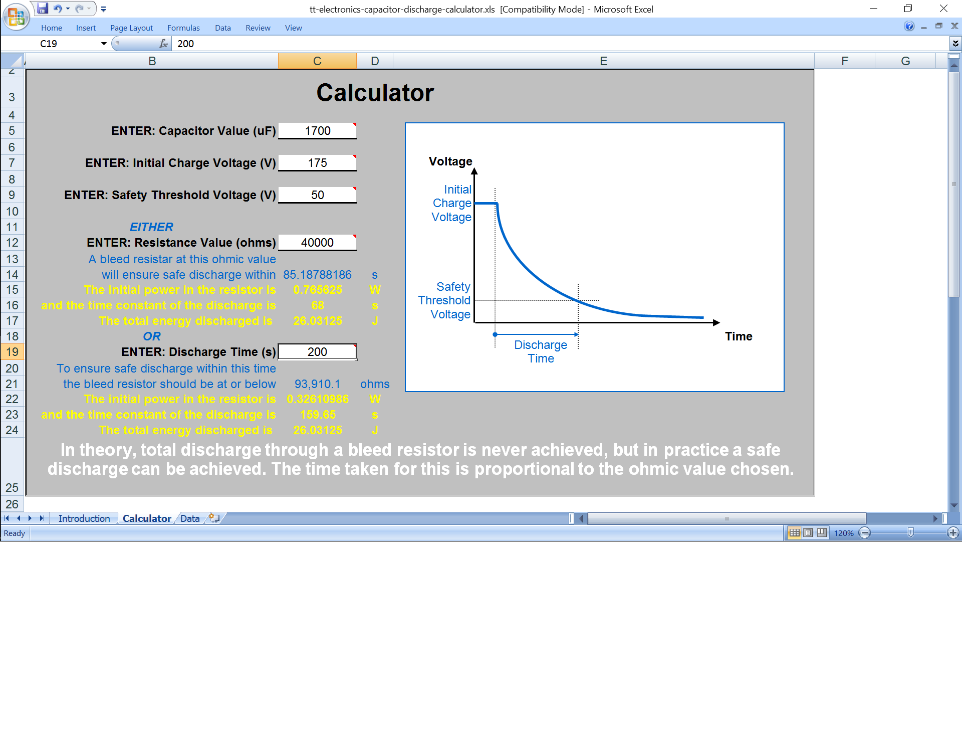

Hi there, there is standard way of calculating bleeder value, it's the safety threshold value you need to remember after calculation, better attach a warning label:" Caution: High voltages, allow X mins after turn off before servicing." Attached is an example of calculation. To ensure highest safety always measure the high voltage supply to ensure it's safe to work on.

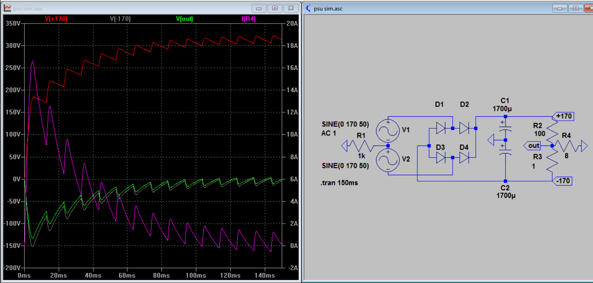

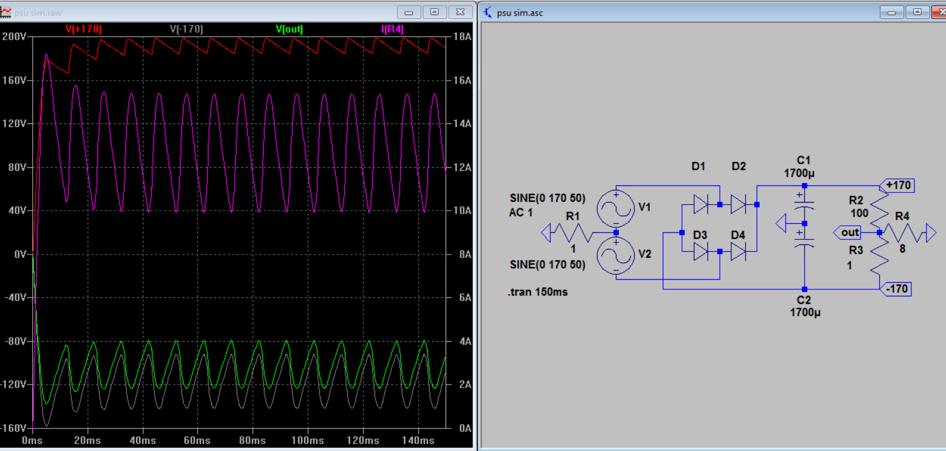

R33 1k sim compared with 1 ohm
This may help to see better the impact for R33 in or out. I think either way the fuse will blow due to some 15A initial discharged into speaker, hence no protection, if fuse does not blow, +170V will be +300V!! which pretty much what you don't want to happen (as already pointed out).
