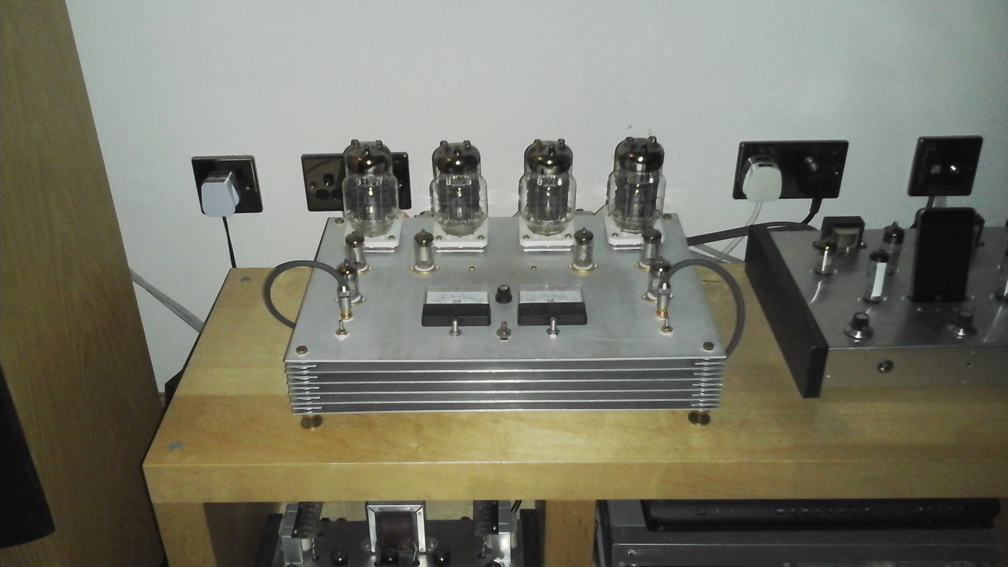

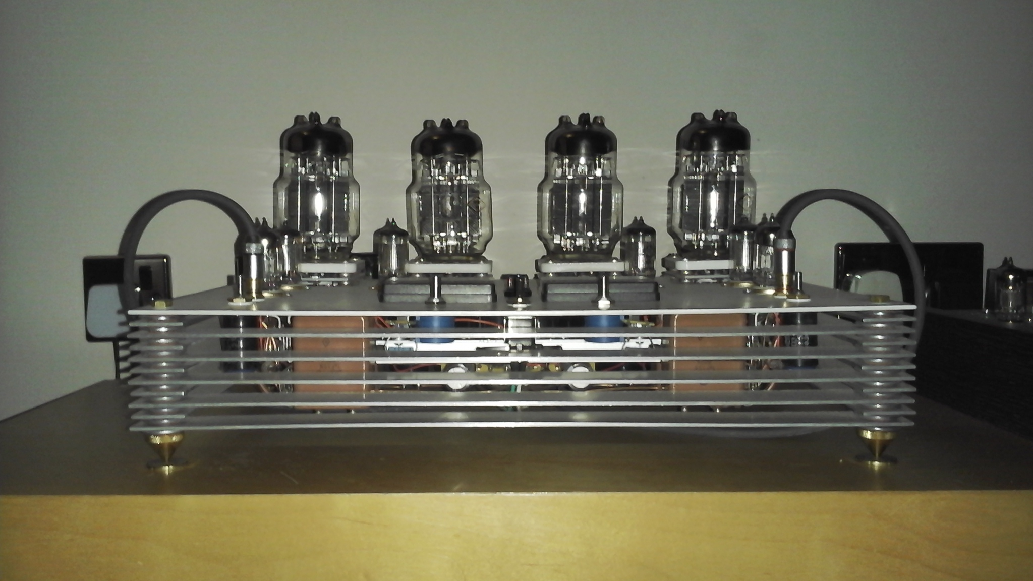

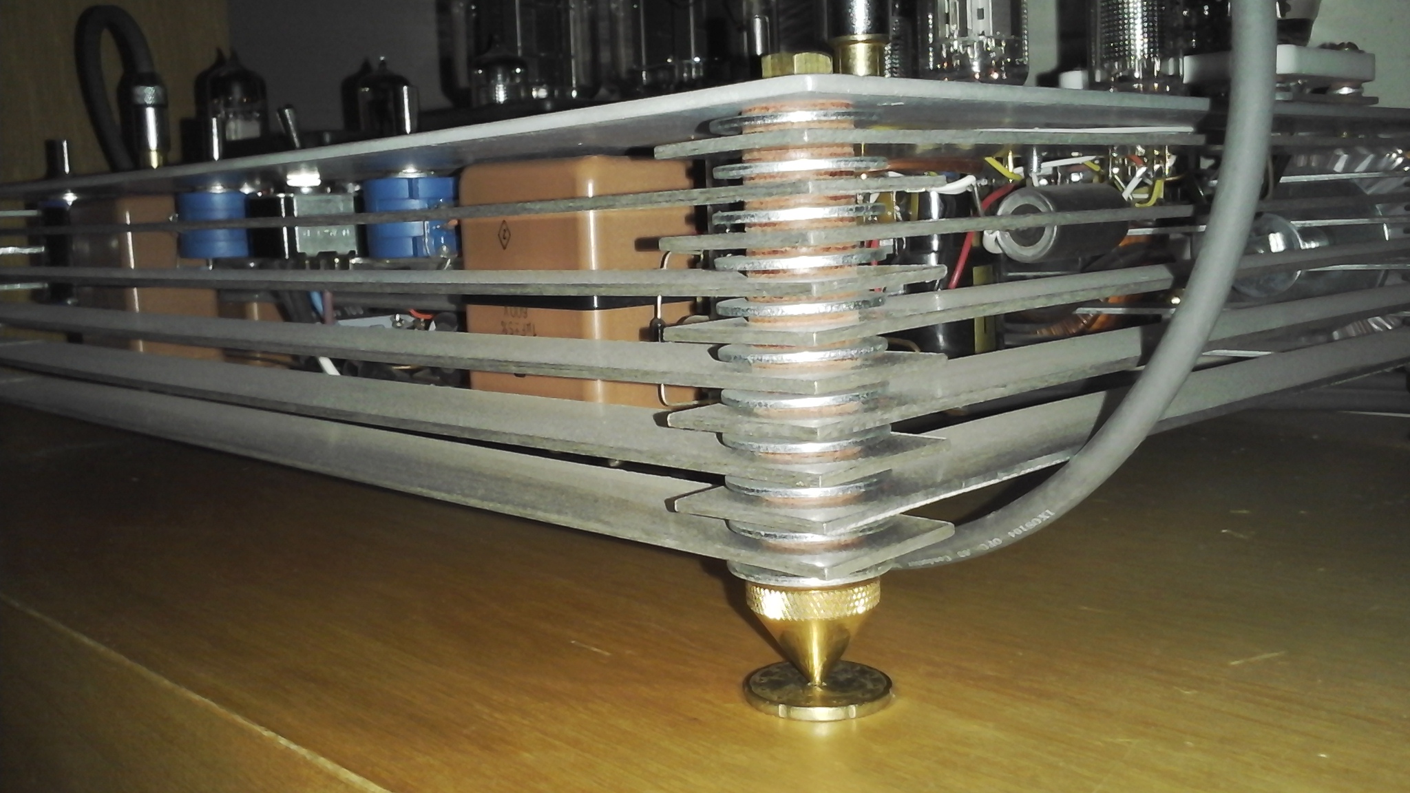

2 years on and amp is still Running great, hats off to Tim for his design,,
Only upgrade is the golf cone feet
( for looks only in my opinion )
Busy building a tda1543 NOS balanced output dac
intend to convert amp to balaced input with miniature xlr plugs

Mine also has been running for two or three years now with no problem. A very reliable amplifier, and a great sound.
Chris
