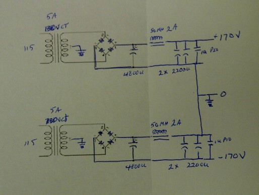

I am building a pair of otl monoblocks based on another design. I have read this thread from the beginning and hope someone can advise me based on the experience gathered here. My power tubes need +170-0-170. Circuit calls for a very standard dual power supply using a 230vct with ct to ground, and a bridge rectifier to CRC filters.
I want to make use of transformers I have and change to a CLC filter. I find very little info on using 2 transformers for a dual power supply, but it seems it should be ok.
I have 2 x 130VCT 5A transformers. (overkill I know). Basically is there anything wrong with using one transformer for + rail and one for - using 2 bridge rectifiers. I would still attach the CT to ground to get the benefit of balanced supply to cancel common noise. I attach a diagram of my planned supply.
Excuse if this is too basic a question, but I want to get it right.

I am pretty certain that you have a problem with grounds.
You are grounding the center taps of the transformers AND you are grounding the junction of the two supplies. With their transformer center taps grounded, both circuits will provide a positive and a negative supply which is not what I think you were trying to achieve. With the junction of the supplies also grounded you will either blow fuses, or burn out components, or both.
The choke locations would be OK if the center taps weren't grounded since each supply can be considered separately - the choke in each case is in series, so it could go in the low voltage side or the high voltage side. There is an argument for putting the choke close to ground in terms of voltage since its insulation is subjected to lower voltage stresses (although for a decent choke it really should not matter).
I don´t know this exact circuit.
Many Otls use diffrent values for the bleeder resistor to create a bias voltage and then you need a single bridge solution.
One bridge is less voltage loss due to diode forwardvoltage and less switching noise.
I played around with chokes in my OTL, make sure the DCR are less then 0.5R.

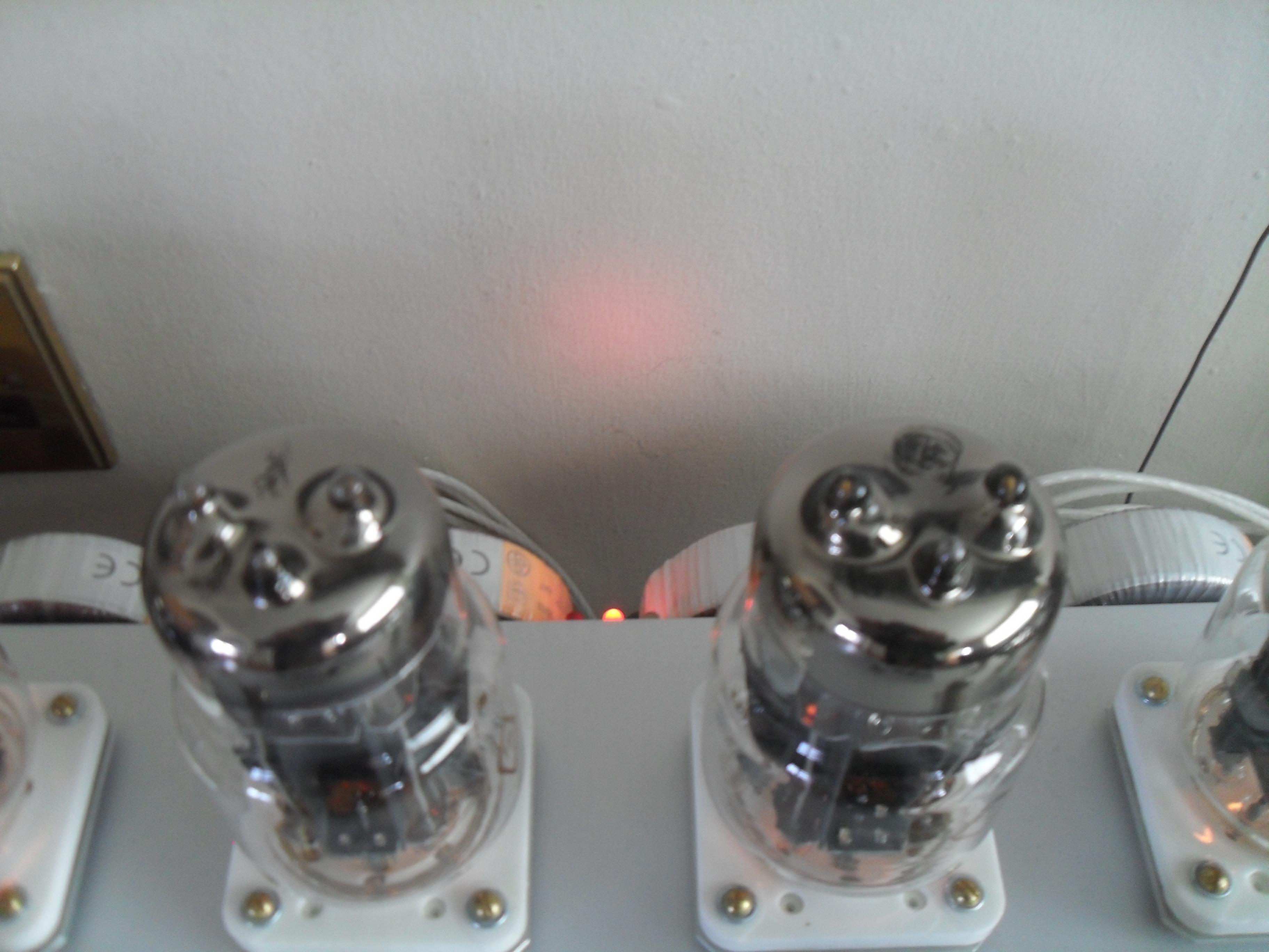

Its been a while since I did anything to the OTL amp I have just been listening to and enjoying it.
I have done away with the auto transformer and am only using the bench isolating transformer without center tap. I set up the offsets using my dvm and everything remained stable with no problems
...UNTIL...
My son had is 20th birthday party, and I noticed 2 of the 6c33 tubes glowing red! (it was playing very loud at the time but he bias was only at 150ma)
when I checked things out the next day I discovered that someone had tweaked the left hand Chanel offset pot and that the +/-150 volt rails wher 50 volts out i.e. +200 / -100 compared with the signal ground

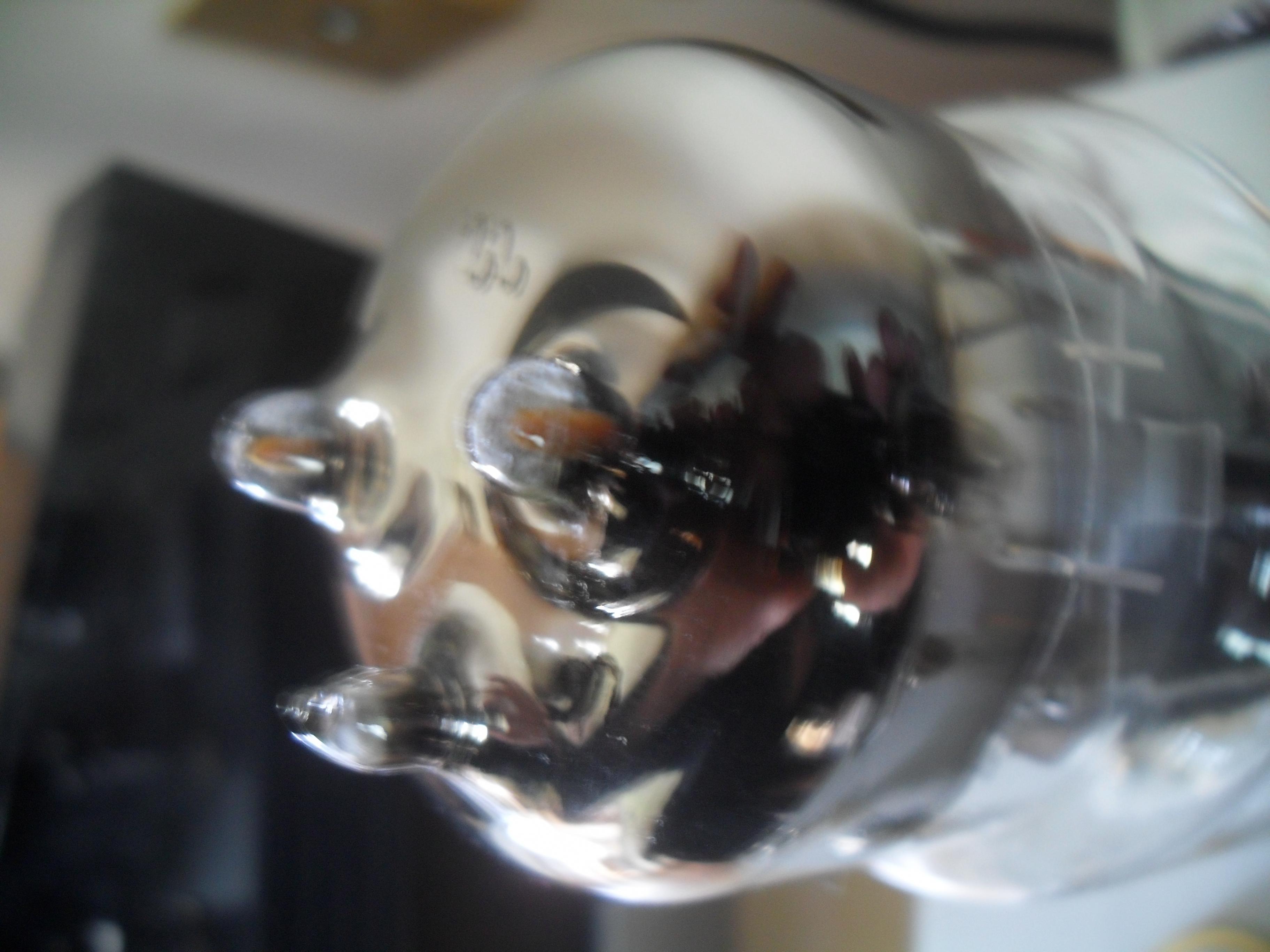

6c33 overheated due to wrong off-set
just as a footnote = a picture of one of the overheated tubes
these 6c33 tubes really are rugged once burnt in properly,
despite this tube glowing cherry red when being over run (to the extent that the getter deposits on the inside of the glass are burnt) the tube still works ok and the bias sets up the same as a one of the other tubes when I swap them around.
I really trust Tim's design 100% and 9 months on the lesson learned is that the off sett pots do not need to be easily accessible. you could get away with having the bias pots hidden too but. the benefits are that as you crank up the bias the damn thing just sounds even better 🙂

FYI, built the power supply and it works perfectly. Per discussion here, no CT to ground and all is well.
