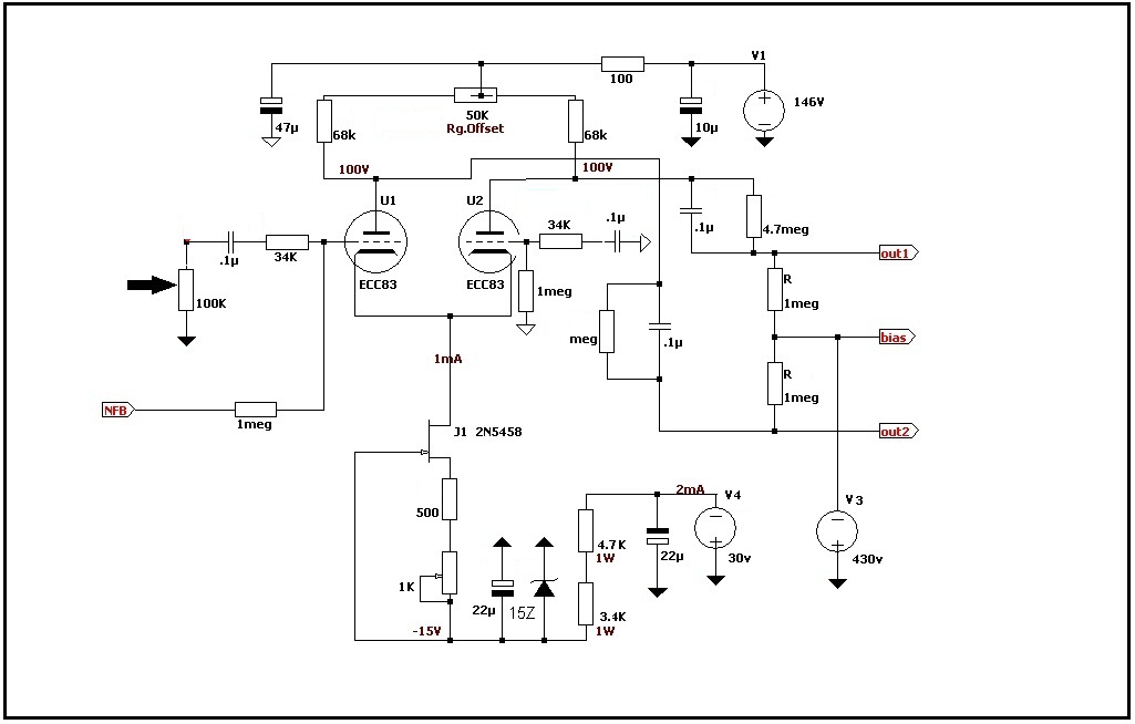

Could you suggest me how to creat a stand alone -430VDC?
How did you separated HT1 and HT3?Did you change annything in the PSU ? I separated HT2/HT4 from HT1 and HT3, then I swiched to a fet CCS instad of R7.
Victor!
It's very simple, make another small transformer with adequate sec. (ex. 150V, 350V, and 24V for CCS if you want) 15VA is enought. So you shall clean up PSU and especialy the function of ecc83.

Tyimo, here you are my -430/-15/+146V SUPPLY
FWIW that CCS circuit is leaving a bit of performance on the table. A cascode circuit will work better, resulting in more gain and lower distortion.
You must be right, but unfortunately this is the best I can do for the moment. I am not such skiled to be abble to design a cascode circuit for that purpose....but I am a dam good listener.

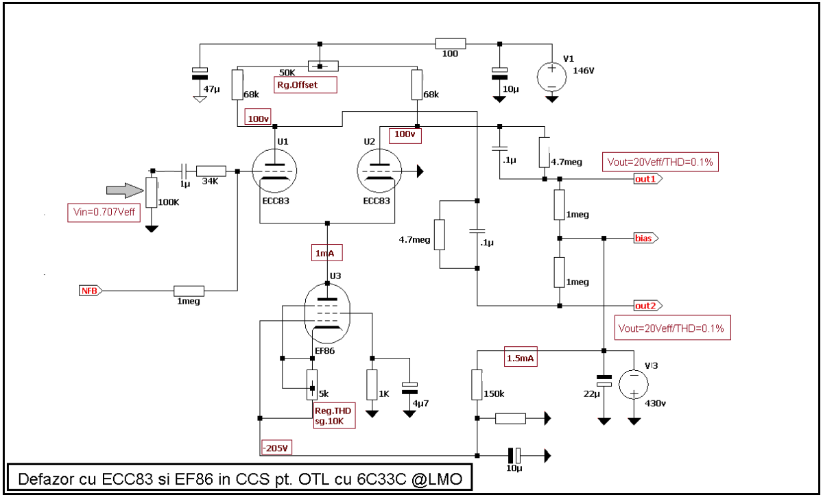

After refining what I has started ( maching my OTL with my Quad's 63 switched to 32 ohms ) I shall pass to a CCS based on EF86.
