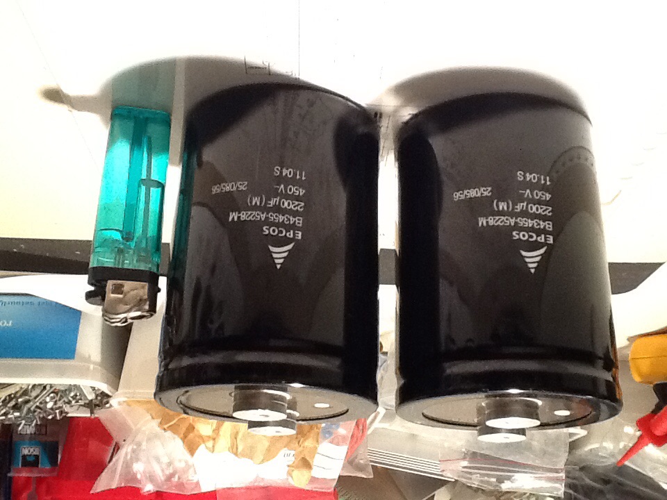

Are these caps usable for the powersupply
In a couple weeks i hope the finish my Tim Mellow design OTL 😀
Are these caps usable for the powersupply![]()
Verry good choice, nice stuff, must be formatise for best results.

All I would like to reach that the PSU could be safe to be tested regardless of any load. With the original values can not do this. The -430Vdc section without load is a bit over 500Vdc! Unfortunately I can not buy 550V ELKO only 400-450-500V.

If the capacitors are the same values, then the resistors in parallel with each capacitor must also be the same values. If the capacitors are different values, then the resistors need to be in the same ratios that you calculate for the values.
Your initial question was for 100uF in series with a 1000uF. As mentioned before, this is not a good plan, because they are too different in value. Ideally they should be the same.
However, in your example if the supply was 550 volts, then...
voltage on 100uF = 550 * (1000 / (100+1000) ) = 500 volts
voltage on 1000uF = 550 * ( 100 / (100+1000) ) = 50 volts
Note that the larger voltage is across the smaller capacitor.
The resistors would need to be in the same ratio as the voltages. In this example across 100uF you would need a resistor 10 times larger than the resistor across the 1000uF capacitor. This is to help maintain the correct voltage balance under all conditions.
