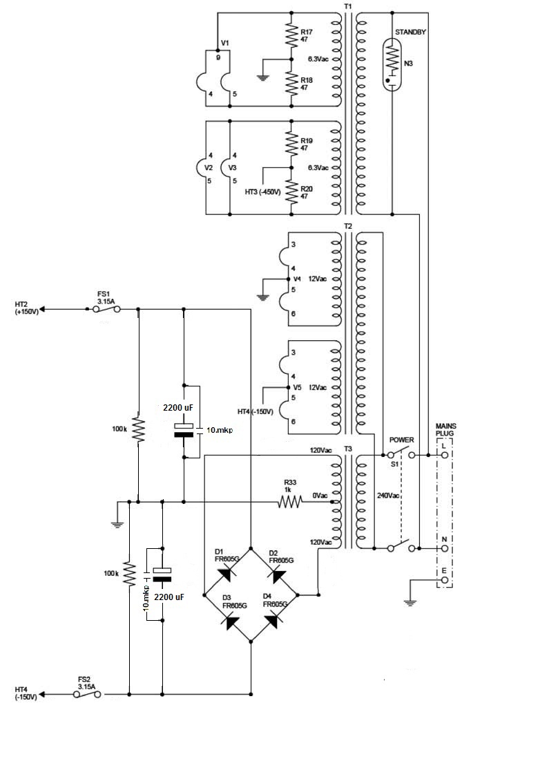

Yes, I will do that.Back to your project, as I told you before, put a 80-90k resistor accross the ht3 and gnd, than you shall not be warry about reaching 500V

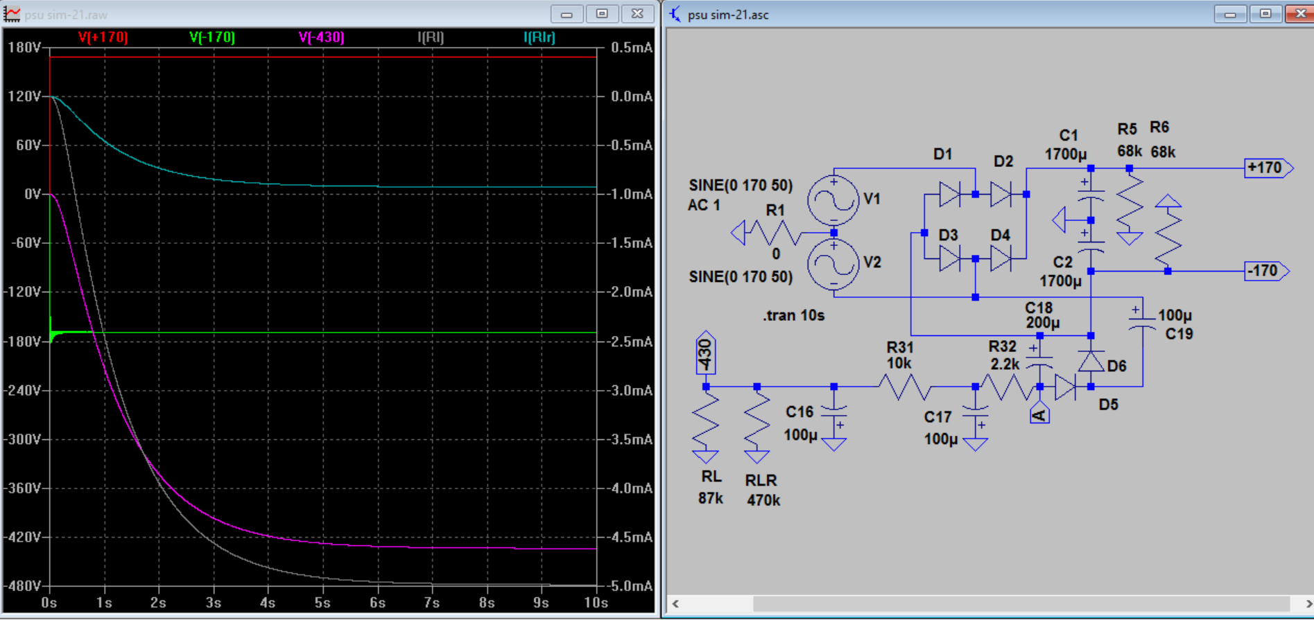

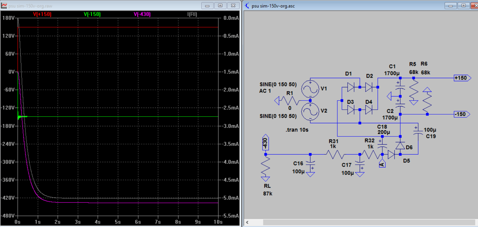

Here are at least 3 areas I can point out and why there are discrepancies.
1) If transformer is 120V then +150/-150 should be +170/-170 as 120*1.42=170. To output +-150 and -430 you need a transformer 150/1.42=105V really.
2) Your own transformer is 125 not 120, the result is near -500V, adjustment sch is attached for reference.
3) C18 should be at least 350V not 250V as specified, and in your case at least 400V.
I hope the clarification will help you and others in future/
Thanks Koonw!
Today I tried my PSU under load: 2x120Vac,260VA transformer, 50W light bulbs on HT2 - HT4 and 85K/5W resistors on HT3. I got:
- 2x 123Vac on the sec.
- 166Vdc HT2-4
- 485 Vdc on HT3!
I think it is still to far from the needed values in the original schematic. So probable I have to adjust it. Thanks for your suggestion and schematic!

Usually transformers made with a bit higher voltage than the nominal voltage, so that under load they could give the rated value...., but sure you know it.2) Your own transformer is 125 not 120, the result is near -500V, adjustment sch is attached for reference.
- 166Vdc HT2-4
- 485 Vdc on HT3!
All my caps are 500V in the -430 line c16,17,18,19. , but anyway I Thank you for the warning!3) C18 should be at least 350V not 250V as specified, and in your case at least 400V.

You definetly need 117-119 V on your sec. If you have thoroid transformer, the only way is to add some winds and put in series with the primary in order to change the ratio primary/sec. It's a practical trick.
In case you have the specs of the trafo is easyer, if not, find out the no of winds/volt...by winding 10 winds and see what you r

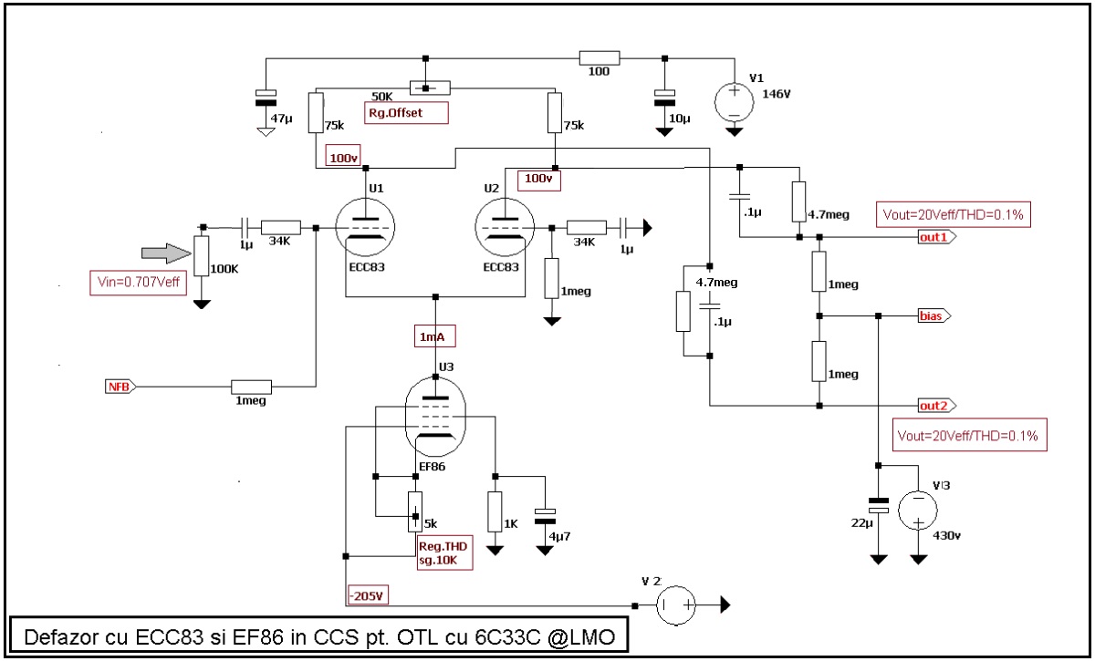

This is what inspired me, but is still to work on
A pentode can be an excellent CCS. However, I would get rid of the balancing pot in the cathodes of the differential amplifier! It causes more problems than it solves! If your CCS really works right then the AC balance pot won't be all that useful.
You must be right about the pot in the cathodes, I shall try this one (attached) with the pot in the anodes, just in case I must adjust the DC offset . If not, I'll live the 100K anode resistors as Tim's original design. Without the ccs, the pot in the cathodes is verry effectiv for the output DC adj as well as +/-150 raills equilibration.
Victor
That looks better... I would consider biasing the screen and control grid of the pentode with zener diodes. This will better allow the tube to reject noise from the B- supply. This would require that the cathode resistor be a separate circuit from the control grid.
Right now I am experementing the 2sk117 CCS , but next, I'll keep in minde your advice for the next step pentode ccs.

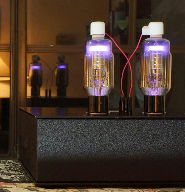

I am planning my projects for the summer and this amp is next up. However, I want to use 2 3b28 half wave rectifier tube. How would I wire them?
