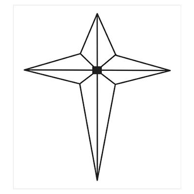

I dig XRK's four-pointed star shaped symmetrical aperture ... That could work on a Karlflex too , hmmm
Could extend the bottom point of the aperture forming a Christ's cross shape making those cabinets highly marketable to churches...... and gothic dance clubs 😛 ... haha
Turn that same bass cabinet upside down and sell them to metalheads and metal /deathmetal venues!
BRILLIANT !!!
(Brilliant! get it? thats a star pun , hehe)

some internal reflective paint and disco lights inside and that cross would fly!
LOL !
Every cool and hip modern church should have a herd of these!
