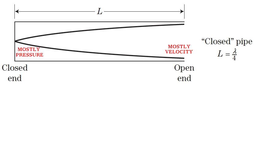

Once again (in regards to resonant pipes) the air particle velocity is not the same at all points in the path ... So if the constriction is mid-path it is possible that there is no chuffing or distortion being generated to begin with .... You are correct though in saying that there would be masking (if there IS any chuffing or distortion to mask that is) ..... I am not disagreeing with you Jag , i am just saying there may be another important factor to take into account .. thats all ...
Velocity at mid-path could be considerably less than what Flare it or HR predicts for the end-of-path ...

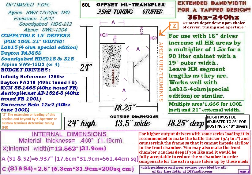

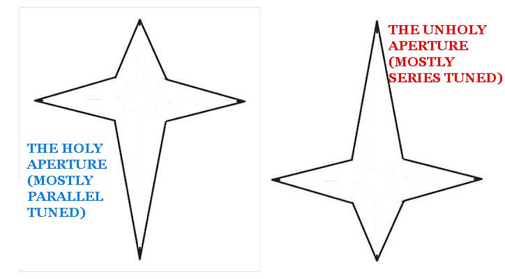

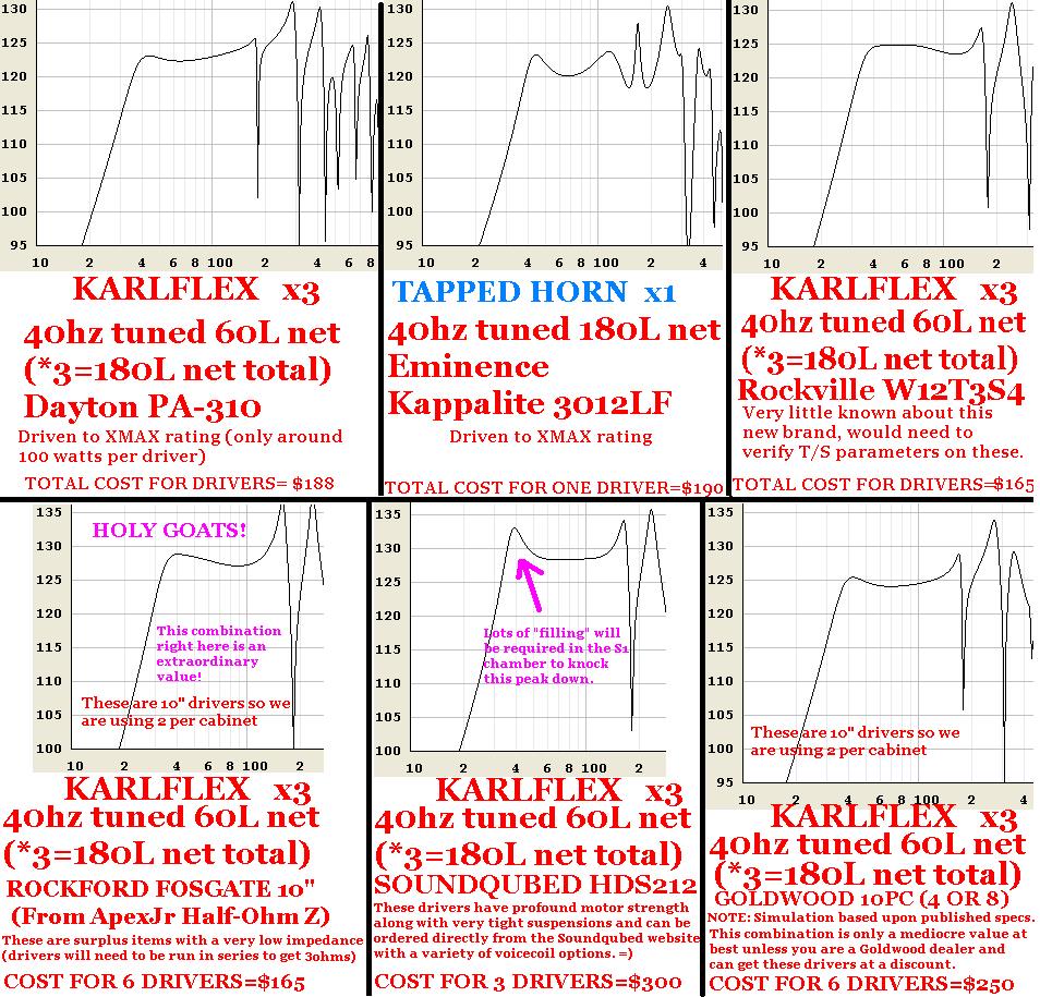

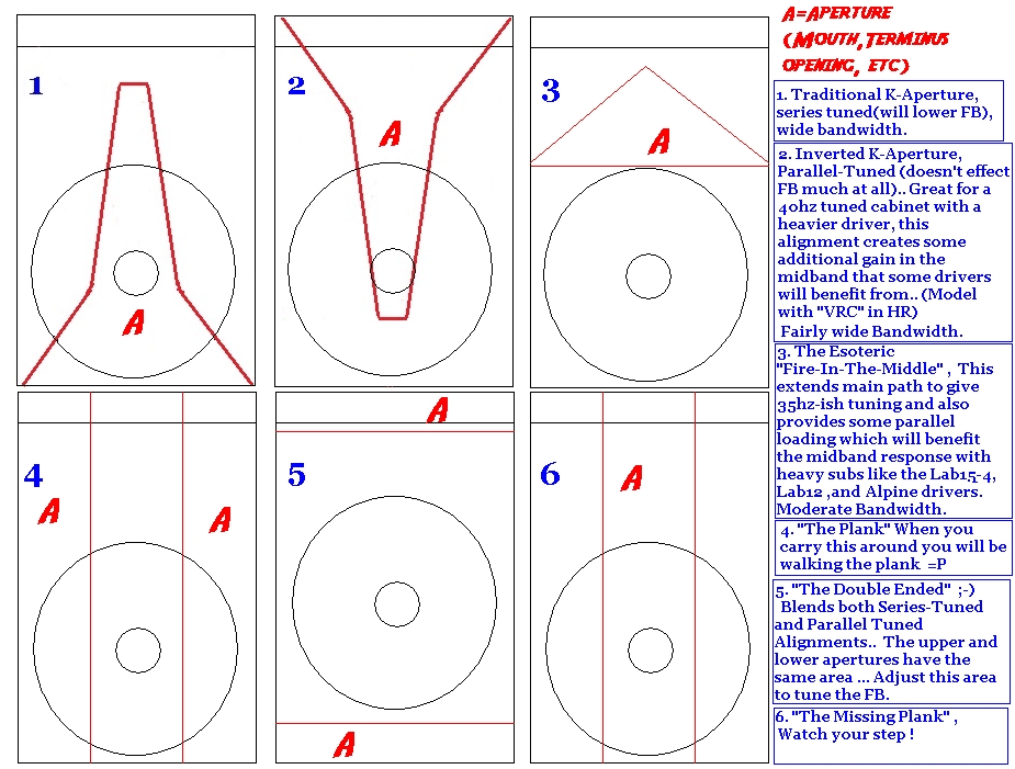

UPDATED SKETCH WITH MORE DETAILS,GRAPHS, COMPARISONS AND APERTURES
GENTLEMEN,
This Karlflex can be a very practical, versatile, portable and economical alternative to other alignments even competing with a well known compact performance leader like the tapped horn... Careful choice in drivers makes this possible
... This design really excels in the price/performance department with affordable drivers and cabinets used in multiples. I had mentioned all of this before but i wanted to show some comparisons to illustrate what i have been trying to describe.... 🙂 There are separate graph collages for 25hz tuned cabs and 40hz tuned cabs..
I also filled in some more detailed information on the sketch and threw in a few more ideas for apertures .....
Envision the following "herd": Utilizing one of the more extraordinary examples given here you can build 6 boxes each loaded with two surplus Rockford Fosgate 10" drivers from ApexJr for a total of 133db in halfspace or 143db in 1/8th space for only $330 spent on drivers (although im not sure what Steve would charge for shipping on those) ... Imagine 3 boxes per side (or put together in one big cluster if you like) with a 3 ohm load per channel, of course this would also have to be 1200w per channel at 3ohms to drive these to full capacity but that is a heck of a lot of sound for a relatively small amount of money ..... Combined net is also only 360 liters for all 6 cabinets! The combined cone area of around 4000 sq cm is certainly nice 😀
OFFSET ML-TRANSFLEX -35hz-60L-LAB12-OR-SWS-12D-24inch-150-cm 40hz or 160cm 35hz Path-Small-Front.jpg506.4 KB · Views: 248
There's no need to guess or speculate what the velocity might be, just run the sim through Akabak. You don't even need to learn to write a script, just export your Hornresp file, import into Akabak and evaluate.
Anytime you create a pinch in the line there's going to be higher velocity, there's a reason you need to avoid this in air compressor lines, it robs power. In enclosures the highest velocity section of an unpinched line is at the end but that doesn't mean velocity can't be very high at pinched sections further back from the mouth.
Flare It doesn't simulate velocity, it just tells you what velocity is acceptable.

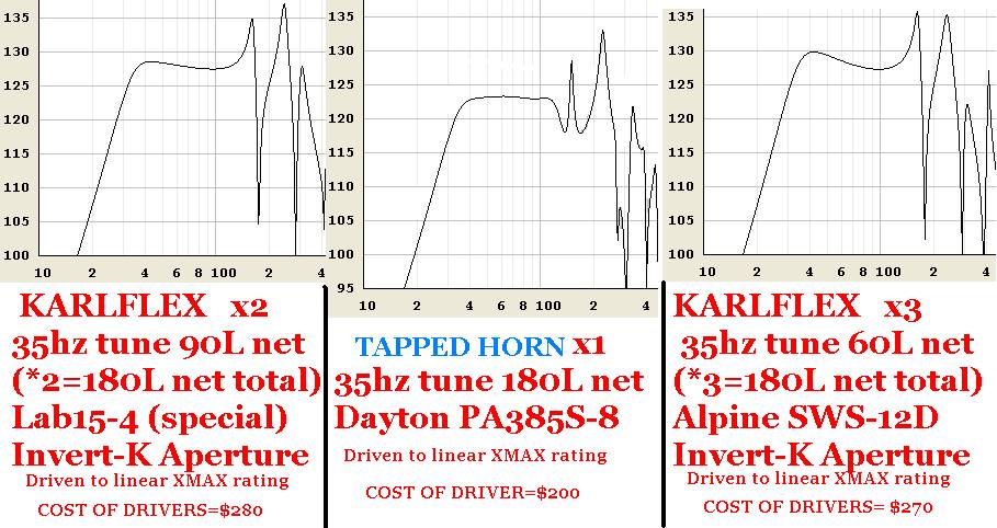

Correction
That was of course supposed to be "separate graph collages for 35hz and 40hz tuned cabs" =/
GENTLEMEN,
"separate graph collages for 25hz tuned cabs and 40hz tuned cabs.".

Suggestion for JAG

I do not know how much the actual velocity is reduced in the middle of a 1/4 wave line but I can say the terminus of that line better have significant cross section to prevent, well lets call it choking just to differentiate.
I just want to try and point out that there are more problems with reduced cross sections than a whistling sound.

- New sub design? Constricted Transflex, simple build (series tuned 6th order)
