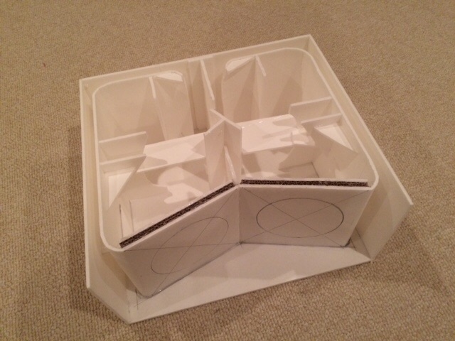

Dual W5-876SE XKi sub completed.
YOU ARE SO FAST!
Looks good ! , how does she sound?

Thanks! I have not had a chance to listen to it other than maybe 2 songs as I had to run. I crossed it over at 200Hz (-48dB/oct LPF) in a FAST system with an XKi RS100-4 on top high passed at 200Hz (-24dB/oct HPF) and it sounded very nice. Deep articulate bass that surprised me. I put a lot of care in using rounded entrances for the vent and a rounded turn. Maybe that is helping the sound quality. I also used copious amounts of thin foam core bracing. The box is quite stiff for a 1 lb sub woofer enclosure that is 3/16in thick walls. Here is a detail of the internal channels and bracing.

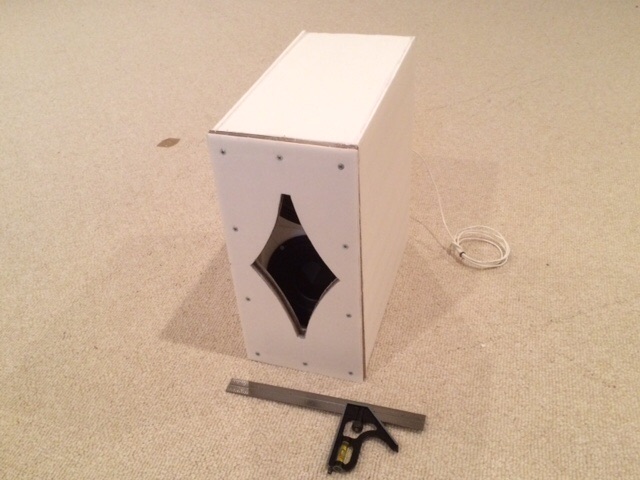

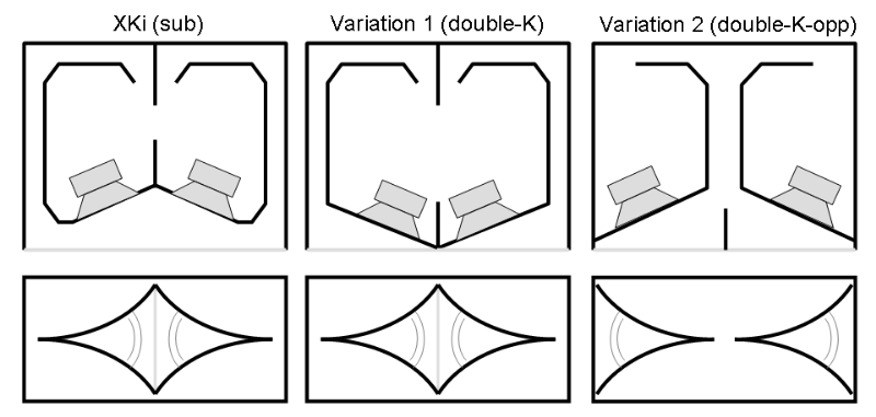

Hi X,
You did it again. Hyper fast work & amazing result. Why hasn't Bose given you a job?
Looking at the diagram and your foamcore cab, I can't help thinking about the shape of original Karlsons. The orientation of the slant and the opening of the aperture are different from yours.
I mean, in a Karlson slot, it's deep at the slit and shallow at the wide opening. Is there a reason for it? Does it have better coupling between driver and port because the larger waveform of LF is forced its way out? I'm wondering.
So, here are some more combinations:
What do you think?

CLS,
You have some good questions here. I made the XKi sub the way it is because I wanted the drivers to focus their power at the exit aperture which is centrally located, and I wanted the sound from the feedback ducts to first pass by the drivers at a closer distance to effect the bandpass cone motion control to a greater extent. The simplified model that I have ignores all of these finer effects and one would need to use a 3d model like ABEC3 to capture the essence of the questions you ask. Although if I split the front chamber into multiple segments to capture the variation in angles and the splitter in the middle, it will probably produce a different result. I like both of your alternate proposed topologies and they would probably work. The last one is similar to the PPSL bandpass subs I have designed in the past with exception that you have a double aperture on the exit. Variation 1 would probably be best to get the highest amount if HF bandwidth out if you were operating it full range rather than a sub.
