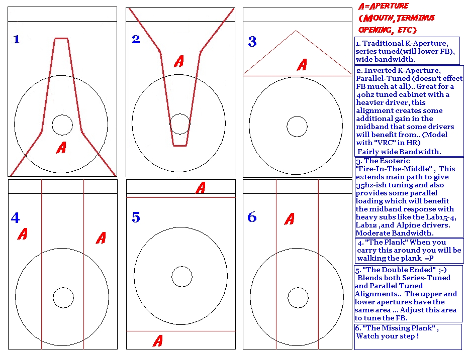

I just realized that i reversed #4 and #6 in the multi-aperture sketch .... Oh well, no biggie, you guys get the idea 🙂
update
Ok , it is all fixed up now 🙂
dunno if my rough sketch of an aperture would be better or not - hopefully you can try a couple of different openings to observe pros and cons.
You might try the double-ended combined with a circular fire-in-the-middle aperture centered on the driver centerline. This will give deeper bass and great cone control. I have built this and it pulls tuning about 10Hz lower than with the vents and no exit aperture plate.

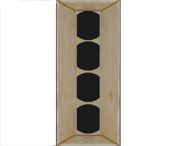

Hi MMJ and chris661,
I agree, the Beyma 15P1200Nd/N would work in a TH, but it also works very nicely in the KARLFLEX T-TQWT.
If you take the drawing from Post #1040, and multiply the width by 1.21 you get an external width of 16.335", which is just enough to fit the driver if you use 15/32" plywood. The external volume now is 122L/4.3ft^3.
By the way, the aperture will have to be determined experimentally, but, I like the one in the drawing. That or a similarly placed Keystone. I just don't have the time right now to work out an AkAbak simulation for that one.

Hey there🙂
Yep , Tb46 is right , a custom width Karlflex works well for your driver Chris ... In that scenario i would open up the "C" (S3/S4) area some, probably to about 3" (instead of 2.5") , allows for better airflow with that high powered driver and also gives a higher FB which will be closer to your target of 35hz in a series tuned (Aperture option #1) Karlflex ....
Also as TB recommended previously you can double the thickness of the baffle and countersink the driver's frame so that it doesn't stick out so much reducing any risk of problems with airflow through that area (could be a critical factor when using this design in it's series-tuned configuration) ... .
Stuffing , in the S1/S2 region (as depicted in sketches) will really help to knock down that peak at FB , and will also spread out the peak in air-particle velocity , reducing the likelihood of chuffing at around FB ........ Even the 90L (19" wide) Karflex works with your driver if you use enough S1/S2 stuffing to knock out the peak , it is just a little larger than you really need, and since you shlep boxes around via taxi smaller is better🙂

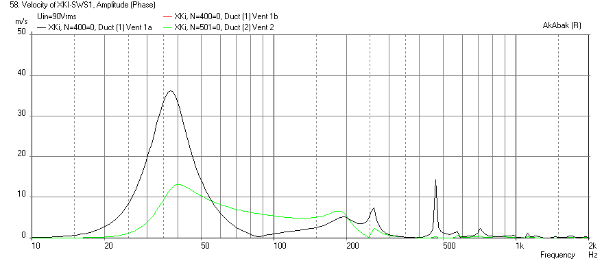

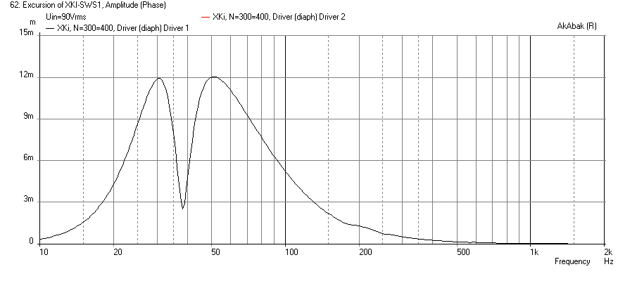

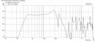

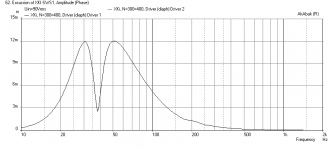

C&P,
I managed to dig out my ancient laptop that has Akabak on it. So I managed to sim your case of using two SWS-10D4 drivers in a 100 liter or smaller box with 35Hz (f3) and maximal SPL output.
The design I came up with is similar to an XKi but with dual vents to reduce air particle velocity near resonance. Make the box 13in wide internally and make the rear chamber 60 liters and the front 30 liters. The vents are 13in wide x 1.5in tall x 28in long (qnty 2 vents). The drivers are angled a bit to prevent parallel-parallel interference. The output aperture is equivalent to a 13in diam round hole.
Here is the predicted max SPL at 12mm displacement (I did not want to go to actual xmax levels to keep it linear and to have head room) at 90v RMS. It is a 125dB design with -3dB point at 35Hz:
Here is predicted cone displacement with a 30Hz -24dB/oct BW high pass filter to avoid over excursion:
Here is the particle velocity in the vents and output aperture - it hits 30m/s in the vents but this is shaded behind the Karlson aperture so I don't think it is a problem:

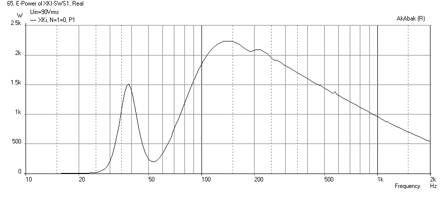

Here is the electrical power input - about 1.5kW:
Here is the code:

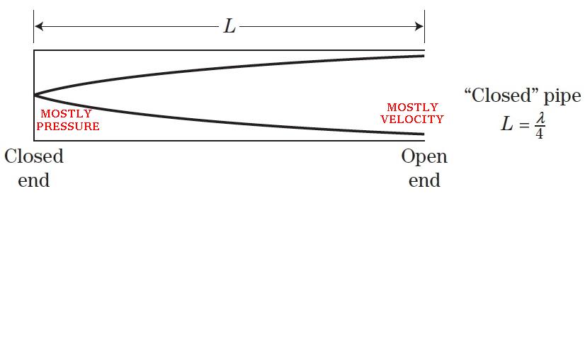

Palsa,
Thats exactly how you could do it 😀
Here is the clever part though
So the moral of the story is that keeping the constriction at 2.5" in the middle of the path is fine (and keeps you from having to make the box taller in your case) and then opening up the S4/S5 area ( which is the "aperture" in the series tuned Karlflex) can be the secret to your success!
When the main squeeze is in the middle of the path it does change the damping behavior a bit but that should be perfectly fine with those Alpine 10s , they have very strong motors and will respond well to the extra damping ...
This strategy would also be effective for Chriss661 since his Beyma driver prefers an alignment with more damping for a flatter response along with better airflow near the end of path for higher power handling ...
