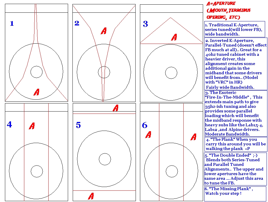

APERTURE OPTIONS AND IDEAS, not perfectly drawn but you get the idea
There are many different ways to arrange the aperture on the Karlflex , some will extend path and some will add parallel loading (which is great for heavier drivers that need improved midbass output), some will create a mixture of both series and parallel loading .... Some will have more bandwidth and some will have less ..... These could all be considered "tapped" to some extent , because even in the Parallel alignment's case there is a shared mouth/terminus/Aperture where a short path and the main path converge before exiting the cabinet ...
Keep in mind that the FB is right around 40hz with no panel at all on the front of this 24" Cone-forward Karlflex, so in order to get down to a 35hz FB (or lower) there has to be some amount of extension to the main path which can be provided by the front panel , but it doesn't take much ... All aperture options depicted in the rough drawing (with the exception of option 2) add some amount of path length to the main path .... The amount of shift in FB will depend on how large you make the aperture (or the two apertures in some cases) , and (or also) where you place the aperture as with option 3...
I am sure there are many other ways to arrange an aperture, these are just a few off the top of my head ... Would be fun to have someone make a variety of apertures and measure the response of each one ... I will probably do some amount of this experimentation when i build the Karlflex boxes for the PA-310

I'd be cautious about inviting wheezing - - a roundover on the inside edge of the aperture with rasp/file/sandpaper or router would help. In a regular Karlson setup, the baffle is angled back so there's greater cross-sectional area behind the narrow-upper portion of the slot.
Ahhhh yes , good suggestion
