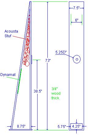

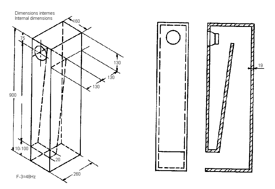

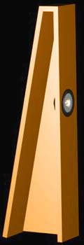

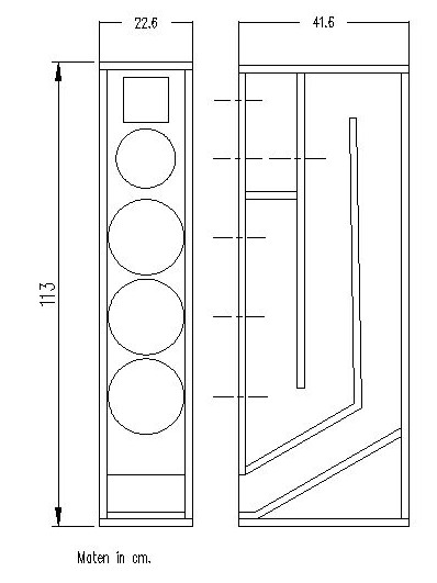

Other offset examples
These sorts of offsets are nothing new by the way .... They have been used for a long time, just usually not with the tapped variety of designs ...
Here are some examples of other people's designs with offsets ...... Many of these are mass loaded as well .... Between the offset and the stuffing these pipe's harmonic ripples are reduced enough to allow these guys to use the full bandwidth of the driver ...
"Spanning" a bunch of drivers along the line can also give you an offset effect and is thought (assumed) to have additional benefits regarding spreading some resonances around and making the drivers seem like they have a slightly lower Q , allowing an even smaller box or more drivers stuffed into the same box but i haven't been able to confirm that for sure even though i have built a few spanned boxes with high Q drivers and i did like their sound despite the uber cheap drivers i happened to use in those experiments 😛

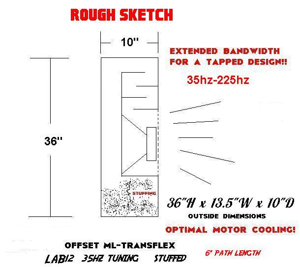

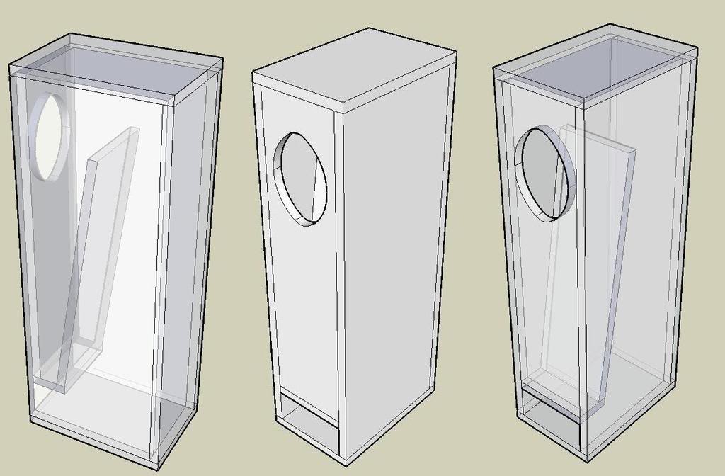

Palsa , i actually got the box size down to about 60 liters net which is pretty darn small for such a thing, it will be really interesting to see how it competes with your larger reflex box ... In simulations it shows an advantage of 3db right? I am looking forward to seeing your measurements and hearing about your listening impressions too ..
When you are ready to build let me know and i will crank out a more detailed sketch ....

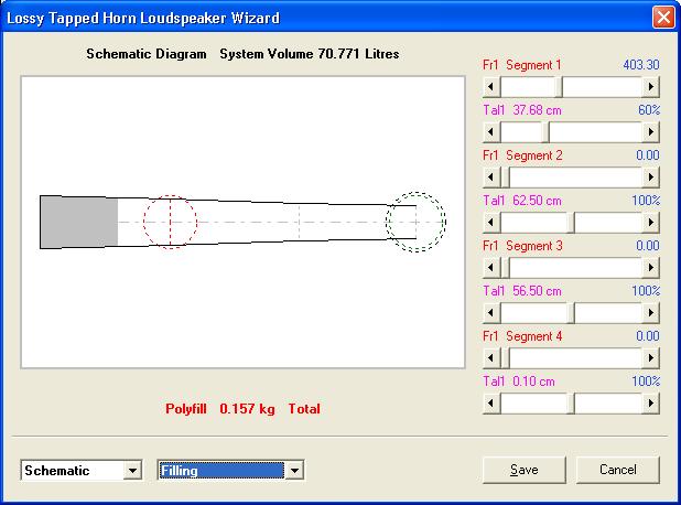

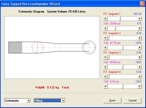

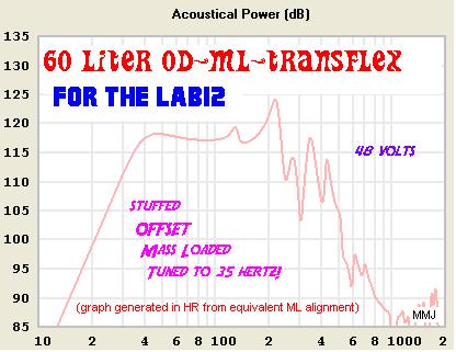

In the meantime , take a look at these approximated equivalent HR sims ..... Like i had said before these extremely long bass waves don't really know the difference between a drawn out tapered style mass loading scheme or abrupt steps, they pretty accomplish the same results and response ends up being pretty much the same (for an identical cabinet size and tuning of course) ...
At the smallest point in the path i found that it is best not to go any smaller than about 200cm sq (with this driver and arrangement) or the particle velocity is increased too much .... So i'm sticking with 200sq cm at the point of greatest constriction which still keeps this cab's particle velocity rating below that of Saba's Alpine ML-Transflex cab (which never had any issues with chuffing at full power) so i feel confident that it is within the safe range for this type of design...
Note:
The tiny chamber (VRC & LRC) i threw onto these sims was an attempt to emulate the effects that the shared (series and parallel) mouth chamber would have upon loading in the midbass range, so there is 10 liters of redundant space in the sim that doesn't need to be figured into the actual box build which is 60 liters net , not 70 ....
You can see one schematic is stepped , the other is just a taper .... Response is the same for both ......
Driver tap is located halfway out of the end of the box because that is what best simulates our very conservative amount of tapped effect in this ML-Transflex alignment ...
P.S. You have to view the response in "Loudspeaker Wizard" in order to see the effects of the "filling" ...
That looks pretty awesome for its size... and if you wouldn't mind, just a few more dims in the pic you posted would be all I need! then a SolidWorks model for everyone would be my duty =)

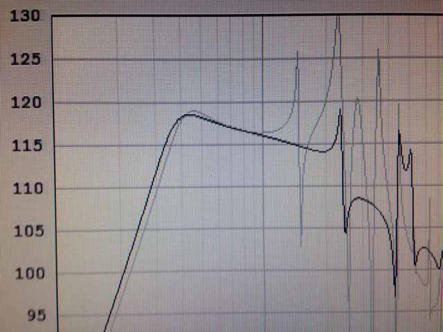

I've found something slightly depressing just now =( it seems there was some discrepancy between WinISD and HornResp. Now that I've simmed my LAB12 bass reflex as-built in the program I am getting this response with an identical 300W input per cab ImageUploadedByTapatalk1421208306.434735.jpg
It should be noted that the OD ML Transflex (grey trace) is doing it with 20L less and if there is any substantial motor cooling, I might be able to get more power into it. I would still like to build that box! Is there anything wrong here? HR shows my 1W (into 6 Ohm for the LAB) as 91dB at 100Hz and a peak of 93.8dB at 43.5Hz which seems a little optimistic for that driver in a BR...

Palsa,
There have been times when i have had optimistic looking simulations for bass reflex boxes which show great VIRTUAL output around FB , but when actually built and tested have disappointed me .... Unsatisfying .... Didn't live up to the sim for some reason *shrug* ...... Personally i have always had more consistent results with boxes that have at least some amount of useful quarter wave (standing wave or eigenmode) action ..... Which ironically (especially in the ML cases) can be very similar to a bass reflex box with a stretched out aspect ratio ...
:magnify:
I suppose i am probably biased though because i haven't bothered to build or design a strictly helmholtz design in a long time after my last few experiences with them ...
I also tend to stick with drivers that have relatively low VAS figures, higher FS figures, and a Q that isn't terribly low for use in these Transflex and similar designs .... The Lab12's T/S parameters are not what i would consider ideal for these types of boxes but according to sim it will work.. Hopefully it will work as well or better than the larger reflex box but we really wont know for sure until you or someone builds one, listens to it and measures it ...
Today i hope to finish the more detailed sketch 🙂
I can't wait to see it and model it!

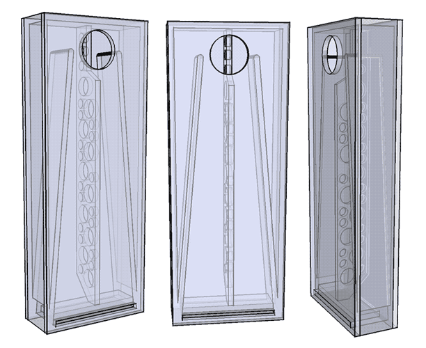

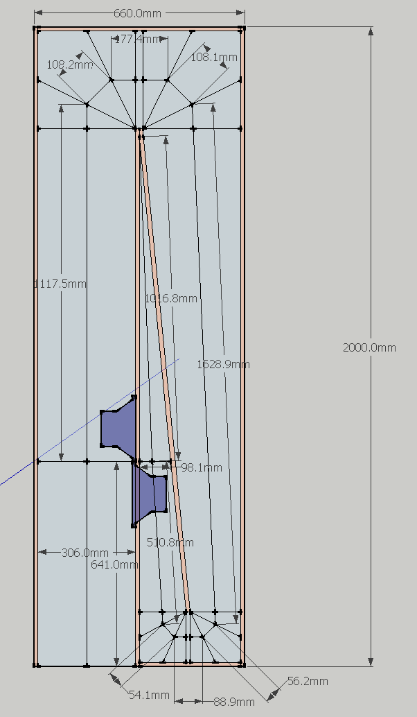

Hi Y'all,
I couldn't make the simulation fit the desired dimensions as in the sketch, but here is my first try at it. You can always reduce the height a tad, or move stuff around inside the box to optimize it, but basically this is it, and w/ a little filling it sims OK. Make sure that the speaker fits through the mouth.

WOW !
Good job TB46 , i really like what you did there! 🙂
I was going to give it a shot with 90 degree angles and steps, but yeah , if everything doesn't quite fit right the insides might have to be rearranged a bit or outside dimensions changed a little ....
