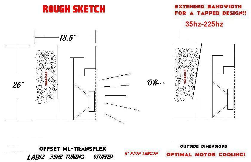

Concept fold , getting closer to a final product =)
I just wanted to show everyone what i had in mind .... I wanted to make this more cube-like but had to settle for a square footprint and a little less height which is a step in the right direction ... The 20" height didn't quite produce enough path length with this fold style , so had to fall back to 26" ...
Still working out the final details .... This sketch shows a stepped version, and also a version with one tapered panel for those purists out there 😛
Offset point ends up being between 60 and 70 centimeters depending on how it is calculated and the compression ratio on the driver falls into the right range...
Still working out more details ...

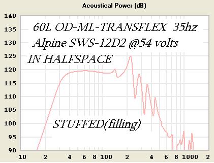

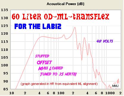

Palsa ,
Here is the comparison between the Lab12 and Alpine SWS-12
I wasn't able to overlap the two drivers on the same graph (using "filling") but you can get a pretty good idea of what is going on by looking at the screenshots since we aren't really splitting hairs with this comparison ..
Other benefits of the Alpine that i haven't already listed are the reduced mounting depth, and it's Santoprene surround (resilient even in a harsh environment, long lasting )...
The only concern i would have with that driver is mechanical noise at high excursions .... SabaSpeed mentioned that he had one of the SWS12s with some very noticeable mechanical noise, i think he said he sent it back for a replacement, maybe he can tell us how that all worked out ...
Wow! It looks like I may have to go for the SWS and keep the LAB12 around for a FLH if Saba can confirm the mechanical noise has gone away

Fantastic work TB46 !
That looks really good 🙂 Path length
I think you may have nailed the single fold design for this cab, even compensated for the airspace taken up by internal panels .... Very nice indeed🙂
I fiddled around with the single fold idea the other night but gave up on it
It is super cool for people to have a choices between tower style or shorter & stout build options for this alignment 😀
Thank you for going through the trouble of making these fantastic sketches ..
So much teamwork happening here , i love it!
As they say, It takes a villianage 😉
