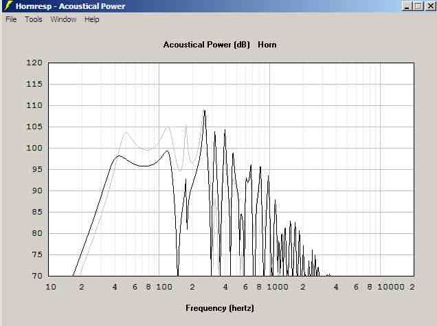

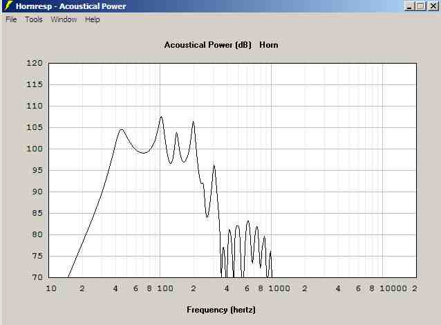

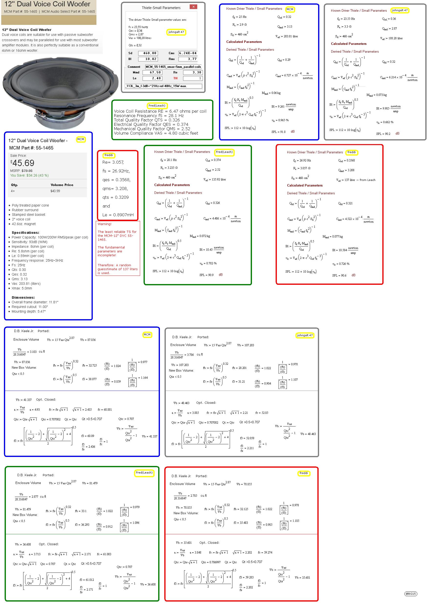

Just a quick look @ the MCM 55-1465 in the THAM15 and in straight tapped QWT of 100L. I'm attaching both Hornresp export files. That doesn't look bad at all.

Hi Oliver,
I think the Driver has a frame width of 12"(11.81") at max?
b🙂
Hi bjorno,
You are correct. I like your example calculations. Thanks.

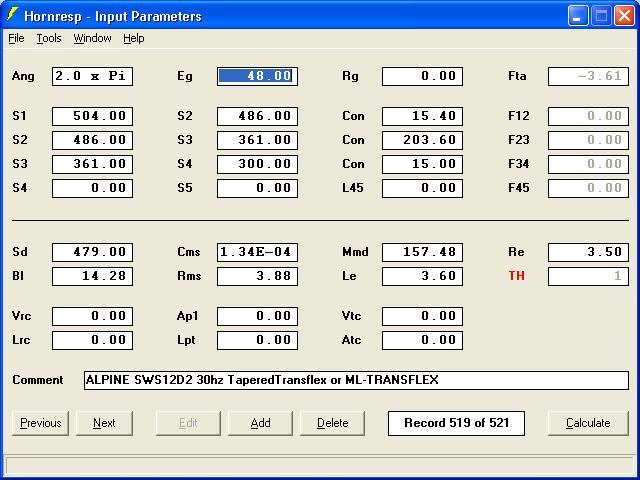

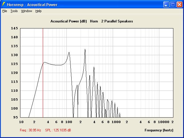

So your amp will do around or just under 500-ish watts at approximately 5 ohms per channel which is PERFECT to drive two Alpine SWS-12D2s at the measly cost of $99 per driver 🙂
These particular drivers work extremely well in tower-ish 32hz tuned 100 liter ML-transflex boxes or Tapered-tapped pipes (sort of like a reversed Tapped Horn) they are pretty much equivalent in this case .... The boxes are rather small considering the extension and output .....
These two cabinets will get you almost 125db from 30hz-120hz
48" tall with a 13.5" wide x 12.5" deep footprint
Easy build ,
A little bit of stuffing at the closed end is advised ...
Using the "magnet in" arrangement is also best to make everything fit properly and to also avoid the mechanical motor noise that Mr Sabaspeed reported with these drivers (only an issue with an exposed motor)...
If you still wanted to use your Beta15s for something (do you have second one?) you could put them in small sealed boxes and have them provide the midbass in your mains unless you already have that covered ...
I will post some data for those subs....... Let me know if you like this idea and i will make a few sketches for you 🙂

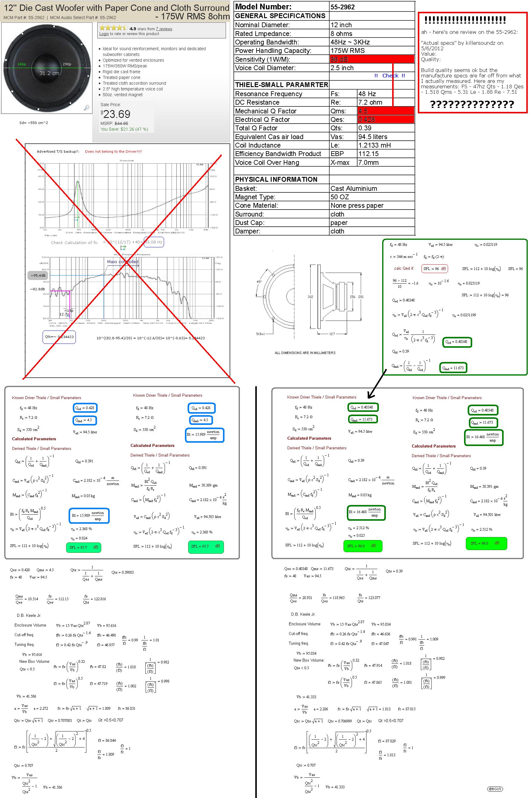

hi TB46 - I bought that MCM 55-1465 in March 2012- - not tried that other MCM - ah - here's one review on the 55-2962:
"Actual specs" by killersoundz on 5/6/2012
Value:
Quality:
Build quality seems ok but the manufacture specs are far off from what I actually measured. Here are my measurements: FS - 47hz Qts - 1.18 Qes - 1.518 Qms - 5.31 Le - 1.88 Re - 7.51
its strange that MCM has that one (55-1465) DVC woofer which basically meets specs - wonder who builds it?

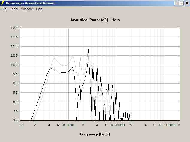

It looks like the design in post #742 should work well for your MCM 55-1465 driver ... http://www.diyaudio.com/forums/subw...ld-series-tuned-6th-order-75.html#post4158362
The cab is tuned to 40hz ... I can try making a 50hz version too ...

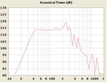

Here is a simulated graph using HR's "filling" feature at the closed end as depicted in the sketch .....
One graph has a little bump on the top as i attempted to simulate the small amount of additional loading on the high end due to the shared mouth chamber (series and parallel tuned simultaneously, almost Karlson-ish) ......
At 100 watts it does go a little past it's rated excursion, a 50hz version might fare better in that regard but this looks nice and flat 🙂

Hi bjorno,
P.S.: Do you have any experience w/ the 55-2962, Post #838?
Hi Oliver,
No, But I noticed a few discrepancies:
