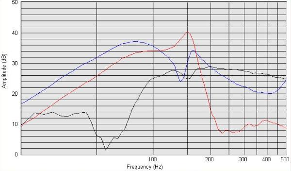

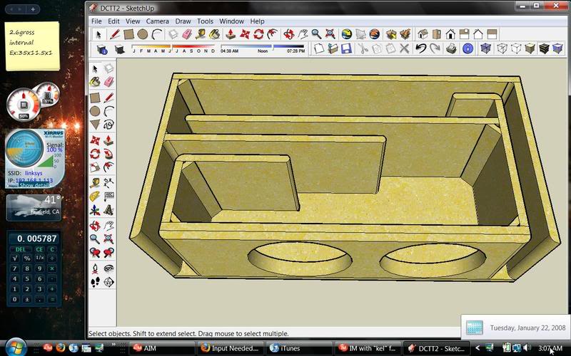

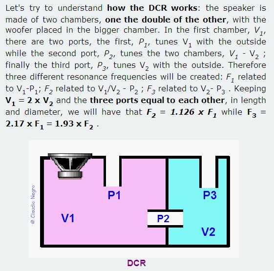

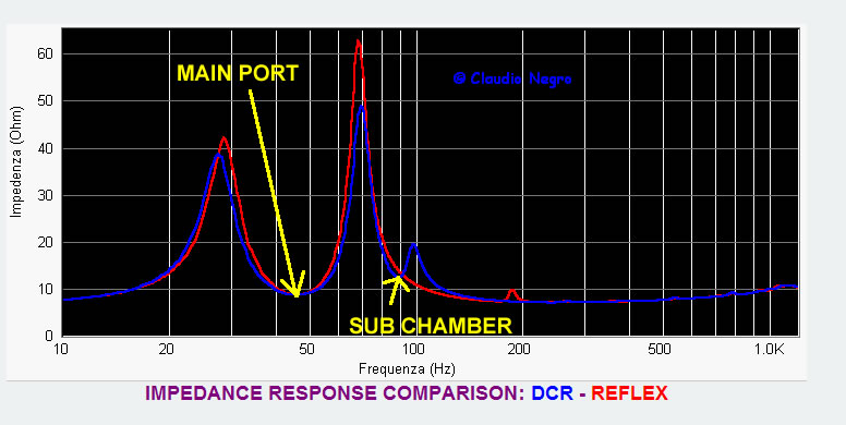

Theoretically drivers with a lack of cone area, or a lack of excursion capability can benefit from the DCR design due to the improved cone loading and excursion control, making these same drivers a little more competitive ....

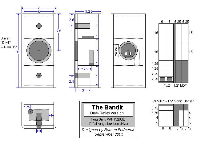

I attached some pics and data for DCRs so you can get a better idea of what we are talking about ...

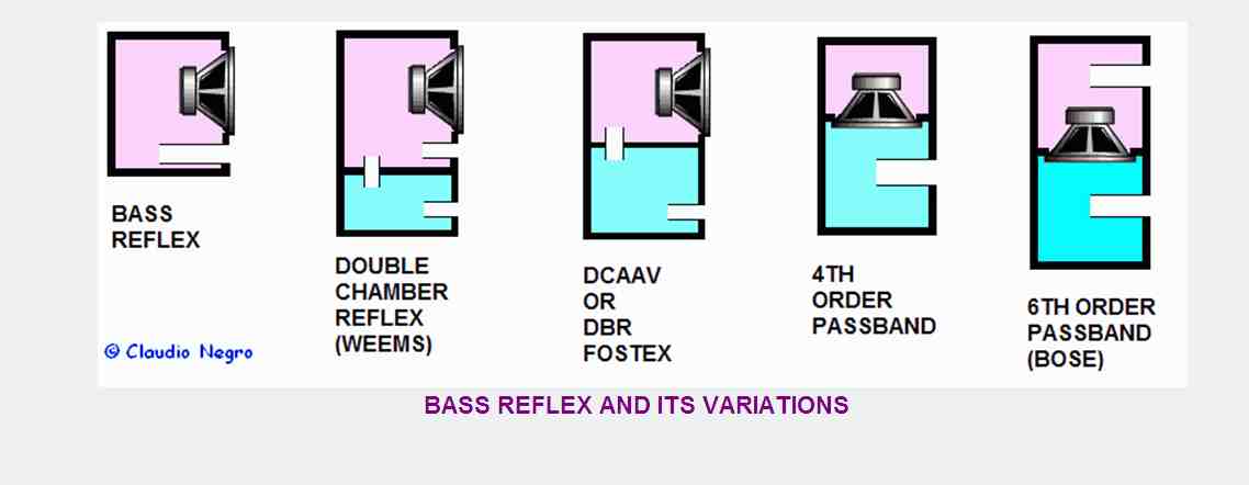

Another one to google is "DCR Claudio Negro", I see you already have some pictures from there in Post #801; I like that DCTT2 fold you are showing there, but you better make sure that the T/S parameters are correct, that does not look easily tuneable.

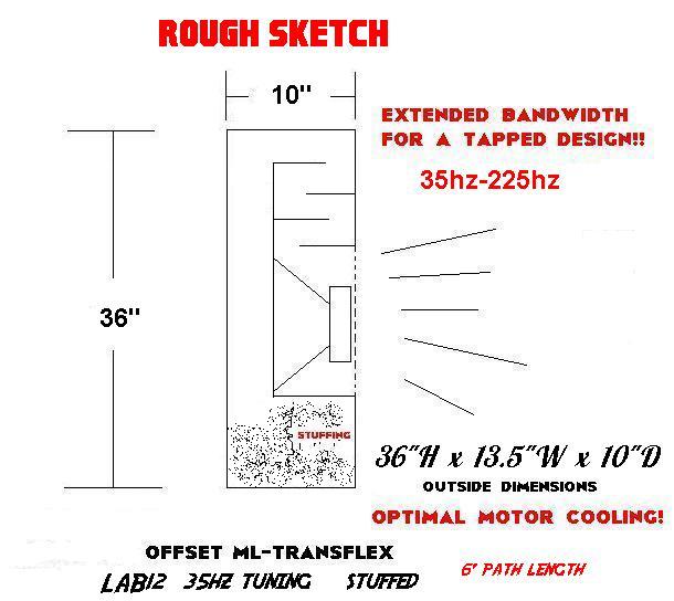

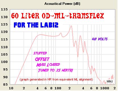

ROUGH OFFSET-ML-TRANSFLEX FOR THE LAB12, 35HZ TUNE
To give you even more to chew on
, for giggles and the sake of science i worked out a rough plan for an OFFSET-MASS-LOADED-TRANSFLEX based around your (or Luuker's) Lab12 , or any Lab12 for that matter ...
The offset and stuffing really help to tame the 3rd harmonic peak/notch allowing much more bandwidth ... The offset also allows the box to be made smaller .... This worked out to about 60 liters ... 35hz is only 3db down according to the equivalent simulation, and the reason i say "equivalent" is because Hornresponse will not allow us to simulate an ML-transflex with this kind of offset (since we are relying upon the throat chamber which has no offset) , however a tapered (imagine reverse expansion) transflex CAN be offset and is also equivalent to what we want to build because bass waves are so damn long that they do not care if the changes in expansion or taper are smooth or stepped, it simply looks all the same to the bass wave ........ Mr Volvotreter used this stepped method in a tapped horn many years ago and other folks have also used this method with success since then ...
Hopefully nobody minds that i am having fun with my pulp art fonts in these attachments
hehehehe
The sketch is rough and subject to revision, if someone wants to actually build this thing i will flesh it out and give it more detail ..
Yessir , i have read through all of Claudio's stuff trying to learn more about DCRs .... The DCTT2 was just one of the other examples i found out on the interwebz , some of those examples intrigue me because they have longer stretched out aspect ratios that are almost reminiscent of ML-TLs ...... It gives me an idea for a DCR-TL ... 🙂

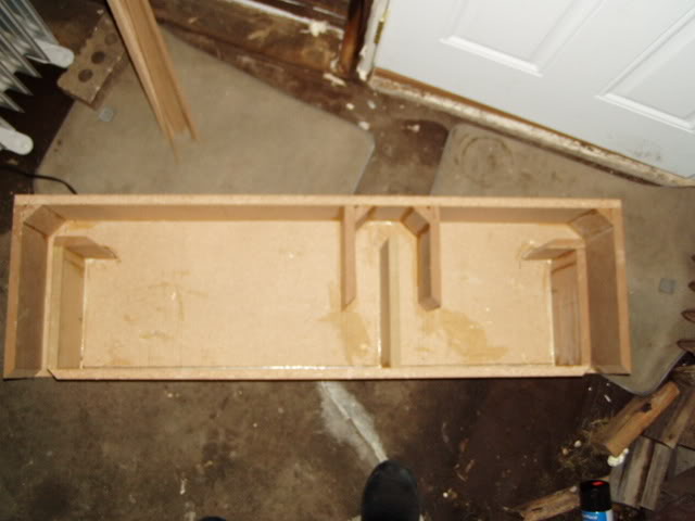

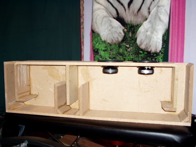

I have built several DCR's using full range drivers and they sound quite nice - very rich deep bass that is smooth and non-boomy. Using the Akabak script, the as-built DCR's measure close to predictions.
http://www.diyaudio.com/forums/full-range/252627-viva-la-vifa-curvy-cabinet-dcr-tc9fd.html

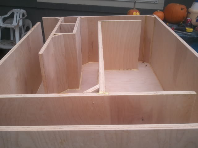

It seems like an easy cab to build indeed. I often use Solidworks to model the cab and check for volume as I go. Thankfully eminence also includes driver volume displaced on their spec sheet. I will model and post a picture for those interested! This seems like an awesome performer for it's size. My issue isn't in total output but rather making the best of my current driver and pack space. Since I fully plan on building 2 of MMJ's "LAB15 special" cabs for full PA duty, I still want a smaller cab for smaller gatherings since pack space is at a minimum for me. This bandpass box looks like it'll outperform my reflex by a few more dB and remain the same size if not smaller.
The only thing I'm fuzzy on is the 8" exit aperture. Is this 8" hole cut in the wrap around port wall towards it's end?
Thanks again!
EDIT* now that I realize a 6th order bandpass has 2 ports it makes more sense what to do. The 3/4" of ply acts as the correct port length?

They look like this, but replace the duct going to the outside with an 8 in hole in 3/4in ply facing the driver:

To give you even more to chew on, for giggles and the sake of science i worked out a rough plan for an OFFSET-MASS-LOADED-TRANSFLEX based around your (or Luuker's) Lab12 , or any Lab12 for that matter ...
Hopefully nobody minds that i am having fun with my pulp art fonts in these attachmentshehehehe
Mr. MMJ, I think you might have just given me a design =) that's a full 20 liters smaller than my reflex box AND outperforms it by a few dB. I'm guessing that's 1/2" ply? If not it will be a very tight squeeze with 13.5" outside panels and a 12" driver!
Placing the motor in the airflow path seems like it might give enough cooling to safely run the LAB12 at RMS voltage. I've read that for sine wave based music you should limit to less than "RMS" if the Pe was tested with pink noise.
XRK I haven't forgotten about you! I will sketch up that design soon and compare the finished outside volume, also a cool looking design!

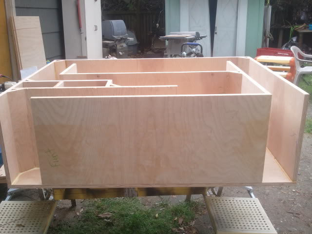

So, a quick comparison between Xrk's 6th order BP and MMJ's OD-ML-Transflex:
Using a quick Excel spreadsheet to calculate volumes on the 6BP box, I arrived at outside dimensions of 18.5" x 16" x 15.5" Thats just 75.2 Liters!
(all upcoming judgments made based on sims)
With MMJ's box, the measurements were 36" x 13.5" x 10" giving just 79.6 Liters.
Extension: MMJ's box has a slight edge, it seems by about a 3Hz lower F3 than the bandpass box. Also, the location of the drivers motor in the mouth of the sub (while opening up the possibility for motor noise) should increase power handling and heat dissipation which seems to be what this driver needs most.
Output seems to be 1-2 dB better over the whole range with 2V less input on the Transflex box.
Convenience: While the Bandpass Box was only 4 Liters smaller, this was figured using 3/4 ply. Using 1/2", the box is only 70.5L external. This, along with absence of mass loading accounts for the slight drop in output and extension I would imagine. The 6BP box is much better for laying on its side and pole mounting a top on in a corner as well (more stable footprint, ports 90 degrees to one another to direct sound at 2 walls???)
Given my possession of 1/2" Baltic Birch, I am very keen on building both boxes and measuring them =) If I have a measurement mic from my Driverack PX, will that suffice or should I look into a different model? Can anyone recommend inexpensive measurement software? (College budget!)
