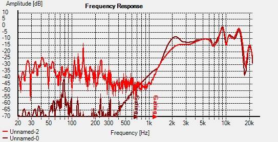

I am very keen on building both boxes and measuring them =) If I have a measurement mic from my Driverack PX, will that suffice or should I look into a different model? Can anyone recommend inexpensive measurement software? (College budget!)

Im not sure what mic you are using with the Driverack (might be good , you will have to look it up) , but i use the Dayton EMM6 with HolmImpulse (free) or sometimes TrueRTA to get my relative/comparative readings.....
I usually take my comparative measurements at very close proximity indoors (for the sake of convenience), but of course in order to avoid the influence of your room's particular acoustical quirks it is ideal to measure outdoors without any nearby boundaries (except for the ground) ........ I just never do, even when i probably should, call me lazy 😛
I have found that at very close proximity the room's influence upon your measurements are minimized, but taken to the extreme with overly intimate placement (such as mic-in-terminus) you get a sort of "proximity effect" where the bottom end of the cabinet's effective range measures a little on the optimistic side ...
So keep it apples-to-apples if you know what I mean in regards to measuring technique when doing comparisons, otherwise the results are meaningless...
Yes ... I sound like Captain Obvious, i know, but if it helps a few lurkers avoid making the same mistakes i made when i first started measuring speakers then it was worth mentioning .... .
By the way guys, CHECK THIS OUT :att'n:, this proximity effect also applies on smaller scales with midrange horns and even high frequency horns! .... For fun and demonstration purposes i will attach an overlaid response graph screenshot that i took the other day when i was doing an experiment with a cheap Piezo 1016 tweeter horn .... The red trace is the tweeter mounted in a cardboard baffle placed 1 meter away from the mic on-axis, and then the brown trace was with the mic placed right in front of the horn's mouth, no more than an inch away from the mouth ........ Of course room effects do not apply here, so it was interesting to see how the proximity effect only seemed to alter the bottom end of the device's range , everything else matched up surprisingly well ! :bigeyes:
