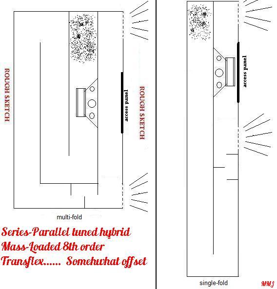

Now here is something that Karlson fans (GM, XRK , Freddi?) might already know but i feel like it is worth mentioning because i think it may lead to a new configuration for me :xfingers:...... I had an epiphany the other day about some of these Karlson cabs, they are not just 8th order but also a sort of hybrid mix of series-tuned and parallel tuned, in a way it is really BOTH simultaneously and i am now just beginning to understand how special and useful that can be :key:.... Via some amount of chamber-sharing i can reduce the size of one of these 8th order boxes without losing any performance ...... Unfortunately HR cannot fully simulate such a beast, but i can and have come up with equivalent simulations that suffice except for one aspect of it that will determine where exactly the FB will land ..... Luckily , adjusting the size of the FIRST of two mouths will effectively shift the fundamental, and that can be done easily enough after the box is built ......
I will post a rough sketch so you guys can see what i am talking about .... It is very similar to other 8th order designs i had posted here previously with the only difference being that the small pipe-chamber has both ends open instead of only one, this creates some amount of sharing (of the small pipe chamber) extending the effective path length of the box a little bit, and this is how i get the size reduction in order to get the same target fundamental ................. With the small pipe-chamber having both ends open it also raises the small chamber's resonance significantly because it will be operating more along the lines of a halfwave (like two quarterwaves placed end to end, instead of a plain ole quarterwave) raising the upper bandpass cutoff .... There might possibly be some helmholtz resonance action too, but i have to think this through a little more and possibly do some testing to be sure because right now with the small chamber that i am contemplating (30-ish liter , 60cm length , open at both ends) i am getting a helmholtz resonance well below 200hz and a halfwave resonance well above 200hz ...?.... hmmm ... curious ..:scratch2:
I realize i am stepping way off the beaten path here, but i think i might be onto something..😀

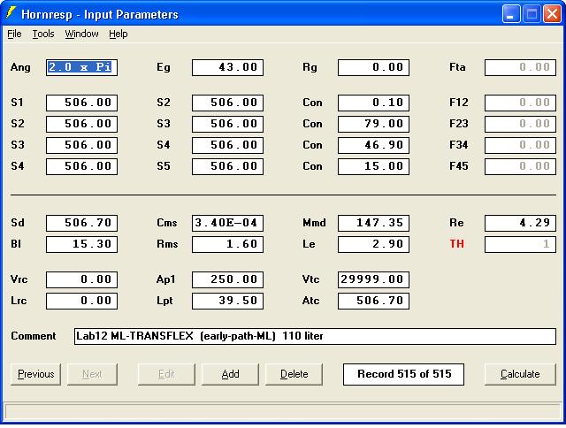

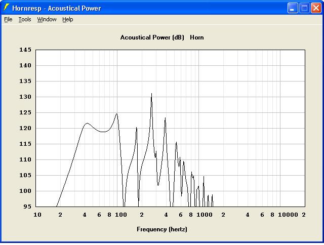

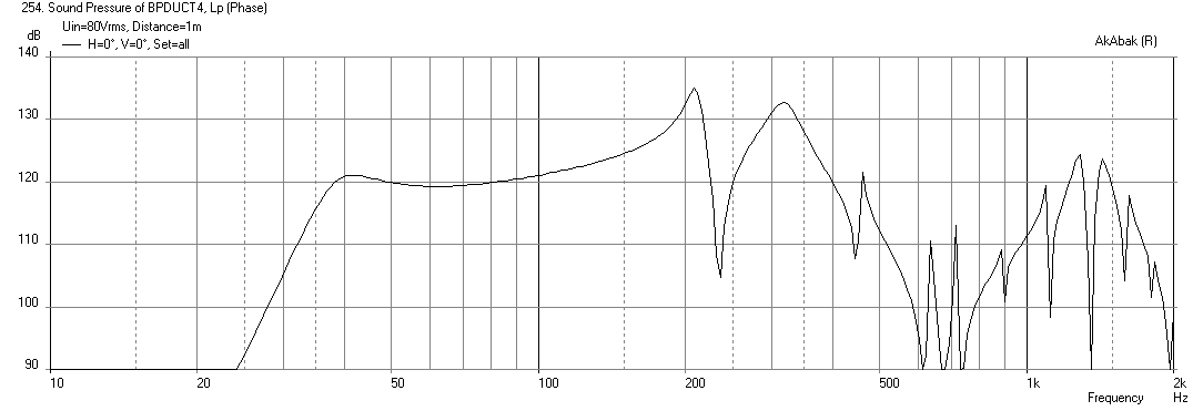

Then today:bulb: i think i found an ML-Transflex configuration tuned to 35hz that looks fantastic using the Lab12 , as long as you don't need bandwidth that extends above 100hz .......
Moving the constriction (port) further up the path is the change i made in order to optimally accommodate the Lab12 ..... The port is only a few feet down from the closed end of the pipe now (notice VTC and ATC values).... ....
Has great output for an extremely simple 110 liter box with a single driver! 😀 (however two 10S4s still do better in about the same size box, but thats two drivers not one, and this is tuned lower)
The outer dimensions seem reasonable on this tower shaped cabinet at around 43" H x 13.5" W x 14.5" D (subject to updates at this point) .....
I have already begun working on a sketch ..... In the meantime go ahead and load these Hornresponse inputs into your software to see if you like the way it performs .....
  • Lab12-MLTP.txt
    Lab12-MLTP.txt

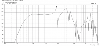

Simple quasi 6th order bandpass box with 12HP1030
If you use a Faital Pro 12HP1030 driver and make a very simple 33 liter chamber box connected to an 8 liter front chamber with a 14 in x 1.75 in x 30 in long wrap-around channel vent, and an 8 in dia round exit aperture (thru 0.75in ply) on the front chamber, you end up with a compact 53 liter (1.87 cu ft) box (including vent volume) that can produce 120 dB output (2 pi half-space) when driven to xmax of 12.5 mm at 80 volts. The benefit of wider bandwidth is possible with a small front chamber. The front chamber provides exceptional cone motion control that allows 80 volts of drive. A 34Hz 24dB/oct HPF was used here to prevent over-excursion at lower frequencies.

That simulates incredibly well ! Has anyone built that yet? It would be great to know how much that small chamber helps to control excursion ... Out of curiosity ever try plugging a Lab12 into that sim? It seems that a bunch of the DIY folks have the labs and are itching to do something interesting with them ....
I have tinkered with the addition of small chambers to make parallel 6th order boxes in sim before, sometimes it works out really well .... Hornresponse allows it in a few different ways ...

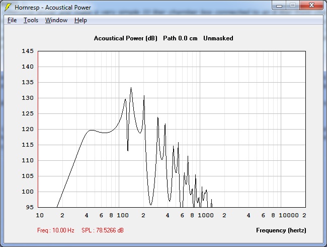

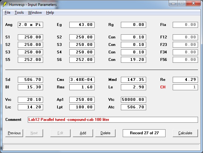

I just made a sim with the Lab12 in a Parallel tuned 6th order with a very small front chamber using Hornresponse's Compound Horn mode ......It is using mainly the throat chamber and rear chambers in sim..... Doesn't look too bad , with some stuffing in the right place that upper bandwidth could be useful 🙂
Yet, not nearly as compact as your Faital Pro box ....
  • Lab12-CH-P6.txt
    Lab12-CH-P6.txt

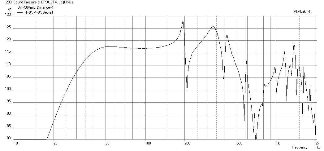

The Lab12 is not a bad performer in a 6th order bandpass box. It has a larger Vas and Qts, and is lower in sensitivity than the 12HP1030 but looks quite decent for a 2.08 cu ft enclosure: 117 dB SPL with -3dB at 38Hz. This is at 50 volts drive to hit 13mm xmax so it is fine for music program but not sustained sine waves as it is about 500 watts (100 above rms rating).

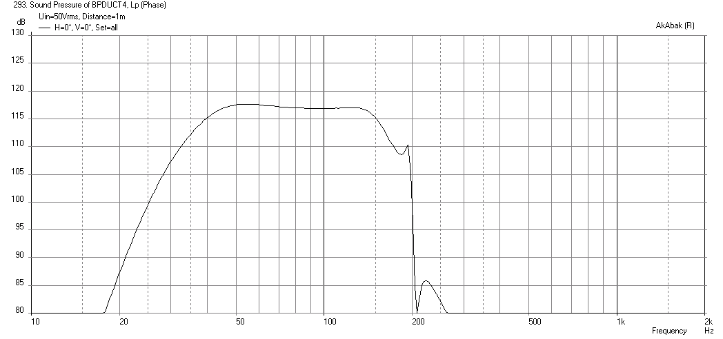

The design ended up at 38 liters for the rear chamber, connected to an 8 liter front chamber with a 1.6 in x 14.0 in x 34 in long wrap around channel duct, and an 8in dia exit aperture on the front chamber. Quite easy to make in my opinion, but will need bracing due to extreme pressures generated. You have to ask yourself if it is worth having two units and twice the volume to achieve the same performance as same smaller box with 12HP1030. That driver costs 2x so maybe a wash. If you have a couple of Lab12's already then it's a no brainer to make it with the Labs.
Here is the predicted performance in 2pi space with 50 volts drive and a 27Hz -24dB/oct HPF:
458067d1420725521-new-sub-design-constricted-transflex-simple-build-series-tuned-6th-order-58p5-liter-6th-order-bp-lab12.png
Here is the predicted performance with a -48dB/oct LPF at 150Hz included:
458068d1420725593-new-sub-design-constricted-transflex-simple-build-series-tuned-6th-order-58p5-liter-6th-order-bp-lab12-150hz-lpf.png

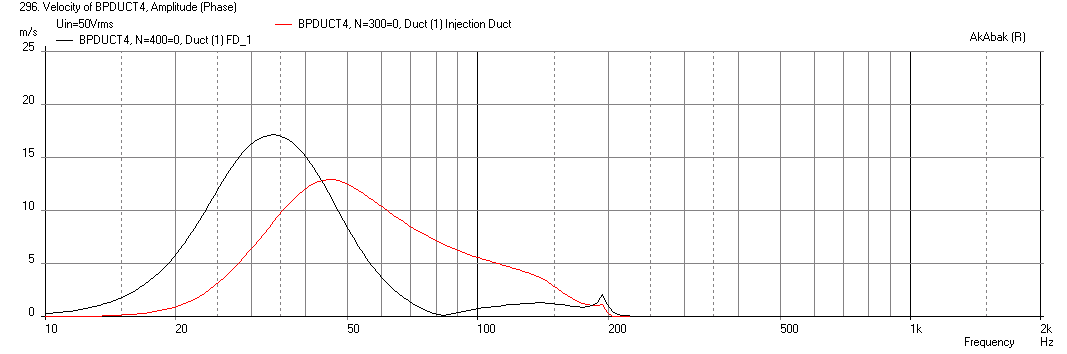

In case anyone is wondering if there will be problems with chuffing due to high vent or exit duct velocities, they are all within good reasonable limits as shown below:
458069d1420725884-new-sub-design-constricted-transflex-simple-build-series-tuned-6th-order-58p5-liter-6th-order-bp-lab12-150hz-lpf-velocities.png
Seems like a very compact 117dB setup if you ask me...
